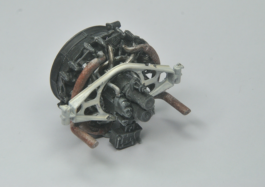

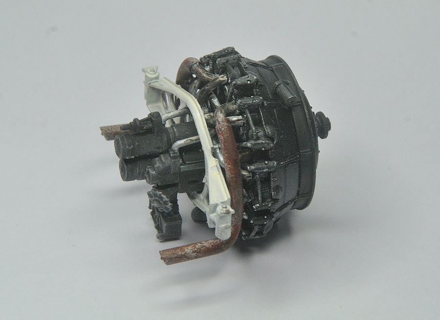

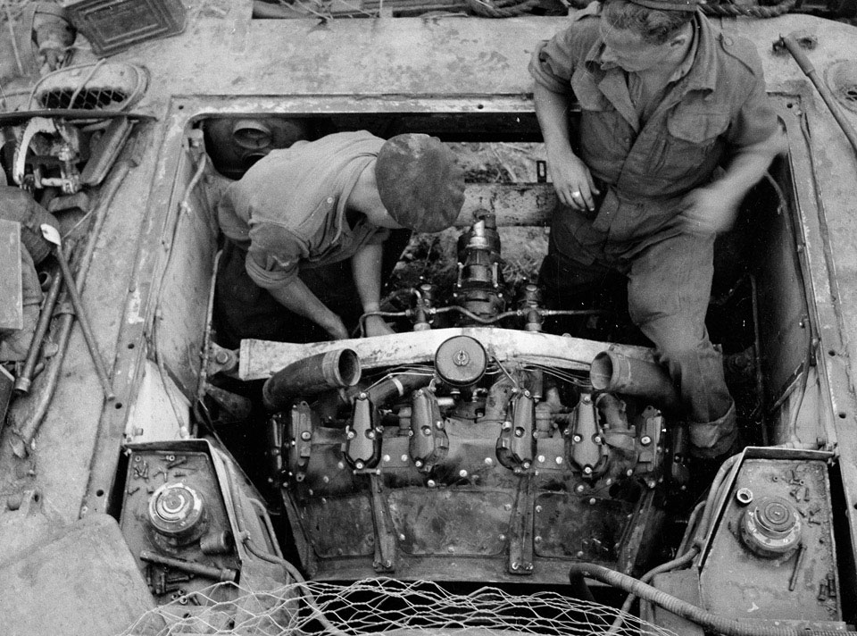

The mini art engine diagrams look pretty good, i have looked at dozens of originals, most are Black and white. the exhaust seems to be a bare metal finish. interesting to see how the engine rocker box bolts stand out against the black ducting for the fan, i wonder if this is going in....or coming out..

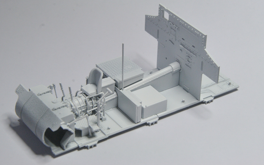

the only real problem i have found so far is the size and amount of attachment points to the Spru's and actually determining what is part of the piece you are removing and what is attachment point. Its not a major problem but does increase the amount of cleaning up time considerably ;-)
Nice, make sure no rust on the engine as it was an aircraft engine (like the Meteor). Look good as is.

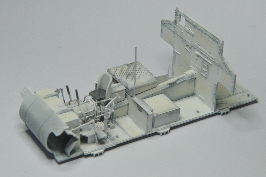

Right well the Christmas break gave me lots of spare time so i have been playing with interiors.

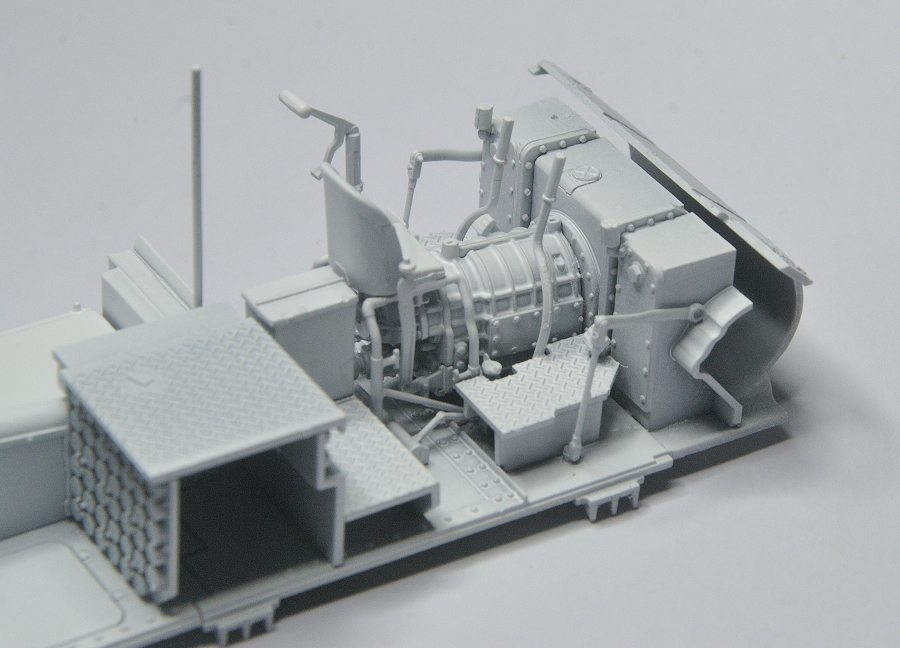

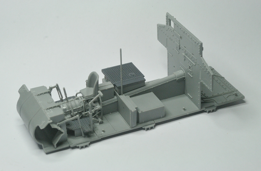

Fit of parts is as good as they come. /excellent here in unpainted mode.

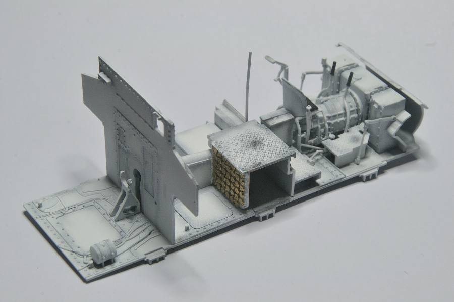

A white primer was added, I really am making this upas i go along, its a case of try it and see how it looks.

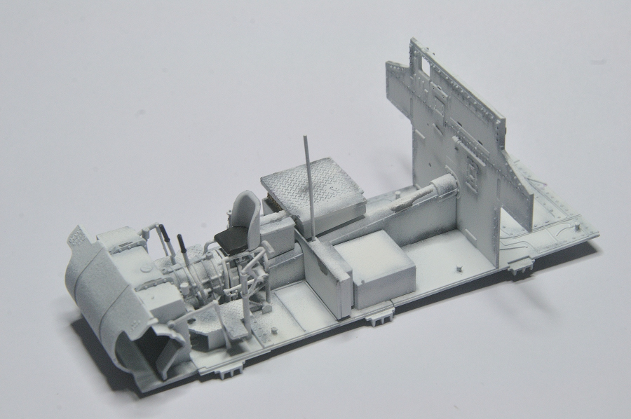

I decided this is too white so i tried to pre shade like you would do with an aircraft
it sort of works but its miles off where i want to be

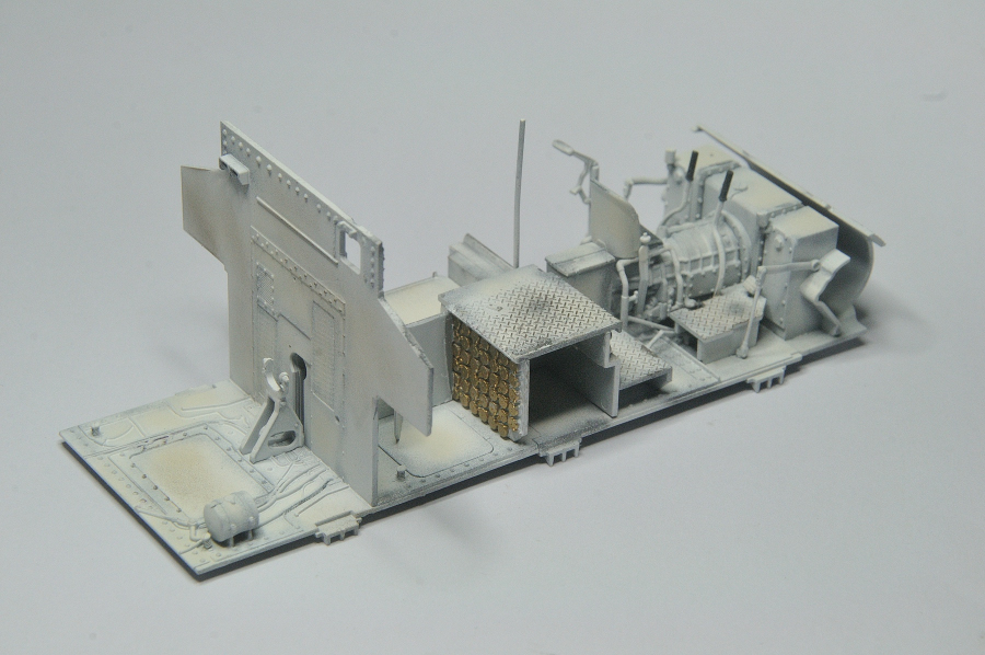

So i tried adding a little desert yellow to the white which again sort of works but still not really what i am aiming for but the problem is all i can find is pictures of restore tanks in colour and they like restored aircraft are probably nothing like a tank in the field.
Apparently British Grants/Tanks were silver inside however they ran out of silver paint as it was all diverted to the aircraft industry so went to white for 41/42/43 .
I think with more parts added to break it up a bit and some strategic chipping and weathering it will look ok, maybe a dark wash to bring out corners and edges, detail .

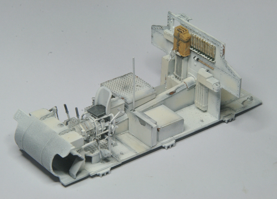

I really am not sure where i am going here :) I had a vision of how i wanted this to look but it was heavily based on rust and having decided to do a Deseret scheme thats not going to work so its just doing its own thing :dude:.
I read that these things leaked like a sieve as there was no seal between the riveted joints so they filled up with water in the rain.....as long as they were not in the Desert :)
I think i will do the interior sides next so its a bit more enclosed ,light wise, and then review it again.
I remember reading some accounts that there was more rusting than you would expect. Metal would be exposed on vehicle bodies by blowing sand and tracks burnished driving thru sand. As most of the action occurred within a few miles of the coast, when they stopped overnight, a thin haze of rust would appear when the temperature dropped and condensation settled. As soon as they started moving the next day or caught in a dust storm, most of it would be removed.
