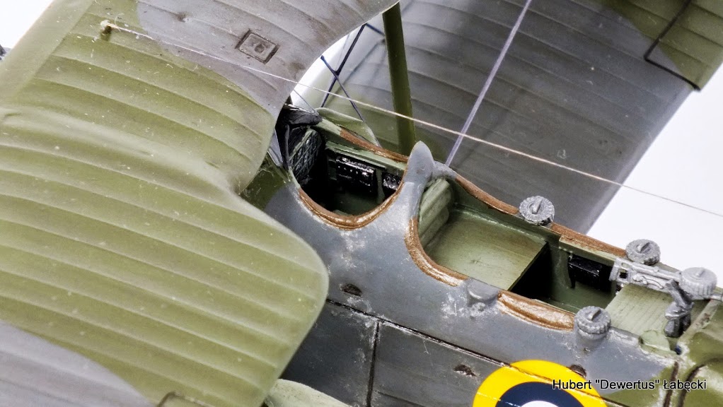

Model.
Model built in order to learn how to made the tendons in biplanes. Because the Smer model is straight I was not worried of its shortcomings and errors - therefore minor corrections and supplements I made mainly to fill emptiness in the model. In themselves using the residues and remains of other models I made cabin equipment (instrument panel, radio, control panels, etc.), rear gunner gun and spare magazines, pilot's gun, crew seats with belts. Tendons I made by using a core of rubber strands, antenna and a cords to the rudder i made using elastic threads drawn from wife's stockings.
Model was painted using Humbrol enamel and Agama acrylic varnish. Wash made using MIG's Neutral and Dark Wash. To brake monotony and homogeneity of colors in several places I slightly wiped surface by the polishing material. At the end to the highlight convexity and give a little "worn" appearance to the model I put filter made from strongly diluted MIG's Neural Wash. Original Smer decals were not applicable due to poor color and wrong size - that's I used Techmod decal sheet for RAF airplanes and "scrap" from other models.

Model.
