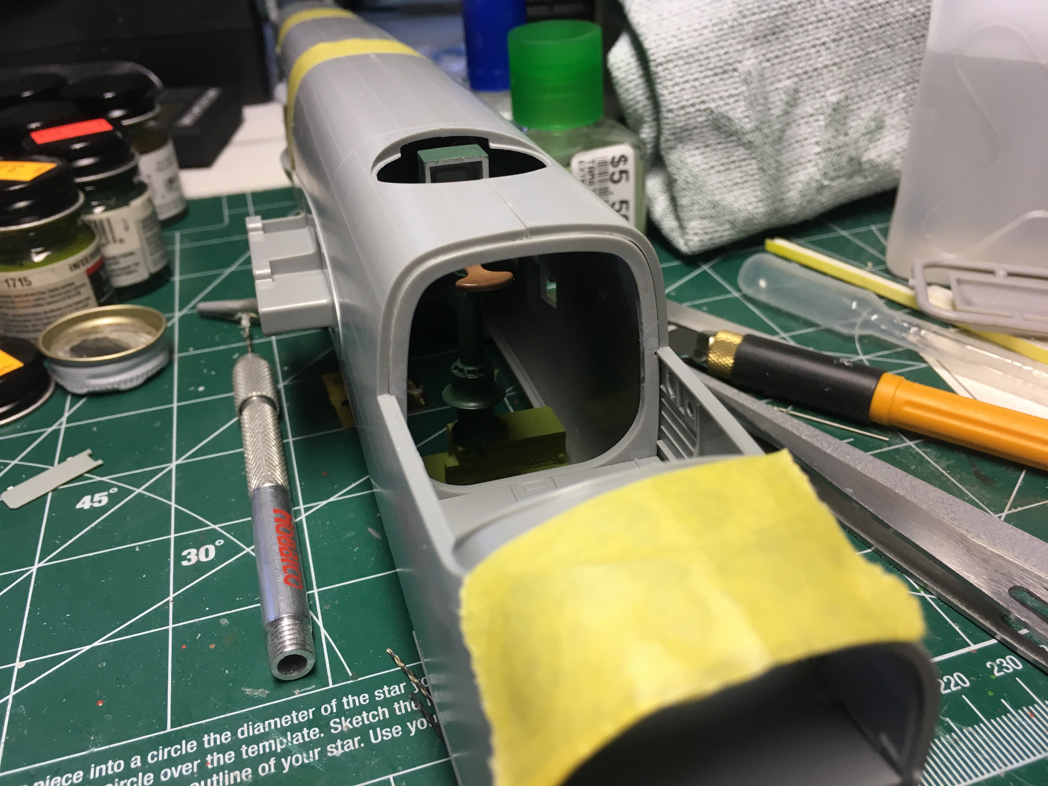

A little mock up of the upper turret so I can have an idea how visible it will be and get an idea of how much "detailing" I want to get into. I think I'll be fine w/ a couple washes and some dry brushing once I get the boxes painted.

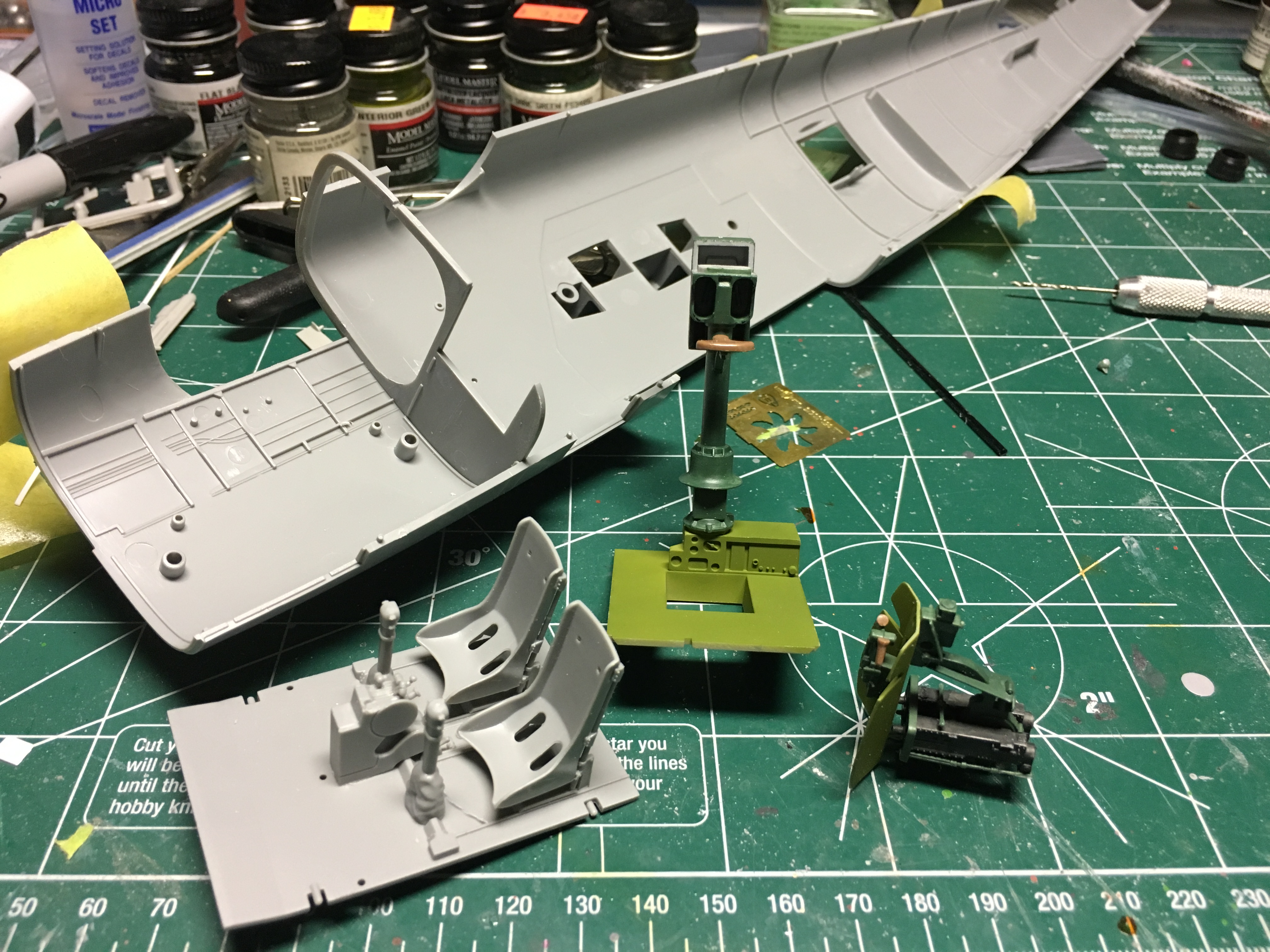

It's been a bit since the last update. Still plugging away on the interior bits. Cockpit is ready for the base coat now. Then it will be washes/dry brush and onto the bomb bays.

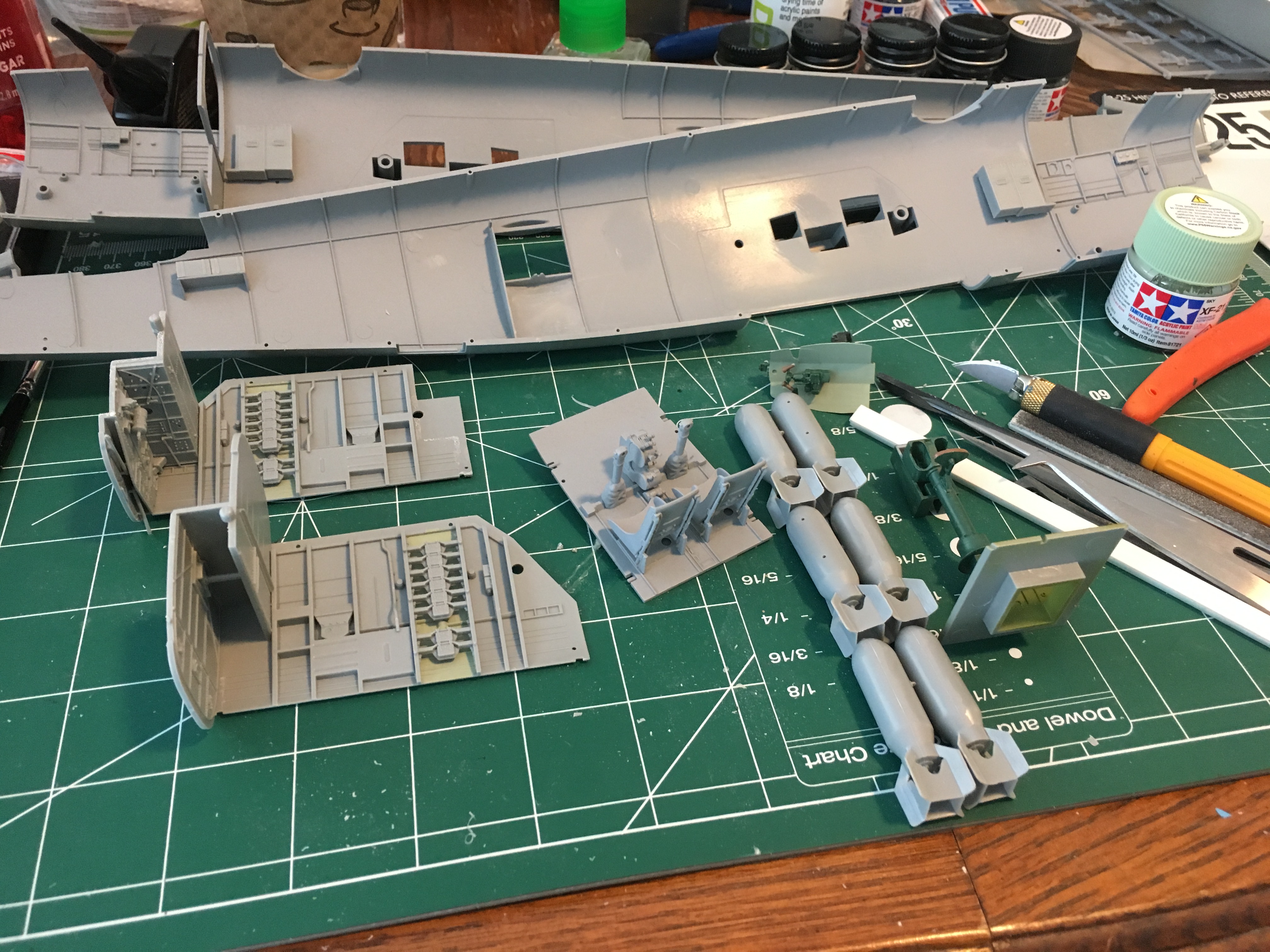

More progress while visiting a buddy. Bomb bay is pre-assembled for painting, which I'll do back home. Dropping in some of the other fuselage bits as well. I think I'm about to move on to the waist guns next.

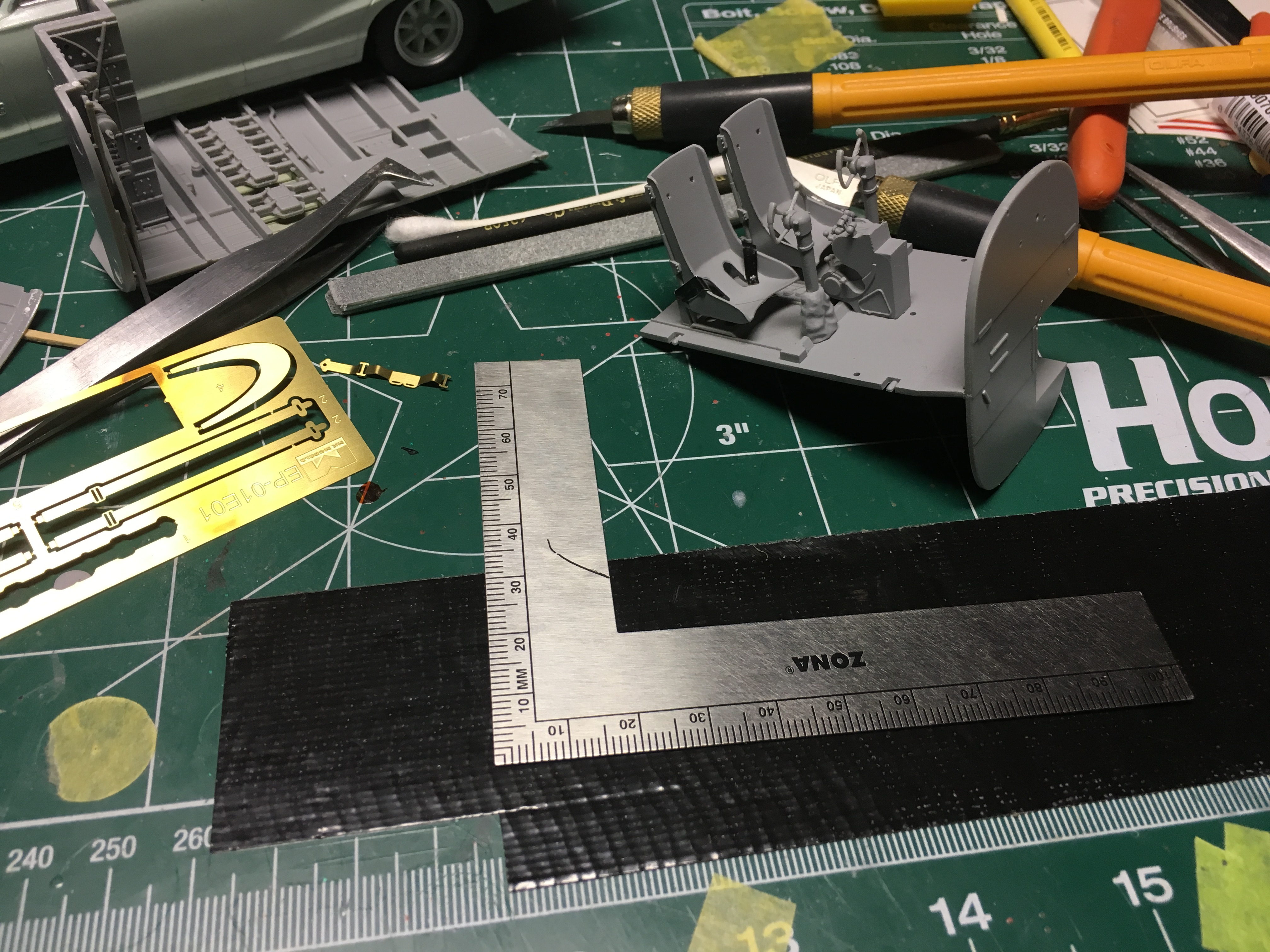

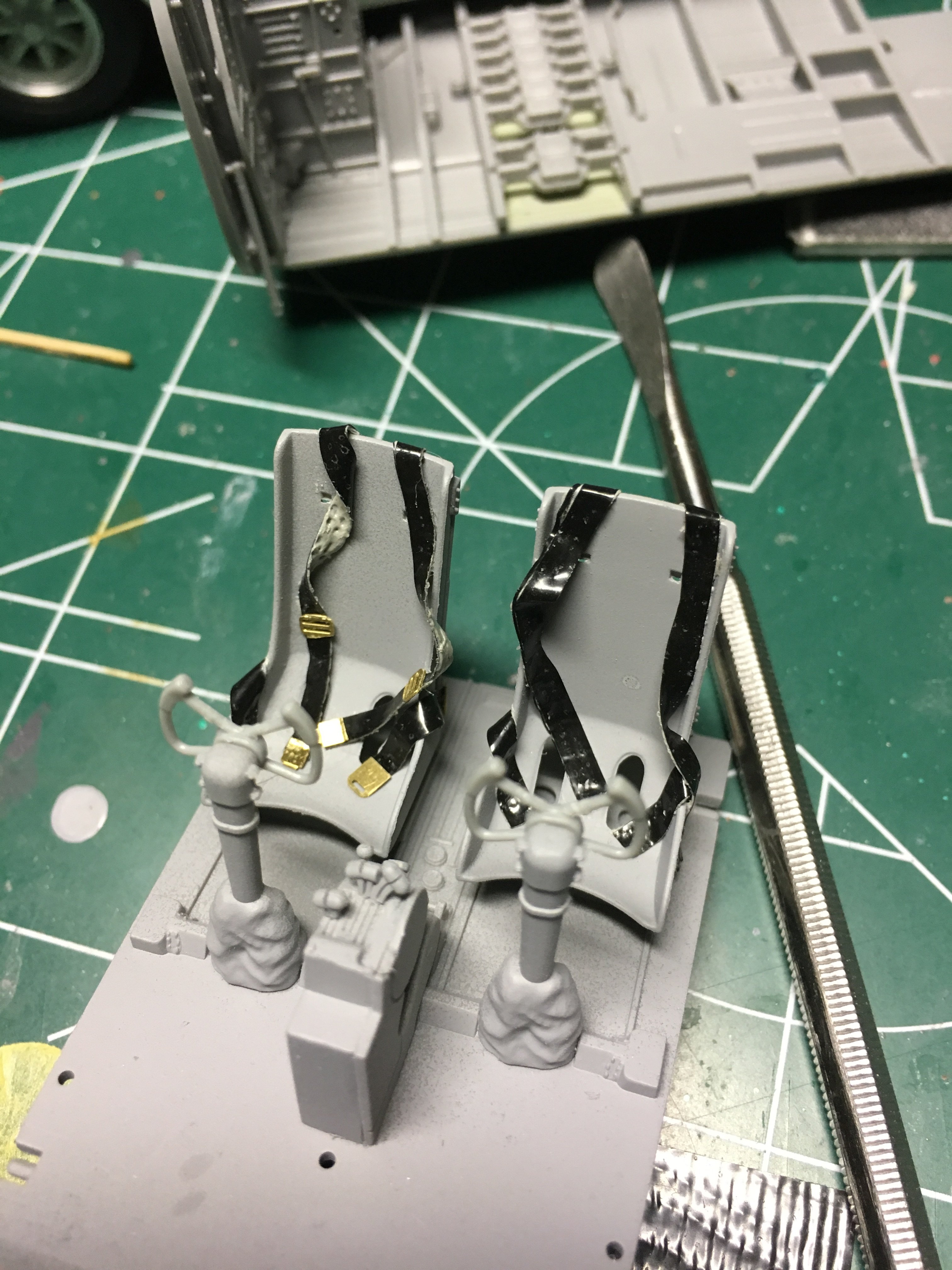

Not a fan of the included PE belts. So cutting some of my own from some duct tape then will snip off and use the buckle portion of the PE.
full
man I wish I could fine my square....I don't like the metal belts either, never can get them to do a natural lay in the seats. :popcorn

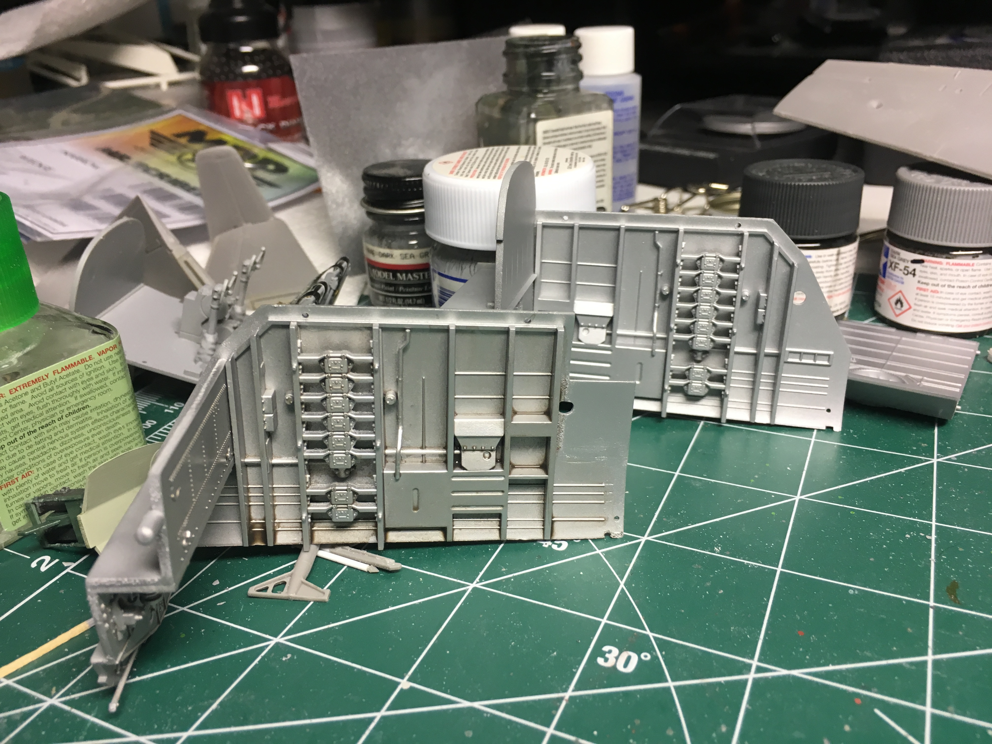

A little more progress on my one night off this week.
Bomb bay sprayed, sealed, and hit with a "grunge" wash. I think I'd like to get in there with some pastels for dust before I load up the bombs. I'm still kicking around the idea of painting the bomb rails...not sure yet.

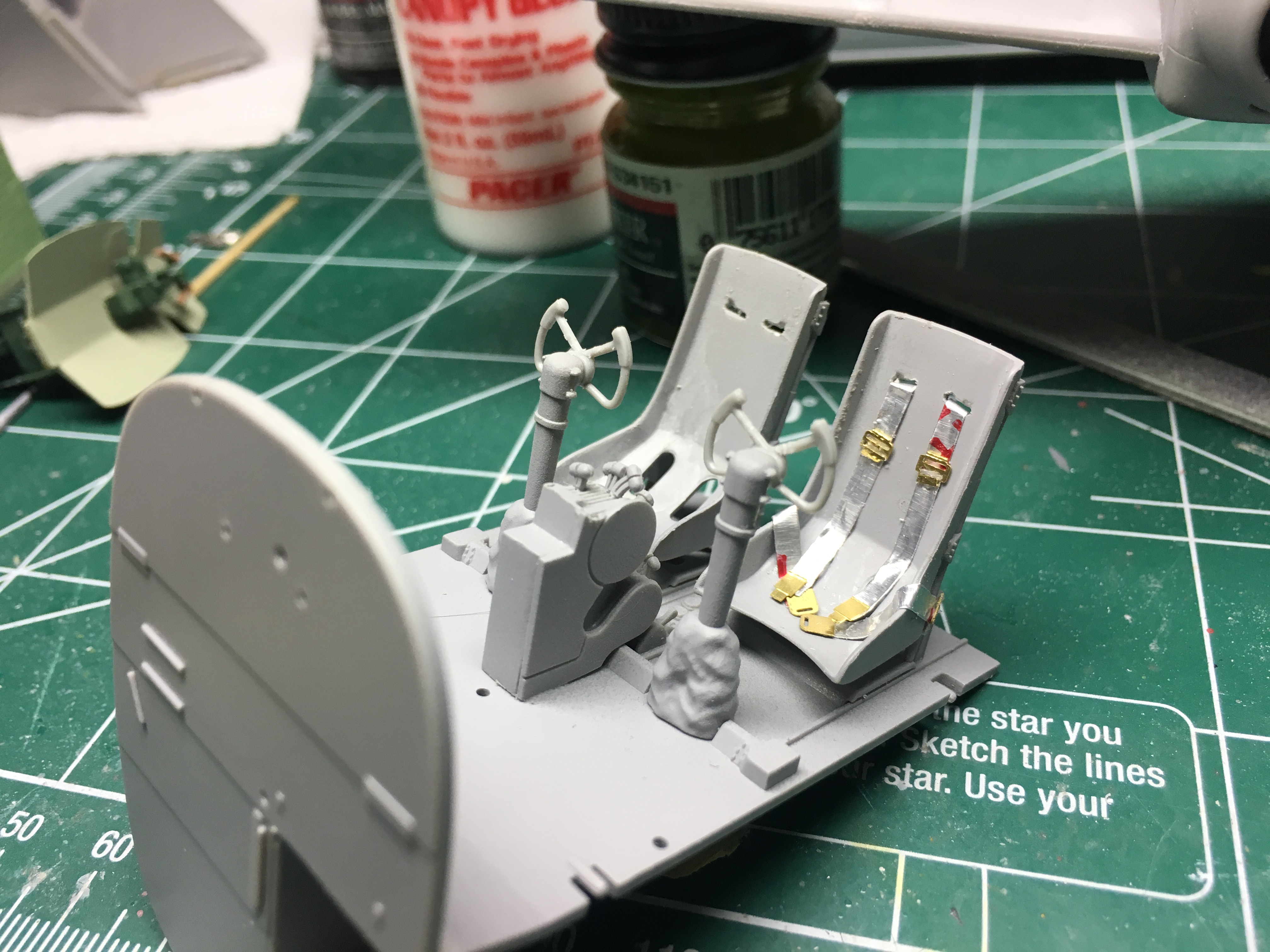

Seat belts Rev3. Opened up the slots in the seat backs for the belts to pass through. Then also decided to try some HVAC tape for the belts themselves. Workability/flexibility of tape, w/ the ability to hold shape like PE. I think this may be the way to go. And for $15 I can probably do 1000s of belts. What a bargin! :lol:
full
