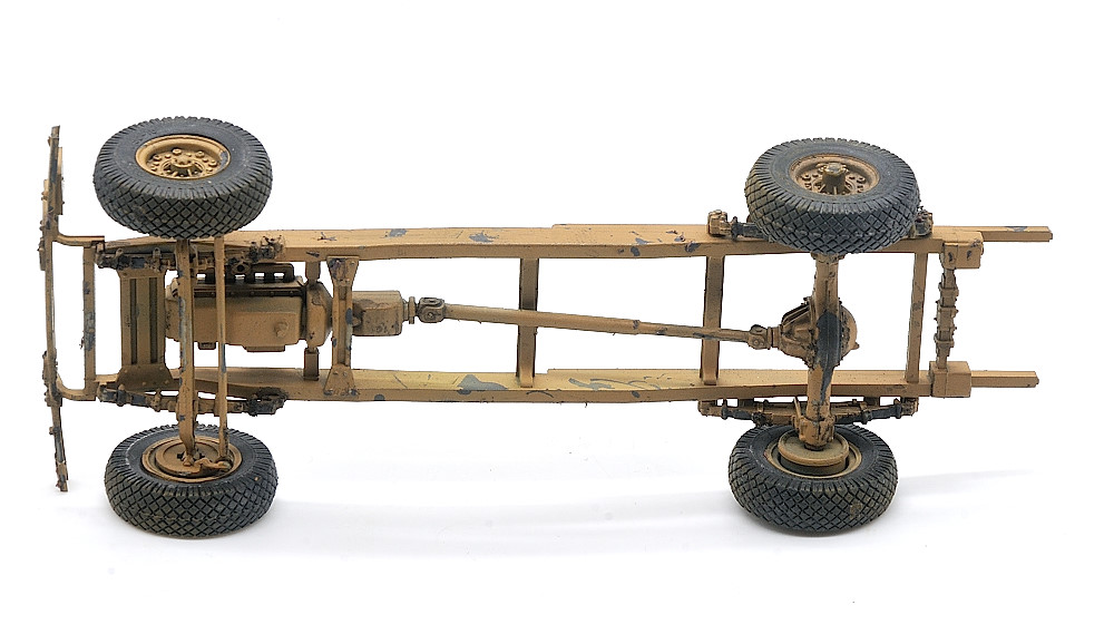

Chassis built took less than an hour so steaming ahead

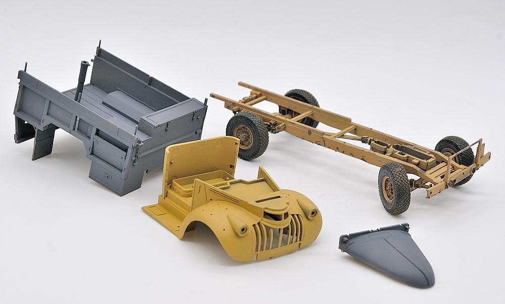

This grey is my attempt at a base coat for chipping, i figure things dont really rust in the desert but they would get sand blasted with rocks and ...well sand. I just wish Tamiya had given us the rest of the engine, maybe a challenge for a future build...
I am planning to try and dent some panels on the body but that might not work :)

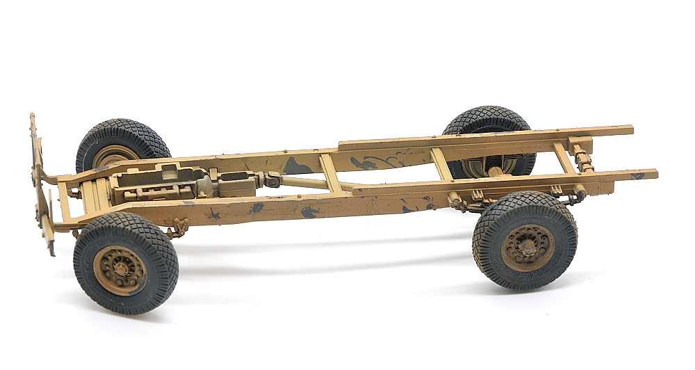

I went with Tamiya XF24 Dark Grey, then a splattering of Humbrol Maskol and then a top coat of Tamiya Desert Yellow XF59.
Its quite handy seeing what works before i start on the body work :)
There is a temptation to over do this i can see so i need to be careful.
The Tamiya desery yellow is quite dark so i might try pree shading white on the top to show sun bleach. I also want to put some dents in which could go badly wrong with flames and plastic :) Good fun though.

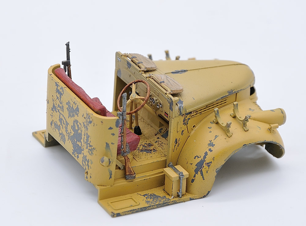

Looks good Paddy! Only thing I would suggest is if it is a North Africa vehicle, the paint would be weathered light as you are thinking. There wouldn't be any dark grime though. No mud or dark dirt to speak of except where there would be oil leakage. Parts like the springs would tend to be dark as the flexing would break the paint loose. You have it right that the areas where the paint is chipped and worn off would be either dark grey metal color or a slight reddish. The tires look really good! The best way is to find some clear example photos. I have some from a Sdkfz 222 I was building and there wasn't any rust to speak of. There was a lot of caked dust in the nooks and crannies, and bleaching of the upper paint surfaces, but nothing other than that.
Keep up the good work my friend! It's looking good! Oh, just a thought, the desert vehicles usually didn't get too beat up and dented. There wasn't all that much out there for them to run in to. There would be small dents and scratches from stuff being banged into the sides and especially around the truck bed. Desert means that light and subtle is better.

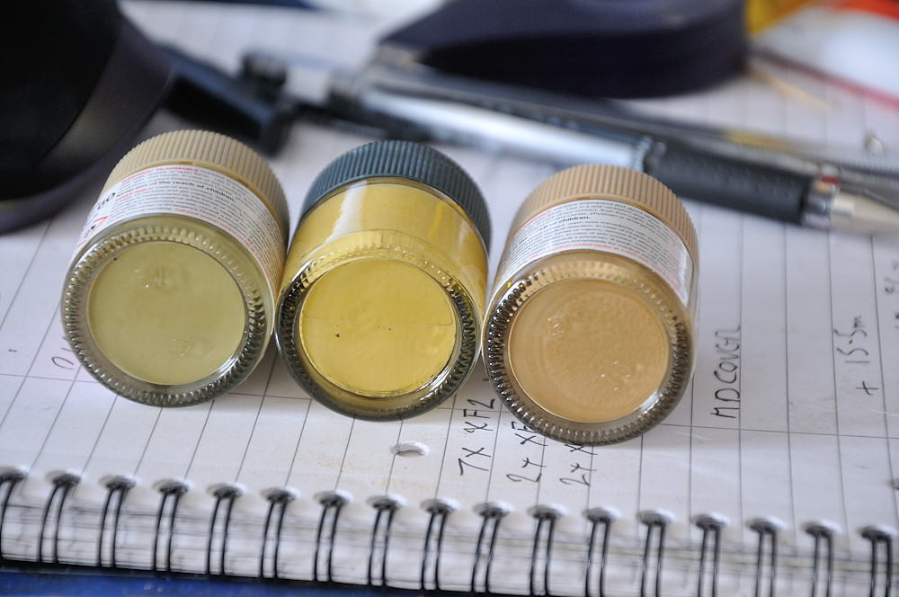

LRDG Chev's were painted Canadian Sand overall at the factory, as were all Canadian built vehicles going to North Africa. It is similar to Light Stone and Tamiya XF-60 Dark Yellow is a close match.
Mike Starmer's mix for Lt Stone is 7 x XF-2 + 2 x XF-59 + 2 x XF-3.
Rich
Thanks Rich
This is my mix of 7 x XF-2 + 2 x XF-59 + 2 x XF-3.
Left is Dark yellow then my mix then Desert Yellow
The mix is quite a bit brighter but then it doesnt look wrong and is quite a good sand.. maybe a splash more XF59 just dull it down a bit ?
The Mix looks good ove rthe dark grey, just takes the edge off but i wonder if the fugures are correct ? as they add up to 11 and usually it would be 10. My guess is 1 part yellow XF3 would work better that 2 parts as i have added a little extra desert yellow to the final mix
You can see the contrast from desert yellow to the mix here , chassis is desert yellow, body is the mix :)
That is his mix. It is described as a light but very yellow sand. It is not the same as the post war Light Stone that is much paler. Once it is weathered and dusted it will be lighter.
Rich

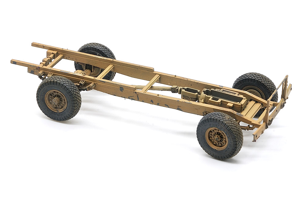

Quick update
I have mostly been experimenting with finish and technique. as well as find i method of painting and construction that doesnt leave me trying to paint parts behind other parts already painted :)
and balanced on the chassis
thanks for looking
I found an article on line that said drag the maskol about with a tooth pick so its not just a round blob or drip. It also says you can use a sponge so i might try that on the back :) Having great fun with this...

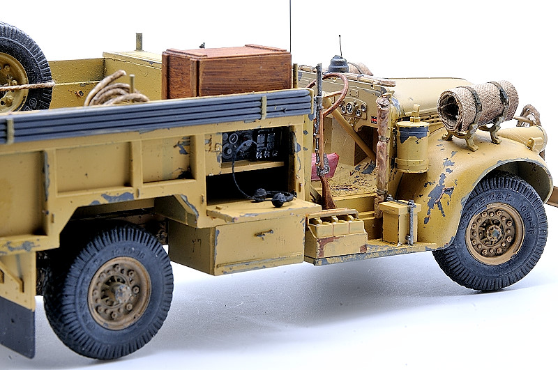

change of direction for a bit now, this is supposed to be part of a diorama so i have been putting off the figures. I'm not very artistic which is why i tried to paint the plastic rolled up tarpaulins here and ended up making some out of a piece of old shirt which is much easier :) I did try and paint the kit parts but they looked exactly like painted kit parts :) ...
So next step figures...........oh dear
