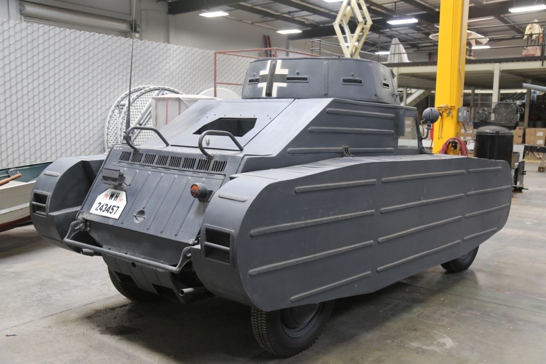

Thanks for the links and photos James. I think both Saúl and I thought you were talking about the Havok.
As to access, there is a hatch over the engine compartment on the rear.
The pods are also such that they can go on either side.
I had known about this variant for years (from the 80's when I was really into collecting VW's)
Imagine my surprise several years ago when these photo showed up. It is definitely original except for the engine. Too many little things all over confirm that it is what it is supposed to be.
oh dear, now that takes the word "Kübelwagen" really to the next level.
For those not knowing, the german word "Kübel" translates into bucket. in the 1930ies it was used for a more dirty bucket a latrine bucket. Nowadays it would be used as a plant bucket. But then there is also a verb "kübeln" which has the meaning of pouring something. In a more dirty meaning it would mean to vomit. - So, now put this all together and the word "Kübelwagen" gets a quite different meaning, not? :)
