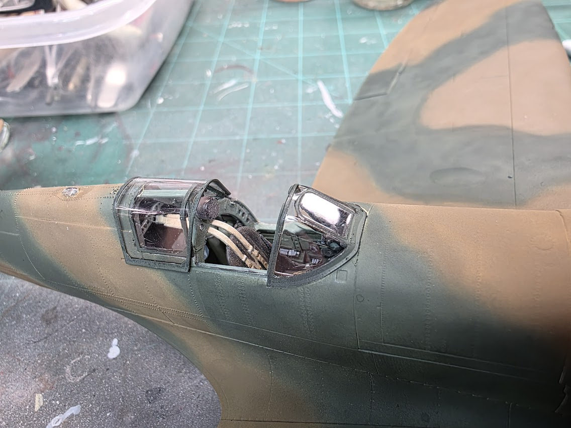

Got back in the shed today to mask off the canopy. I decided to do a double mask to get interior and exterior frame work. First a black primer, then the interior color on the inside, exterior on the out.
It's not scratched, I promise. I didn't seal it this time because I was using only acrylics and figure it would wash right off if I screwed up.
Well I'm in a little trouble. The canopy didn't take the clear coat well, when i stripped it I saw there are in fact some cut lines from masking, really didn't think I cut that deep but there they are. So I used those new sanding sticsk I got which include the glass sanding sticks. Goes all the way up to 7k grit. Then clear coat again, looks like shit.

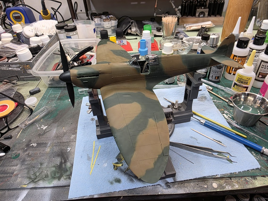

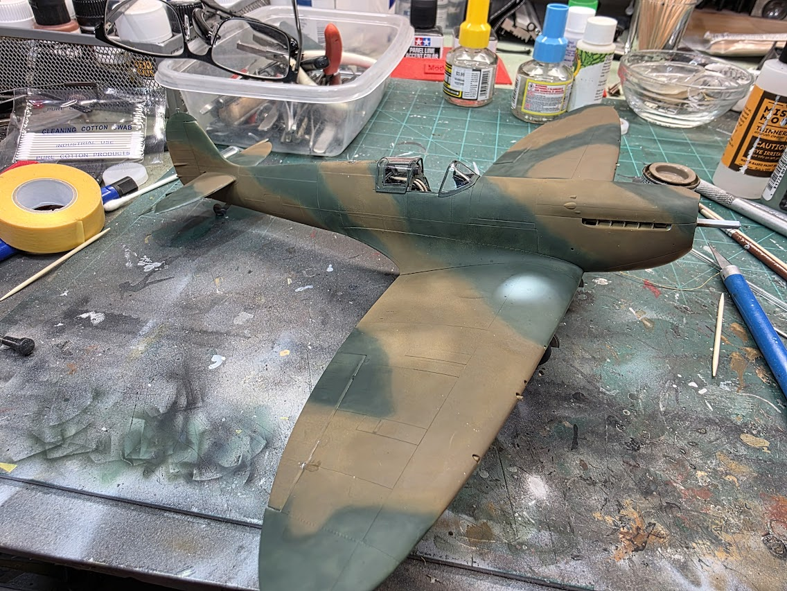

Anywho, I cleaned up the demark lines and tried to replicate the camo shapes best I can. The Mobius air brush is nice change, but I think I'm still in the market for another.
Got the Malcolm hood masked up and canopies are in place.
Clear coat up next and I gotta get the underside done.
