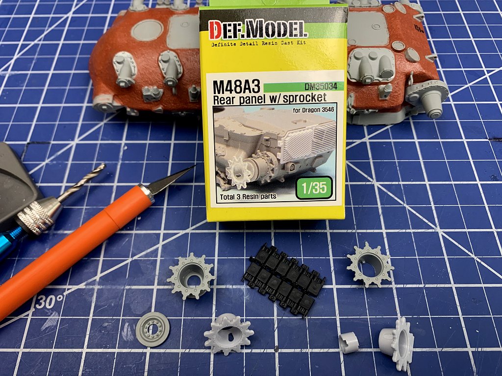

Eric and Erik,
If the rear doors on the Def.Models set are warped, see here:
Dealing with warped resin...

Eric and Erik,

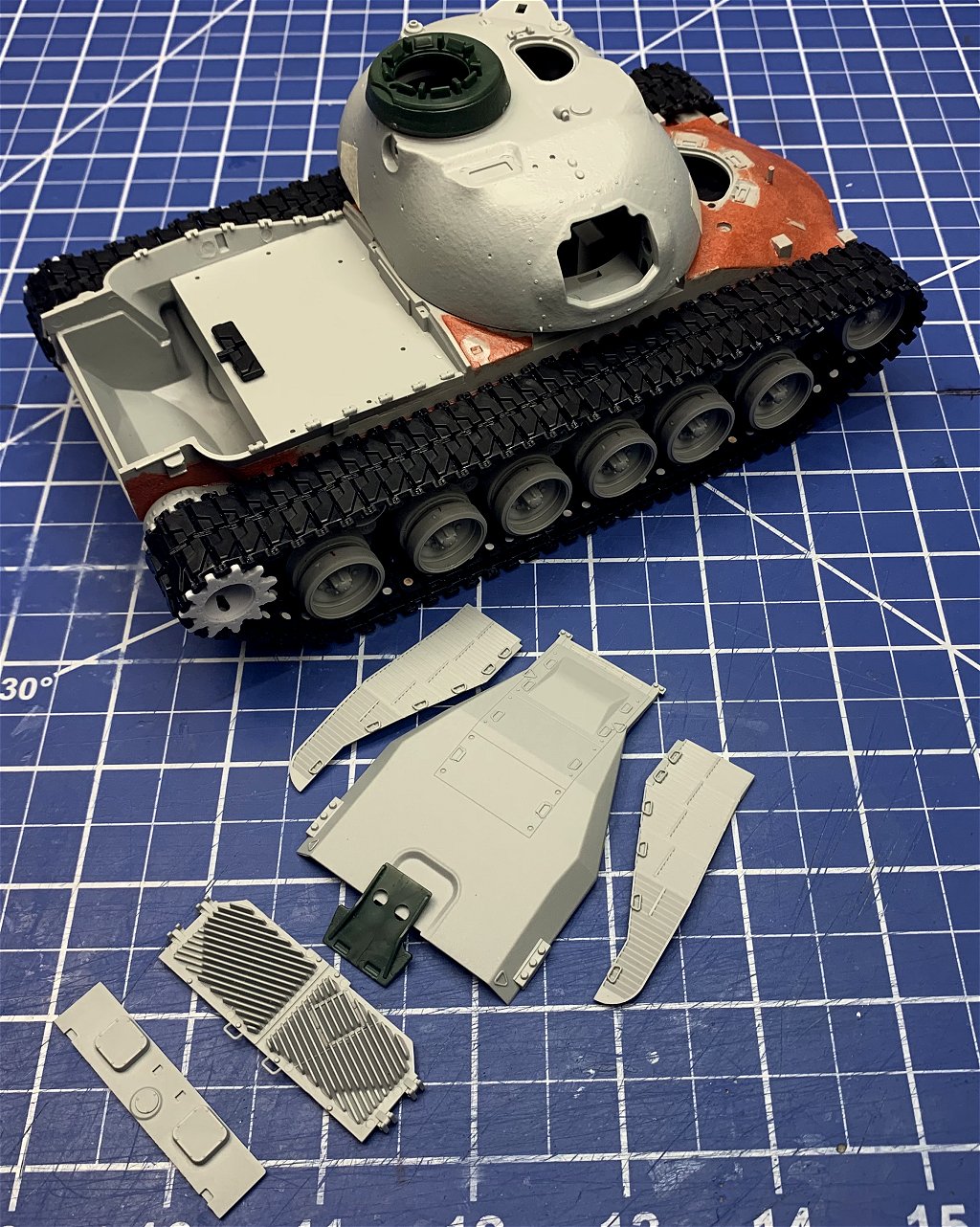

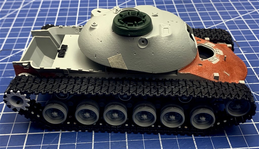

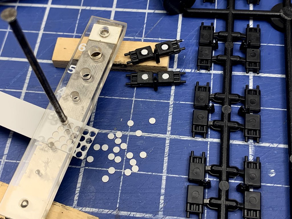

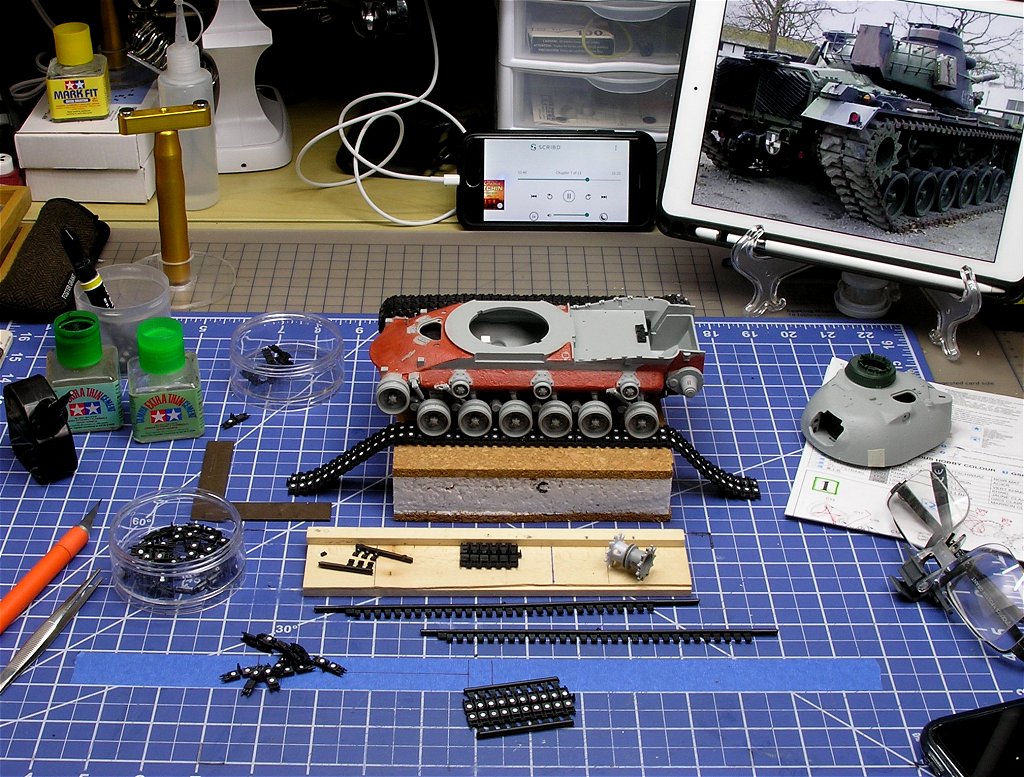

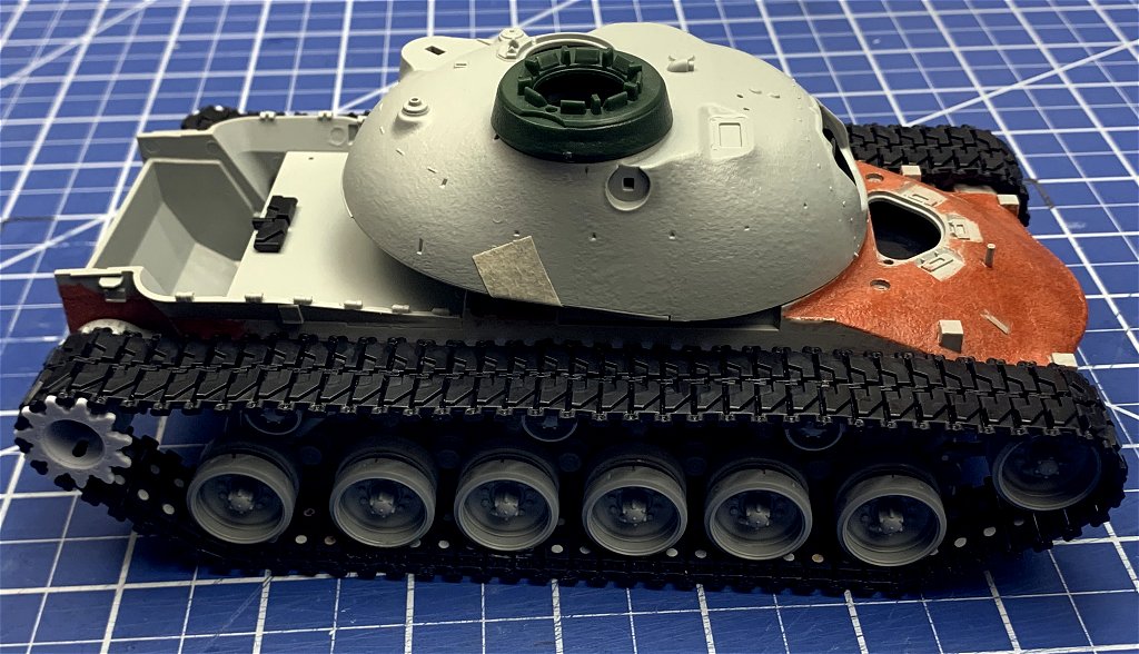

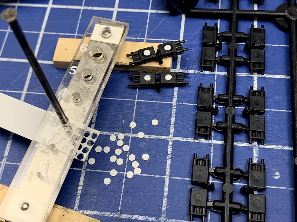

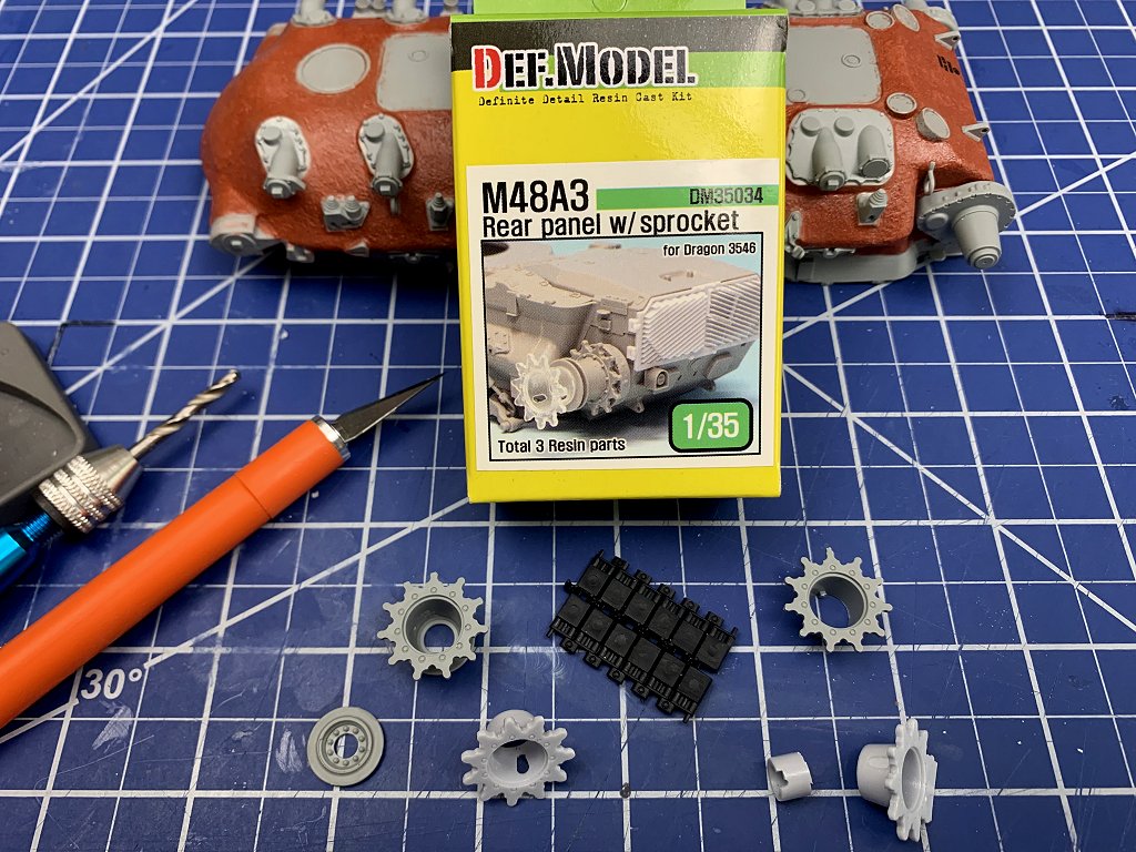

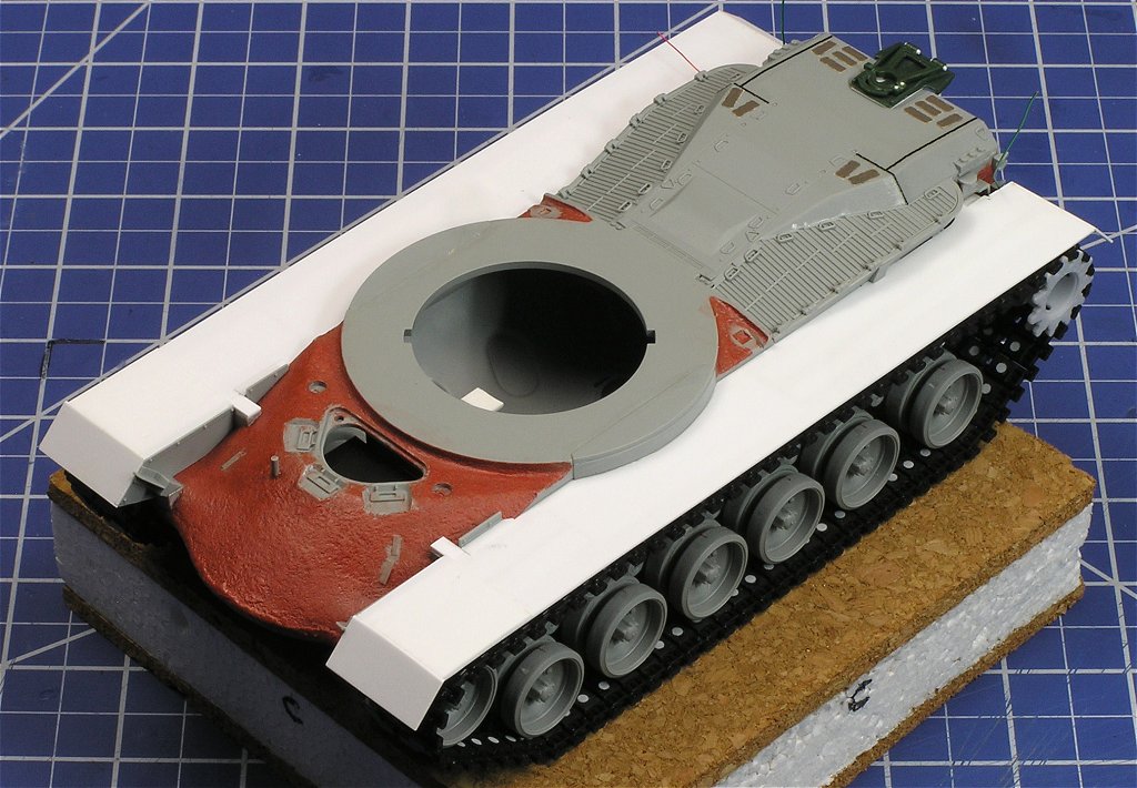

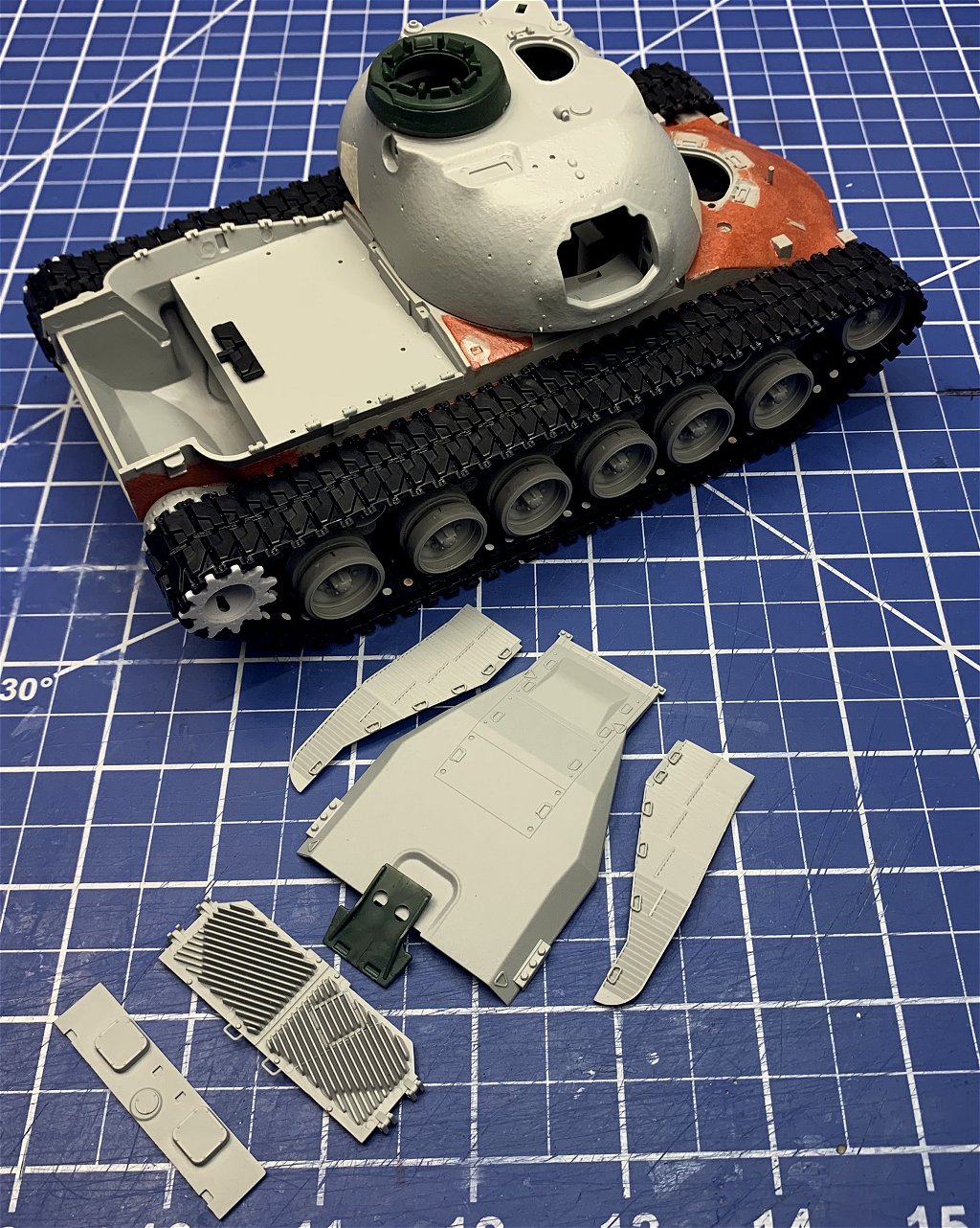

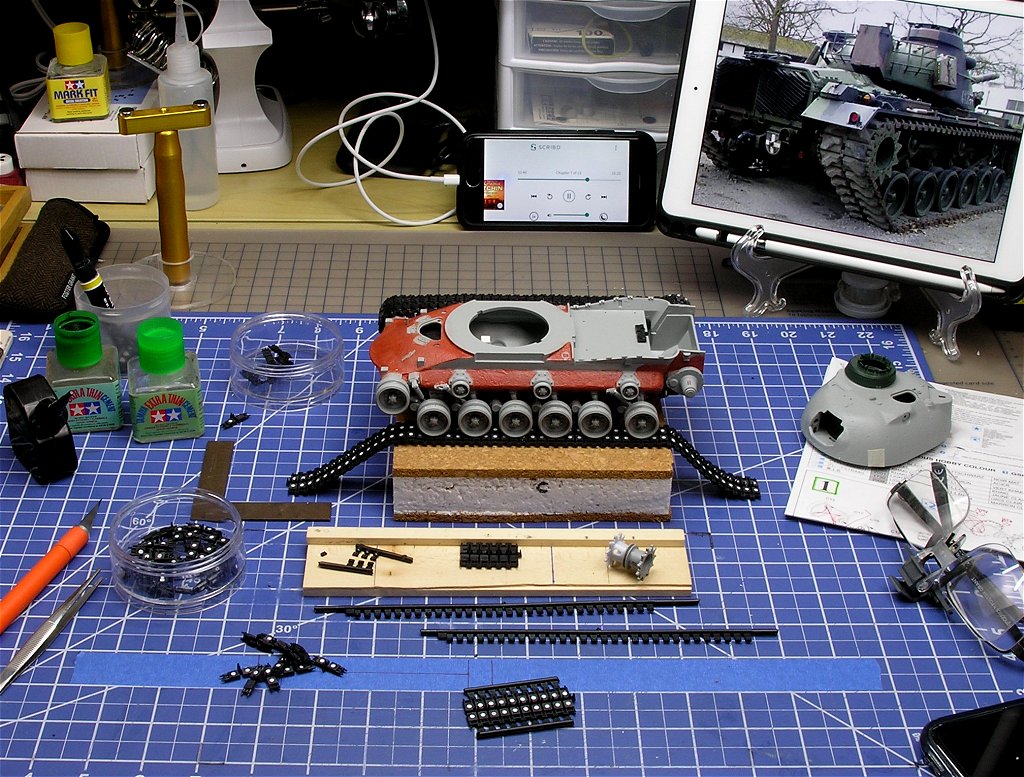

Eric I would be interested in knowing where you got that punch-thingyMade some great progress over the past week. Got suspension and tracks installed, in record time I might add. No real major problems other then ejector pin marks on each track link. I ended up punching out about 200ish discs to fill them, but it didn't take as long as I thought it would. Once that was done the tracks went together quite easily. Up dated the drive sprocket with one from DEF models, a little tricky but doable. The only other down side was I wanted to build up the tracks so that I could remove them for painting. However the way the kit suspension goes together didn't allow for that so I just attached them...oh well. All and all I happy with the results. Next up assembling and detailing the rear end.
Thanks for stopping in and see ya'll next week!

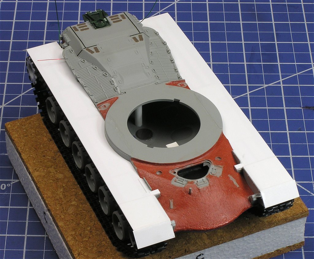

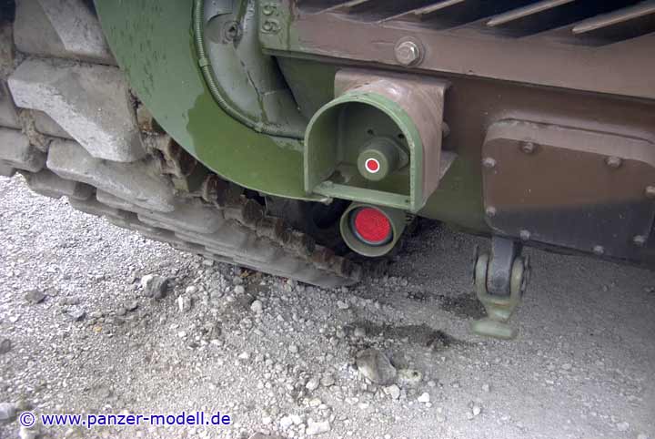

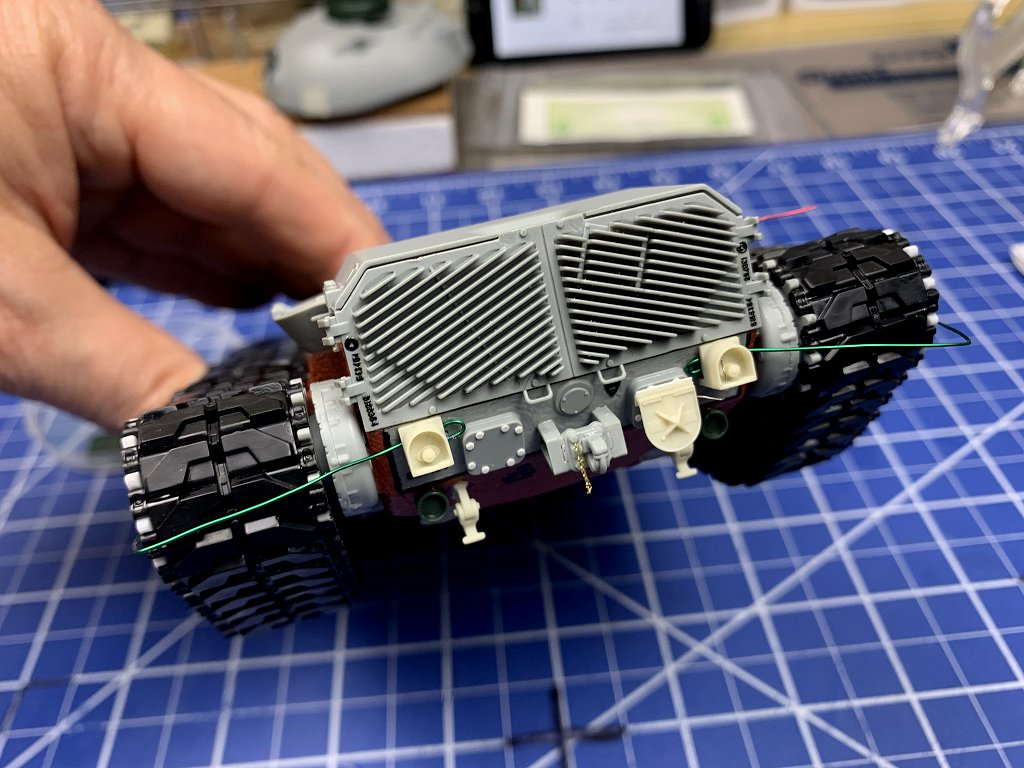

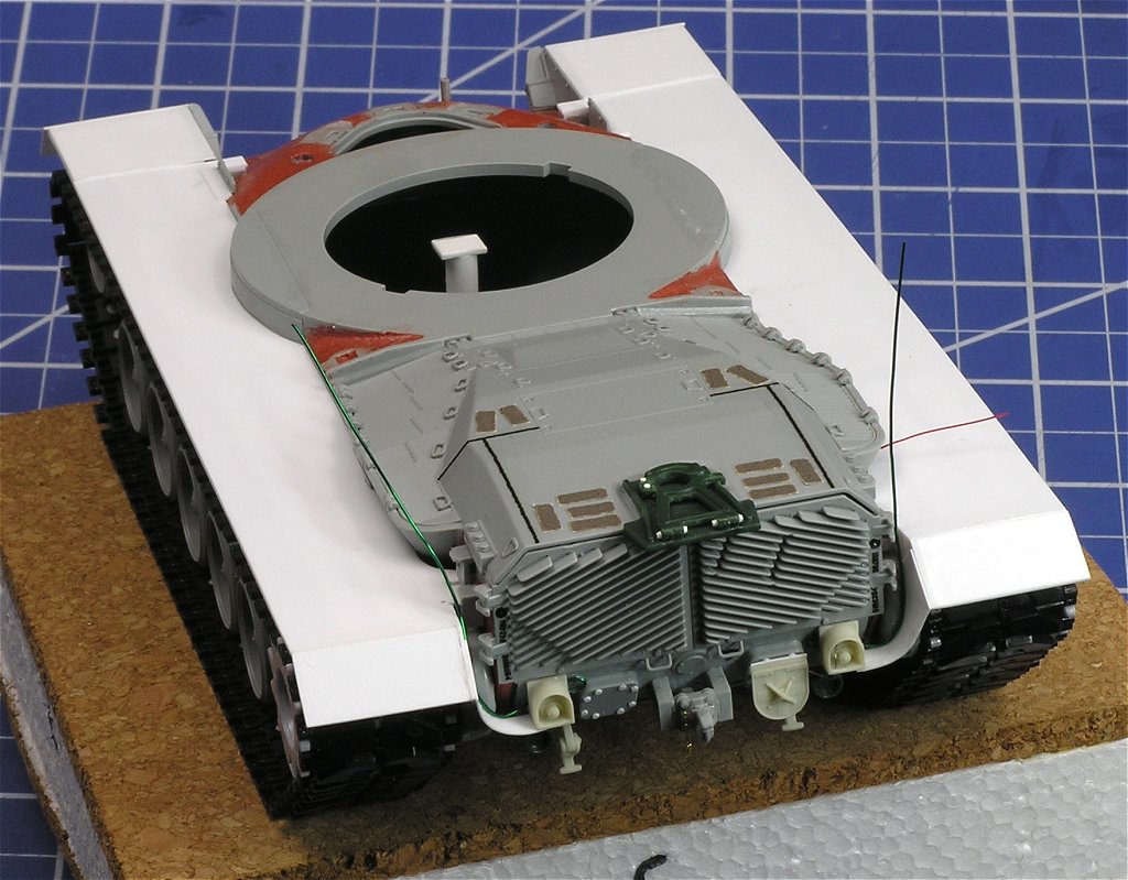

Ah, you just don't have it all routed yet.There are tail lights on the finders and the green wire is the wiring conduit for them.
Correct. Just have them tucked out of the way or now.Ah, you just don't have it all routed yet.![]()
