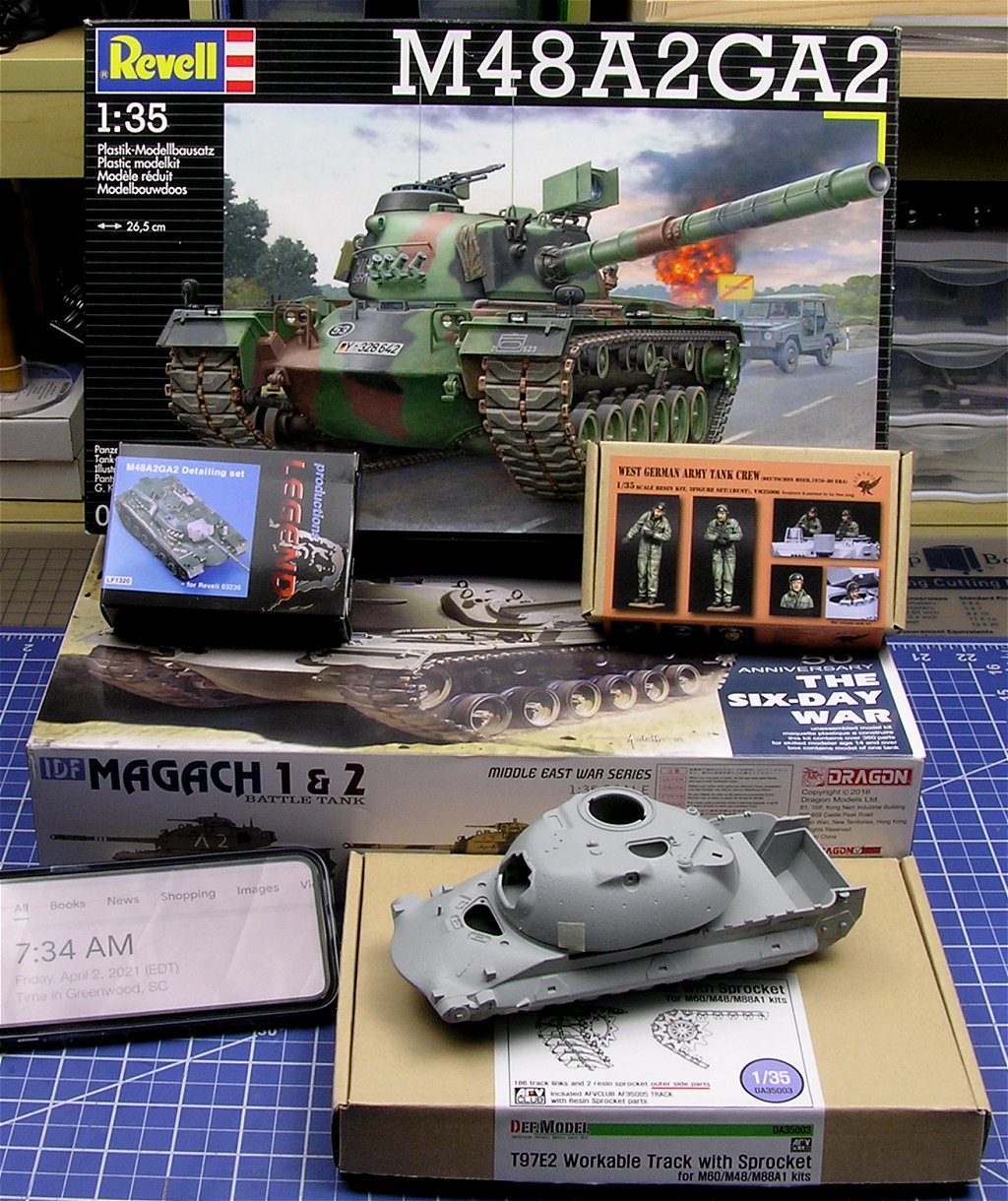

I've been wanting to build this version of the M48 for several years...so now is as good a time as any! As the title states I'll be kit bashing the Revell GA2 with the Dragon Magach 1/2 kit to get a better detailed end result.
Anywho here is the start up pic.

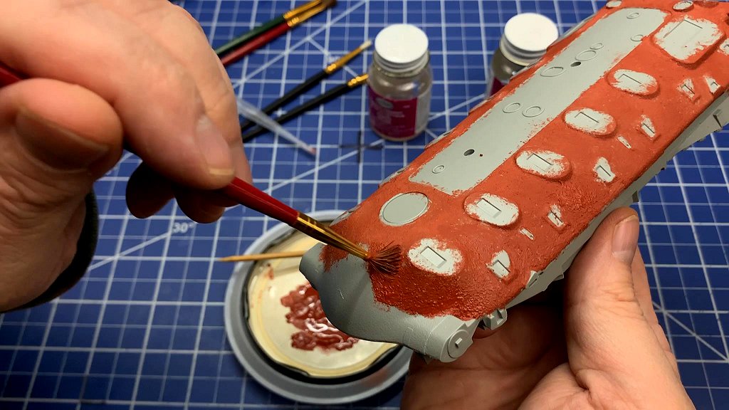

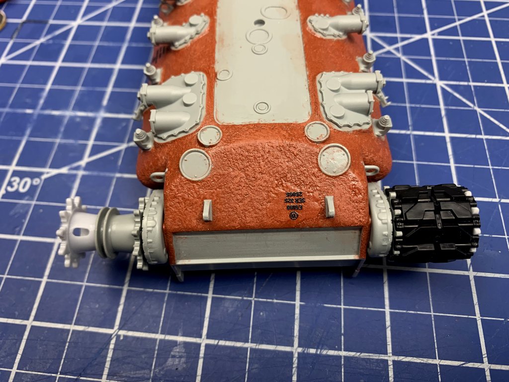

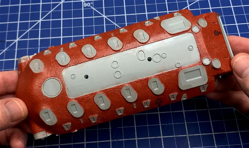

Here's the first update after a couple of days work on this. Got the lower hull textured using automotive bondo thinned with testors liquid glue. I then sanded it down added foundry markings then sealed it with a coat of future. After that started adding the suspension elements. So far I think its coming out ok.

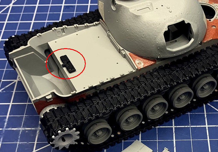

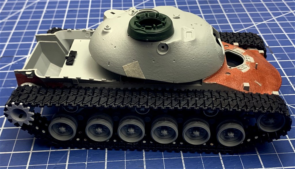

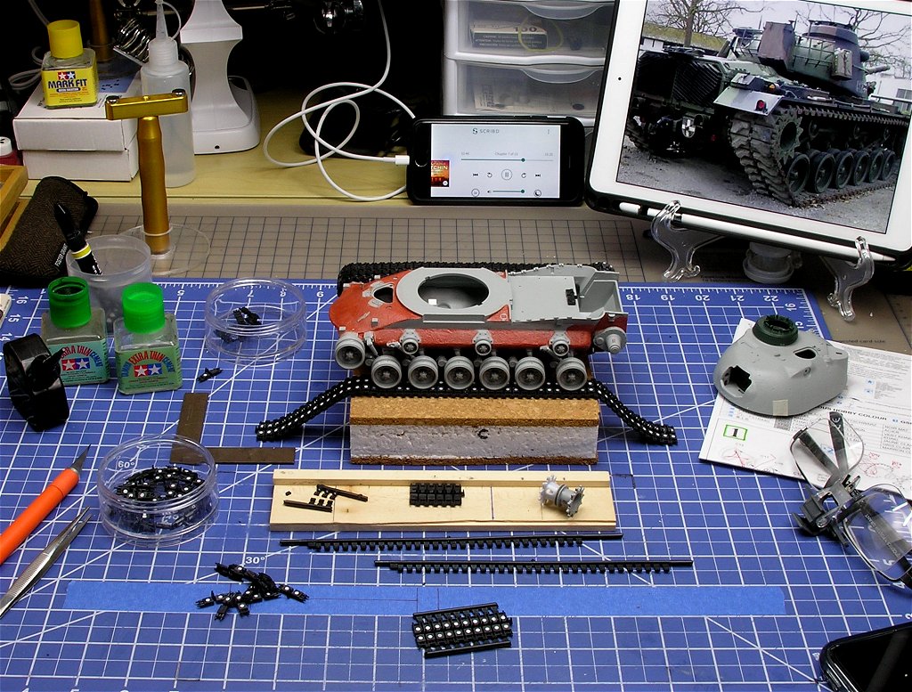

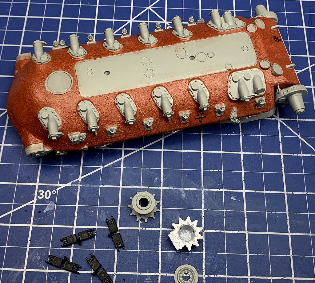

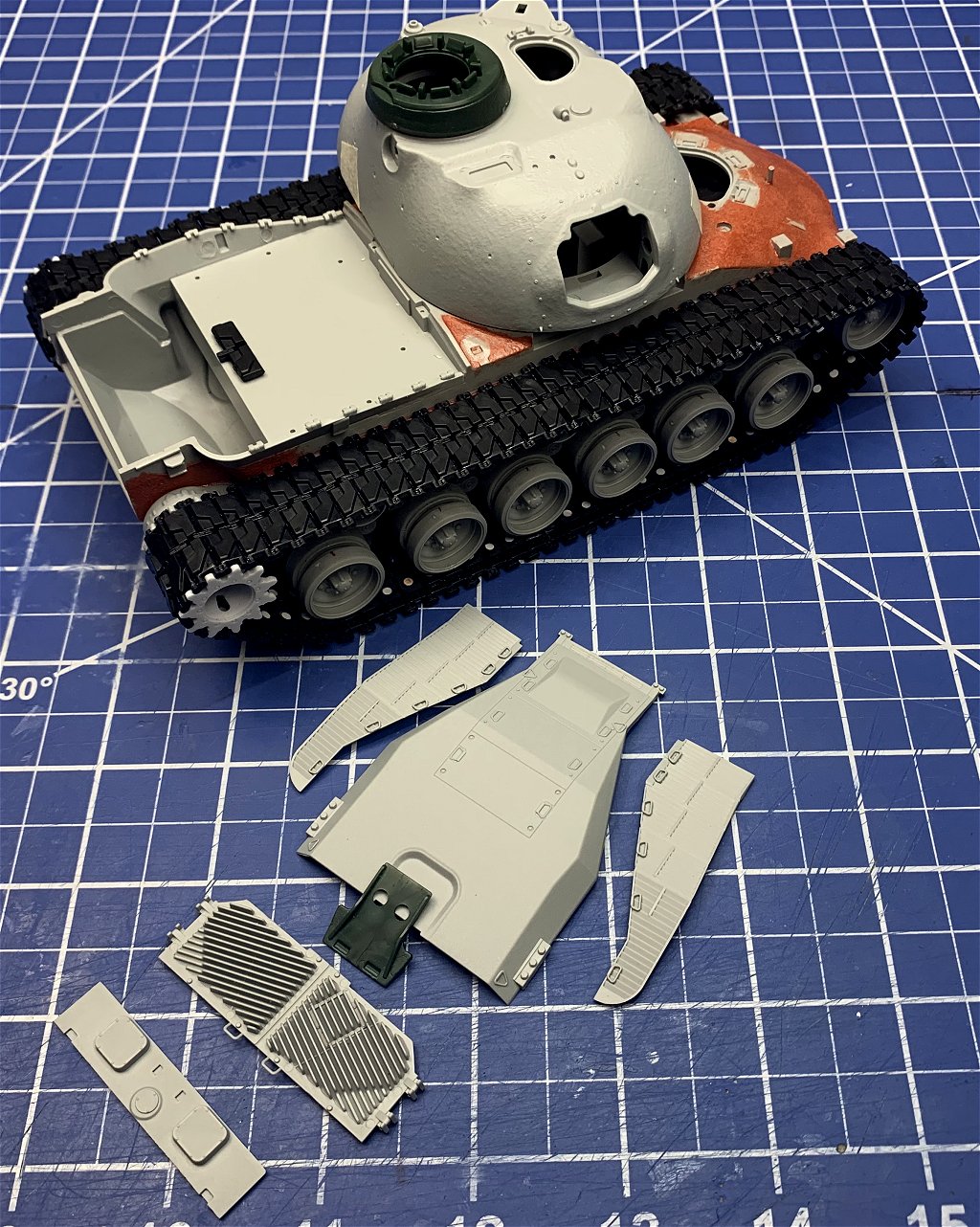

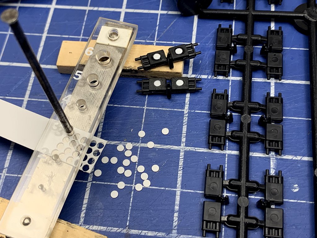

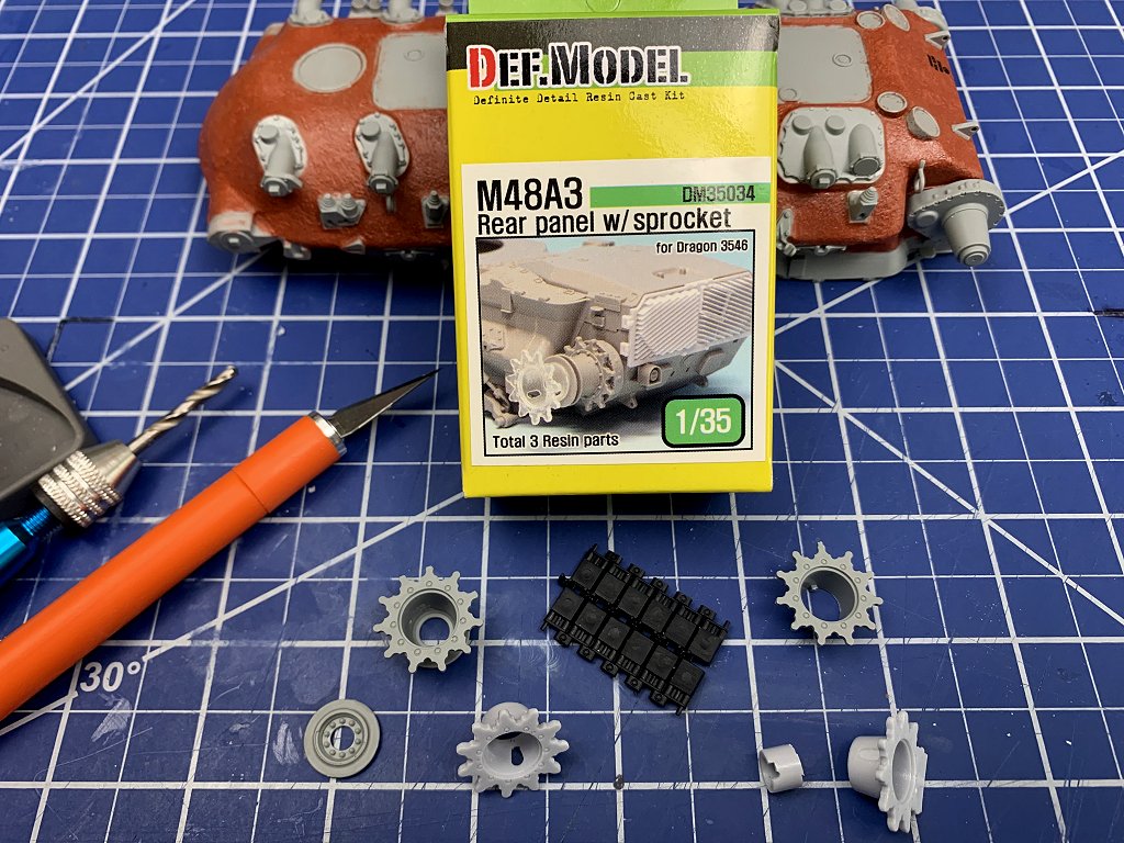

Made some great progress over the past week. Got suspension and tracks installed, in record time I might add. No real major problems other then ejector pin marks on each track link. I ended up punching out about 200ish discs to fill them, but it didn't take as long as I thought it would. Once that was done the tracks went together quite easily. Up dated the drive sprocket with one from DEF models, a little tricky but doable. The only other down side was I wanted to build up the tracks so that I could remove them for painting. However the way the kit suspension goes together didn't allow for that so I just attached them...oh well. All and all I happy with the results. Next up assembling and detailing the rear end.
