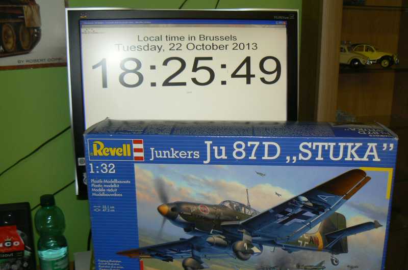

Here is my startup pics with date, not sure when i will be able to start but this is atleast a first post :)
My second airplane so don't expect any wonders here :pilot
