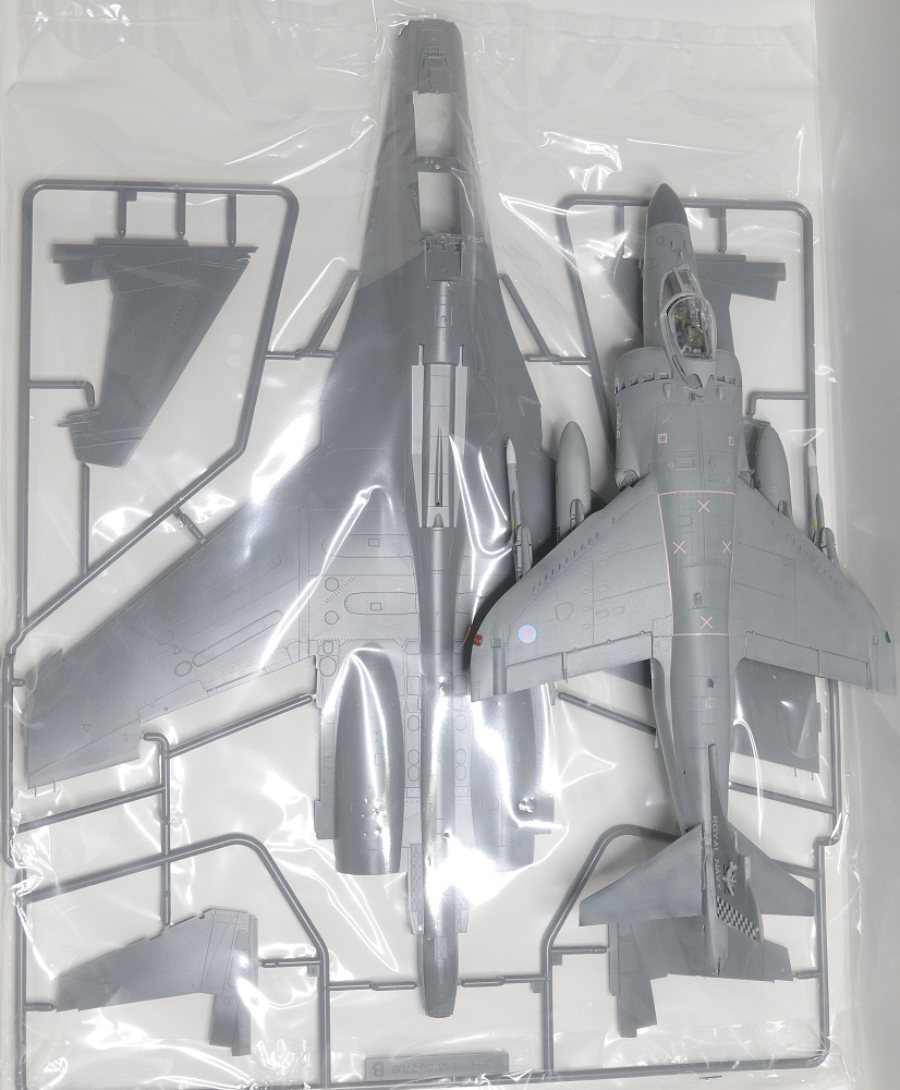

This is a large model as can be seen by comparison with a similar scale harrier which is just about the size of a SU27 wing.

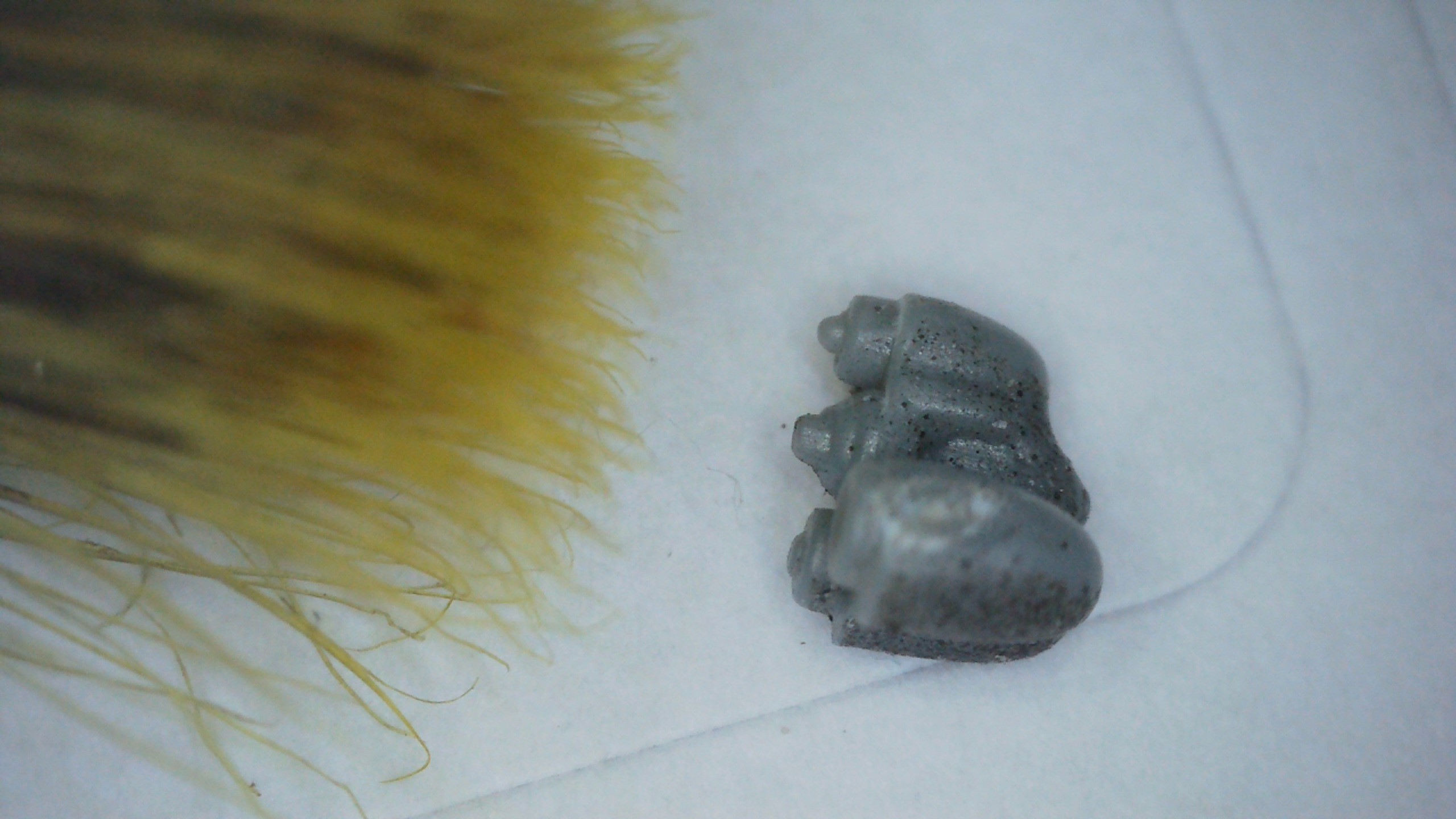

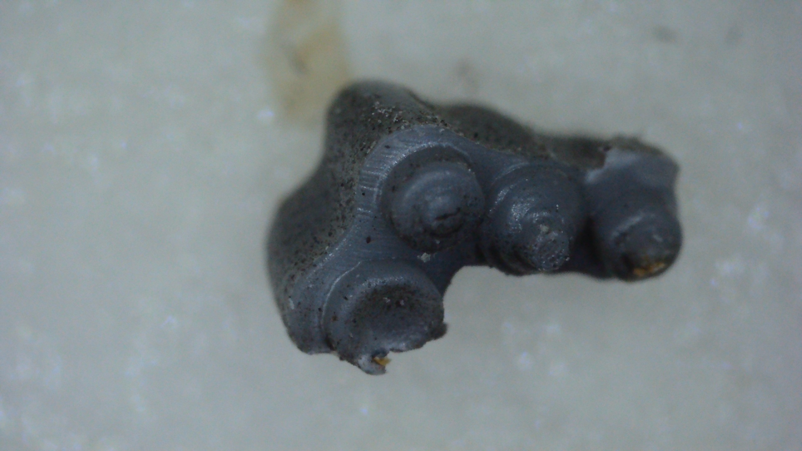

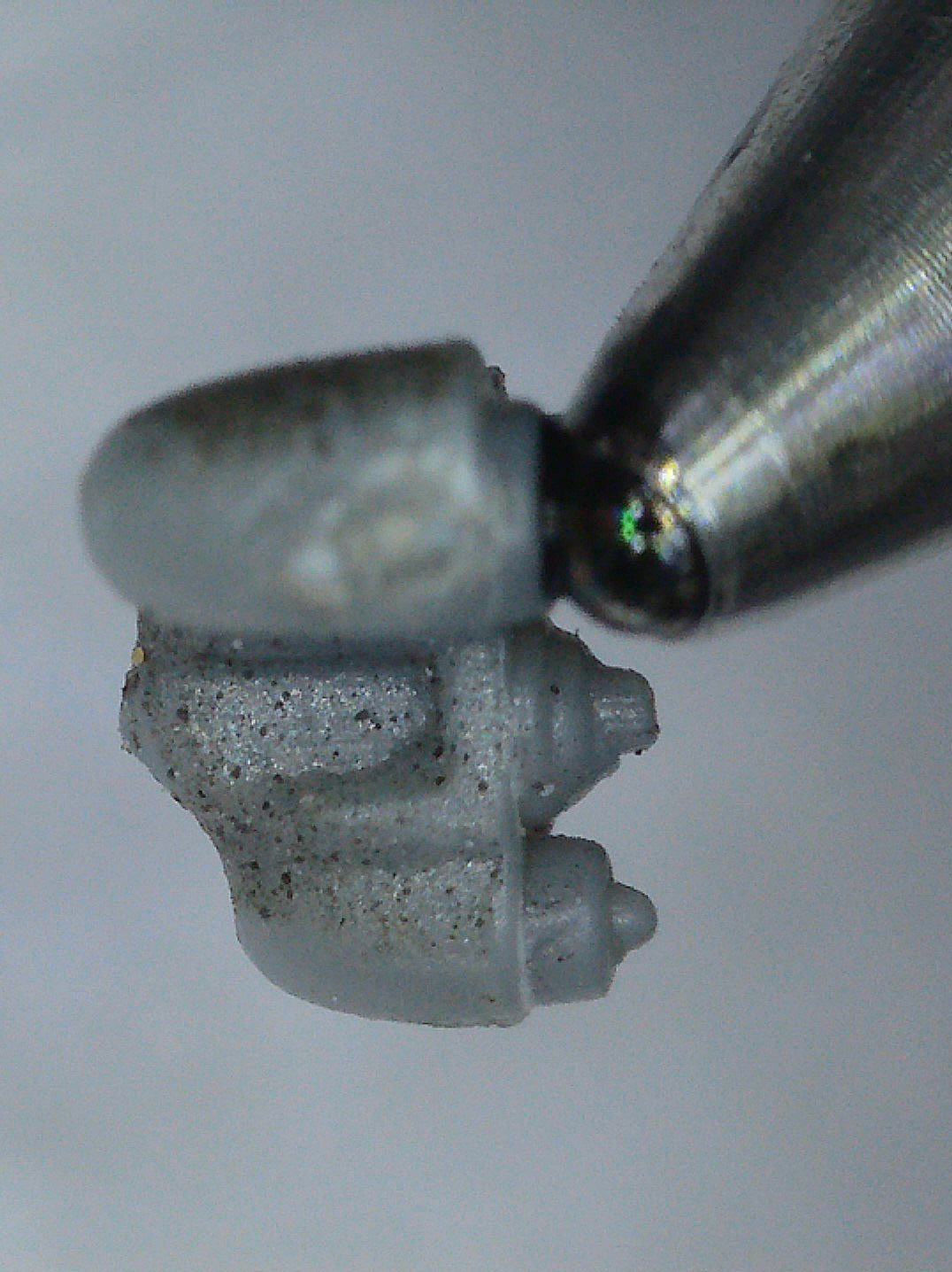

First job is paint the buttons on the joy stick top and then stick it on the joy stick
her its is
easy you say ? We are goig to need a smaller brush.........
And now its stuck on the end of my Bic biro.....
But you get my earlier point about detail with this kit :)
Yea, i had trouble finding it on the sprue and even then i have chopped half a button off :)

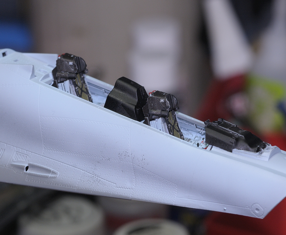

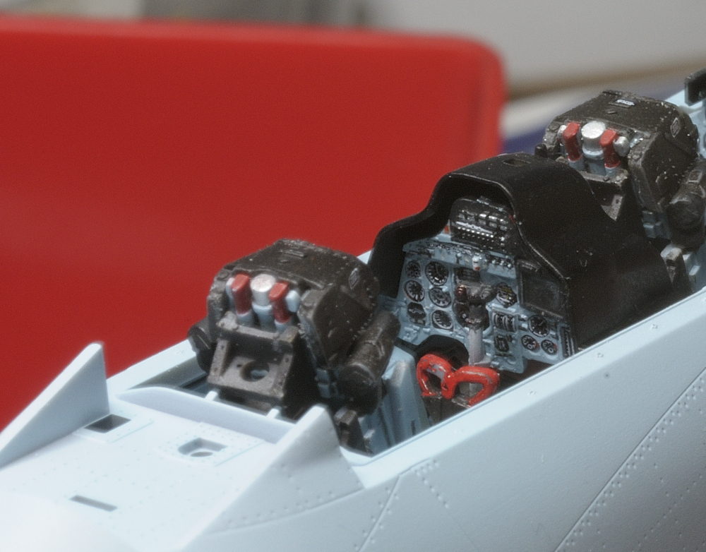

the instructions are rather like Kinetic's in so much as some phases of the build are completely missed out. This is the first time i have used decals for the instrument panels, despite the uneven surface they actually worked quite well with Micro sol..

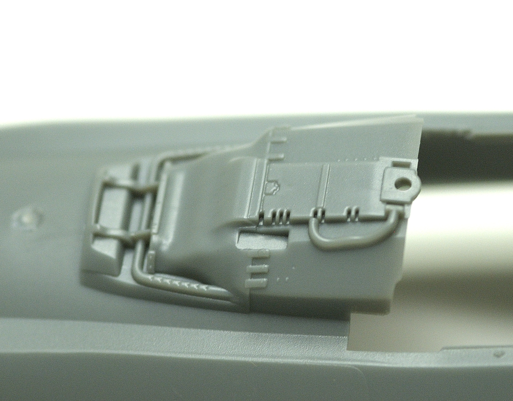

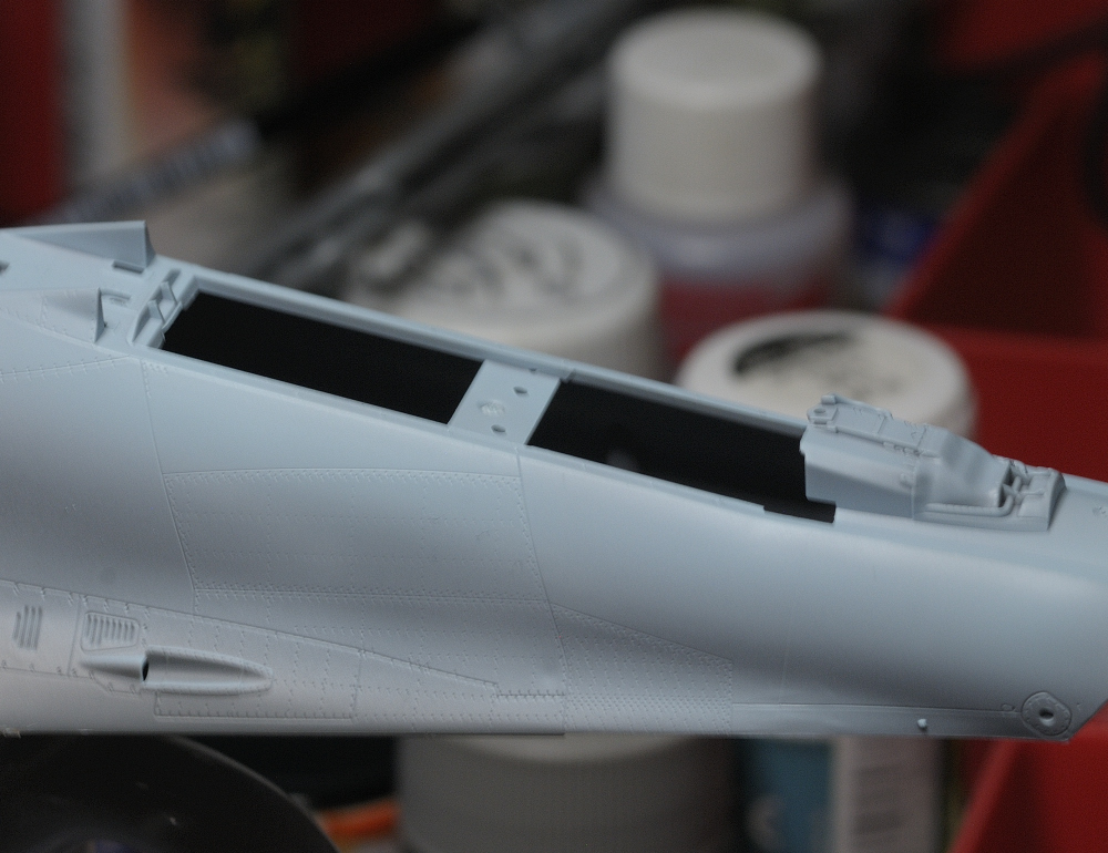

these parts are just tacked together here because...the fuselage splits top/bottom rather than the usual left/right and i need to work out what goes inside before i join the halves. Obviously the two cockpits but anything else ? the instructions dont show this part at all.

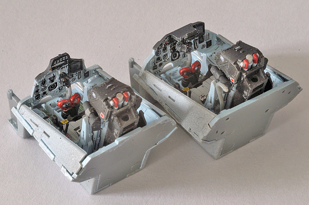

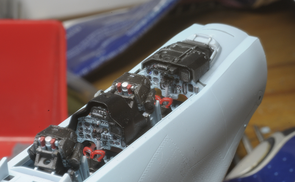

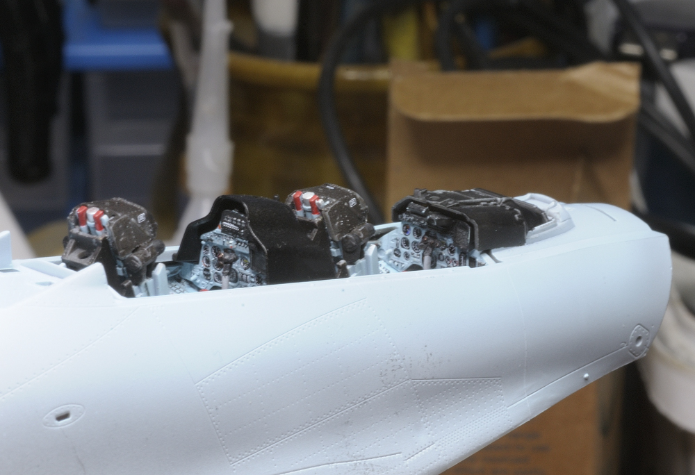

The key to this kit is forward planning, it would be difficult to fully assemble then mask and paint so i am painting some parts before assembly.
firstly though i tidied up the cockpits and fitted them after i had painted the area sky blue.

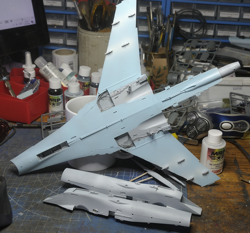

White Primer MRP
Ukrainian underside blue
the blue varies a bit as its under Florissant light but this is pretty well spot on taken inn daylight

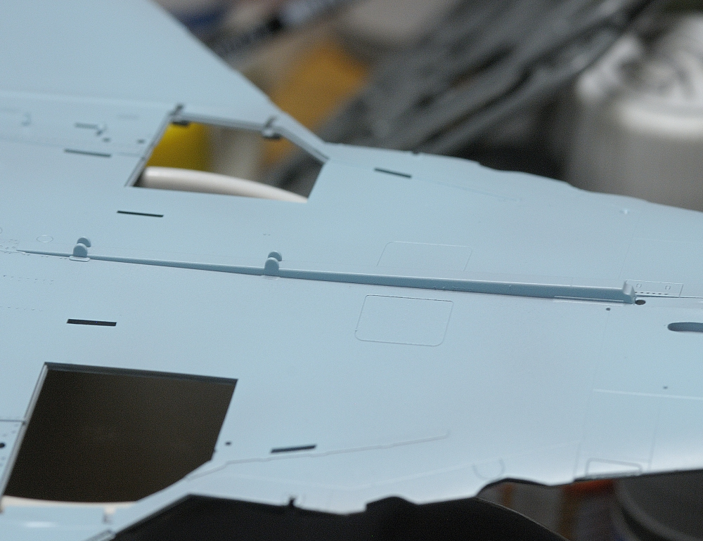

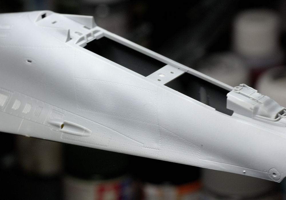

As i mentioned the kit splits top and bottom, not left right as usual and this is the under wing. the kit has no ordnance, not even auxiliary tanks so its going to be pretty plain underneath. I think GWH do an ordinance kit for the SU33 which would probably work but its near £65.00 or another $77usd and in any case this is a OTB build.
My guess is this is modelled on the airshow aircraft and all the pictures show it clean so thats what they went with.
This build is 75% paint and decals, parts count is quite low. I'm still finding my way with order of assembly and in particular order of painting .

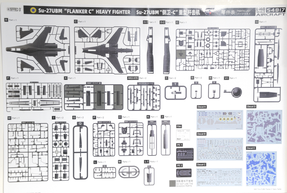

if i was given this model in a plain box i would say Chineese. There is a trend now in a lot of Chinese's made goods to be pretty high quality and highly presented but they just cant do English translation and its like the concept of needing to supply instructions is completely alien. Its a minor complaint but how hard would it be for GWH or Kinetics to actually get someone from the west to proof read thinks before they go off to the printer ?
I have some hard point pylons, shown as used in the sprue pictures but not shown in the instructions ? and i have PE parts shown as not used/shaded in the sprue pictures which are needed in the instructions and again a few steps that you need to fill in yourself :)

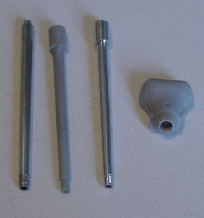

GWH (Great Wall Hobby) is a product of the Chinese company LionRoar. They only produced aftermarket (1/35th scale tools, Barrels, PE, stands, and bases) and then started releasing limited run kits (nebelwerfers) followed by their first full kits of the sWS series.
