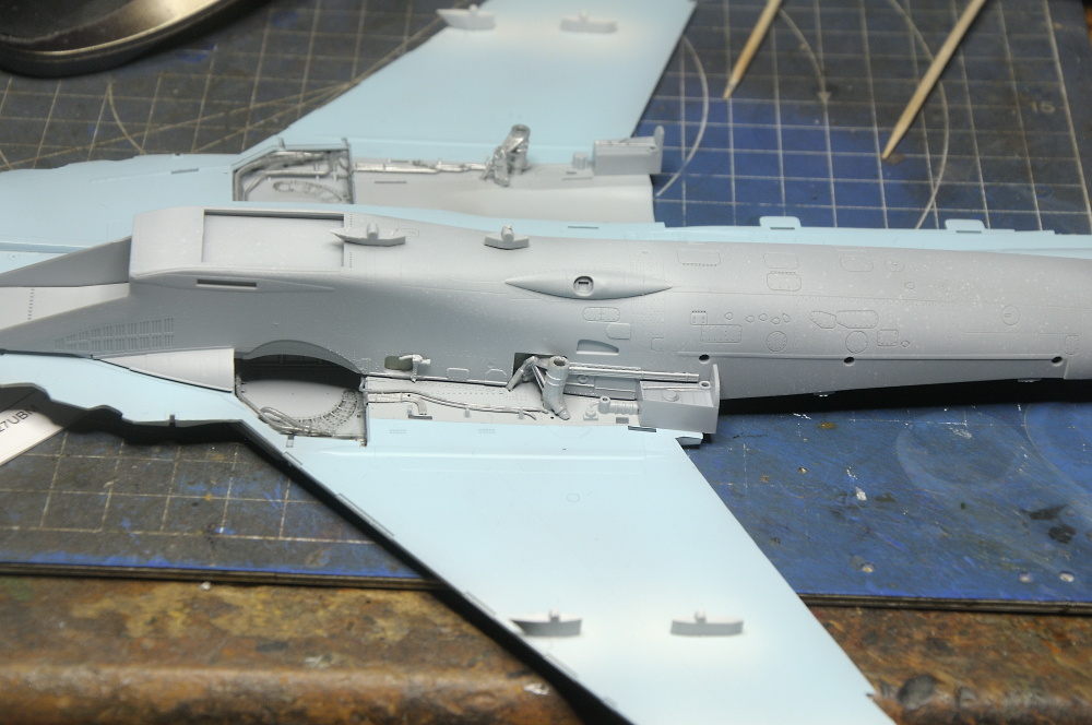

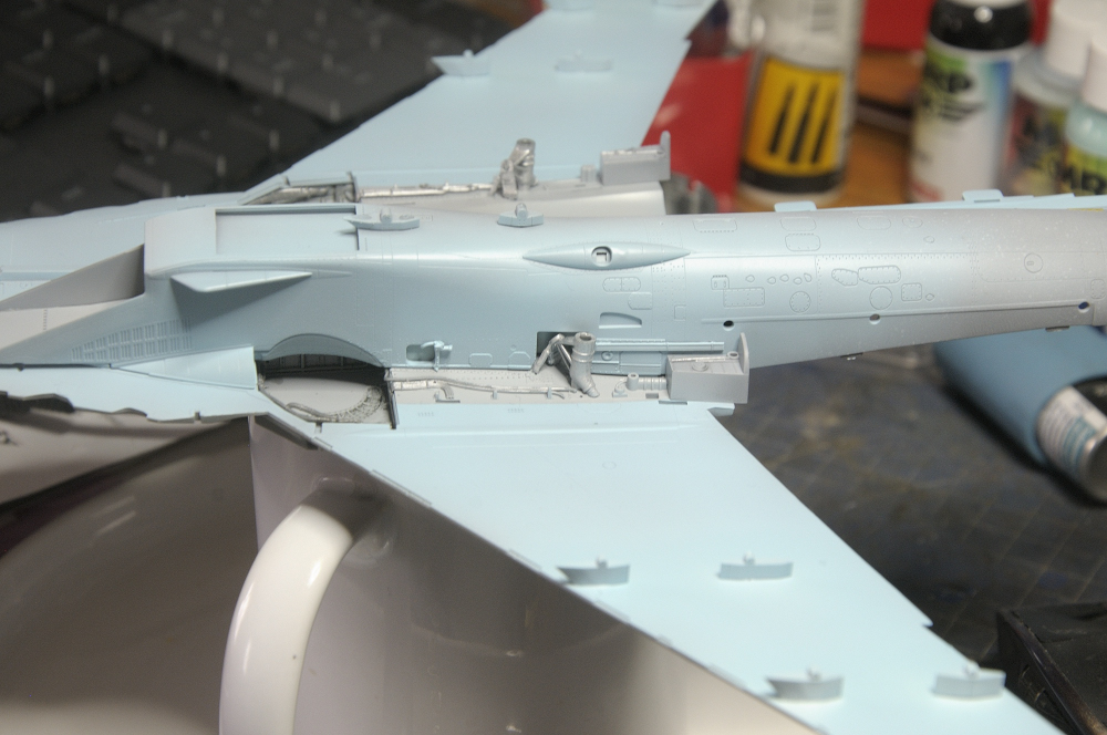

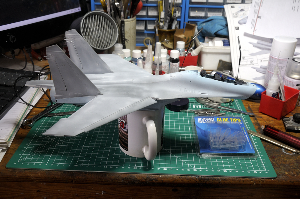

Plan ahead
If you assemble like this
How am i going to paint that engine cover without spraying the grey undercarriage bay and parts ?
So paint it first. At least round the parts you cant get to before
. Might seem obvious to most but i am used to assembling masking and painting and thats not going to work here.

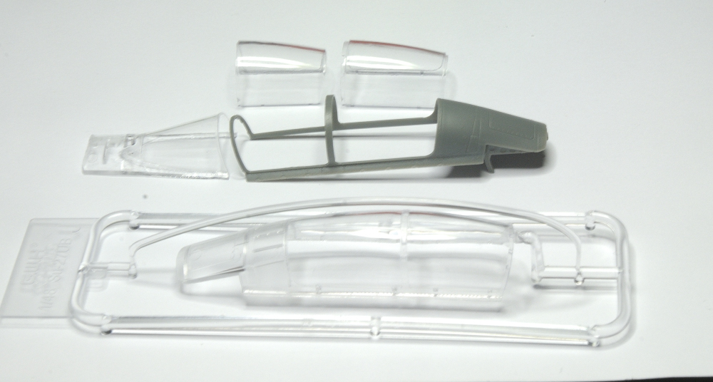

Although no mention is made of this in the instructions you get two canopies, a on4e piece ad a build up option

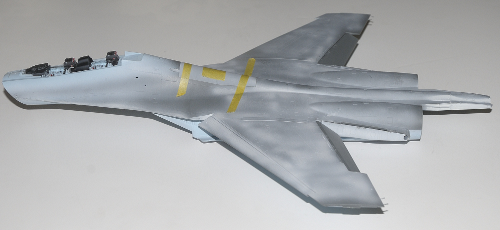

Engine nasals are now on with slats and flaps, its quite a simple kit ojnce you have worked out the painting TBH
Instructions do say slats and flaps are both dropped when parked.

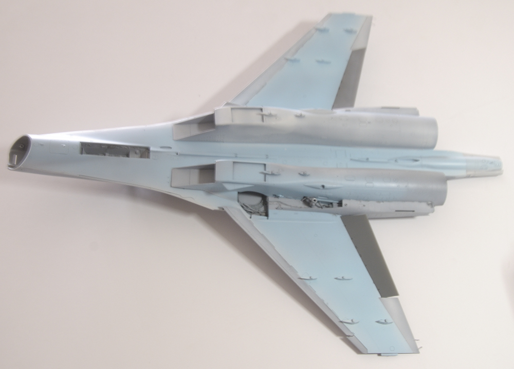

Work is very slow here. That said, its not a race :) its all about the paint. Gone are days where i blasted a Harrier with one coat of Tamiya. Now I'm looking at 10 coats , 5 each of primer and top coat. its boring but the paint finish is a bit special. I have learned that paint is not just paint :)
Only draw back so far is this stuff doesnt brush, its thinner than water and so is its pigment. This means if you want to touch up a chip or missed part you are going to have a the airbrush out
In short i have had to re think my methods and trusted build order and up my game several levels.

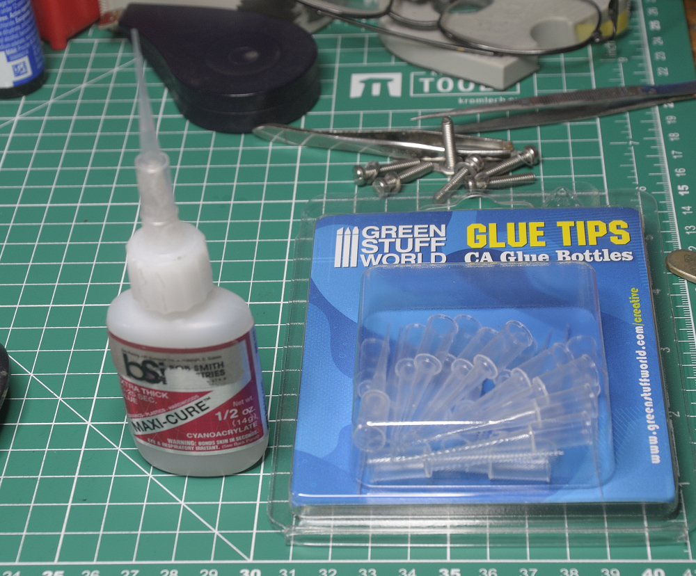

On a different subject i came a cross these this week. CA glue is good until the nozzle bungs up and you either have to cut it off leaving an ever enlarged hole or throw it away as the lid is welded solid to the bottle. With these really fine tips you dont actually need a lid as the hole in the tip is so fine the bottle can draw the fluid in the nozzle back down as you stop squeezing. Great for accurate pin point application as well. these will pay for themselves in saved half bottles of CA.

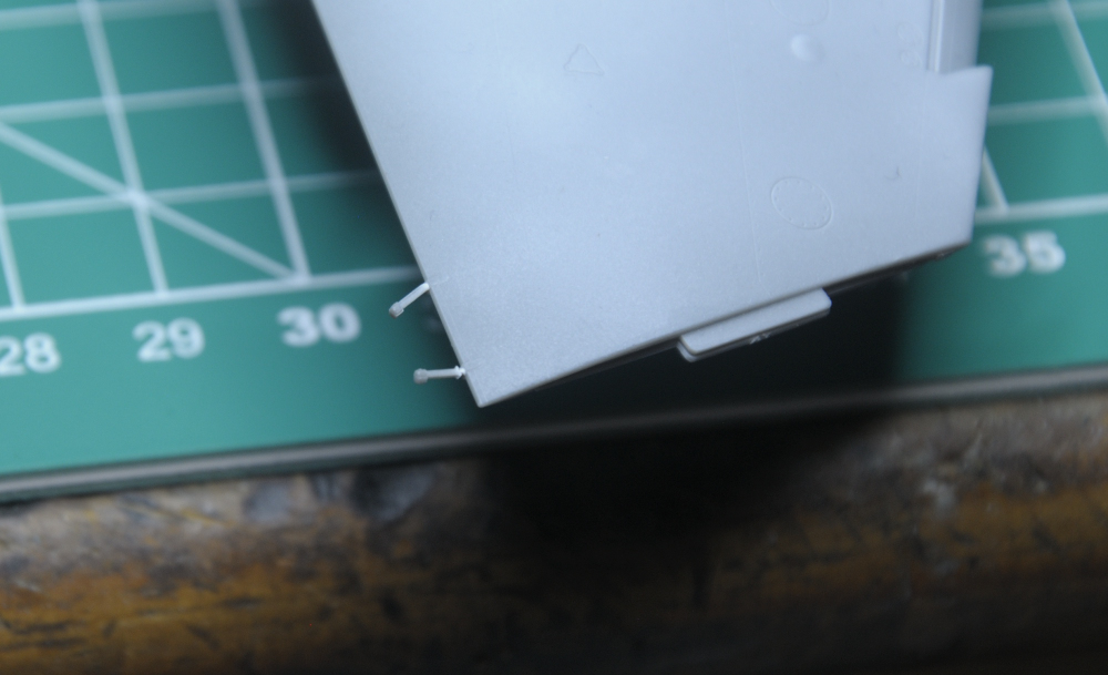

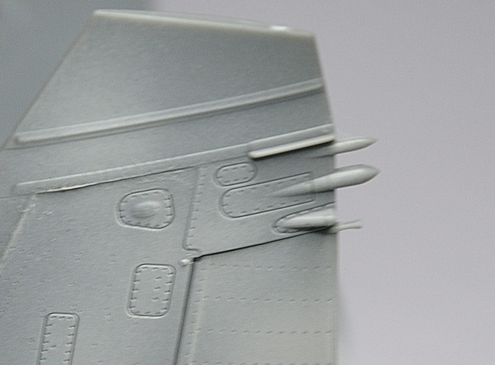

aerials ? on fins and wing tips etc are so fine they are destroyed with handling so they will be drilled out and replaced with .004" piano wire ( i hope if i can drill the trailing edges without slipping off)
aerials ? on fins and wing tips etc are so fine they are destroyed with handling so they will be drilled out and replaced with .004" piano wire ( i hope if i can drill the trailing edges without slipping off)View attachment 158300

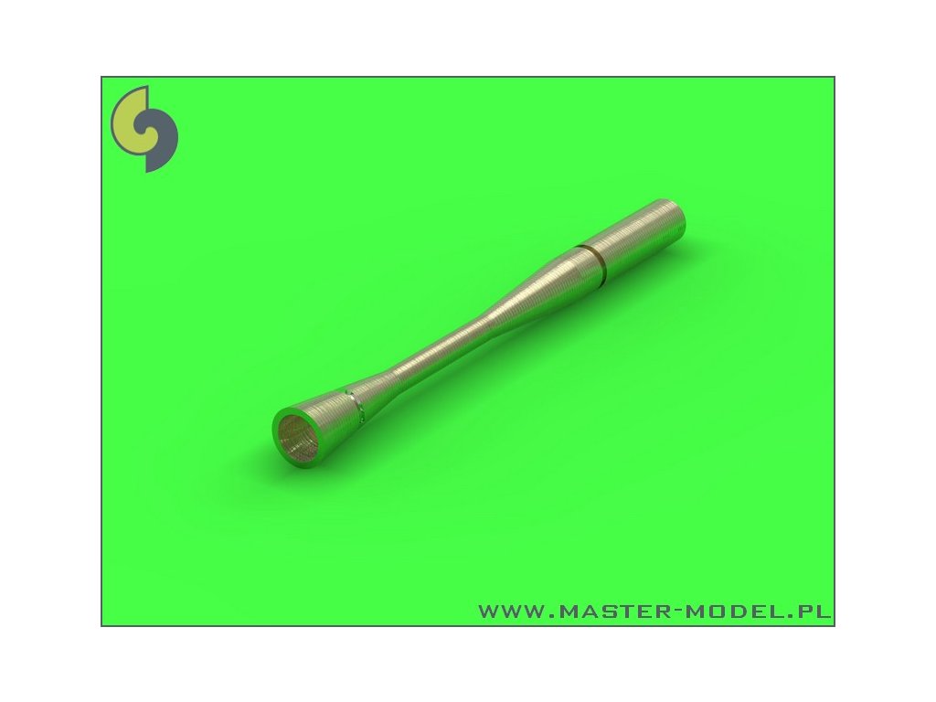

Anti-static wicks with MiG and Sukhoi having a slightly different end shape.
Master makes a crazily accurate set of 14 in 1/48th scale from turned brass.
thanks for that
the bits that break off are much smaller than those.
Its the third one down thats the problem and these are also on the wings These are way to small to reproduce in brass, maybe about 5 thou of an inch
thanks for that
Well, I have them for the MiG and can tell you they are that small!
