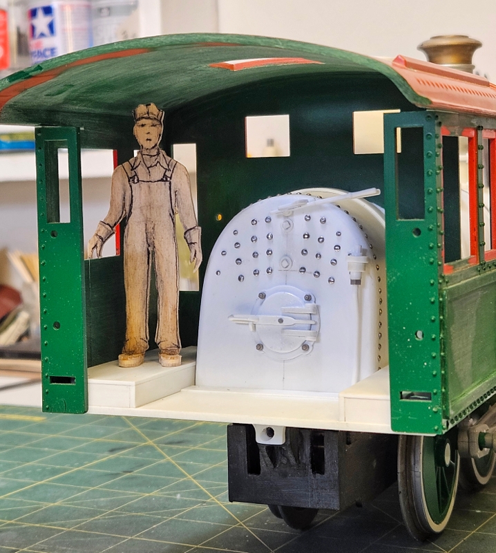

I spend a lot of time on this project contemplating how adding details will effect the functionality of the model. The detailing will be sacrificed for ease of getting to vital parts like the motor, gearbox and wiring, etc.
I'm overbuilding as well, everything, including the smallest details are thicker to withstand handling.
The cab shell can be removed from the cab floor, which also is removable from the frame.
I decided it was safe to glue the boiler backhead on to the cab floor. Then I added the raised floor panels on either side. The engineer and fireman's seats attach on them. The bulk of the cab detailing, throttle, brake, reversing lever, piping and gauges will be permanently attached here. The whole thing will be removable from the frame.

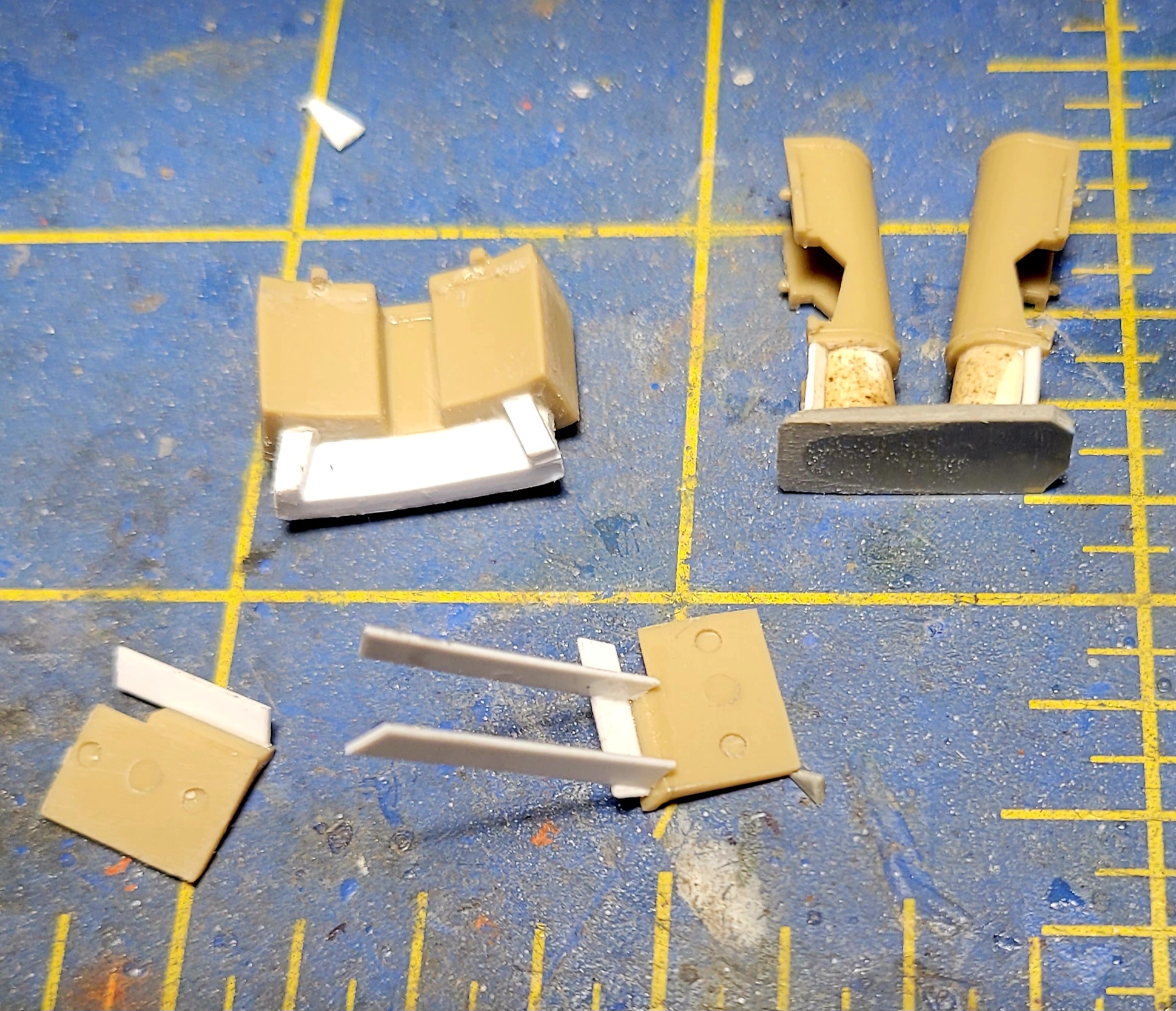

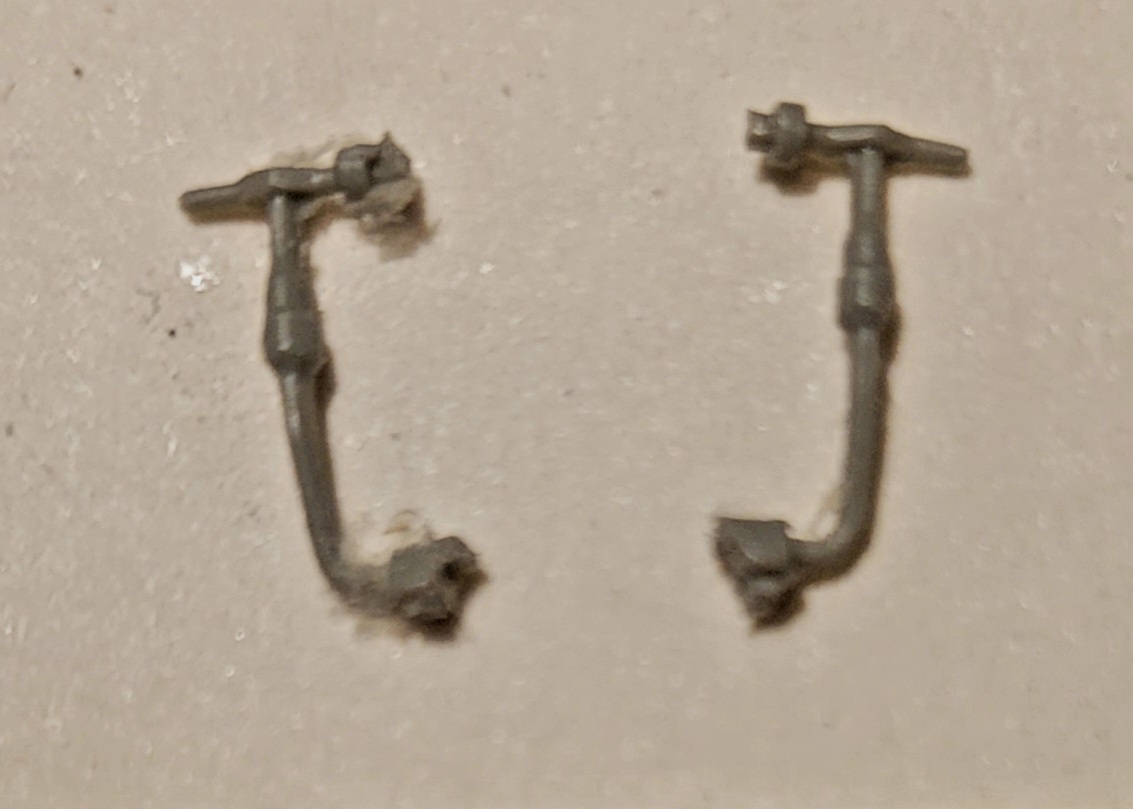

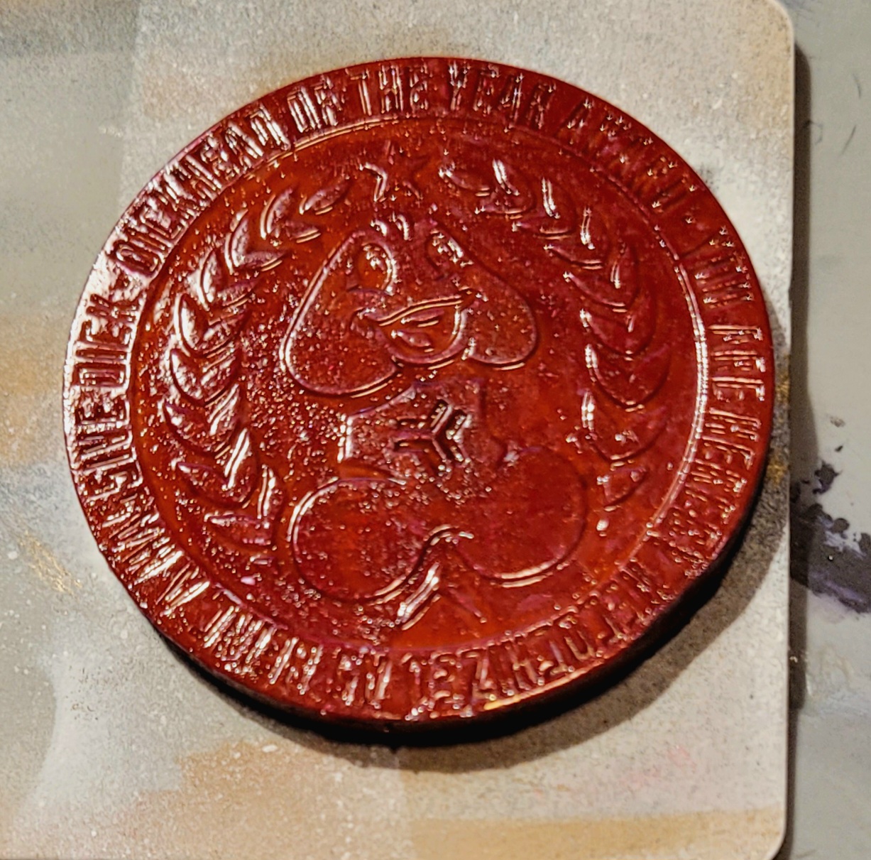

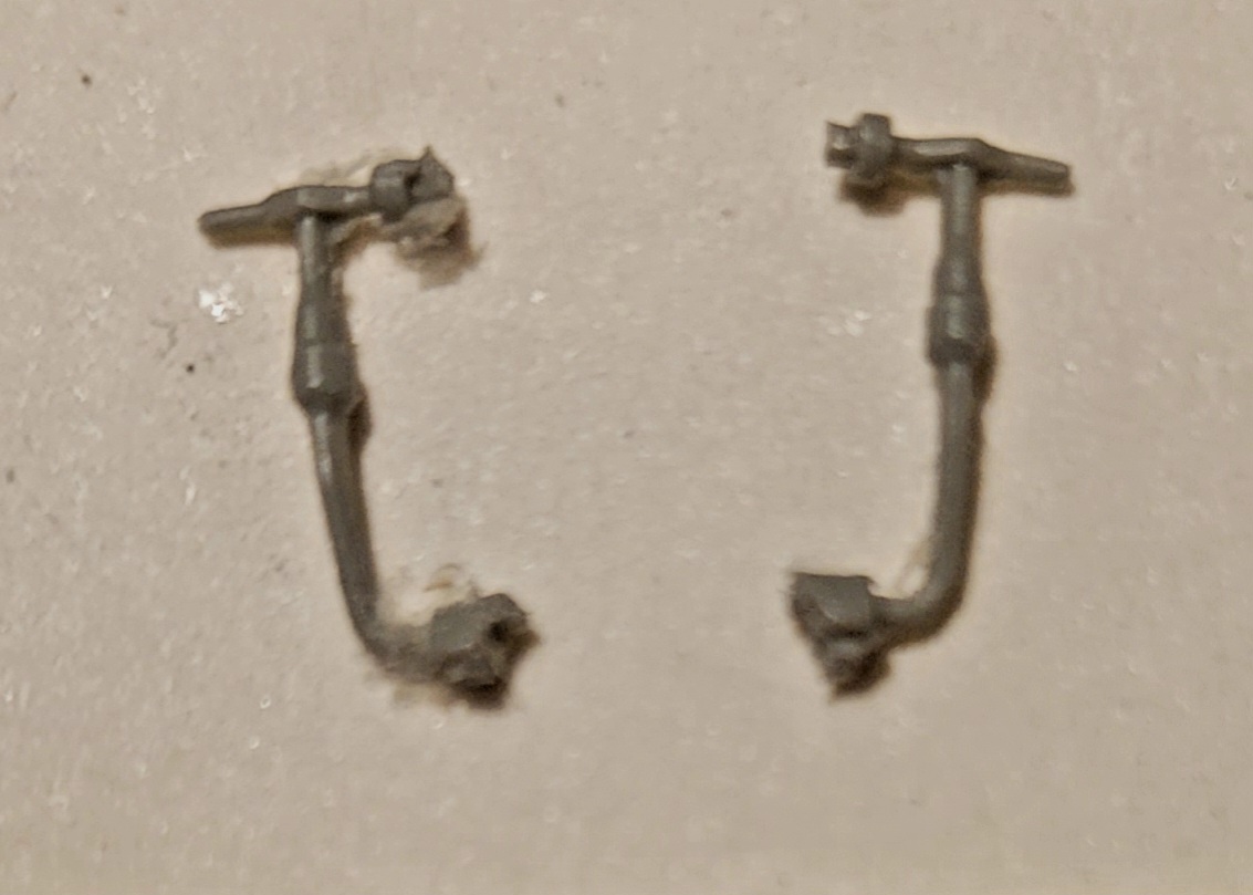

Almost Every TLAR Model begins as a precise plastic Master, molded in RTV Silicone and cast, under 60 pounds of air pressure with liquid polyurethane plastic. This makes a very high quality, bubble-free "resin" model kit. I build my own models, so I can write illustrated instructions, in English. This began in June of 2015. The website is younger.

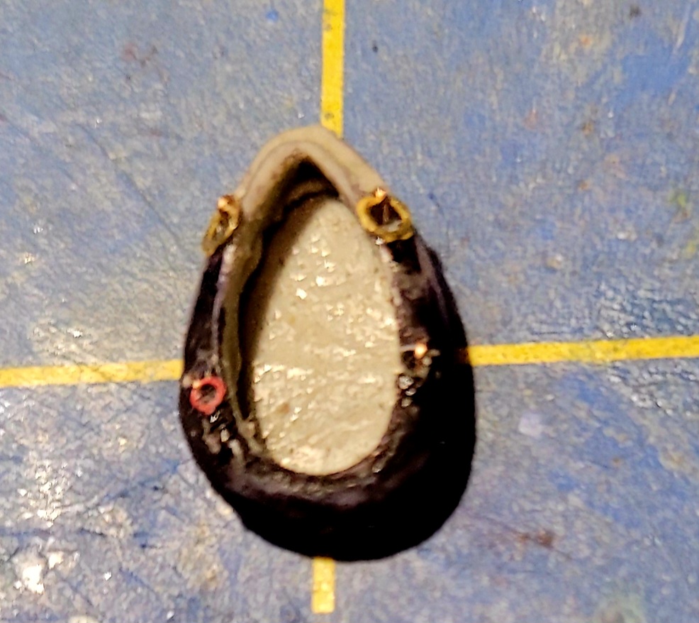

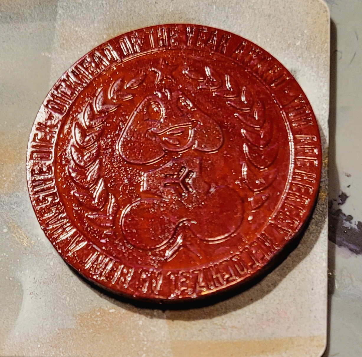

I have molded and cast a few items as favors. 1/48 AH-64 wind indicators, rear fenders, exhaust cuffs and turret bin for 1/72 Tiger1 kit and more than a few token coins. These are bald-faced copies and cannot be sold. They are also not very complex. See?

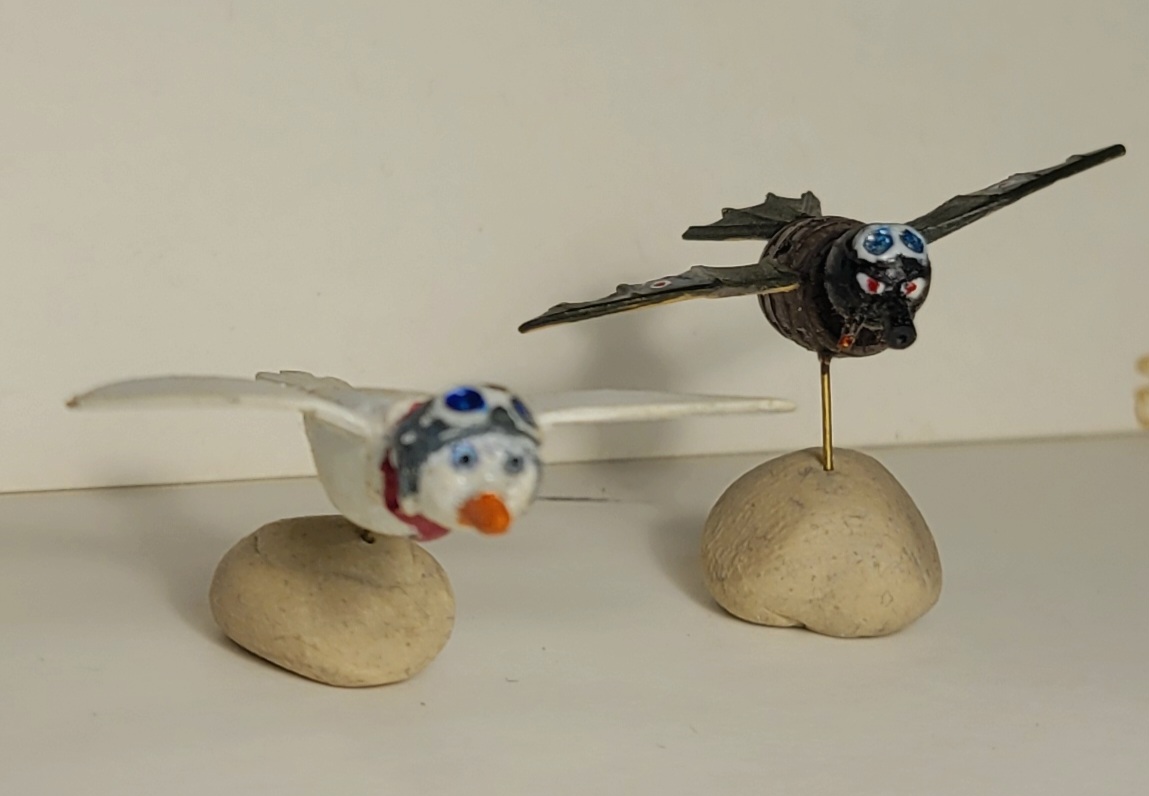

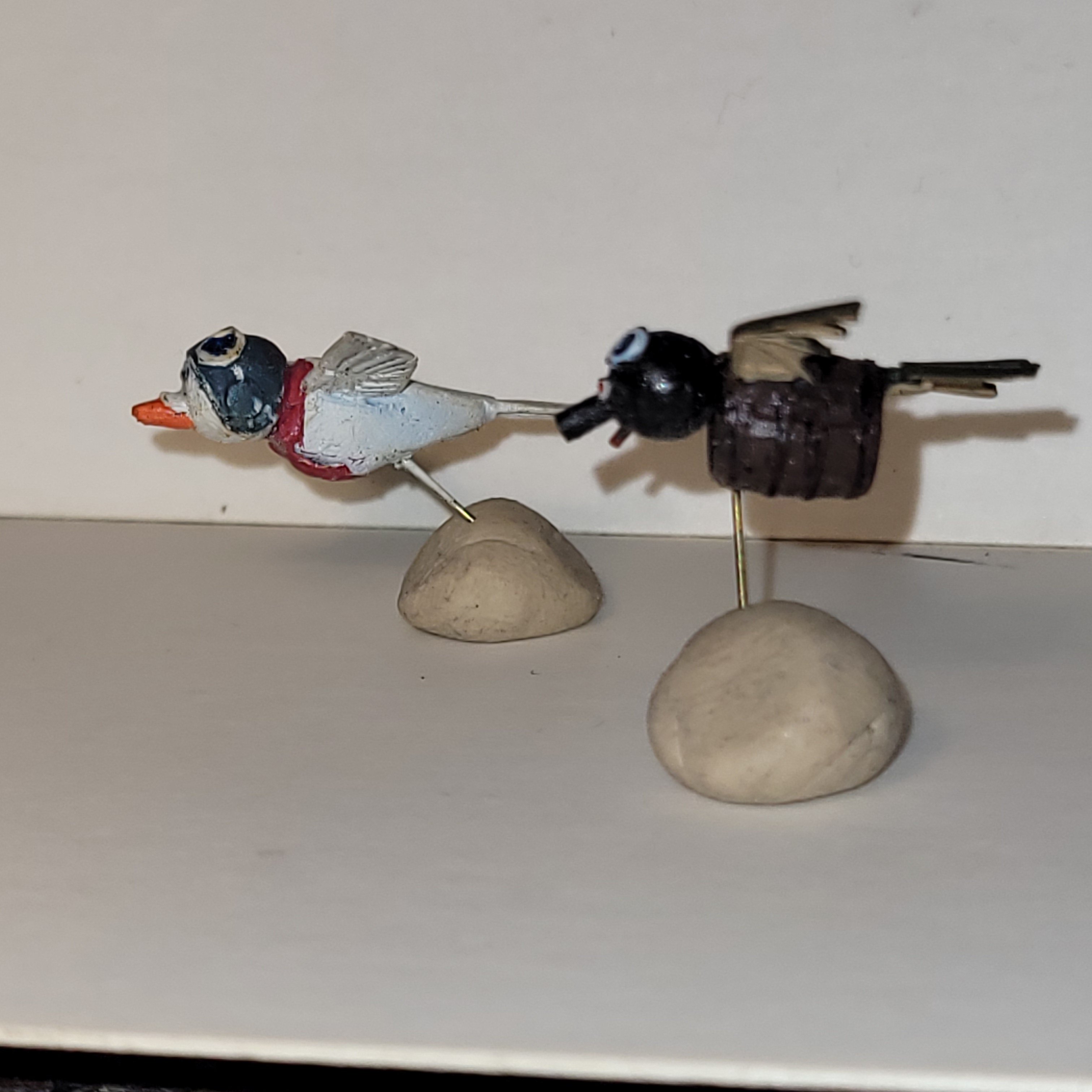

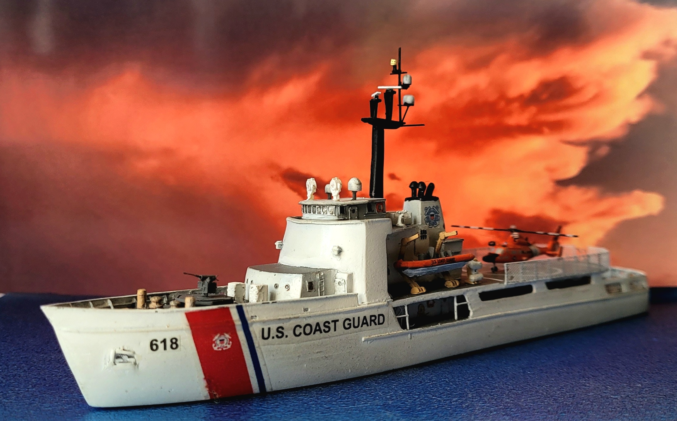

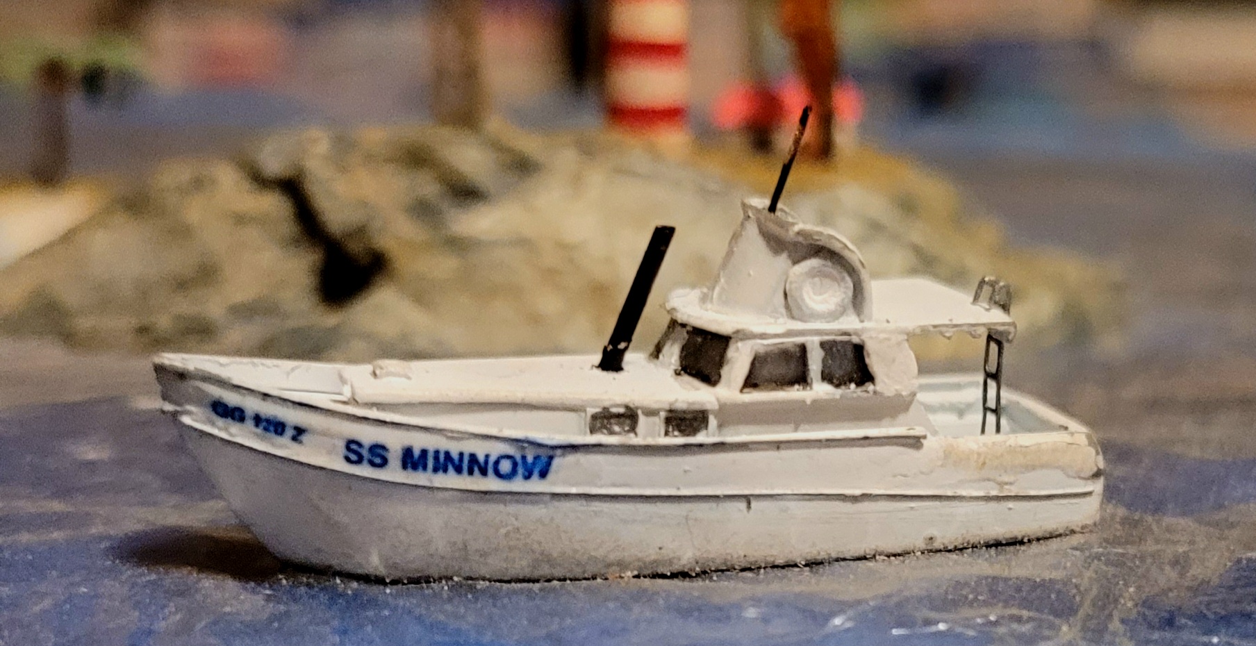

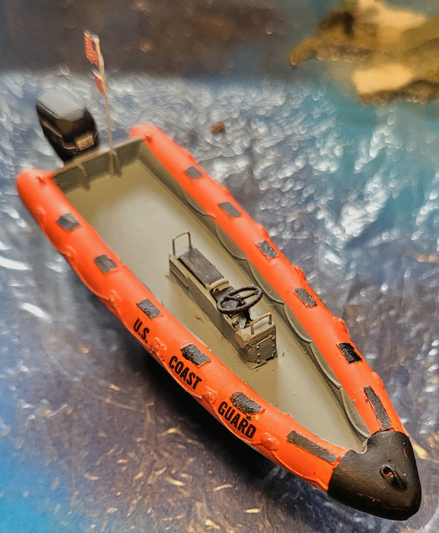

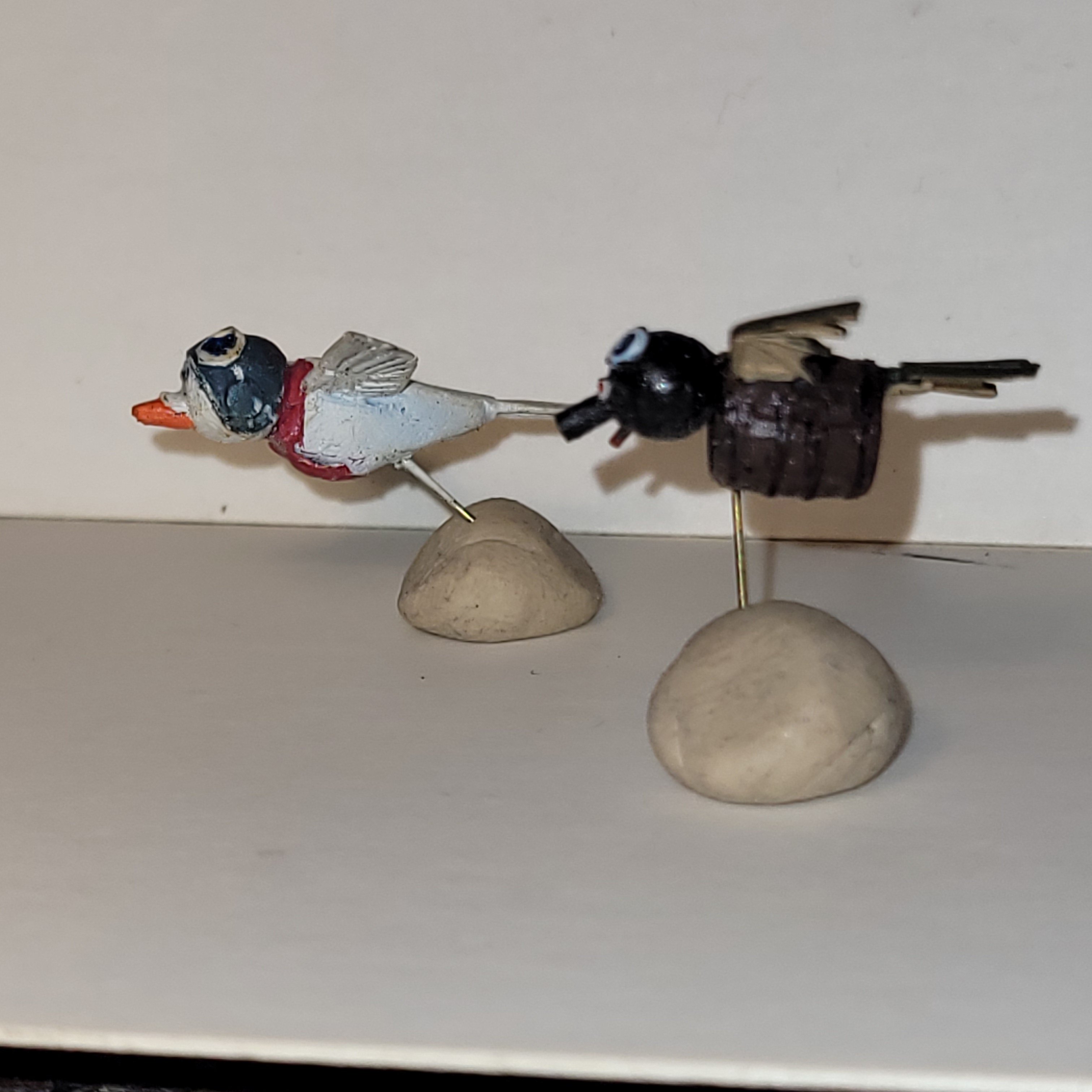

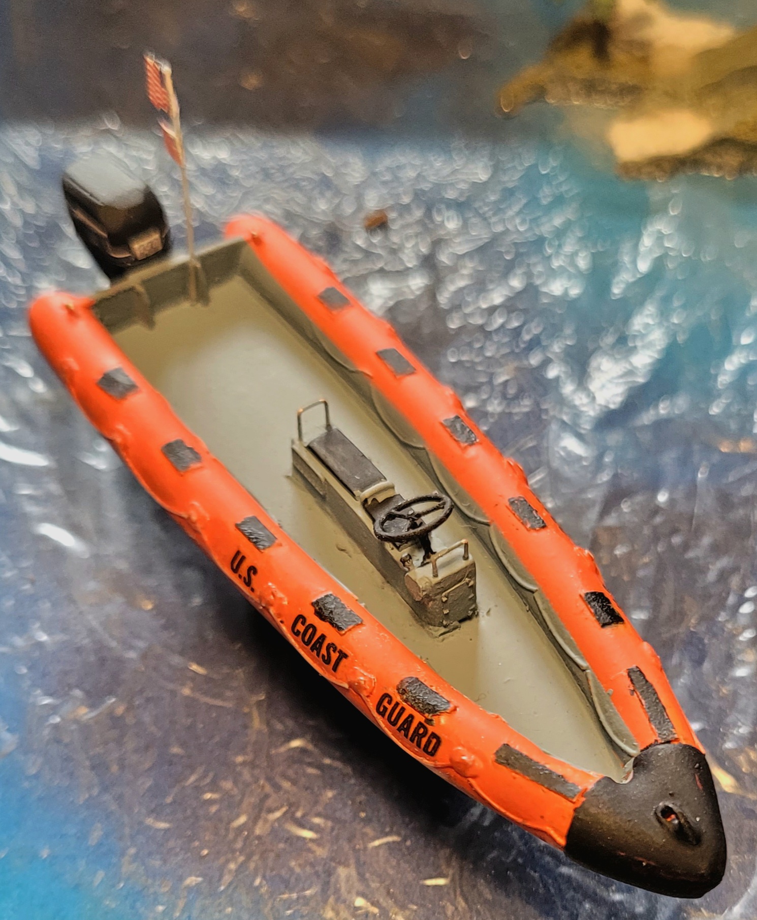

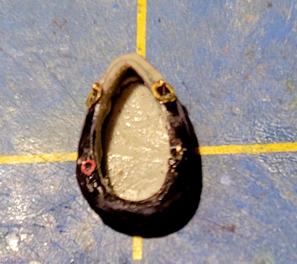

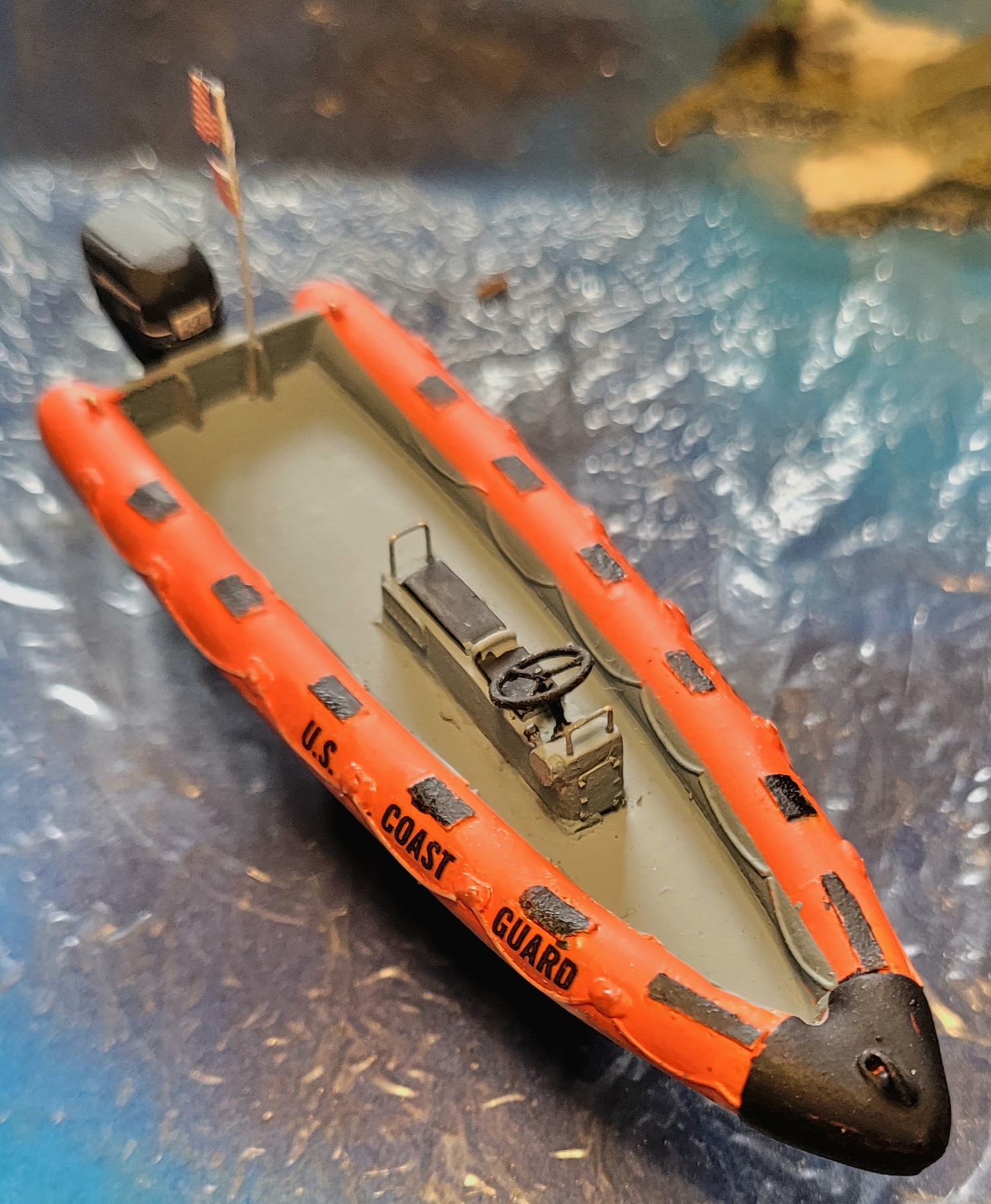

I have done a few model projects by customer request. 1/35 horse collar for a StuG IIIb model, 1/32 Yankee Doodle Pidgeon and his Bomb-a-kaze decoy drone sidekick, 1/350 USCG Reliance class 210' cutter and (Not) SS Minnow and the 16-foot rescue boat for a 1/72 scale Island class Coast Guard cutter model.

View attachment 178052View attachment 178054View attachment 178056

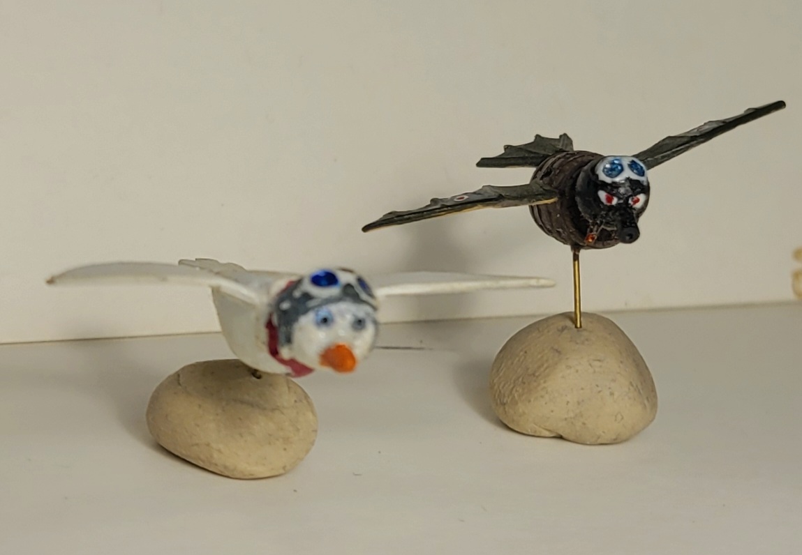

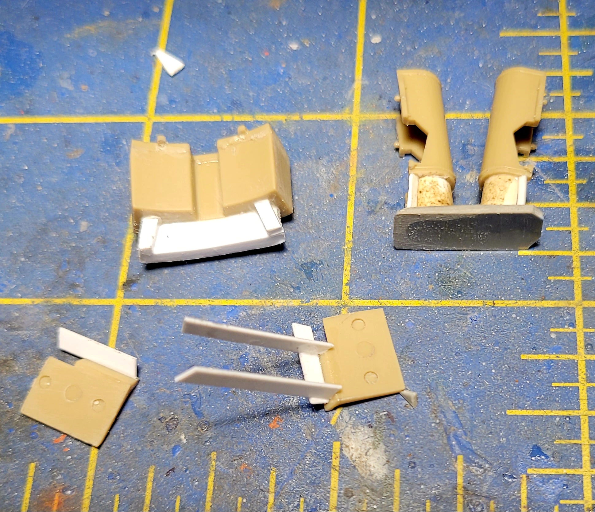

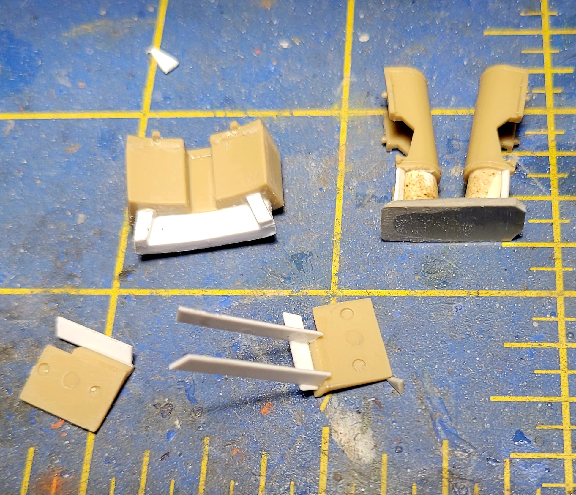

View attachment 178057View attachment 178058View attachment 178059View attachment 178062View attachment 178061View attachment 178060

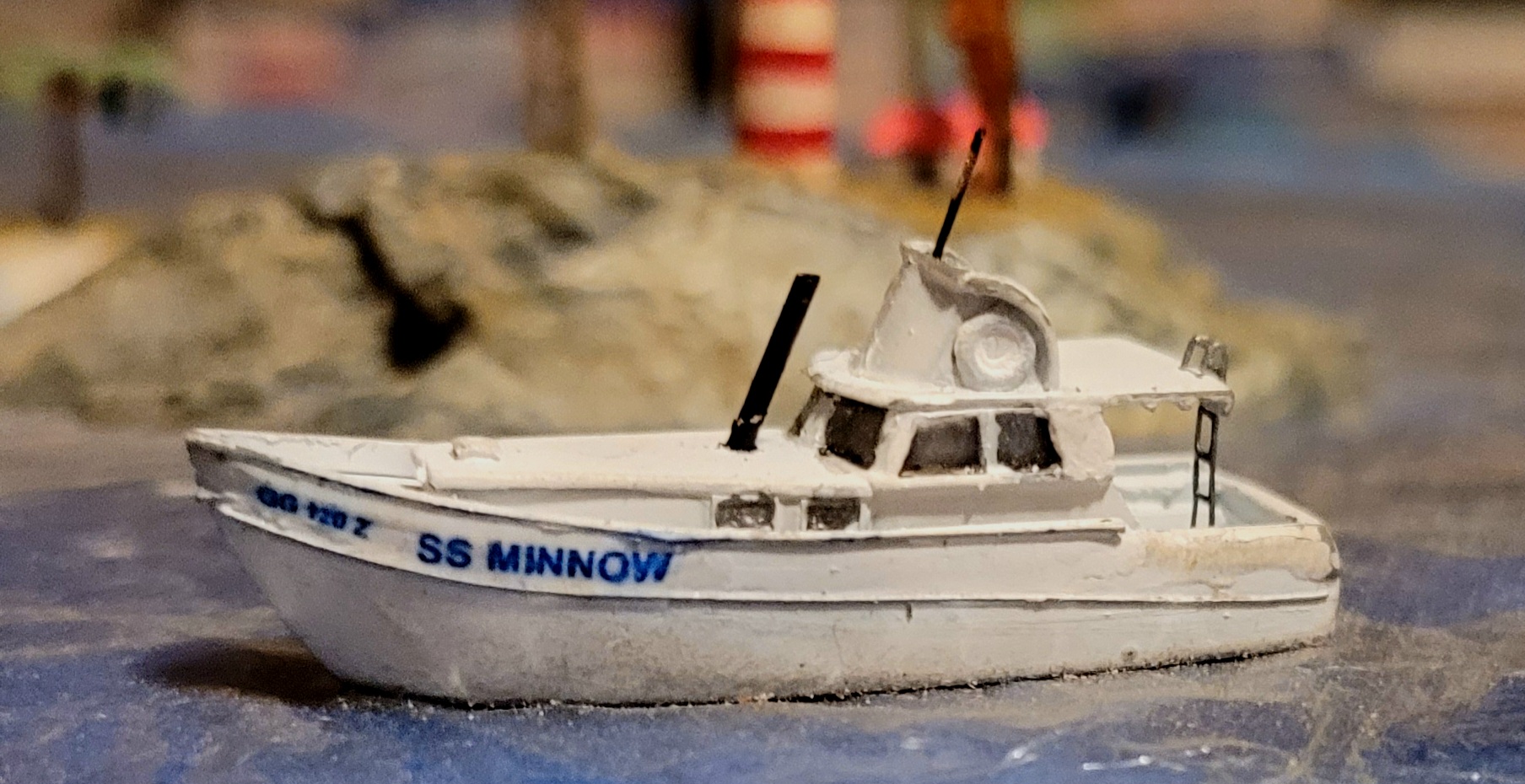

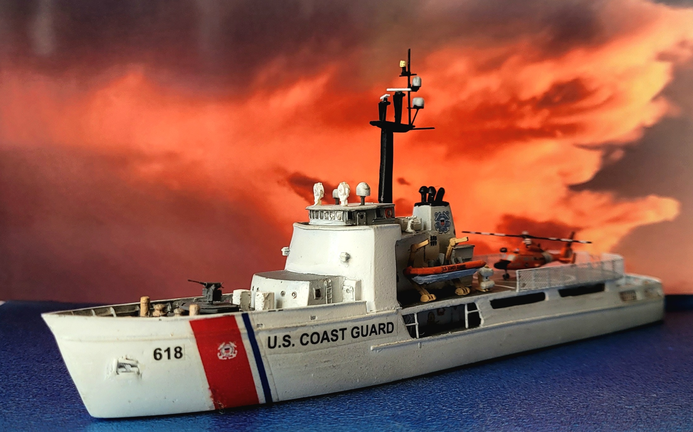

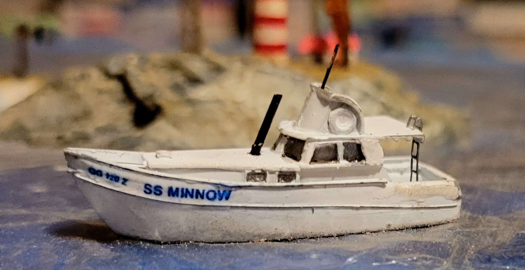

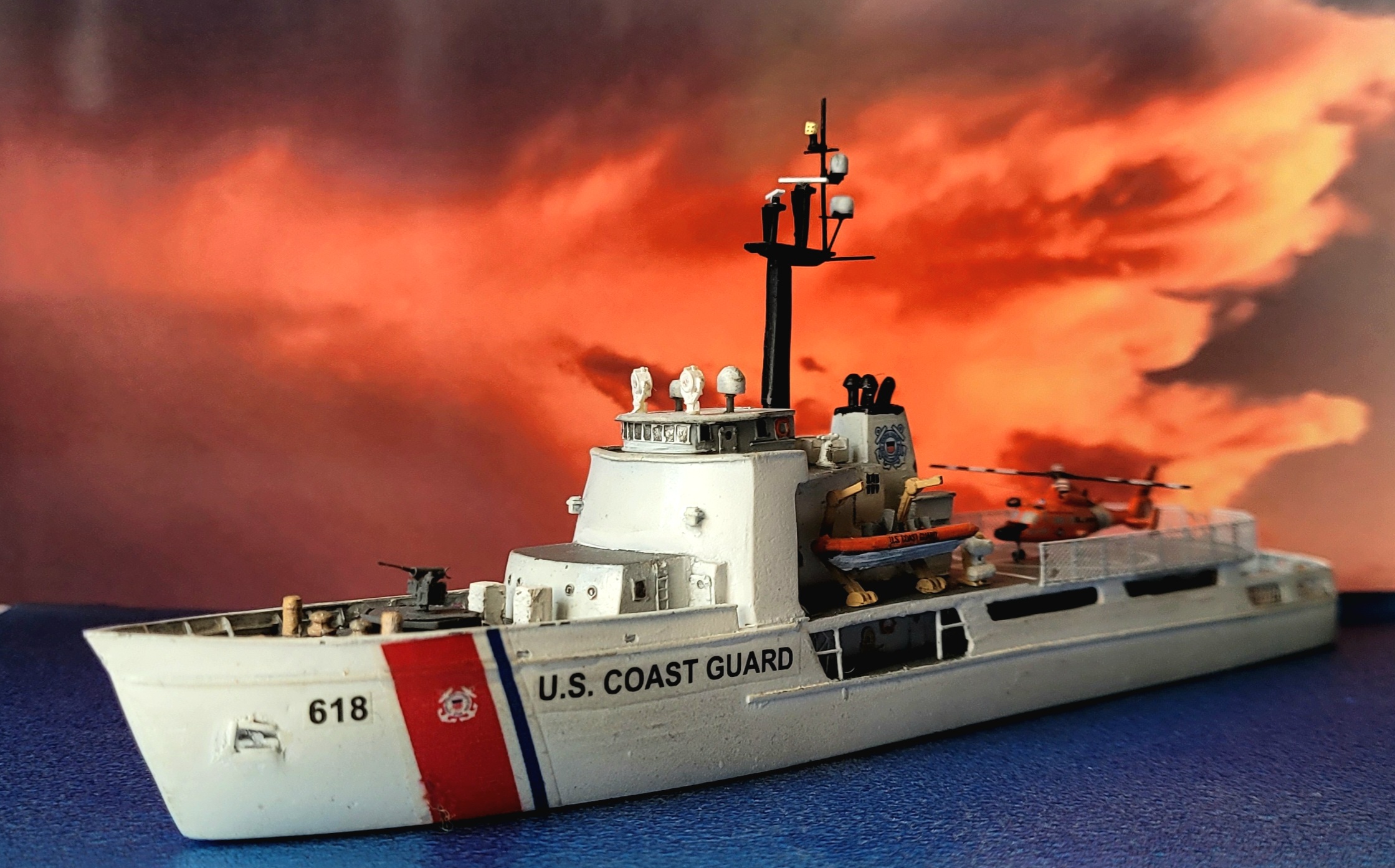

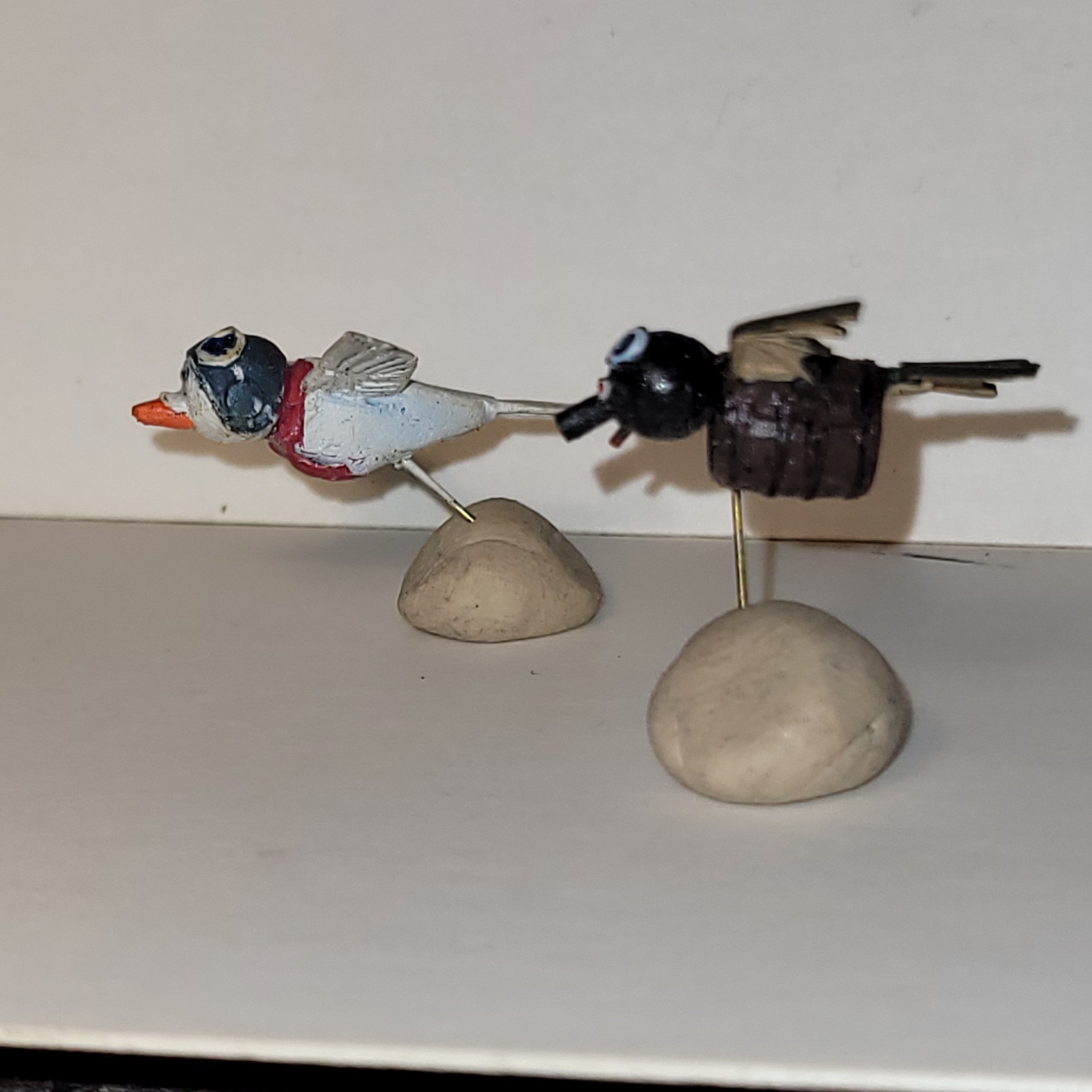

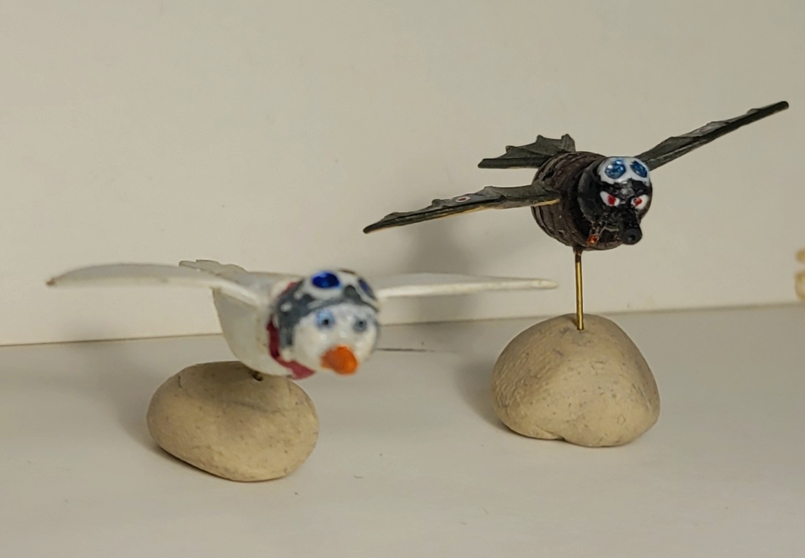

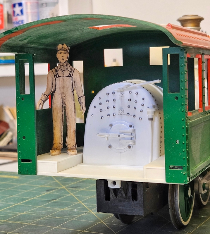

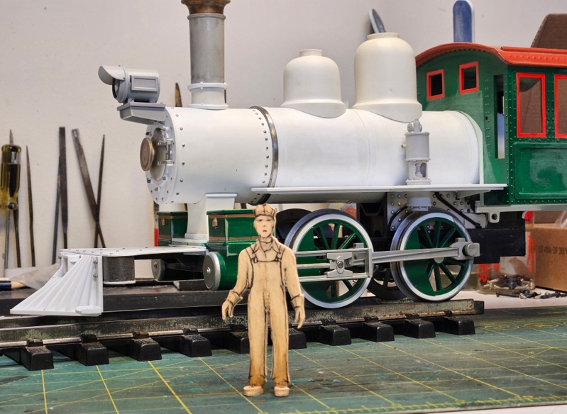

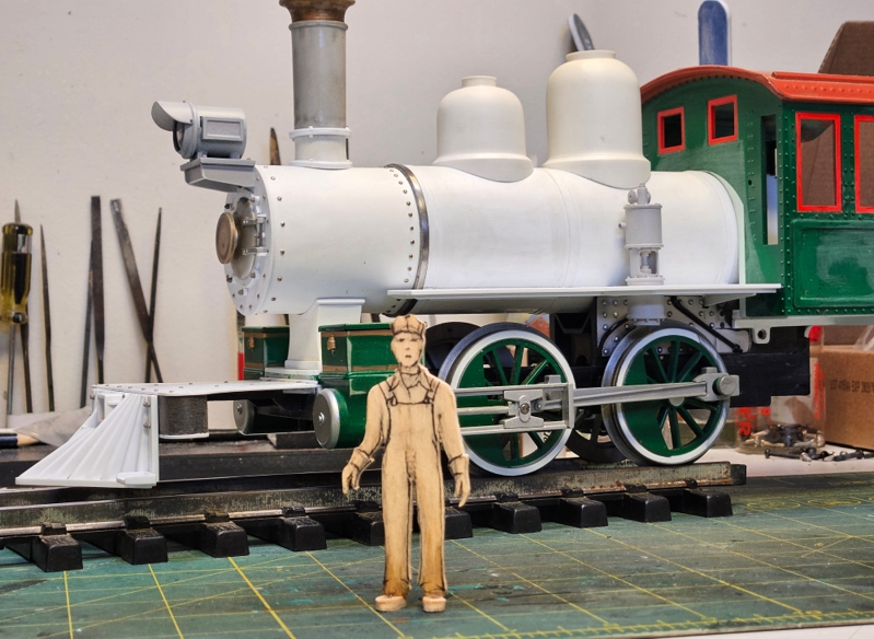

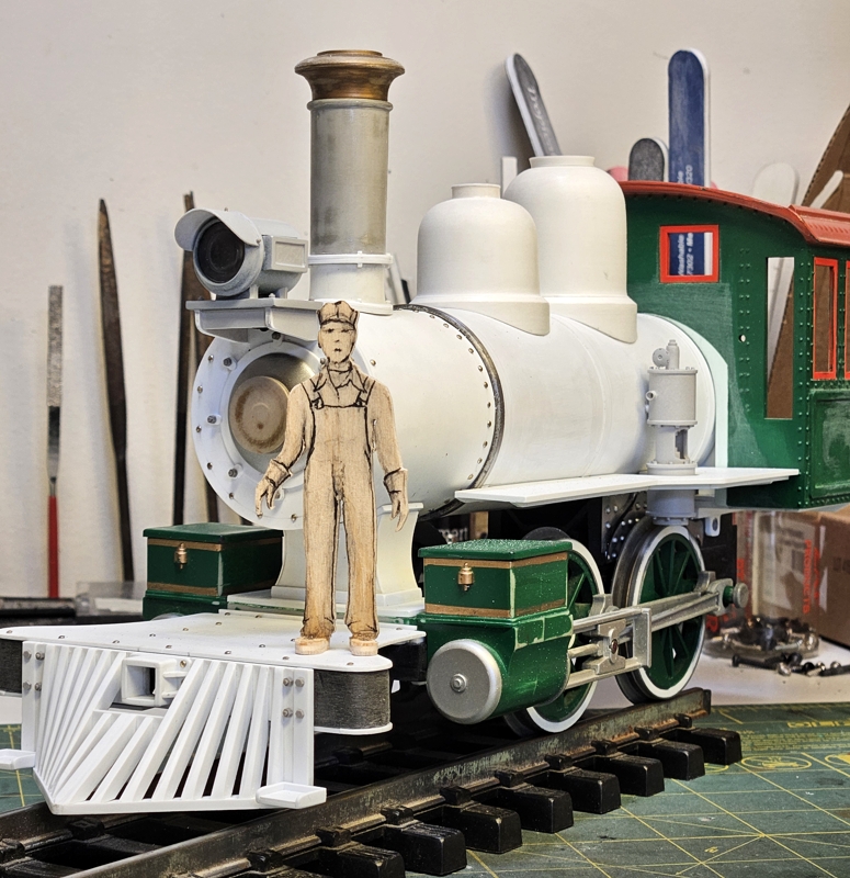

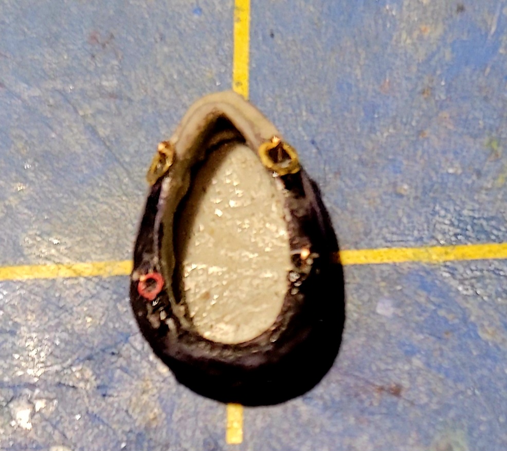

I'm beginning to get concerned that overall the scale elements of this build may be all over the place. Unlike other scale modelling, in the world of "G" scale modelling there isn't a universal scale rule that is followed. Some manufacturers use 1:29 while others follow a 1:22.5 or 1:20.3 scale. The engine that I'm kitbashing was manufactured as a 1:22.5 scale model. However, some parts are more in the 1:20.3 scale size. So, to get an idea I made a 2D engineer figure in 1:22.5 scale. I'm not a figure guy, so laugh it up...lol. The purpose was to see if it looked right with the model and...
I can't tell? In G scale you can easily change a 1:22.5 engine into a
narrow gauge 1:20.3 scale locomotive by simply changing the scale of everything thing else, such as figures, buildings, etc and no one could argue about it. I've ordered a 1:20.3 scale figure to see how it fits.

I'm beginning to get concerned that overall the scale elements of this build may be all over the place. Unlike other scale modelling, in the world of "G" scale modelling there isn't a universal scale rule that is followed. Some manufacturers use 1:29 while others follow a 1:22.5 or 1:20.3 scale. The engine that I'm kitbashing was manufactured as a 1:22.5 scale model. However, some parts are more in the 1:20.3 scale size. So, to get an idea I made a 2D engineer figure in 1:22.5 scale. I'm not a figure guy, so laugh it up...lol. The purpose was to see if it looked right with the model and...View attachment 178073View attachment 178074 I can't tell? In G scale you can easily change a 1:22.5 engine into aView attachment 178075 narrow gauge 1:20.3 scale locomotive by simply changing the scale of everything thing else, such as figures, buildings, etc and no one could argue about it. I've ordered a 1:20.3 scale figure to see how it fits.
Could you use 1/24 scale figures and enjoy commonality with other parts/accessories?
Scale can be important, you often see people mix 1/35 military with 1/32 aviation and it really doesnt work, it sounds close but its actually 10% difference. However with your engine, if it looks right it probably is right and you might be seeing problems no one else would notice.
As i say people are odd, Casey Jones might look huge in 1/1 on the footplate but Tom Cruise in 1/1 might look way to small :)
I agree. In a lot of dioramas, all of the figures are of the same height. Also the weight of a Panther tank is around 47 tons which would mean that a 1/48th scale model would weight around a ton.
