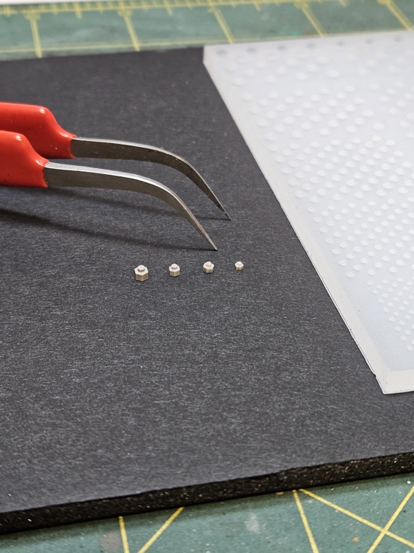

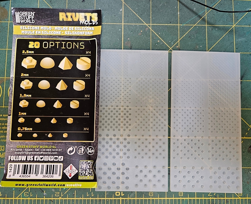

The silicone molds Finally made it from Spain. I used Super Sculpey for these.

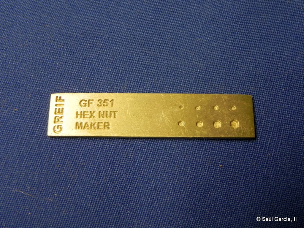

Do tell the make and source! I have ancient steel molds from Greif for which I uses squash molding:

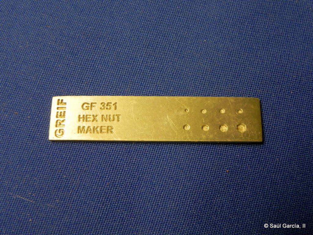

I also have several punches including the ultra-rare The Small Shop Nutter. It uses a lead foil roll and the reason it don't use it anymore. Not my photo:

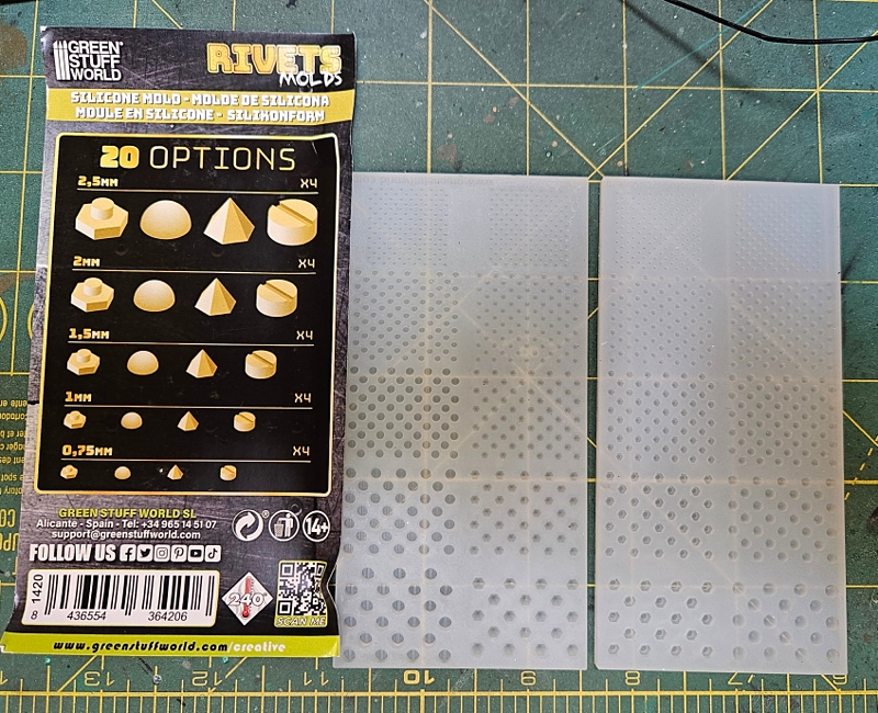

Green Stuff World is the manufacturer. They're in Spain and as far as I know there isn't a US distributor, but they were all over getting it shipped. It took about 3 weeks to get here, not bad.

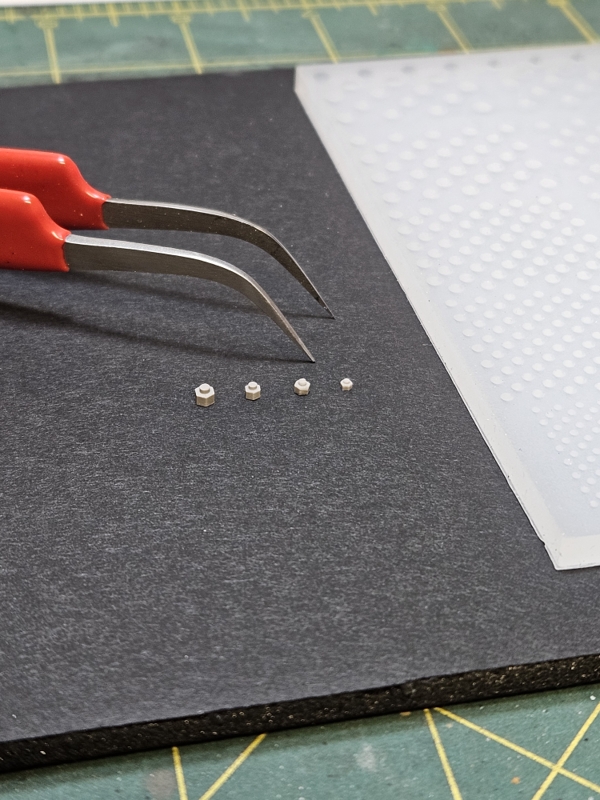

I'm using Super Sculpey to press into the molds, no release agent needed for the Sculpey. Pop the mold in the oven at 275° for 15 minutes and presto! Just pop them out of the mold.

The tutorial video for the silicone molds show milliput being used but it requires a release agent for the mold.
