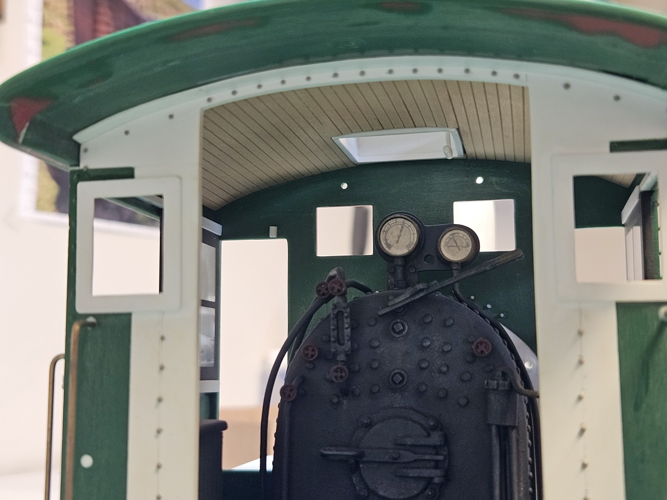

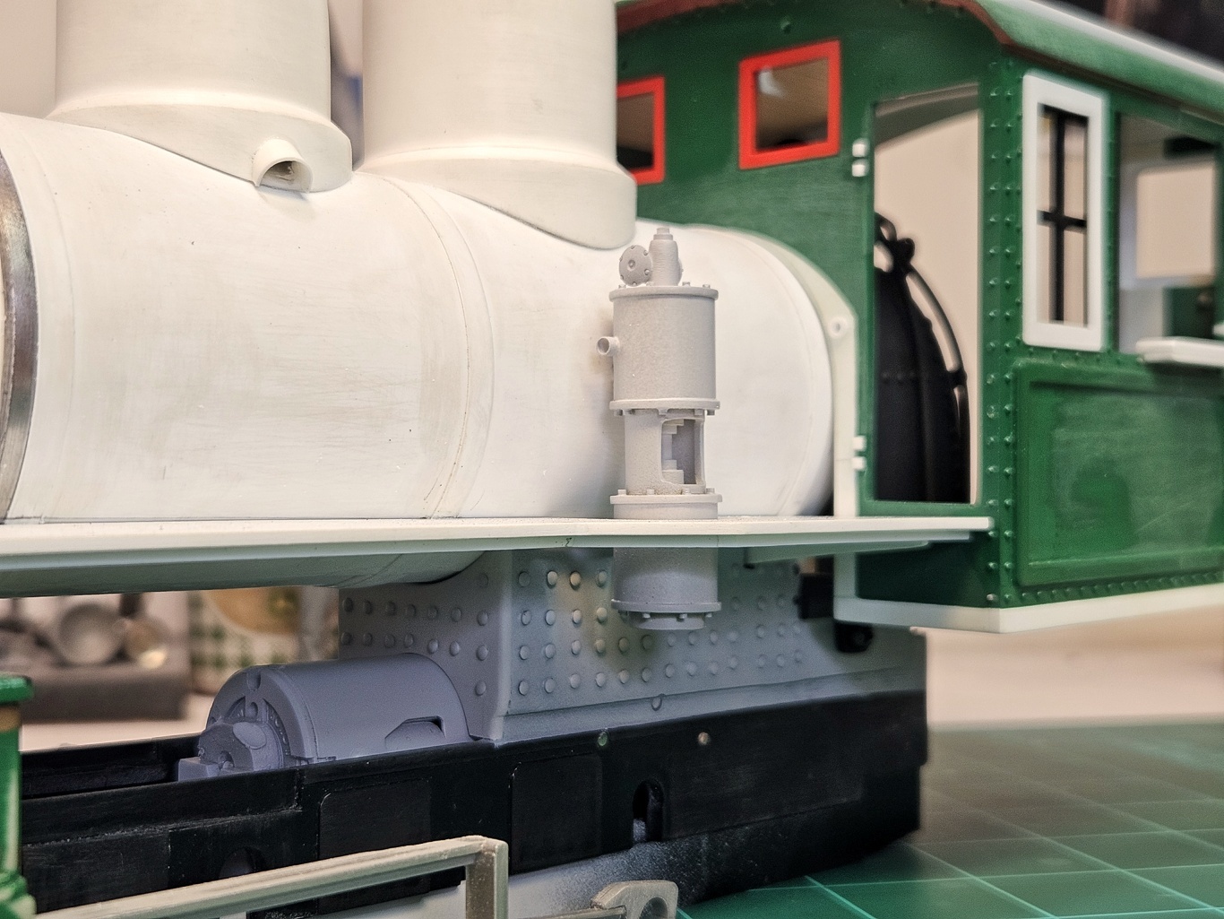

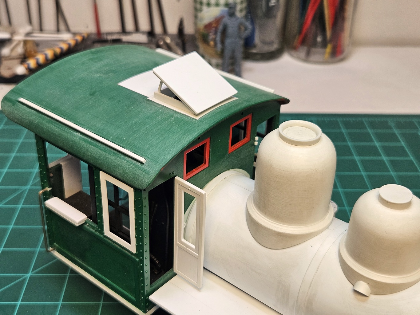

Re-working the Bachmann cab shell. I plan on adding sliding windows, closing in the back some, lining the roof interior with wood. I started by cutting in the catwalk access doors. They didn't turn out to bad for using a cut off wheel on the flex shaft and sawing the corners with a hacksaw blade.
While I was at it I went ahead and removed the molded on gutters, rivets and the raised lip around the edge of the roof. I really should move the fresh air hatch forward as well.
