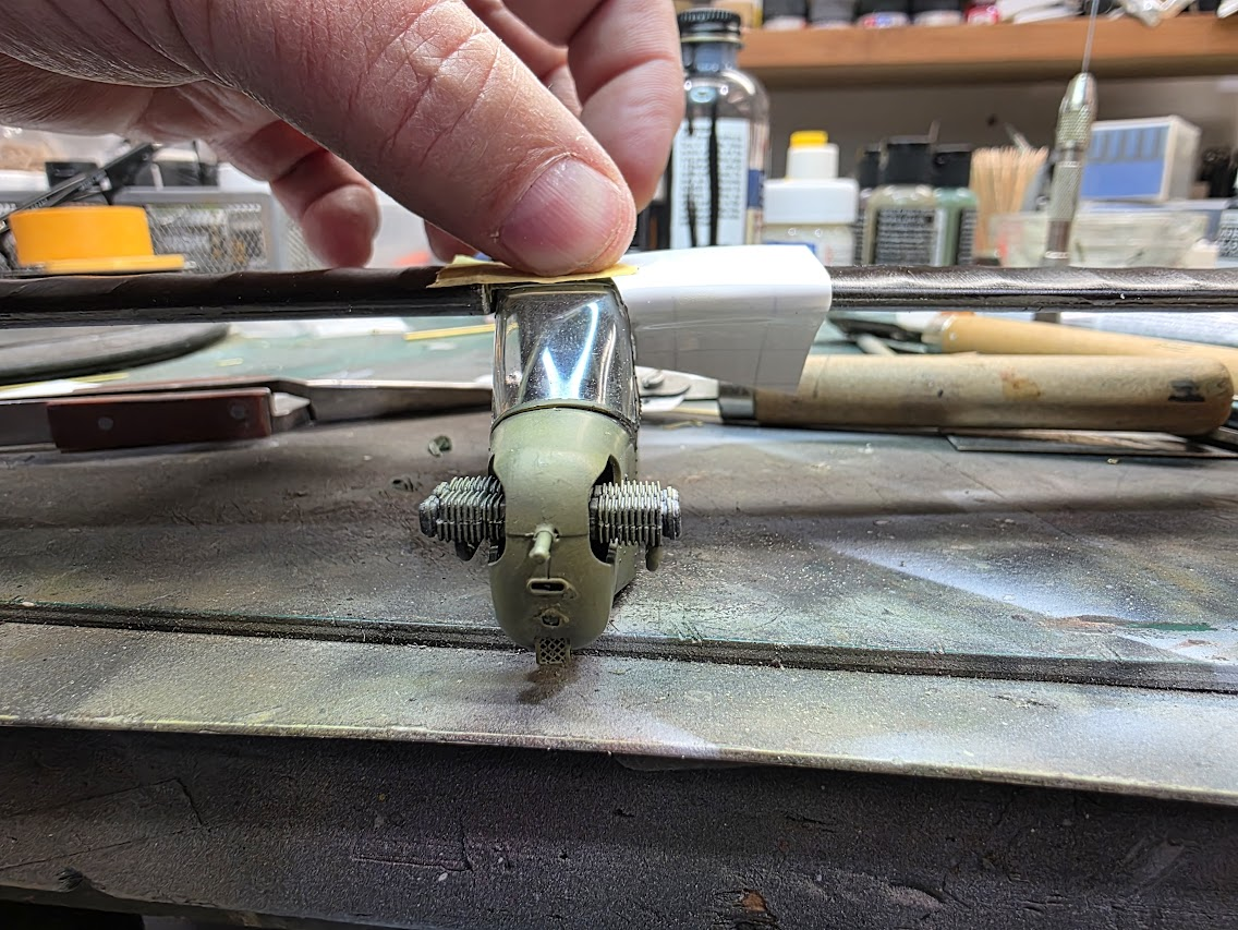

Just dawned on me as I'm pouring coffee, get a sanding film between the wing and the canopy and sand it down. Trust me, I got it in my head.
If this is to remove the dihedral,

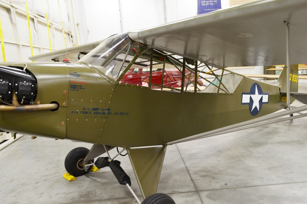

I am still checking about what looks like an extra window but appears as sheet metal reinforcement in all the photos of the L-4H Grasshopper...

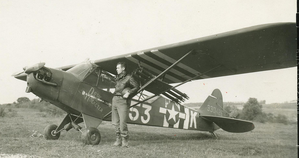

Did anyone notice that this is an other bazooka armed Grasshopper and not Rosie the Rocketer? Serial 42-15188 is an L-4A
Whereas Rosie the Rocketer is an L-4H serial number 43-30426 (@moon puppy, don't forget the rear view mirror) :

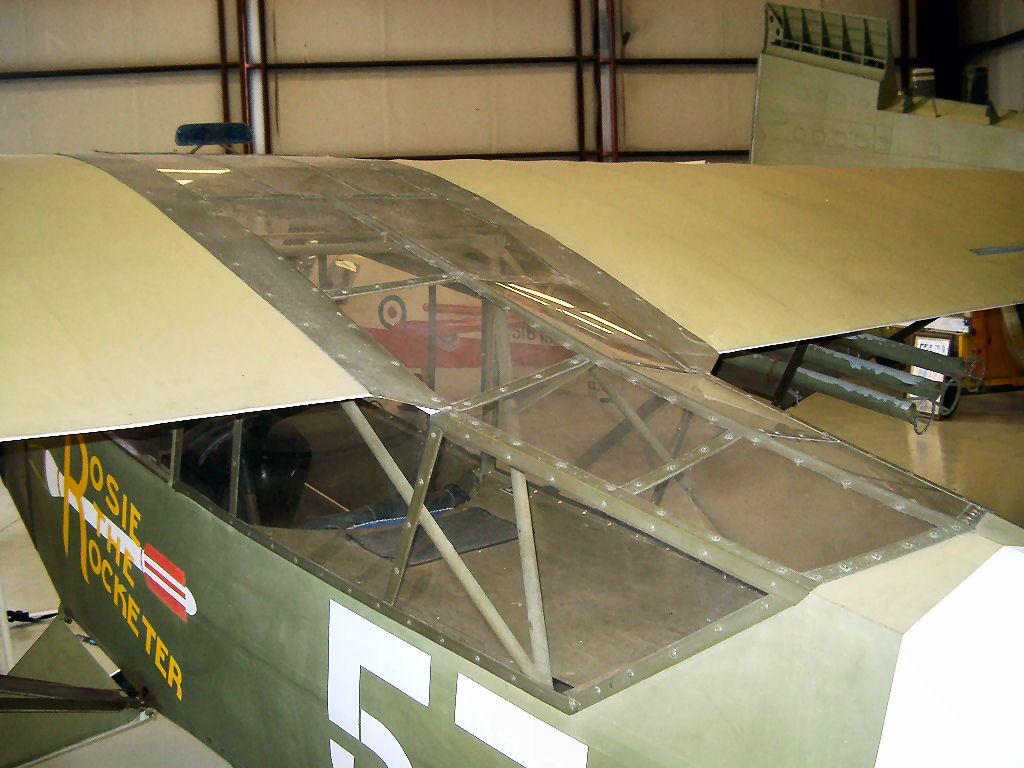

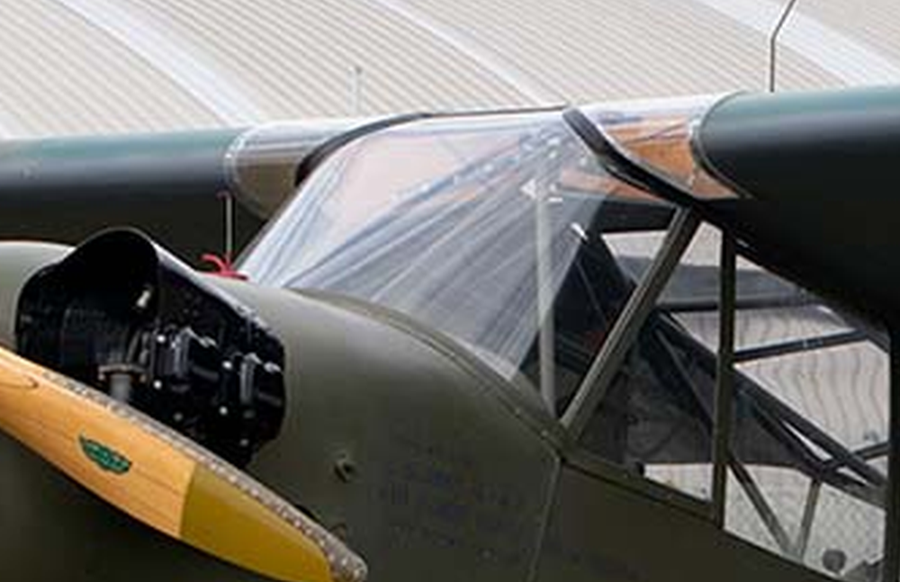

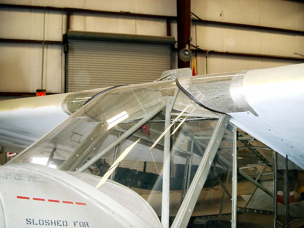

I don't know, that looks totally transparent. Looks like we can see inside the wing root.

That's not a reflection of wood grain, that's the unpainted wing spar and some control lines.

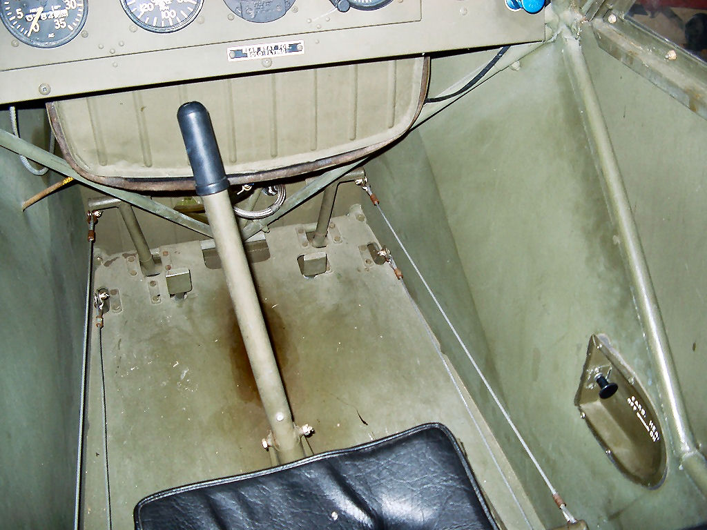

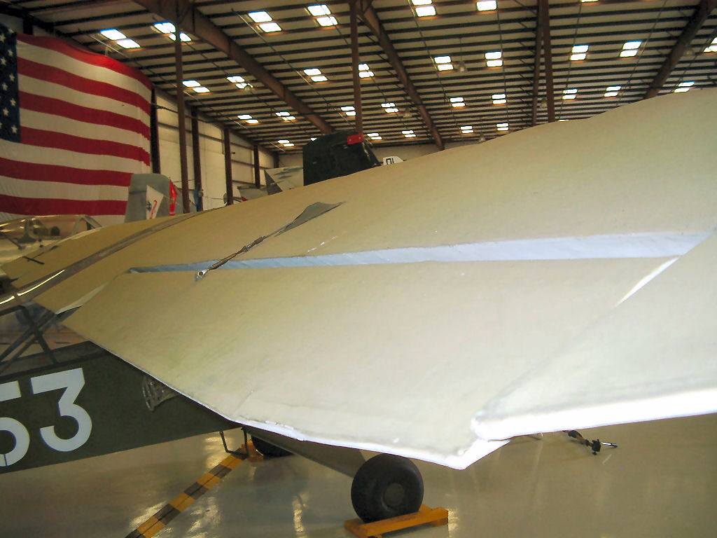

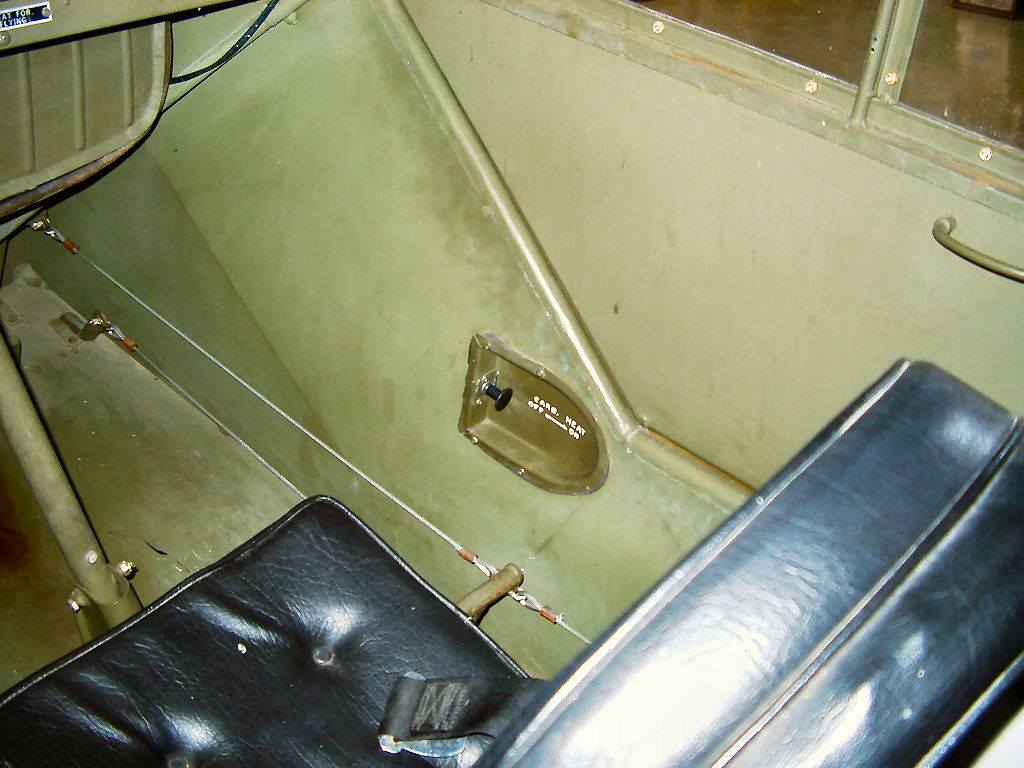

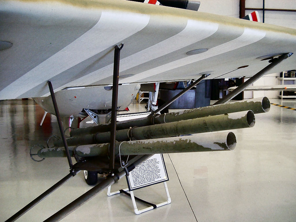

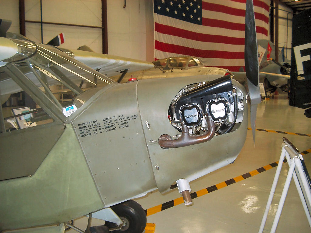

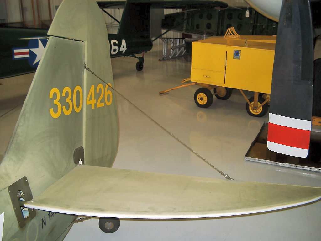

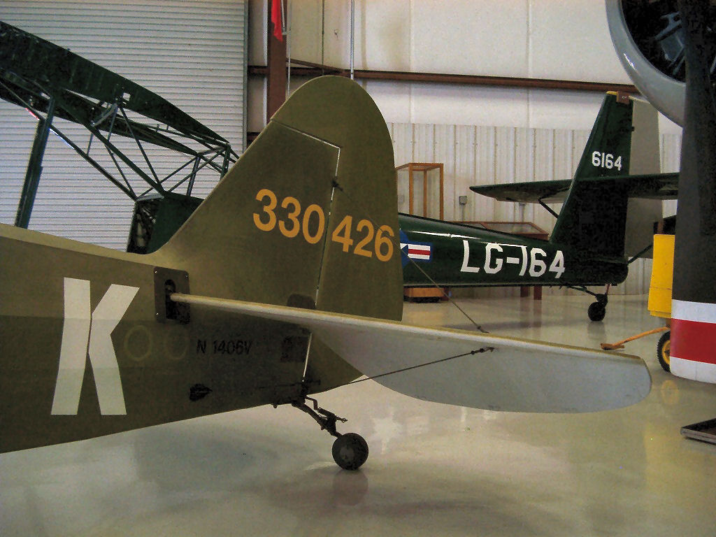

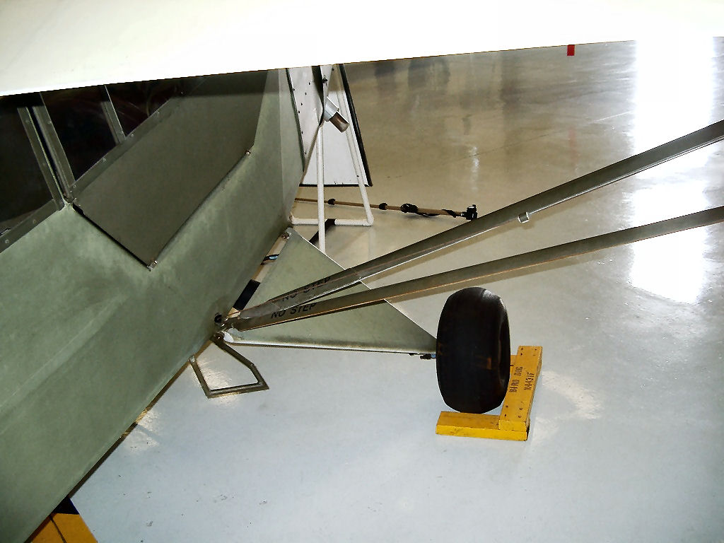

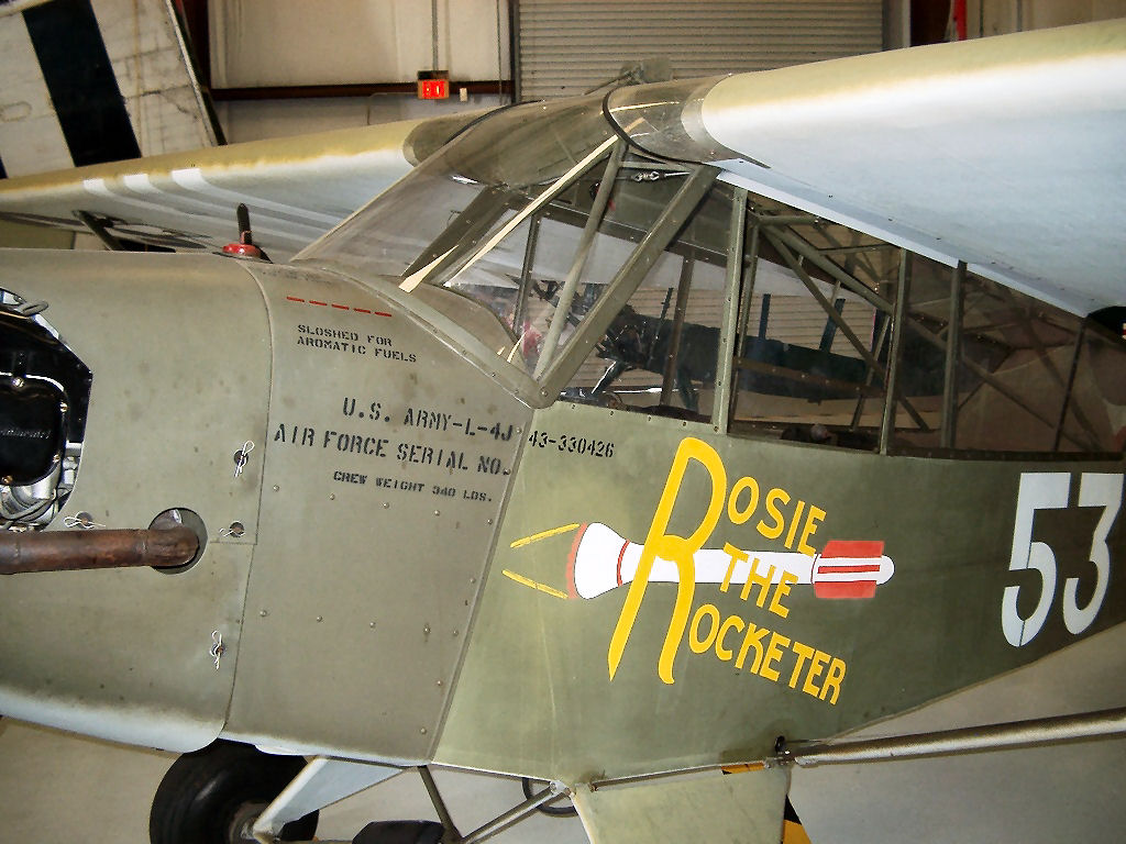

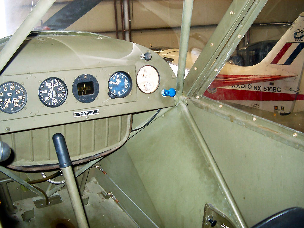

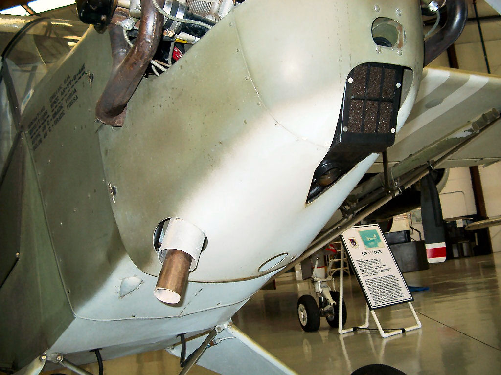

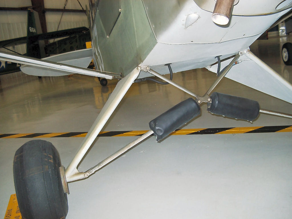

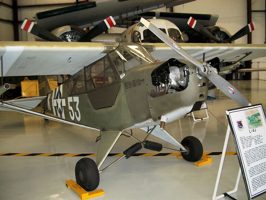

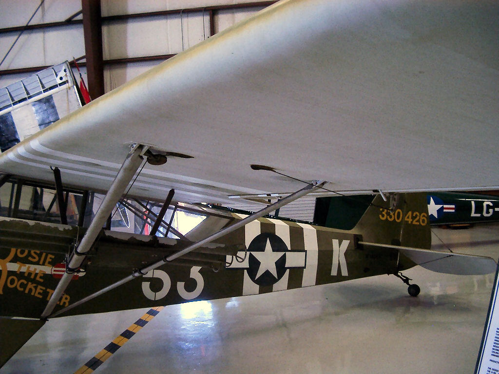

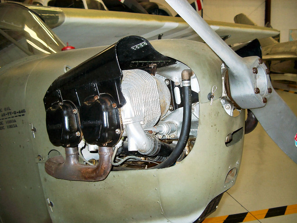

Well, here are some close up images of what is claimed to be Rosie the Rocketer, HOWEVER this is an L-4J on display at Valiant Air Museum whose serial number is actually 44-80595 and not an L-4H as would be the case is the serial number were actually 43-330426. It is why I didn't post them as this is one of two Rosie the Rocketer imposters.

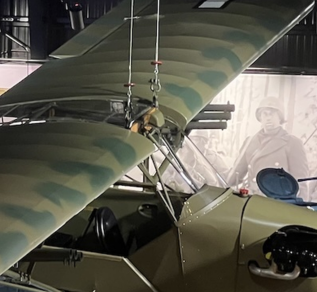

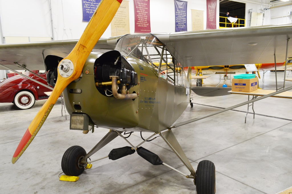

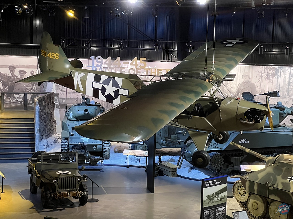

Now, someone stated that the real one, below, had the sections open but it seems that was to be able to hang it:
A crop from this photo:
So you got yourself a mystery!
Yet, it is quite POSSIBLE (no idea how probable) that L-4J parts (if indeed those are clear plexiglass) could be sourced and used during WWII as the L-4J entered production in 1944. Also, note that the tires need to be smooth with no tread pattern and all nuts silver as restorations using current AN hardware have 'gold' tone to them.

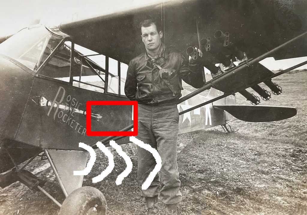

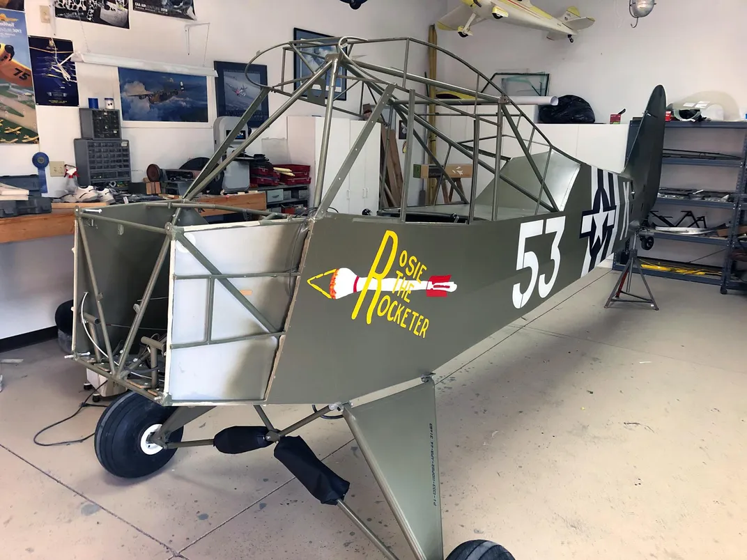

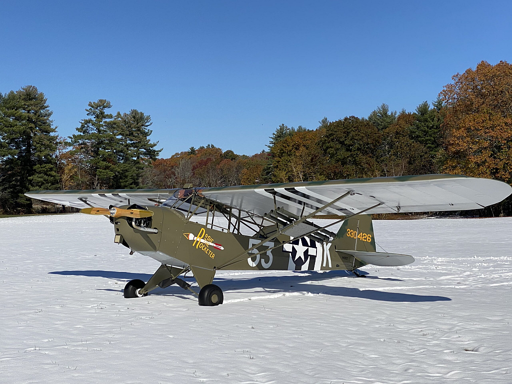

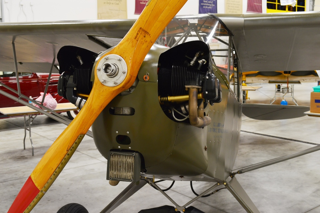

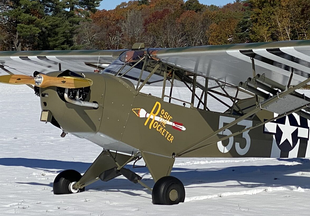

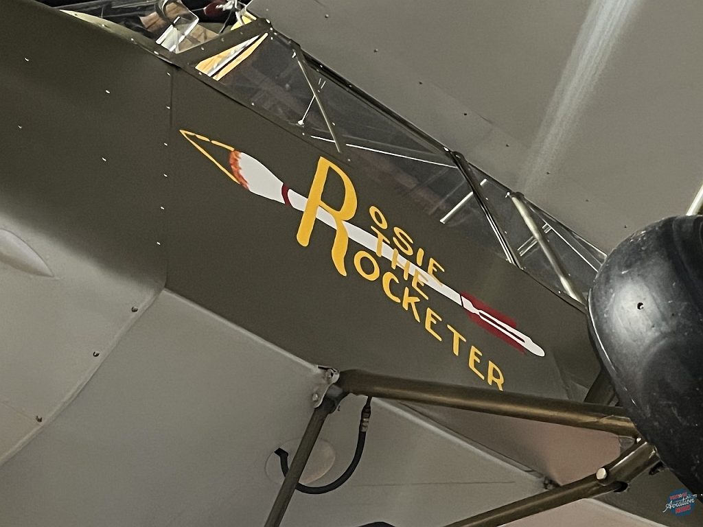

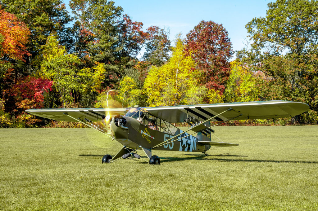

More photographs of the verified L-4H 43-30426. Click for Smithsonian article on the restoration:
Well @moon puppy, you have some work to do based on these photographs of the actual restored Rosie the Rocketer! Use some clear acetate from a sheet protector and the kit's plastic leading edge root fairing as a template. Cut plastic kit part leaving an edge to mount the acetate. Easy-peasy...
So you know, I am intrigued by the clear inserts and am trying to find out if anyone calls them Plexiglas (perhaps to increase the view out above?) but so far nothing. I'm just glad I won't have to deal with that!

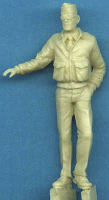

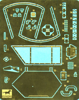

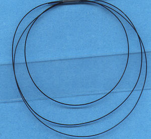

Bronco did re-release the kit with some improvements added but I doubt it was to the moldings. From what I saw, it was a revised PE sheet, decals, some cable for rigging and a resin pilot added.
@moon puppy, are these in the kit you have?

No pilot for me Saul, guess they ran out of the figures. Didn't have one in the first one either.
The PE sheet is shit, numbers are wrong for the most part, that part 5 is supposed to be for the antenna mast but no clue how the finished product is supposed to look. Didn't figure out why they supplied two sets of frames for the wind screen, guess they knew one would end up rubbish.

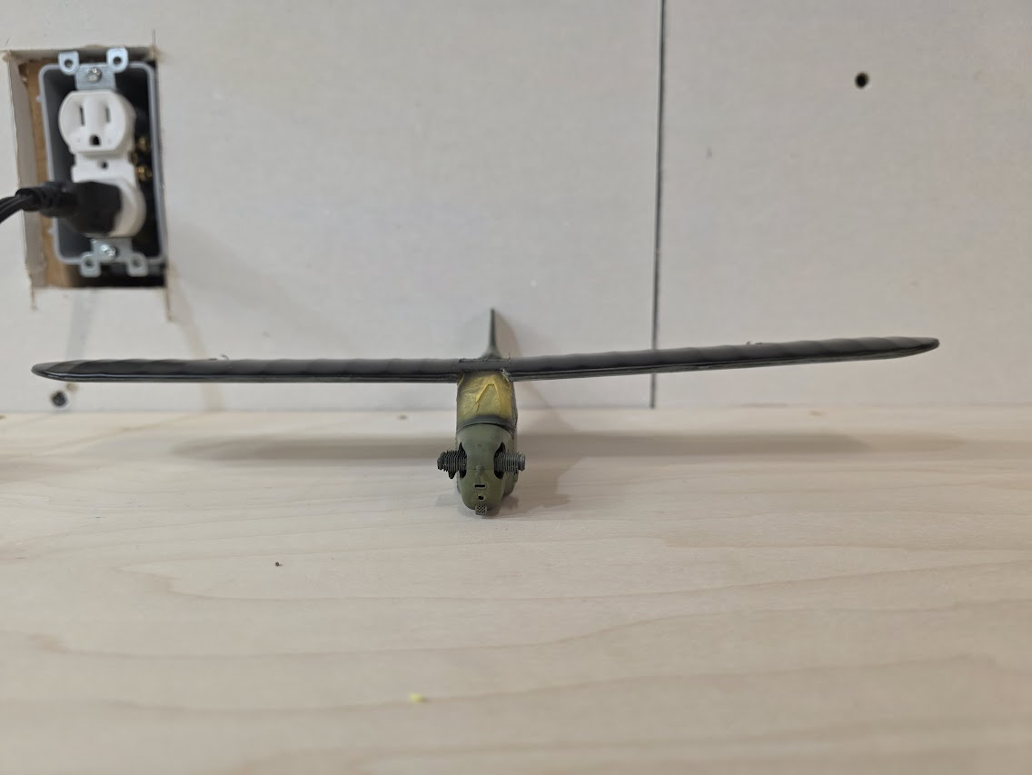

It's become clear to me the intended for a dihedral int he wing, just look at the box art. I think you could get a gallows Cub and work it up and end up with a better representation of a cub than this.

That white sheet plastic is my form for a good clear sheet when I find one. I've watched enough Matt's Offroad Recovery to catch some fabrication tips from him. Yes, I broke the wings, this really needs a proper wing spar. I'll smoke this over while I rebuild my work bench.
