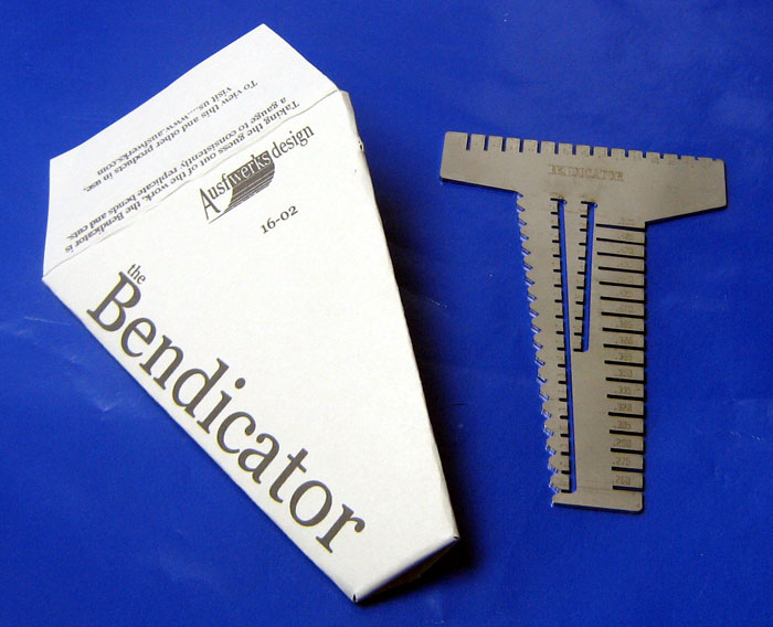

Mission Models Grabhandler and brass wire. Make multiples with same width,no guessing. Works with brass
or copper wire.
...The price doubled since I picked mine up.
There is also The Small Shop Wrangler Wire Bender:
But I use the simplest, Ausfwerks' Bendicator:
Here is a review:
http://www.track-link.net/reviews/k1619
Regards,
