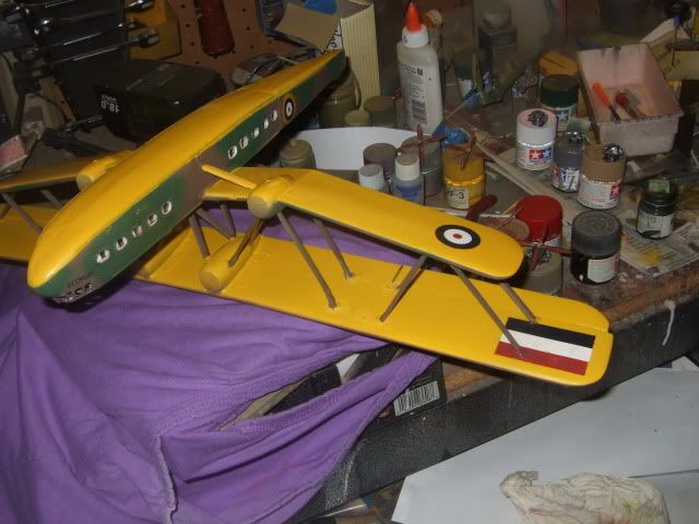

Unmasked today.Sure looks like the waterline of a ship ,dosen't it?
Today I started the process of attaching the top wing.I used 2-part epoxy to attch the outer wing struts and engine to lower wing struts.i have to obtain more strut material to custom fit the engine to fuselage struts as well as fabricate extensions to allow some of the shorter struts to reach the top wing. Here is a pic
Very nice. The old aircraft sure have a lot of character, something the new plastic jets seem to lack. She's looking beautiful.
James
Thanks guys!I have never built a kit quite like this,and I've built hundreds of kits the last 35 plus years!I've built vac-forms but they were monoplanes!Plus the bi-planes I've built have been 1/48 fighters and they only have from 6-8 struts!(never built a tri-plane)I'll never forget this one for sure!
