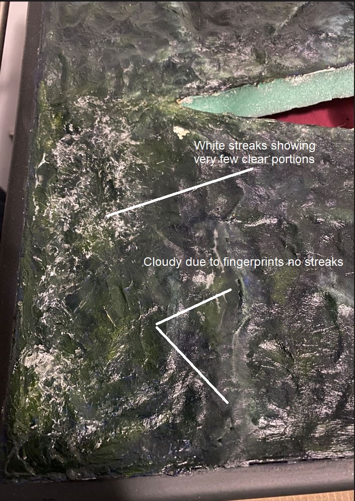

Time for another update ... tried many ways of adding thin transparent layers that would be dry brushed so to create the illusion of depth. First I tried Selleys all clear caulk but, even though it did dry clear, there was a zillion tiny air bubbles trapped in the "silicone" - not a silicone, but a co-polymer sealant as they call it. Had to strip the small portion that I laid, repaint the base, few square inches, no big deal. Then I found Sika Crystal Clear caulk, this does not bubble at all but I ran into two other things.
#1 - I used a spatula to spread the silicone, bit of moisture (water) the result looks bad - portions of it appear white, not clear (called them streaks)
#2 - the two white lines show the segment of silicone, only this time I used my finger dipped in a bit of water mixed with a tiny drop of dish washing liquid. Much better, smooth and no bubbles, the only problem is that, pressing with my finger, I left fingerprints all over, which gives it a cloudy appearance.
I stripped the #1 portion and about to repaint it, #2 I will leave it as is, paint over it the same base color and then try to apply the silicone again, only this time either use latex gloves or a spatula dipped in the same water / dish washing mix and flatten it to the right thickness.

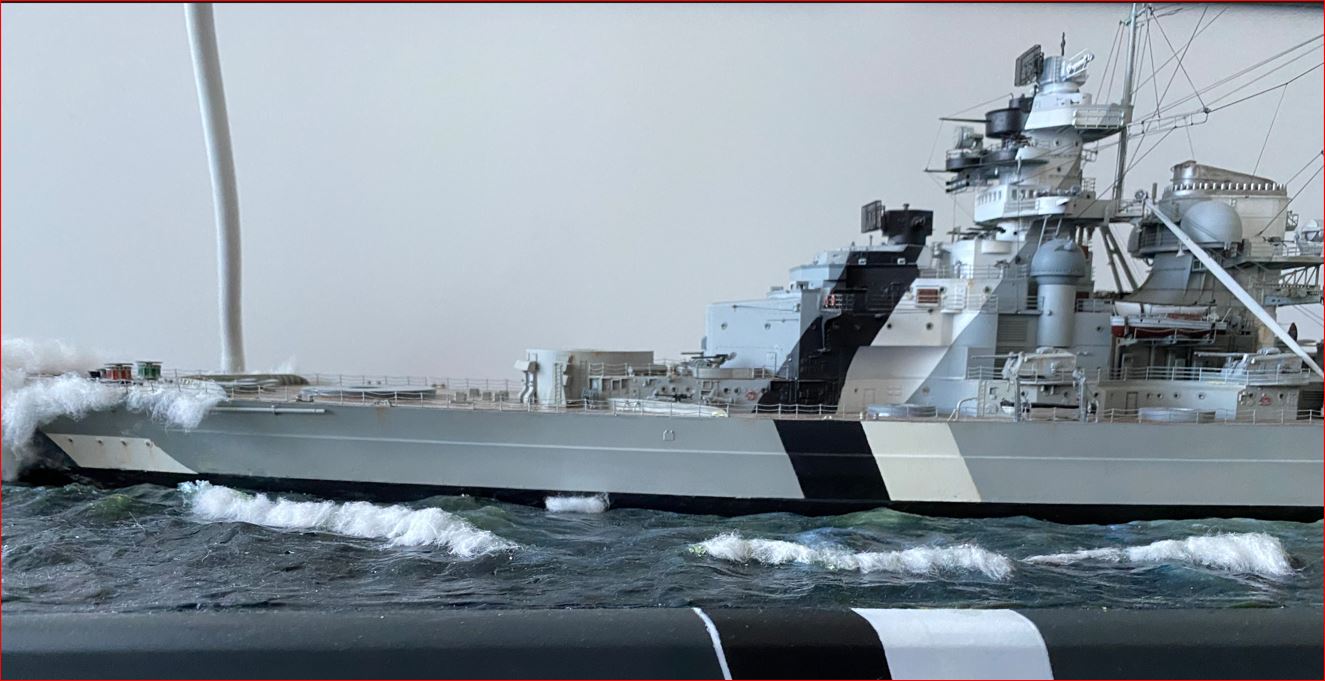

And from the side ...

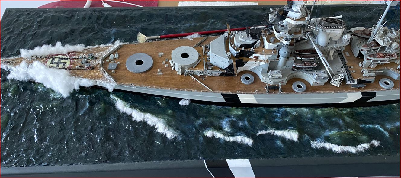

Everything covered with a thin layer of clear silicone - totally clear / transparent, plus some shaping of the water to add realism and make it look very choppy.
Cotton added by first laying some more silicone, so the waves are not "flat" when looking from a side. All those waves there consist of multiple additions of cotton, slowly "building" them up.
The ship is not fixed to the base yet.

It's not easy to make cotton look like water. It's, well, it's cotton. Big Don Barry used to drip isopropyl alcohol on his water media. the small bubbles just vanish. Does the big base have attachments for wheels and a towing hitch? :lol:
The frame is hovering above ground, sort of a gravitational mambo-jumbo lingo thing here :bigrin:
The silicone I am using leaves no trapped bubbles, which is great - the previous one I tried was impossible to use - a TON of bubbles . Also using methylated spirits to smooth it and prevent it from sticking to my fingers when laying it down.
Once the cotton is stuck to the base (using a bit of silicone for that), I am using a bit of hairspray to make it stiff and give it a bit of a glossy / shiny look.
