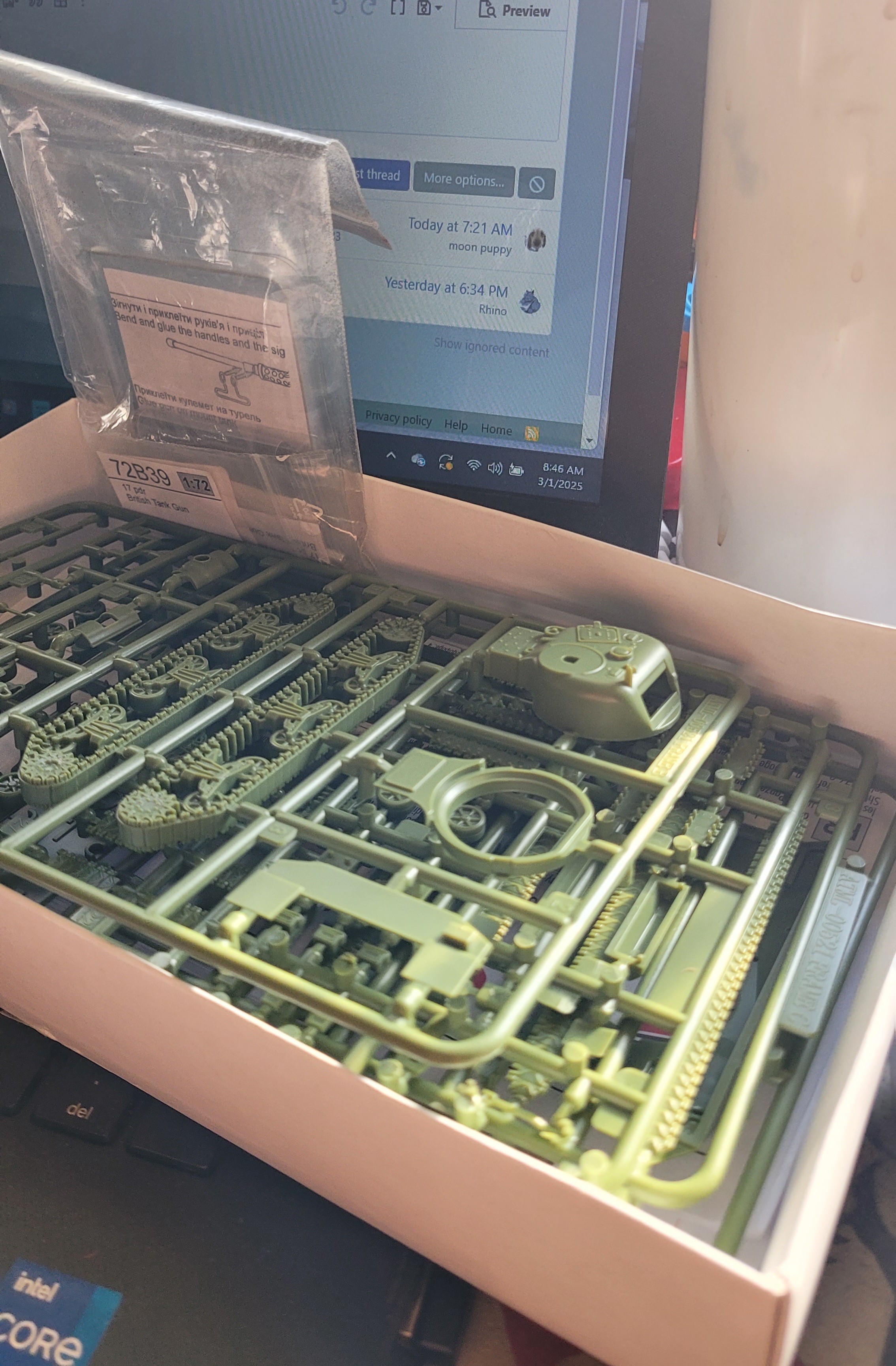

Airfix issued their new-tool 1/72 scale Sherman Firefly Vc kit in 2020. The plastic glues easily and sands readily. Assembly is straight-forward with molded on positive attachment points. 2 sets of running gear are included. Separate suspension, sprockets and link-and-length tracks OR running gear and tracks as assemblies. Airfix includes a jerry can. .30 and 50 cal. ammo boxes, extra track sections and bogie wheels to add some stowage.

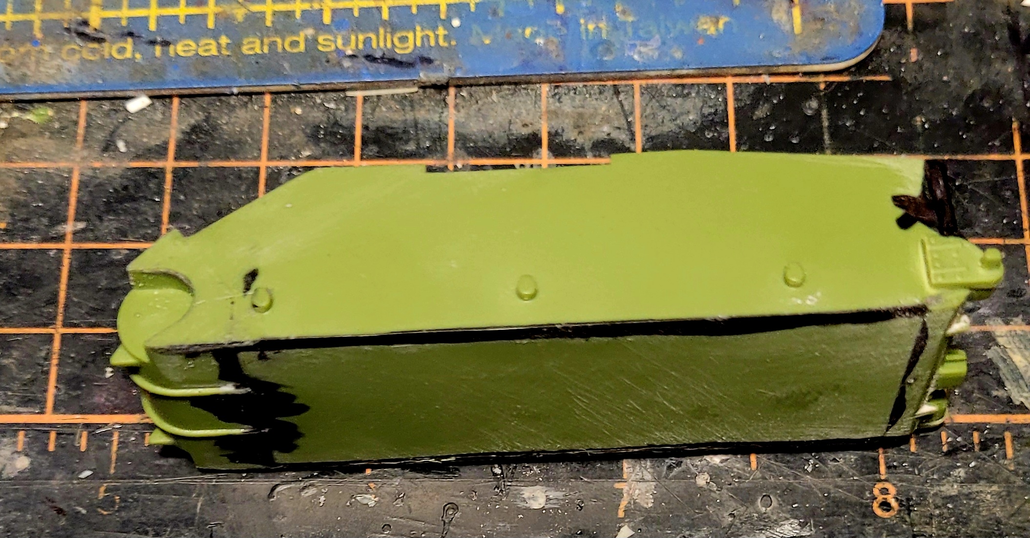

The fit leaves quite a lot to be desired in a few spots, but I built this wearing my 150 magnifier. That could be inadvisable.

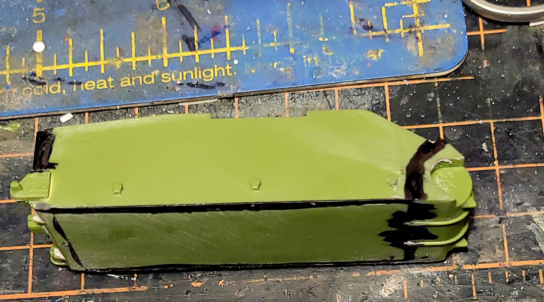

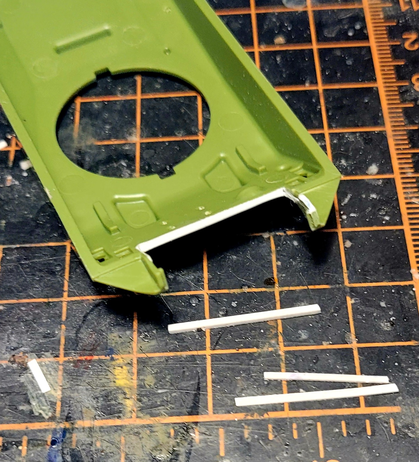

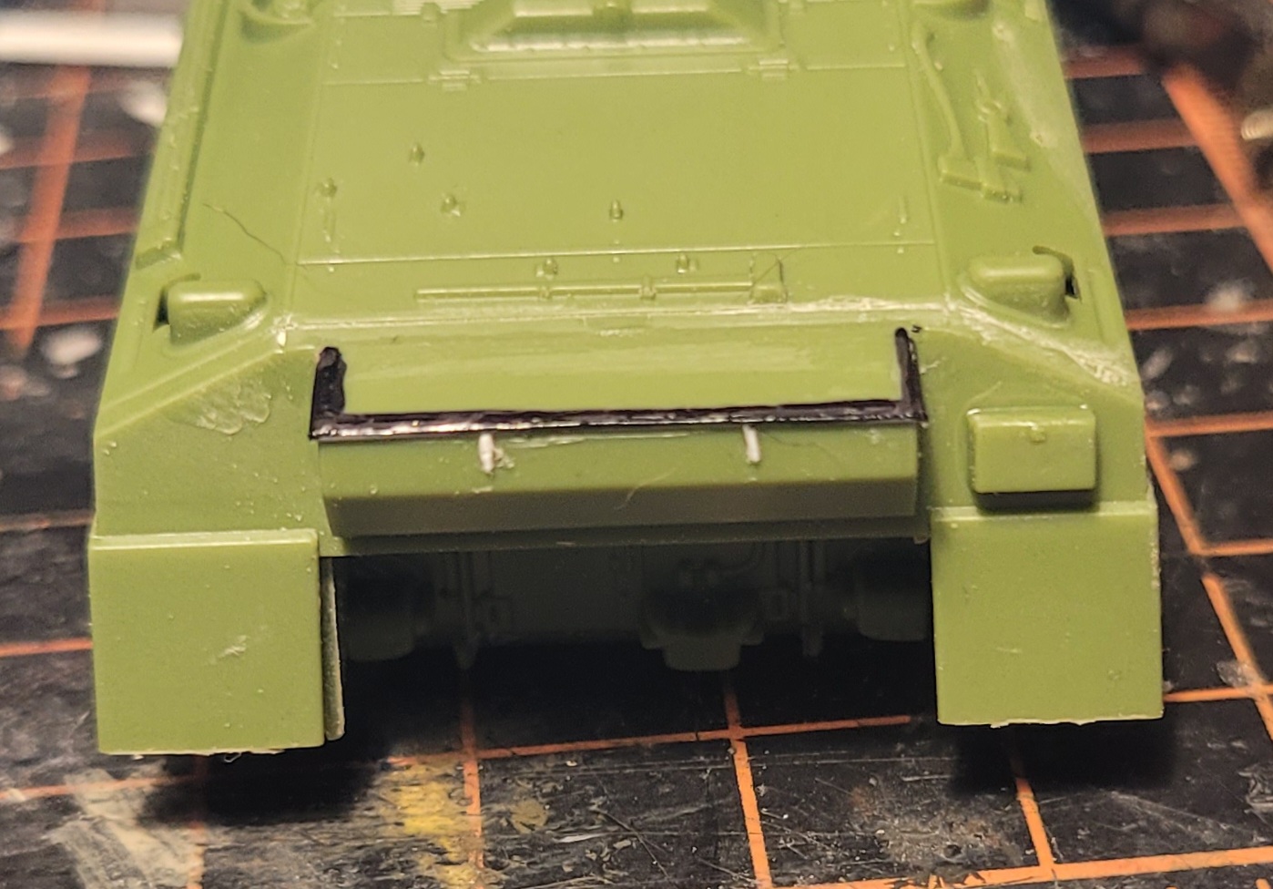

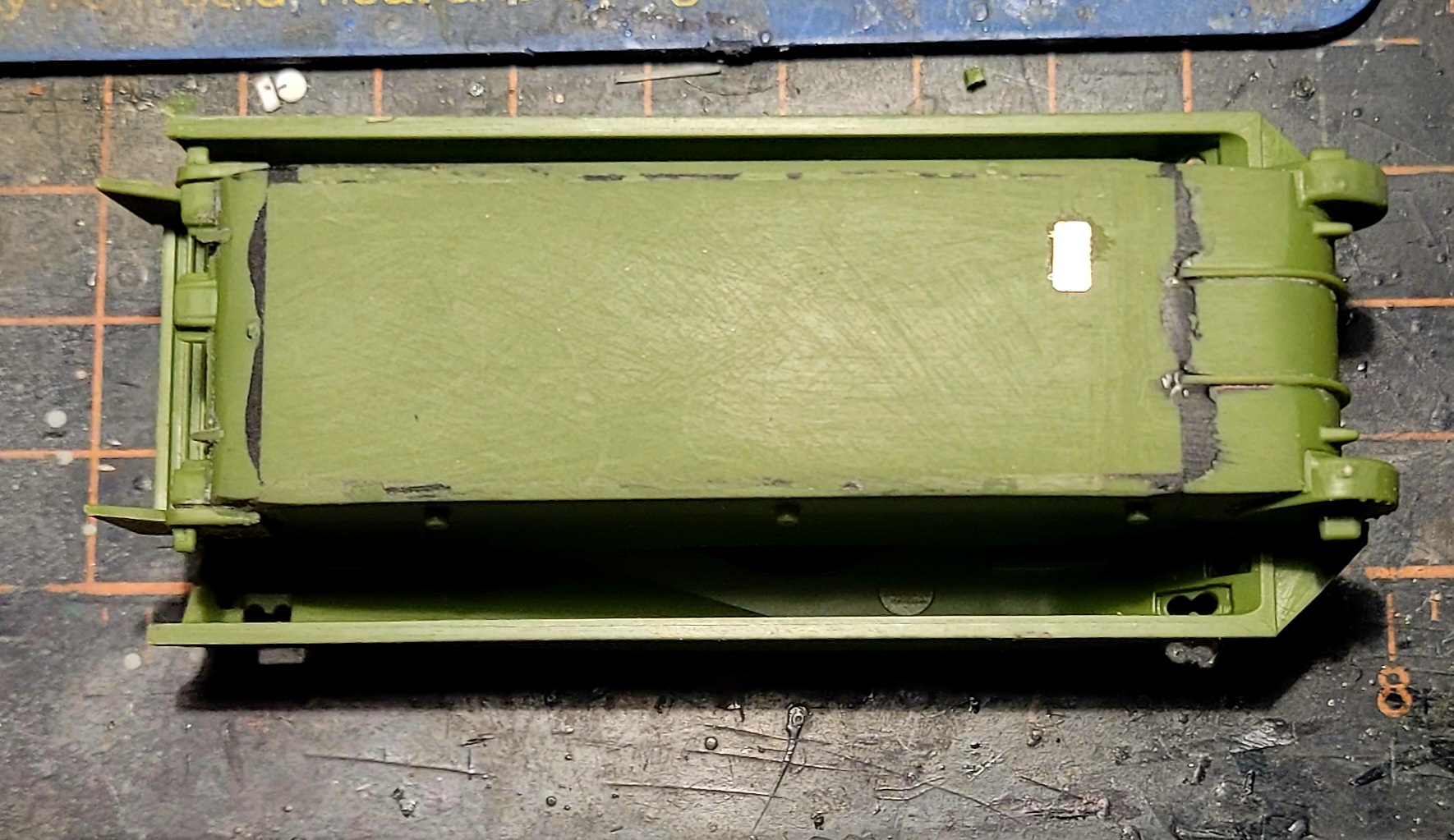

Using the ship model "Black sharpie, c/a glue and sand' method makes short work of minor gaps. Bigger gaps (transmission cover to hull joint, fenders to drive housings, rear mud guards) require styrene strip and sanding.

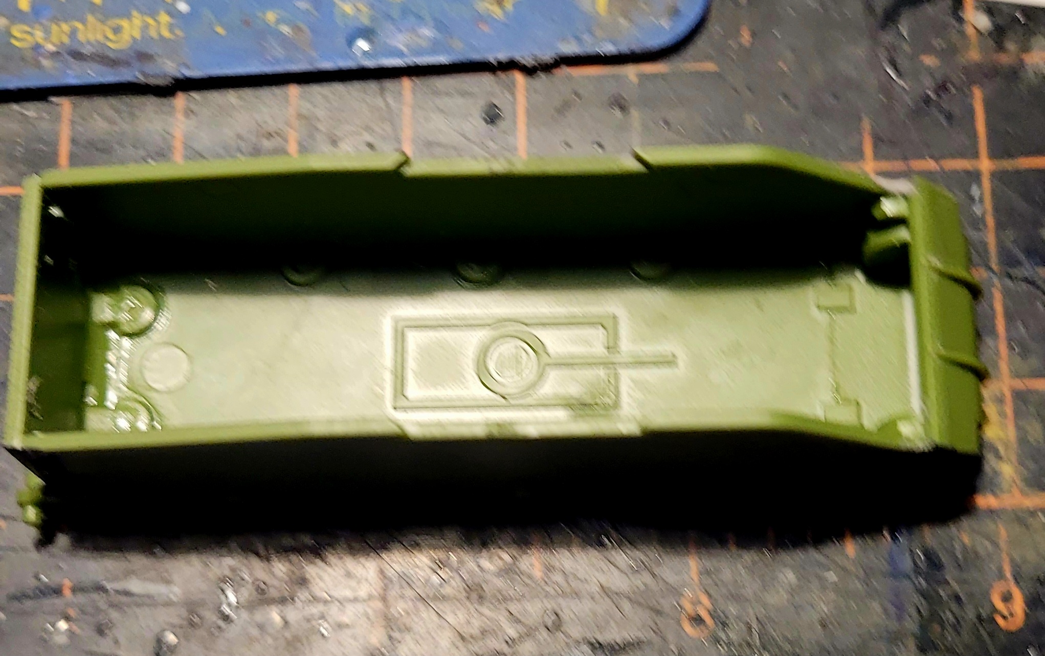

The hull over the running gear is a wide open empty space. I don't think I will take the time to close it up.
The lid for the bin on the rear could have been better, so I worked on that, and added the hatch in the bottom of the hull.

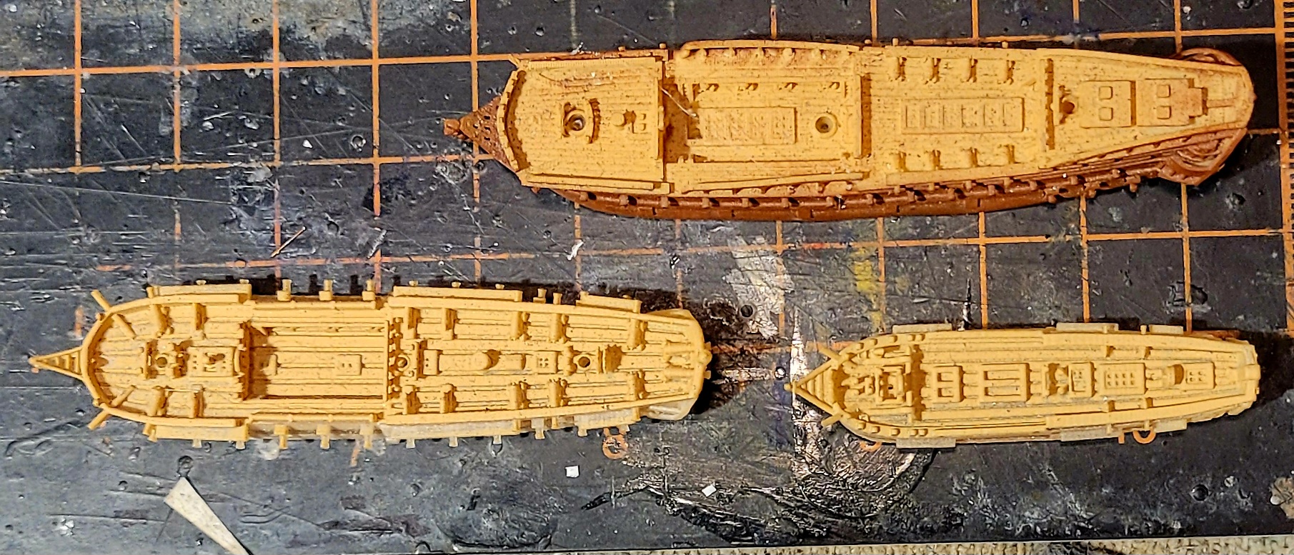

I'll bet you guys thought I would put all of Henry Turner's designed 3D printed sailing ships together, didn't ya!

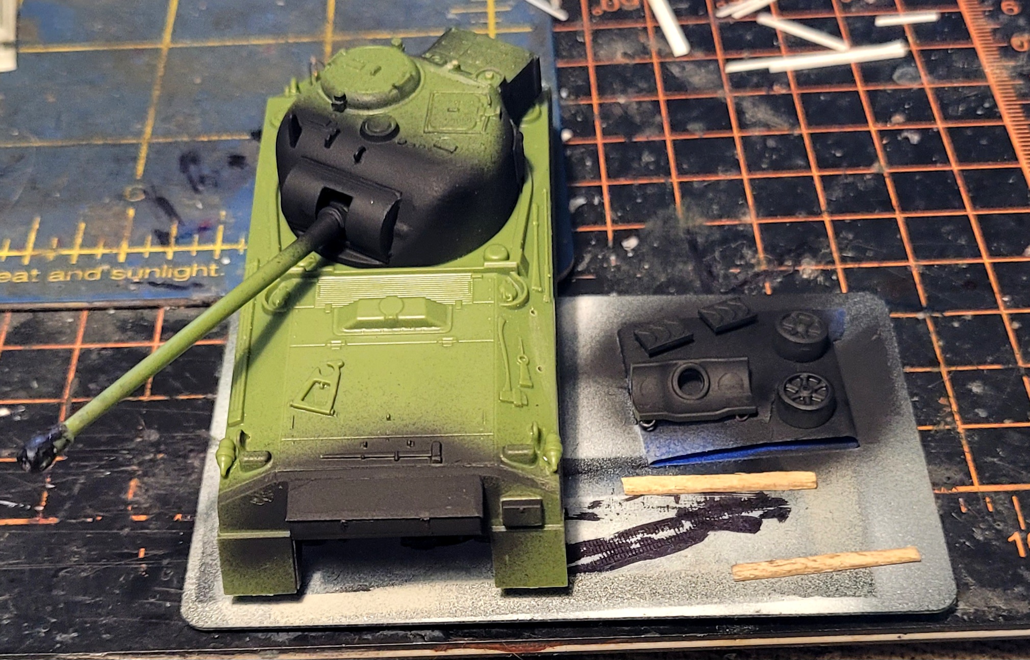

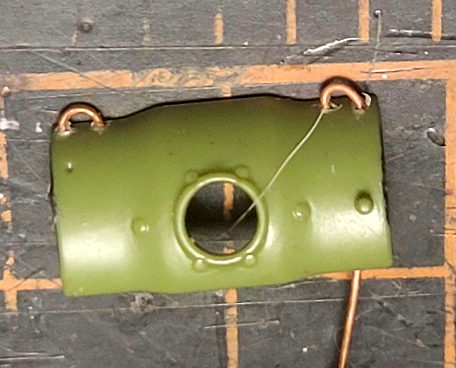

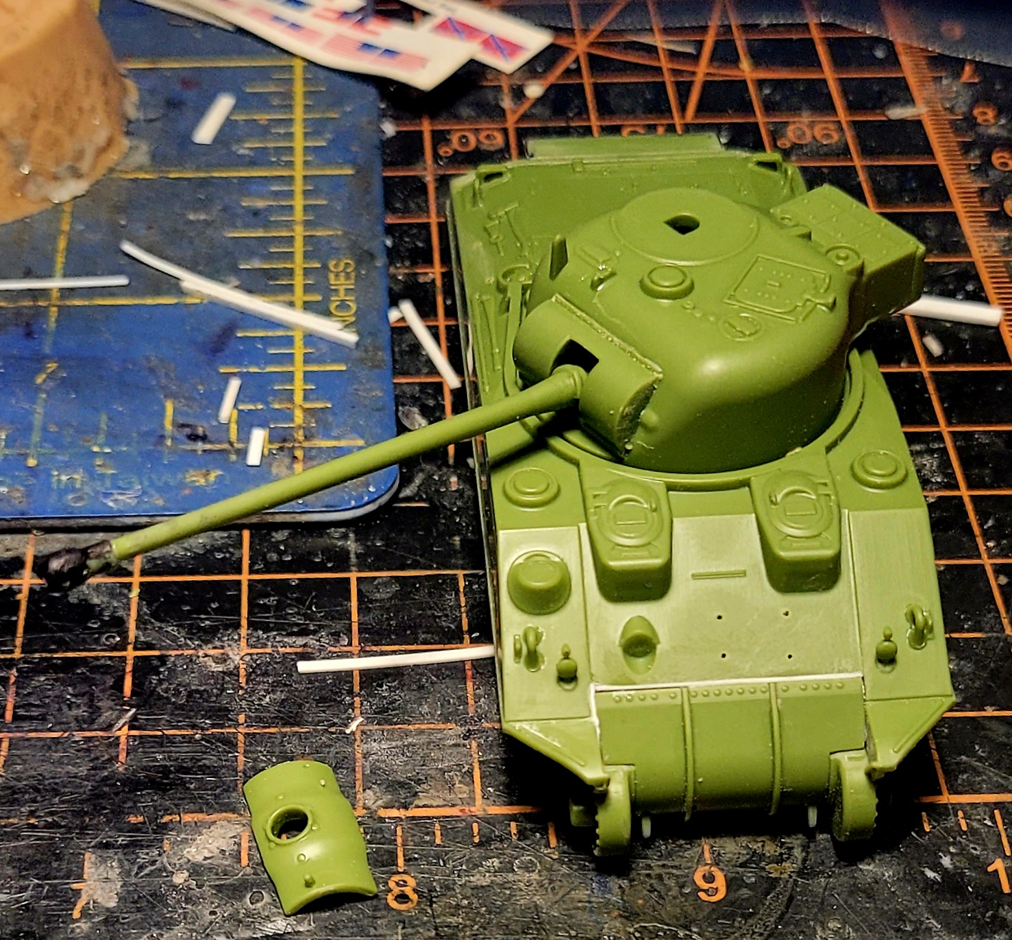

No hoisting points are on this cute, li'l Firefly model, so I installed some. Mantlet and turret both. I also added headlamp guards from a smaller diameter copper wire. The elevation action of the gun seems unlikely. After carefully installing the mantlet and picking a jaunty angle, this is where she stays!

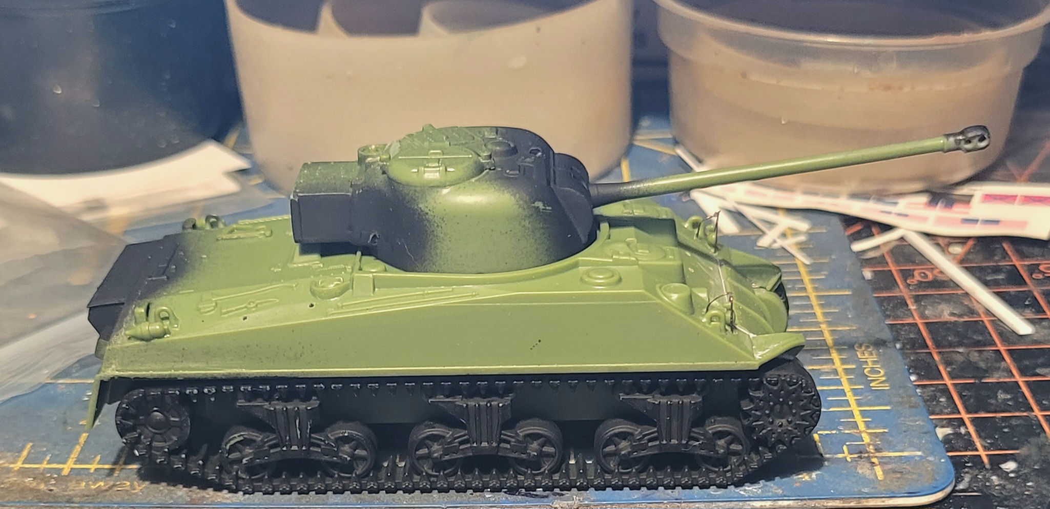

I confess to having little fondness for assembling tracks, so my Airfix Firefly will be assembled with the one-piece running gear.
Painting the track assemblies is tedious, but I like the look of them so far.
TIP: Some carving of the hull attachment points was needed to fit the one-piece track assemblies! I imagine it would be the same on the link-and-length tracks. A little disappointing for a "new tool" kit.

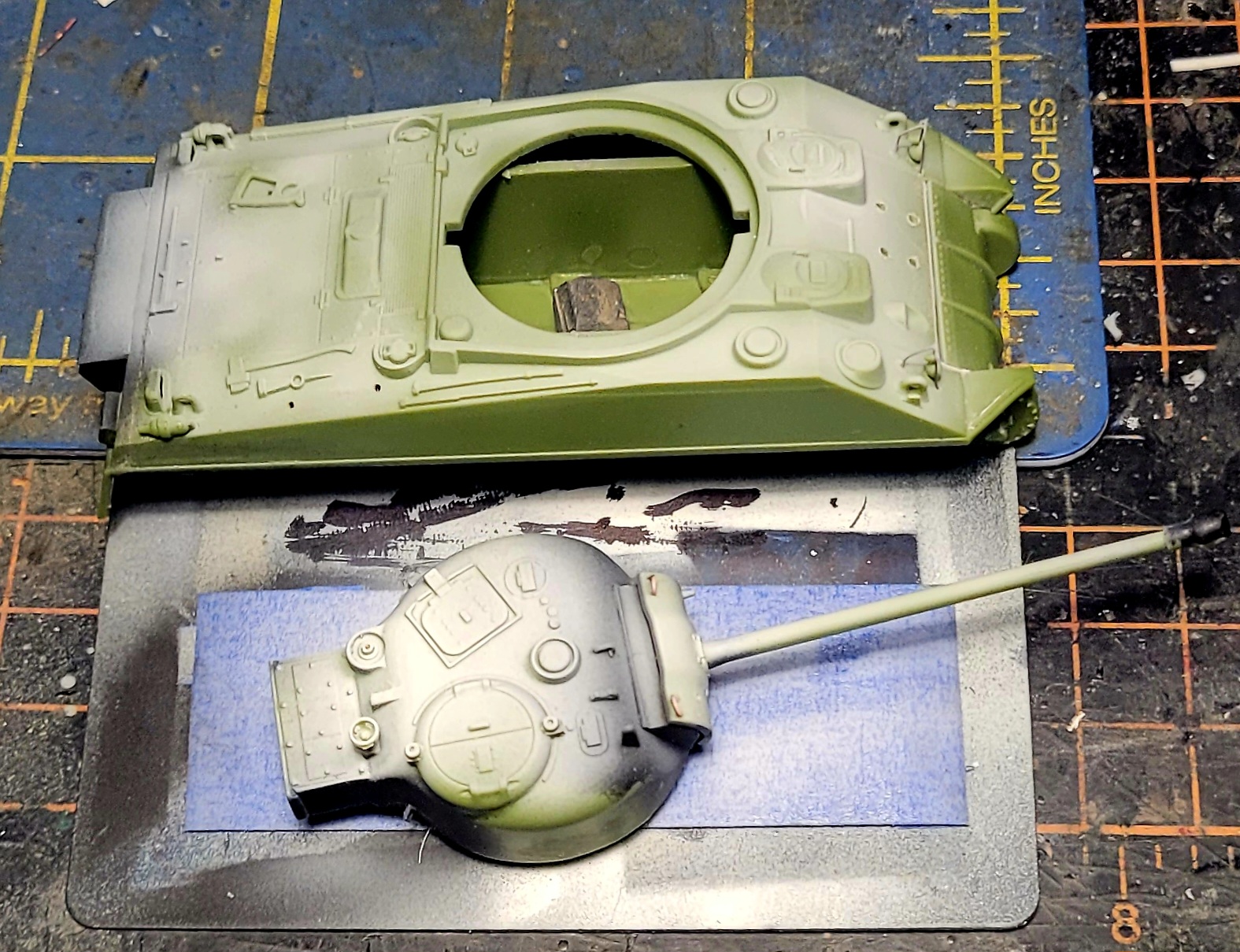

This kit is being finished in Tamiya acrylics entirely.

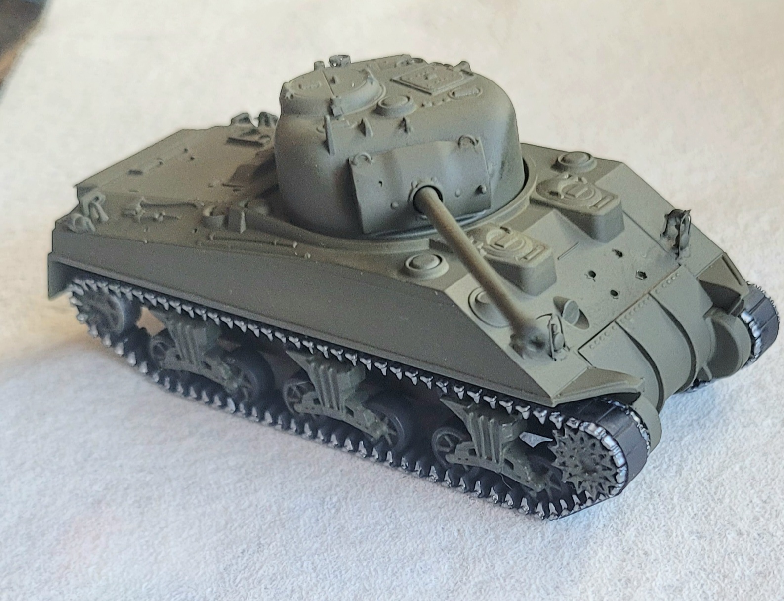

I just sprayed the Olive Drab green, and my pre-shading efforts seem ineffective. You Armor guys use this technique more than I do, so it could be a question of experience.
Stayed tuned to see how it comes out once the paint is properly cured!
