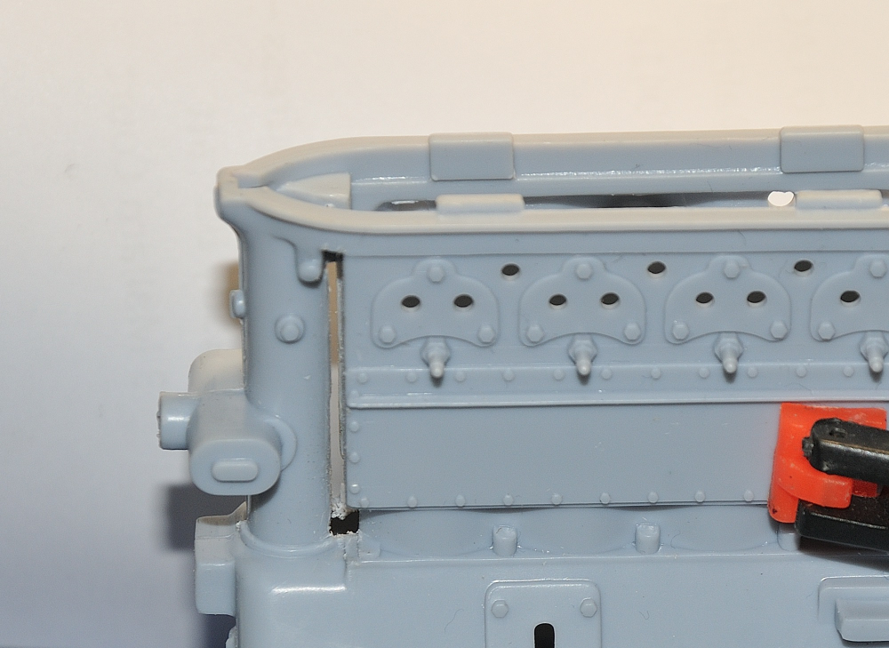

starting with the engine, this is a big lump about 3" tall. the front over head cam drive is by a shaft and bevel gear which is in a housing at the front that should be separate from the cylinder block so first job is to open the gap up
Because the engine is basically 2 parts with the manifold moulded in things like the block, barrels front bevel tube and manifold which are all different colours which will have to be masked off and painted rather than painted separately and added as you would normally do.

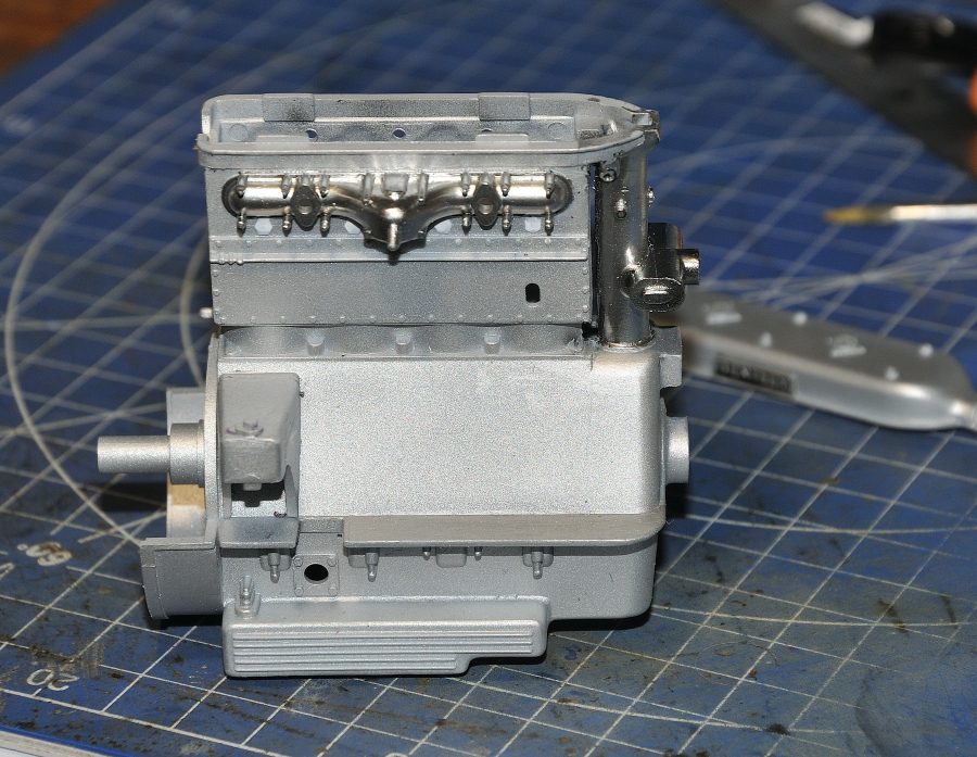

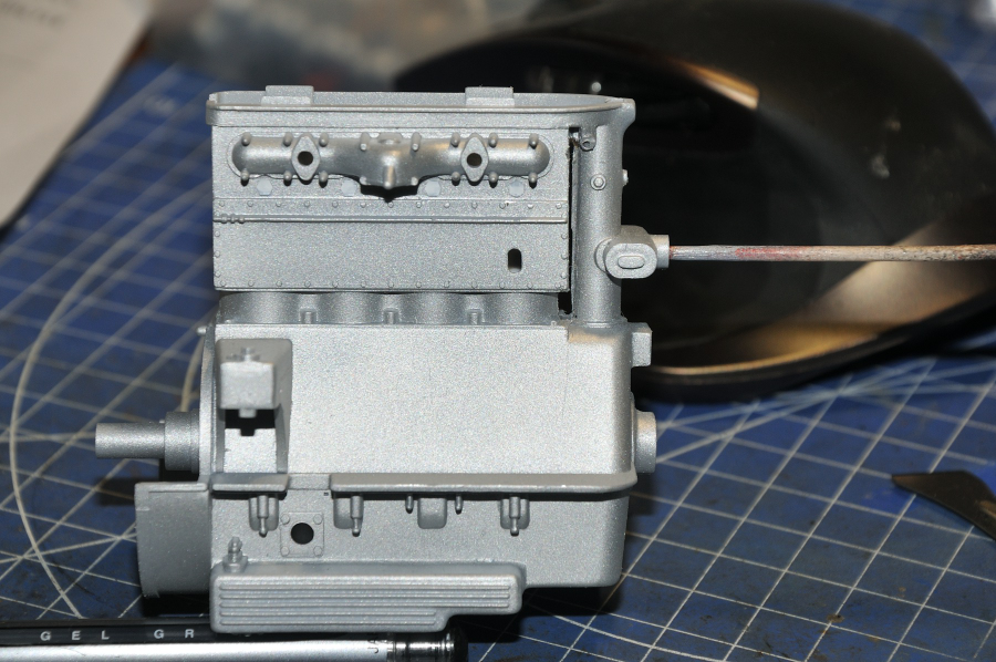

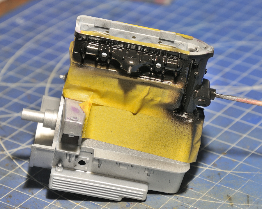

I decided to continue with the engine so i gave it a coat of flat aluminium

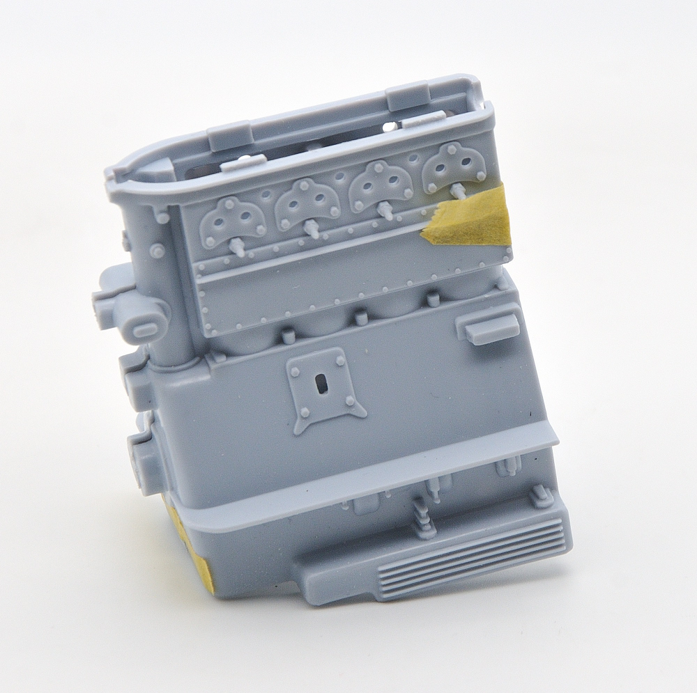

As you can see the inlet manifold is moulded in to the cylinder block and i wanted to make it look like separate part so decided to experiment with Alclad. first thing i did was to cut the spark plugs off, i can add them again later but removing them makes for slightly easier masking

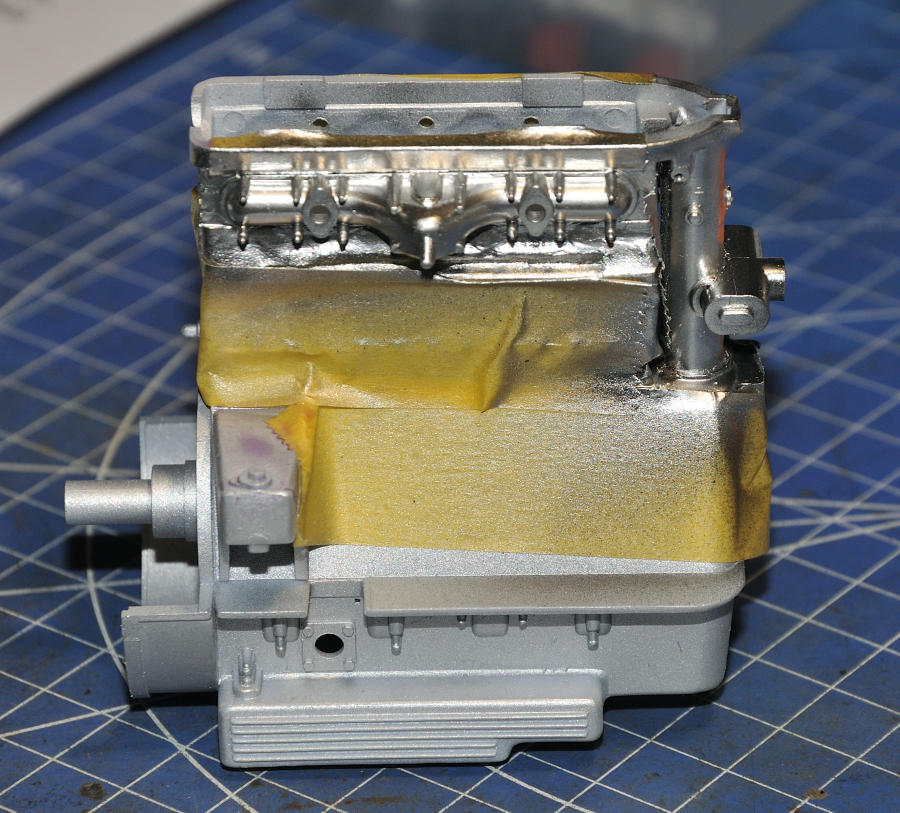

I used Alclads own black base and TBH i am not overly impressed but it is my first attempt so maybe i don't have the knack yet. Masking is by Tamiya tape and humbrol maskol
Followed by a top alclad coat, i used chrome knowing that i hadn't done any prep so i would get a shinny metal finish rather than chrome.
Moment of truth................did my masking work ??
Yes i can live with that, after all its an engine not chrome trim. I need to make some spark plugs now...i thought i could just buy some resin ones but no one has them over here and importing is very slow and expensive now with covid.

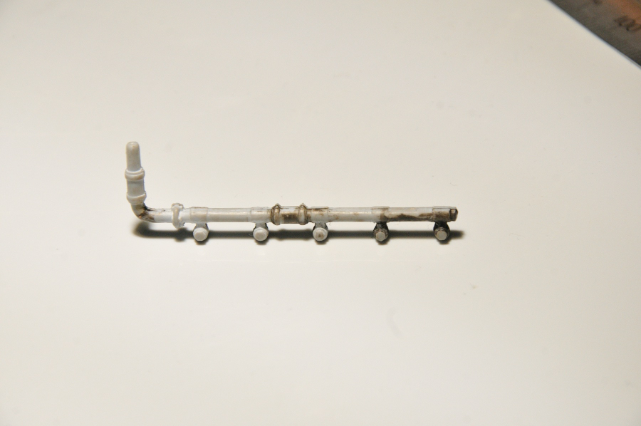

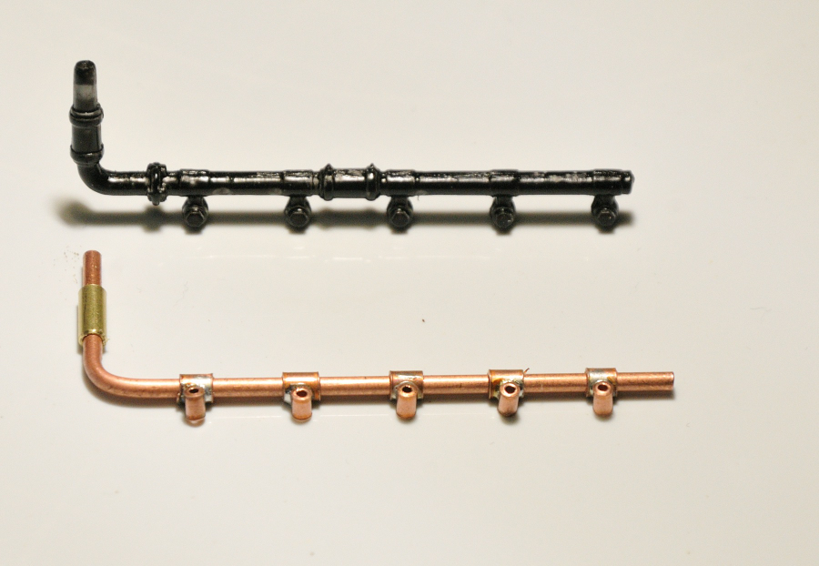

Well i spent most of the week trying to get the chrome off the water pipe
after trying Oven cleaner, caustic soda, spirits of salts, i ended up 3 days in Bleach and got this
It was really still not what i was after. I had hoped there would be more definition to the moulding without a thick coat of chrome but i put a coat of black on it and it looked worse than ever.

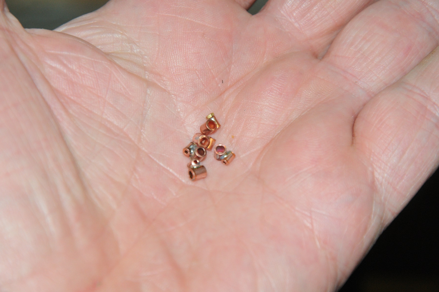

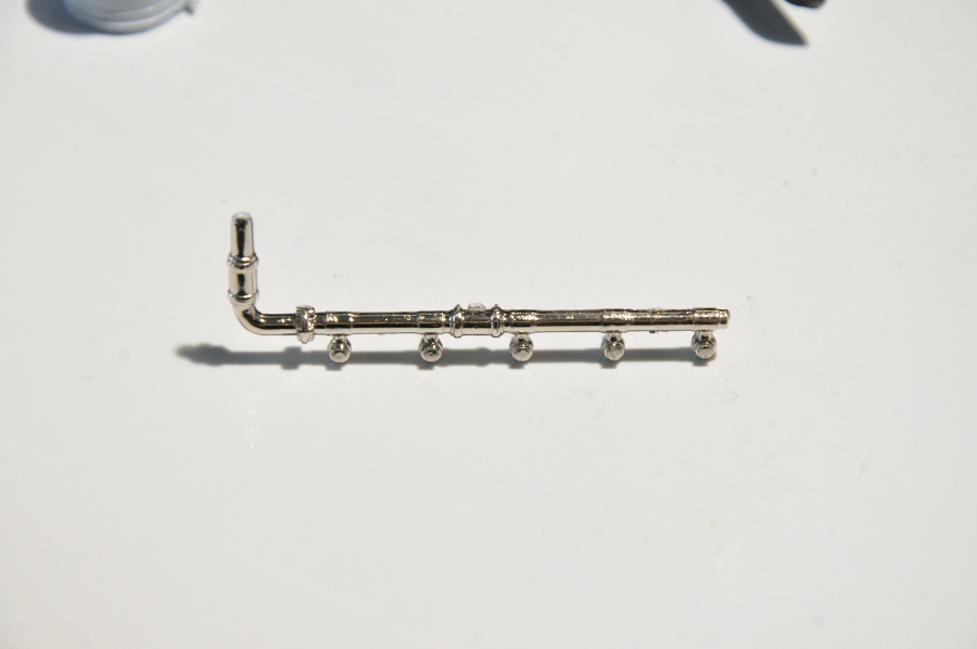

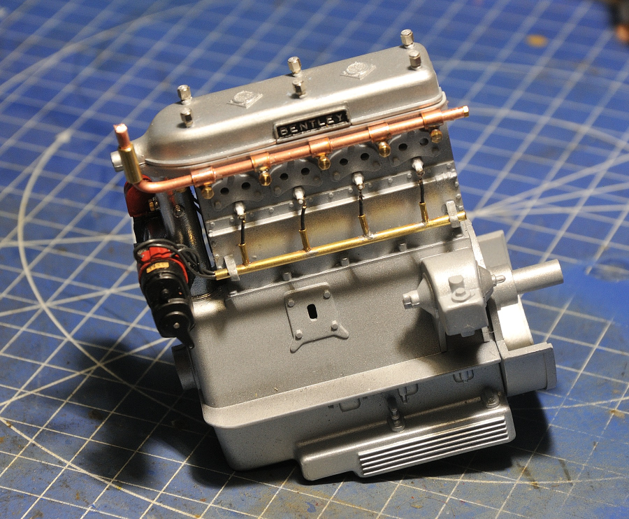

so now i am making one, its very small and rather out of my comfort zone but i think it will look better when its finished.DSC_2228.JPG DSC_2230.JPG
I am pleased with this

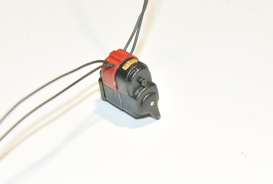

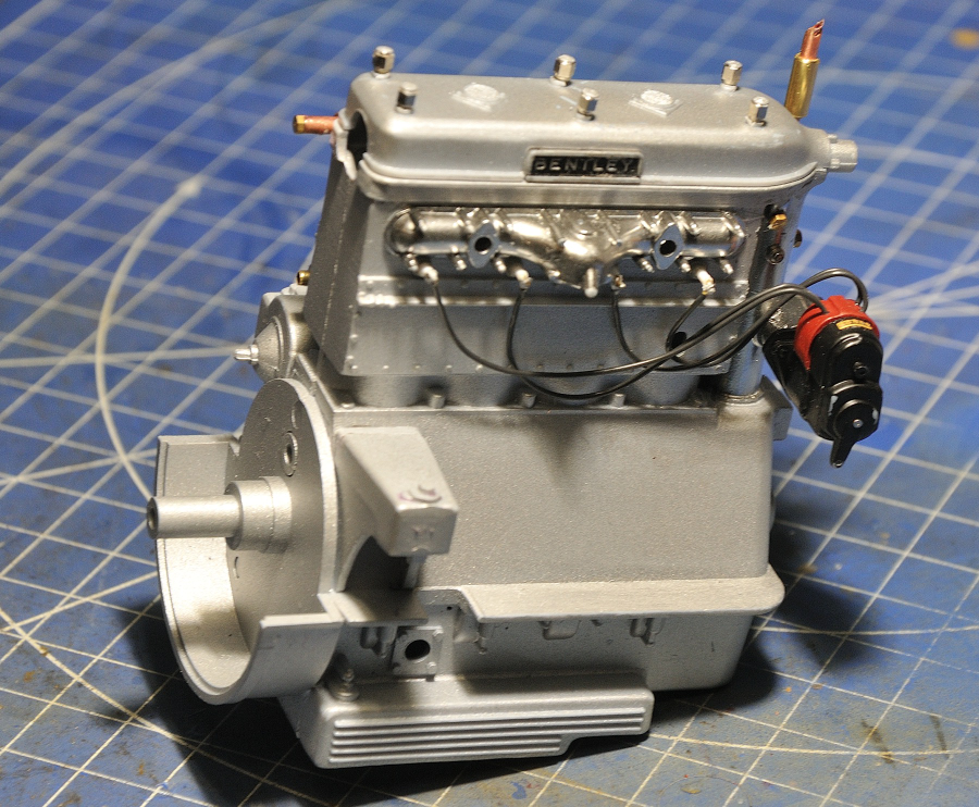

As i say this has twin plug heads so there are plugs both sides. That means 2 magneto's. the plug lead this side are visable but the other side
the leads are in conduit to keep them away from the Exhaust manifold. So you need to construct the conduit. The kit doesn't even reckon on you fitting leads so conduit is not included in the kit
Also now fitted my water pipe which runs from the radiator headed tank to drillings in the head. Looks much better that the plastic chrome job :)
