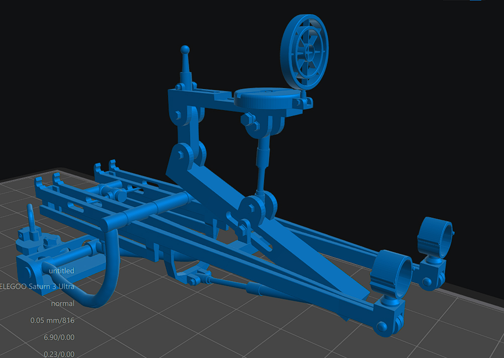

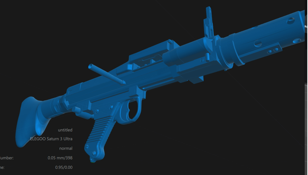

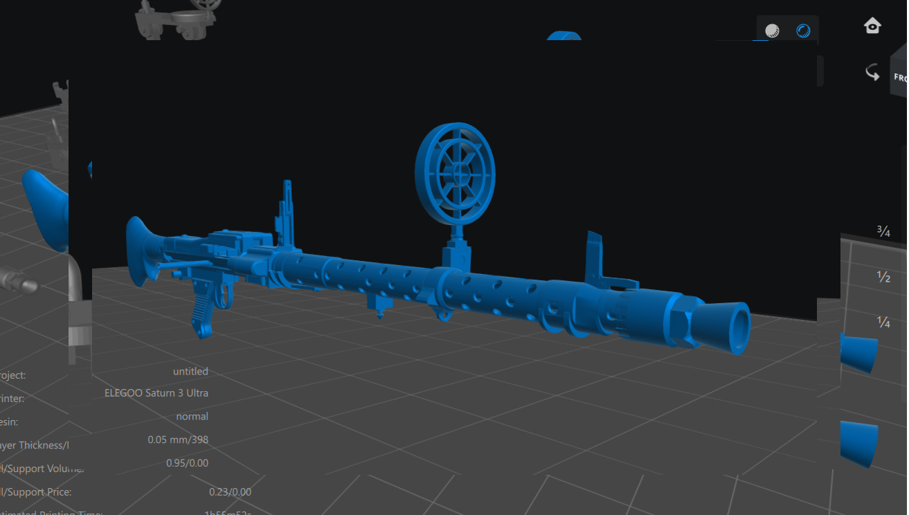

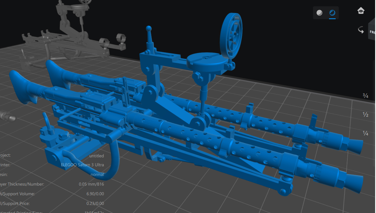

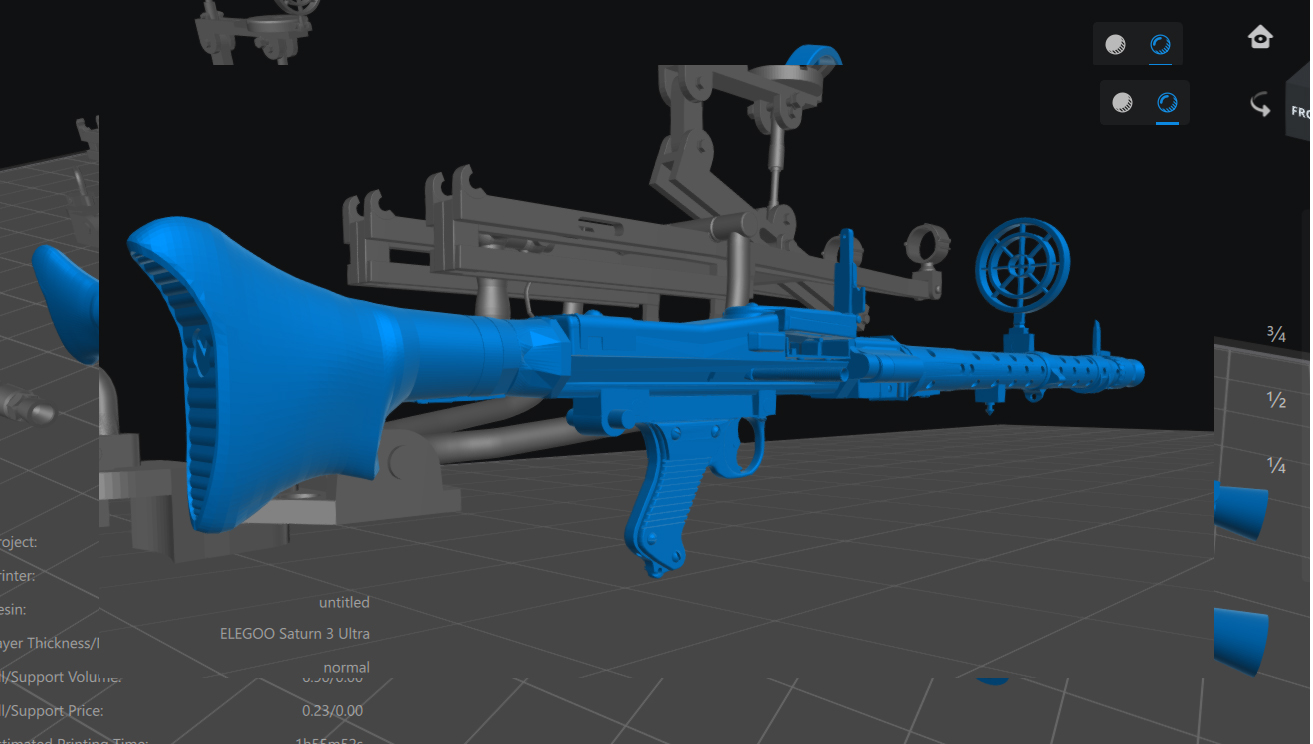

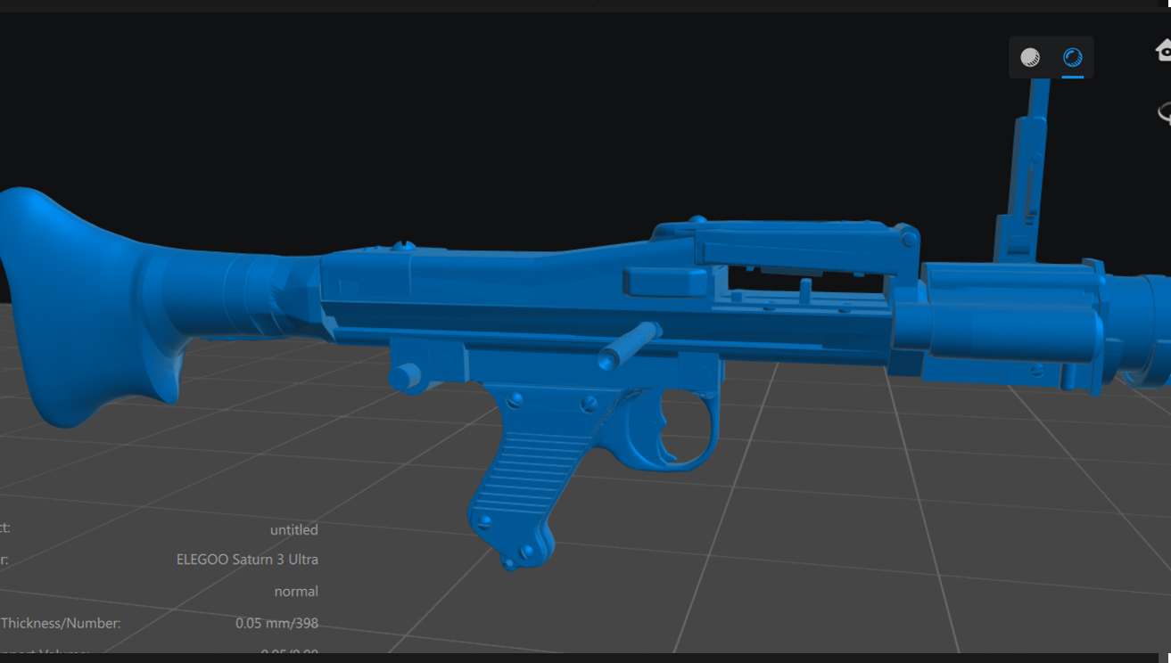

Well, it is better, but I am struggling with a few small parts. I have countless hours in this dang thing LOL. Not kidding, probably near a hundred. All because someone asked for a twin mount MG34 for their tank. I have to count it as a learning experience. The part that is still giving me fits is the stock connector. I cannot shape that right without a bunch of funky surface anomalies and I cannot figure out how to smooth them out. BTW, I never found a twin mount for a tank. I found an anti aircraft chair with twin guns and the spider sight. So, I sort of made the mounting bracket up, based on lots of different real parts. There may not have even been a twin mount for a tank, because I can't find it mentioned anywhere. Single, yes, lots. Searching for double, I've been ghosted. Maybe y'all know of one. I found a very interesting video that shows about six different kinds of tripods, tank mounts (the trigger is based on that video), bipods, etc. I mean, this "looks" like it could have been real, right? Maybe? sorta...

Impressive.
I think what you have here is very close to what it would have, could have looked like. I mean if we were scratch building it it would be a couple of pieces of plastic rod and some strips.

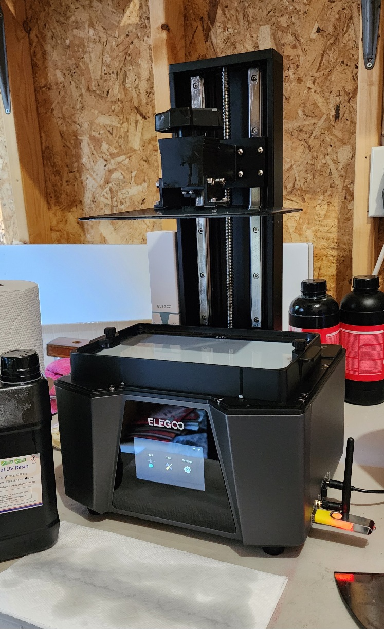

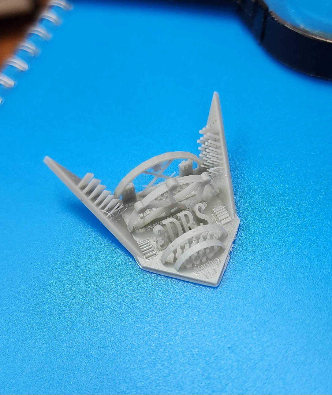

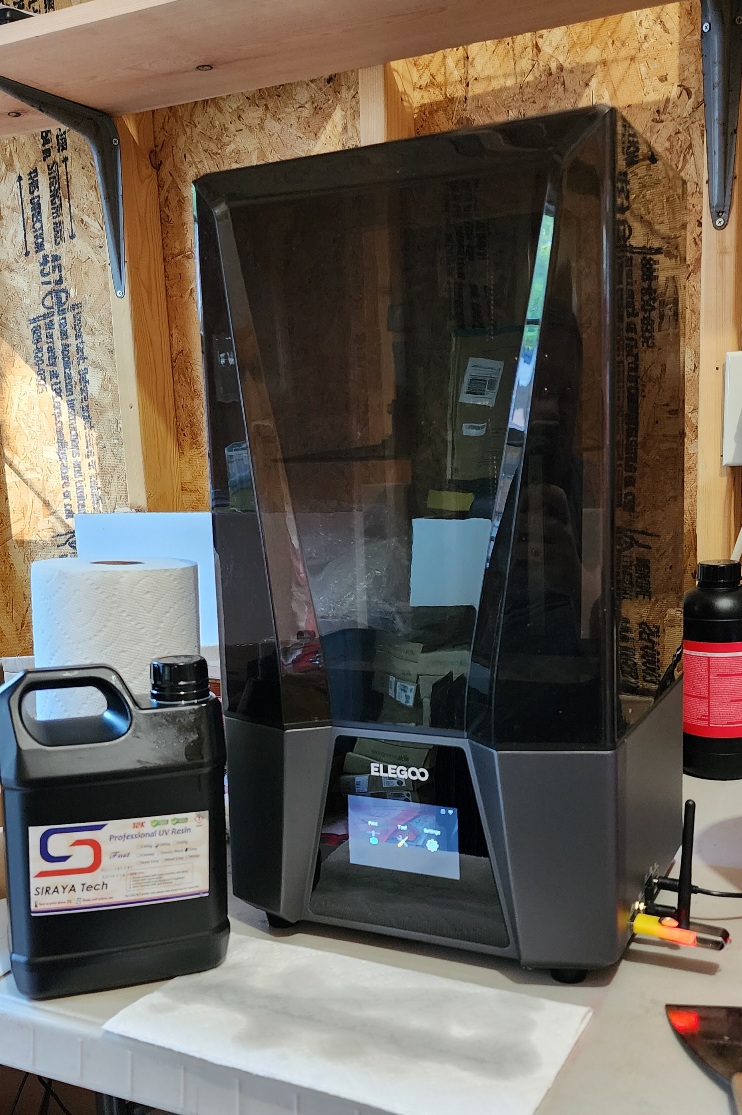

Ok, happy times are here again! The new printer is here. Introducing the Elegoo Saturn 3 Ultra 12k printer. Right out of the box it printed beautifully. I have tweaked the exposure time and am now curing my latest test, but the raw print looked spot on. @jknaus, I really like this resin! Thanks for the advice. I have printed the test spaceship and will analyze it in a few minutes. I am pretty excited to be in business!!
First up is a stamp my daughter needs for her pottery mugs. She makes mugs and steins for a mountain B&B called Cherit Creek and the old stamp has worn ou. Next up would be test printing the MG 34 and dual tank mount to make sure that all works correctly. Following that are the Phalanx CIWS pieces for my ship, and on the same plate I have the parts for the International Scout. Fingers and toes are crossed!

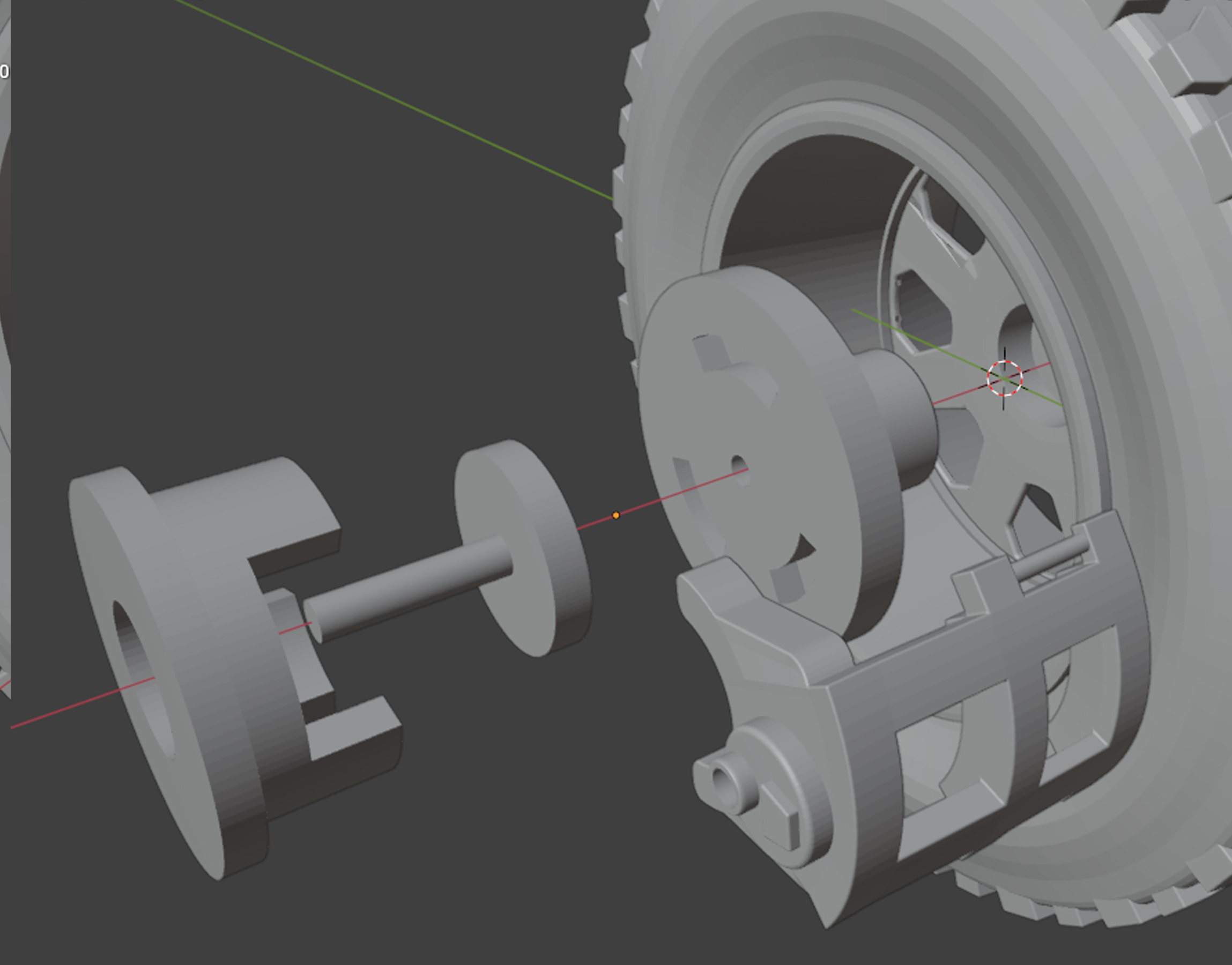

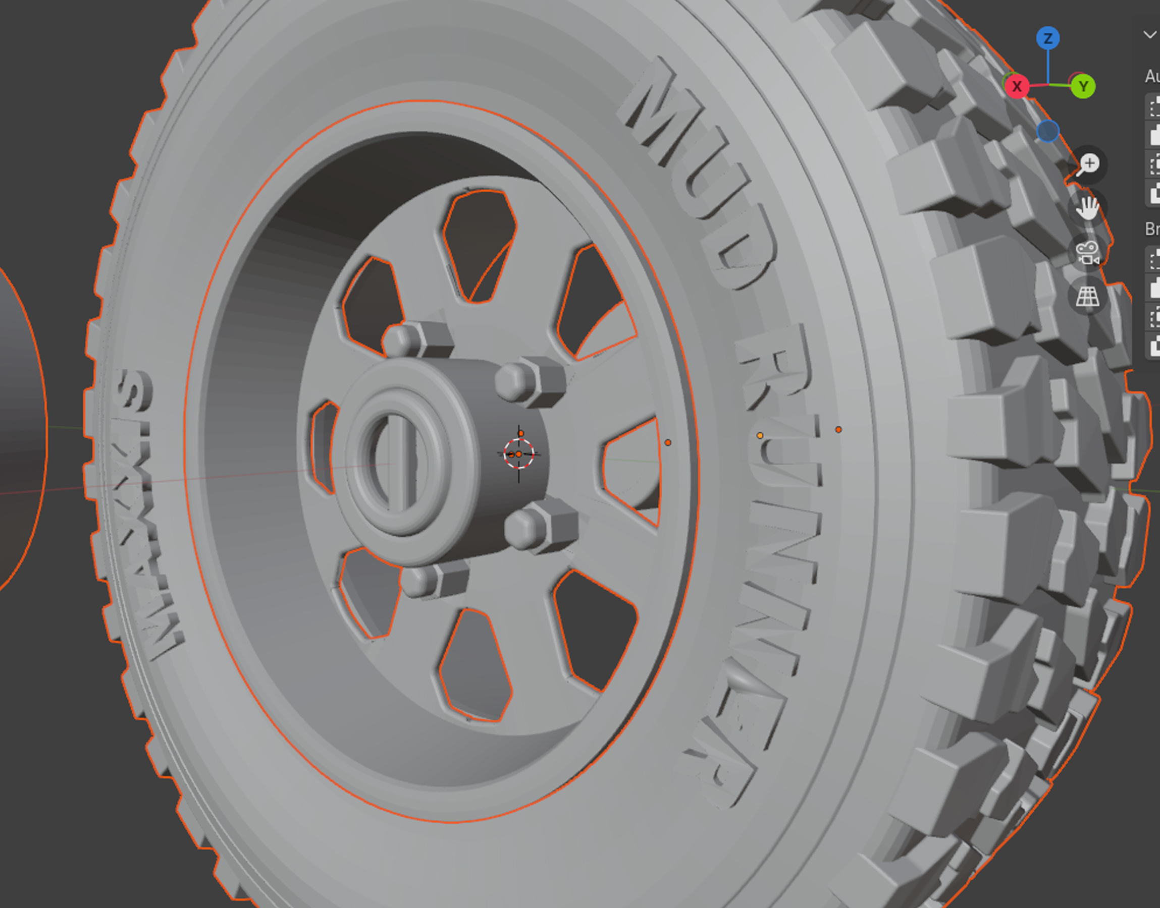

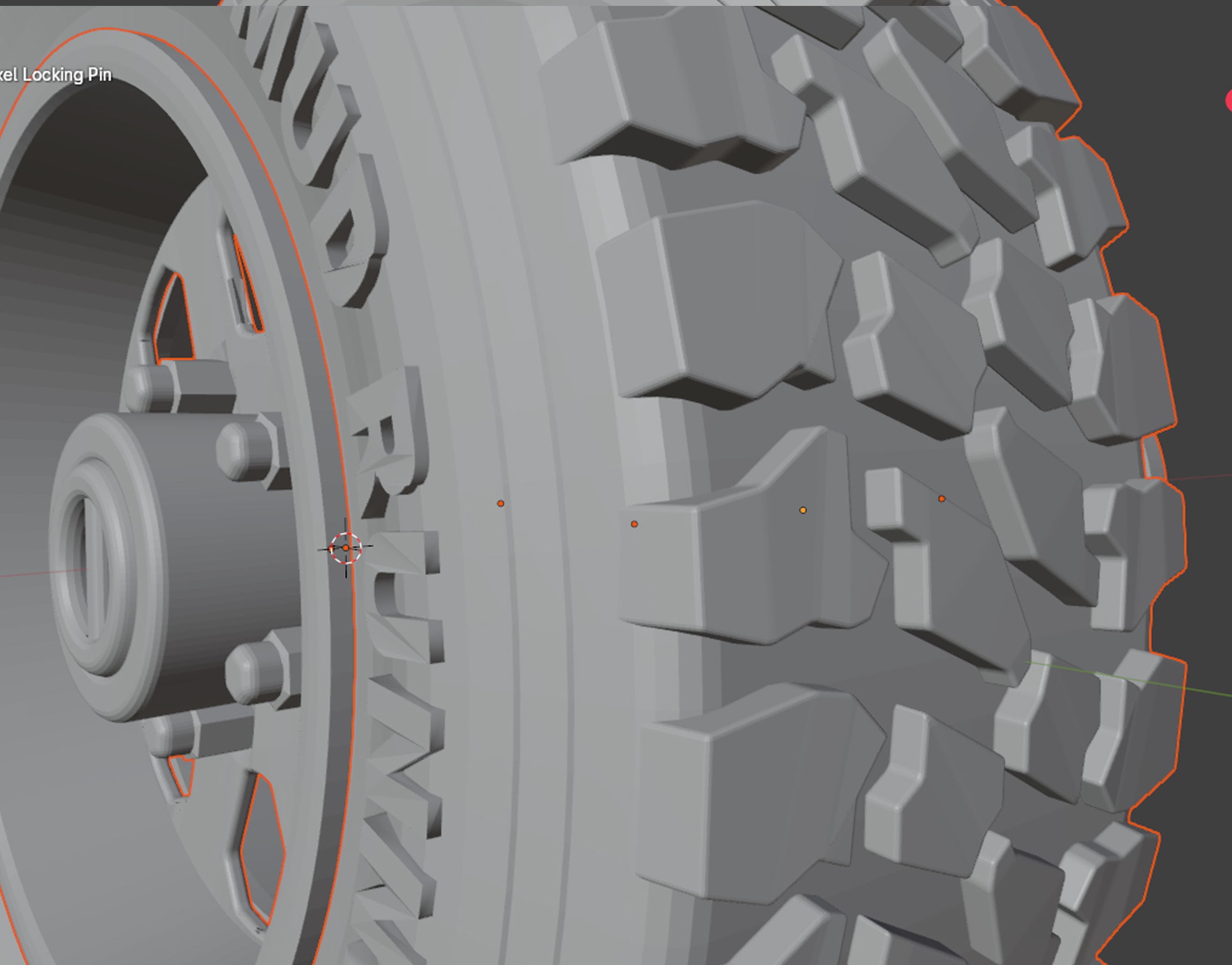

I have had a big learning curve making these tires and wheels for my Scout model. The hubs and brakes are pretty specific to this model. There are a lot of parts I have made for the engine area that could be used for any 1/24/25 scale model. I learned a lot about using the "array" modifier to make one object into multiples and how to arrange them in a circle and stick them to objects. I made one set of tread pattern, which was about 8 pieces, then repeated them around the tire cylinder. The Shrinkwrap modifier made them stick to the surface, and "solidify" gave them thickness. Cool stuff. I have not printed the tires yet. I will print them in flexible rubber-like resin but have to test print parameters for that resin before committing to print the real thing. The hub parts printed very well and "should" make the wheel where it spins freely. The disc brake caliper is a hybrid design so that it fits with this model and does not exist IRL. The tire name also doesn't exist as far as I can find, but it should!
