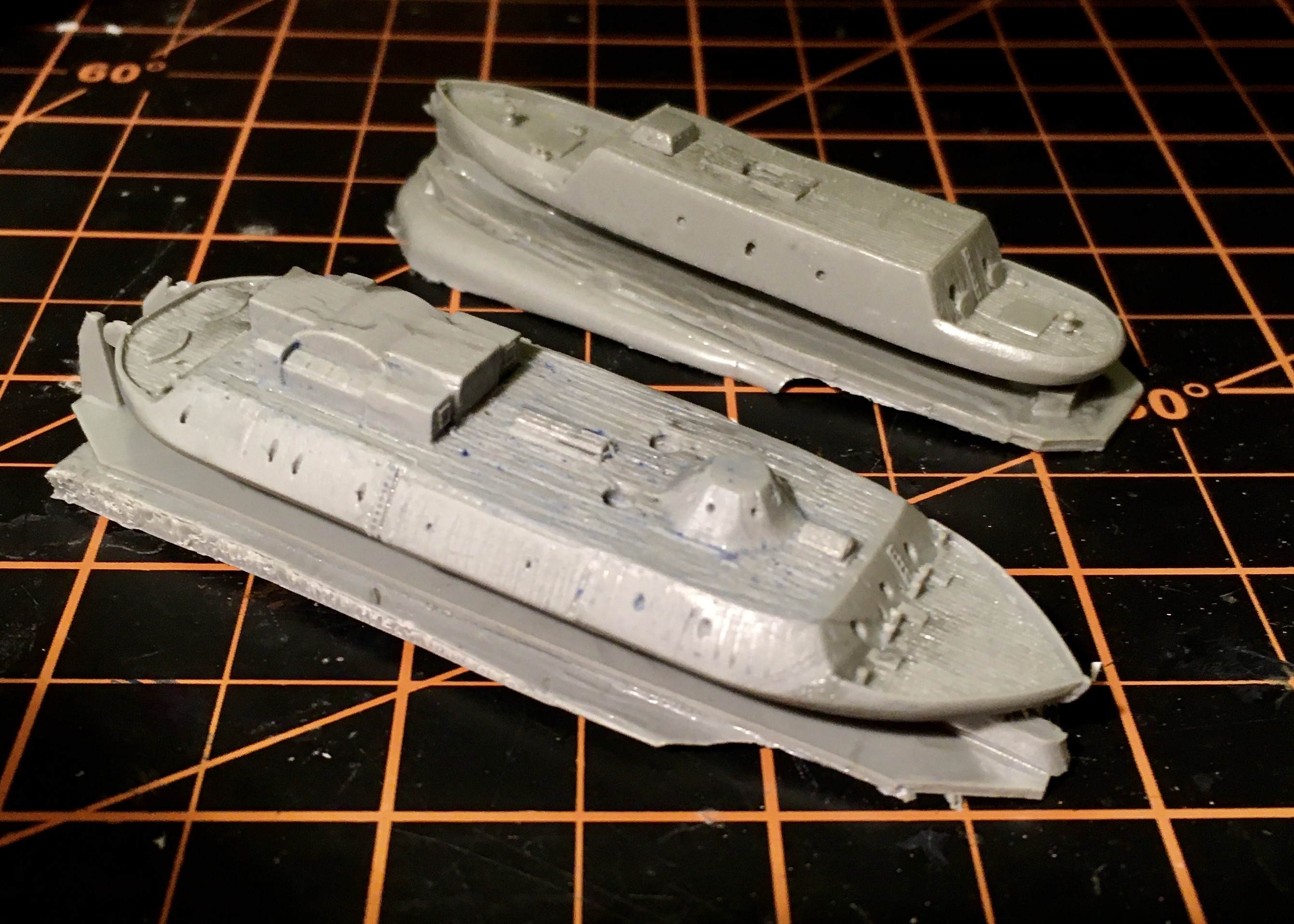

USS Carondelet 2.0 is casting tonight. 40ml of poly-plastic is a God's plenty for both Ironclads and their parts molds.

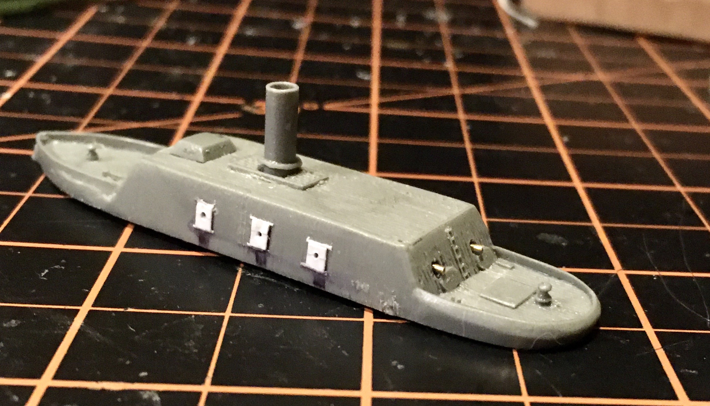

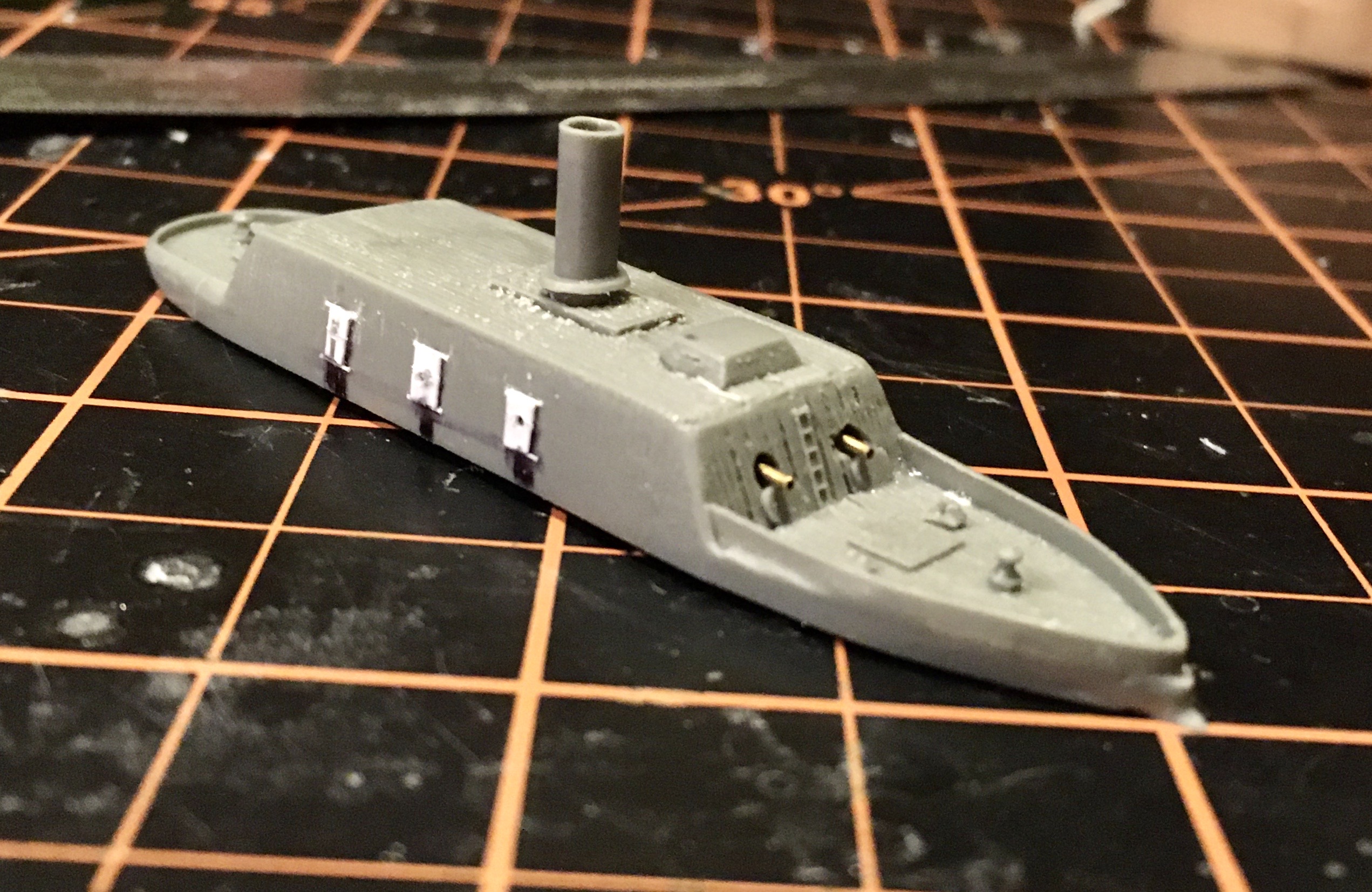

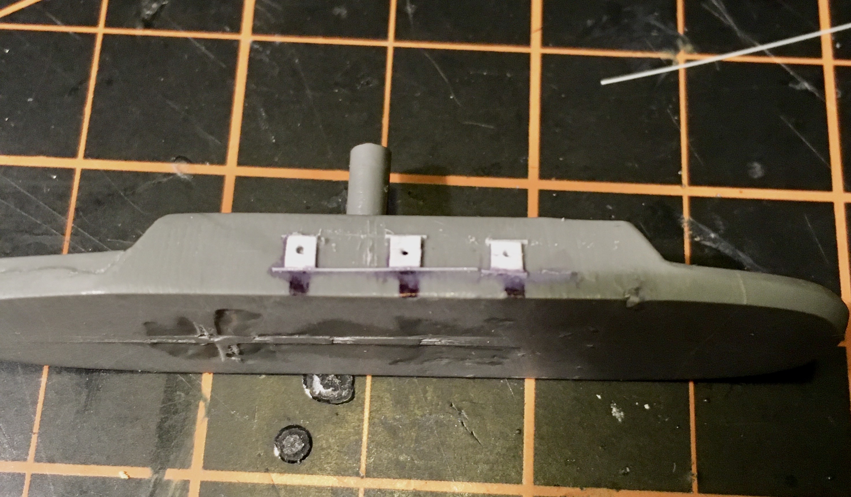

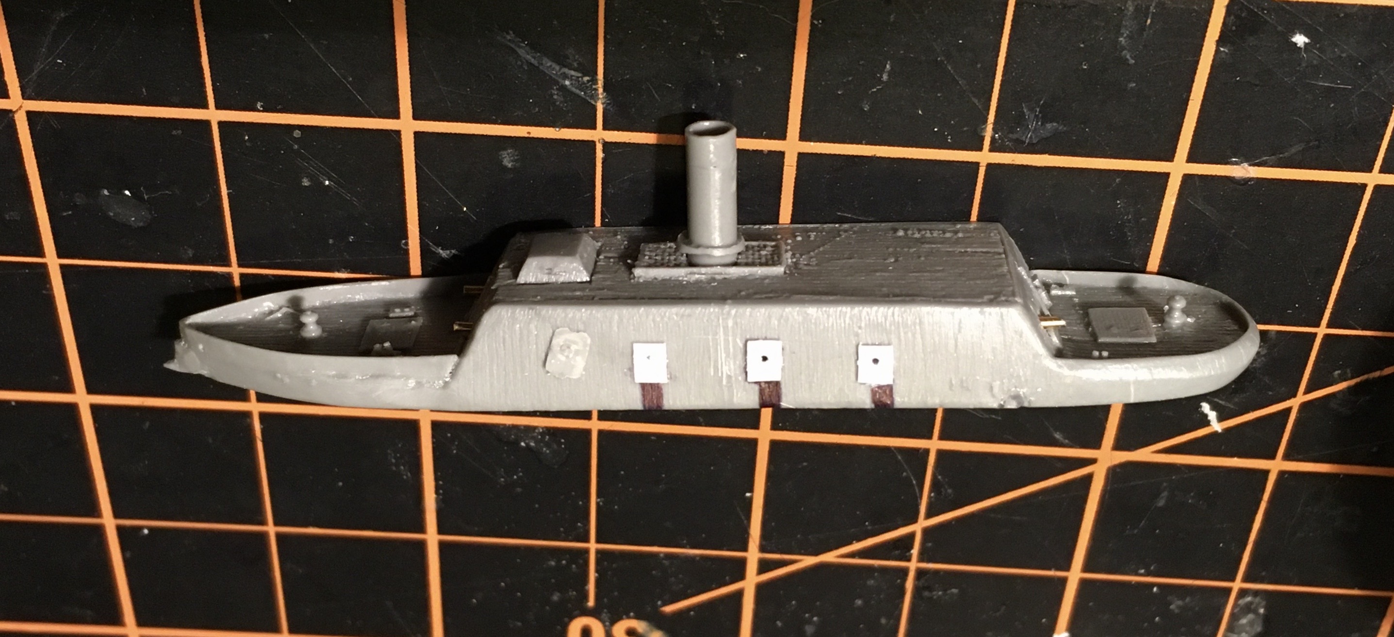

Molding and casting PE gun port hatches is kinda cool. Actually putting them on the model proves impractical. Gentle 600-grit wet-finger sanding yielded unsatisfactory results. The little bastiges got so thin they would blow around the work mat, then snap when picked up to install them. Evergreen .010 X .100 strip to the rescue!! Cutting 3/16 bits of strip and CA gluing them onto the casemate sides was much more forgiving. Stretched sprue for upper & lower hinge details. Tamiya thin sticks the thin sprue to the Evergreen strip hatches, but not to the poly-resin ship.
Drill & scribe the gun port hatches, Roberts your Uncle, Fannie's your Aunt, PROGRESS!! Bow & stern chaser guns are installed too.

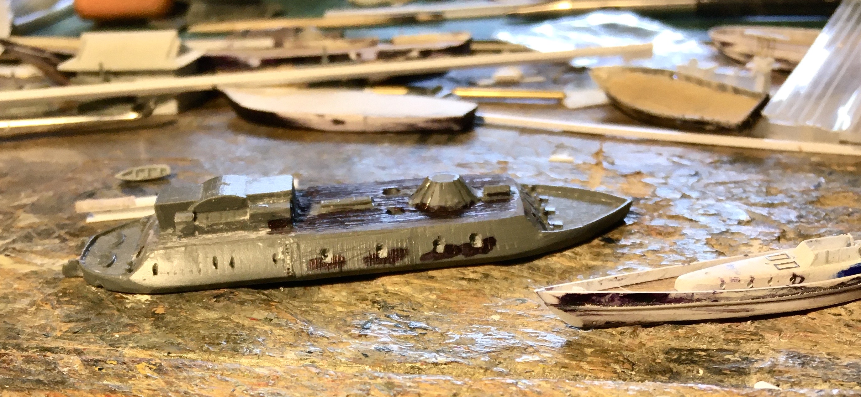

This casting had a small imperfection in Her port quarter and was damaged coming off the pour stub, making her The Builder. I'm having a really good time with this CSS Arkansas. She and her Union antagonist should debut at the Fartin' Flea's show in April.

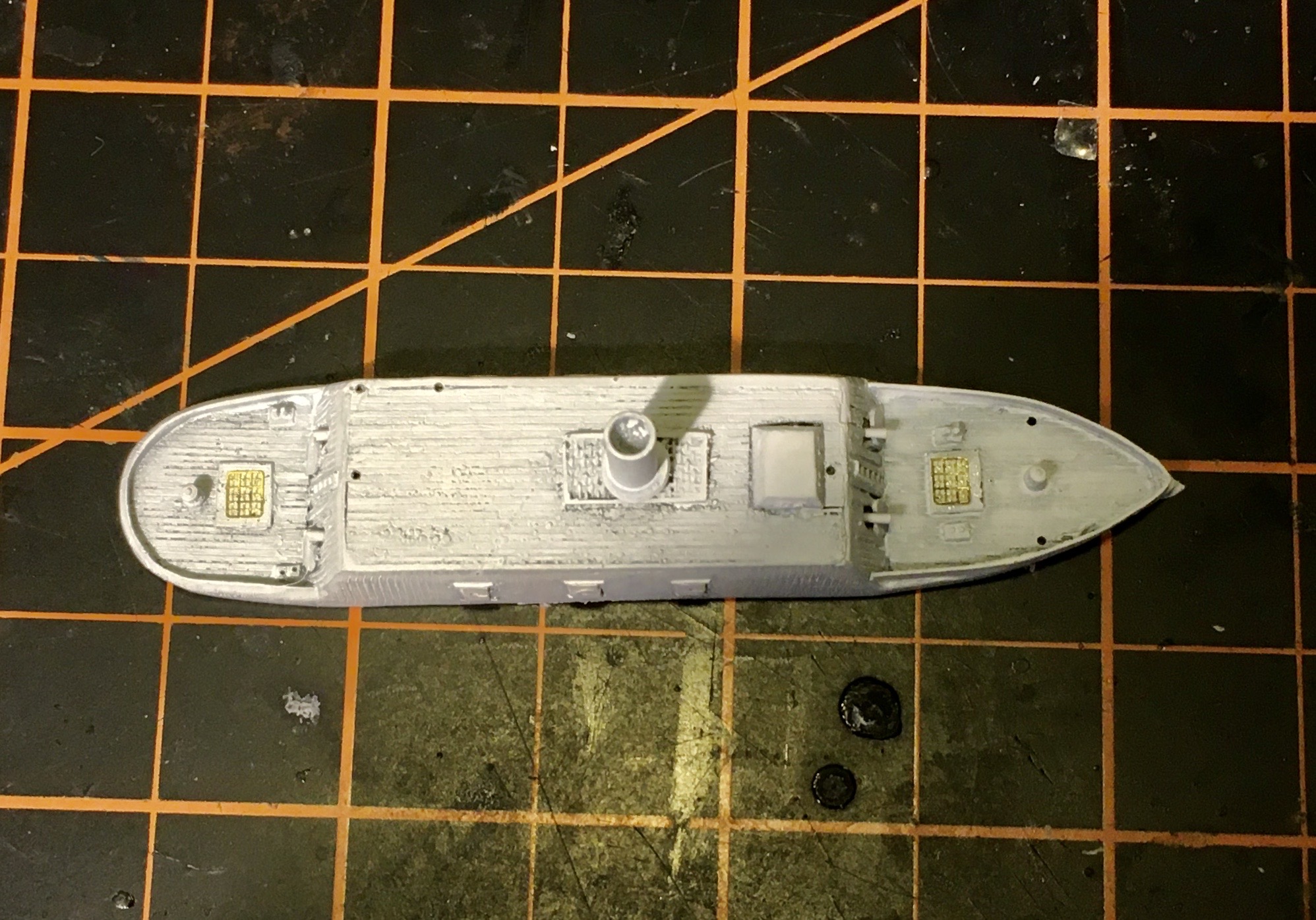

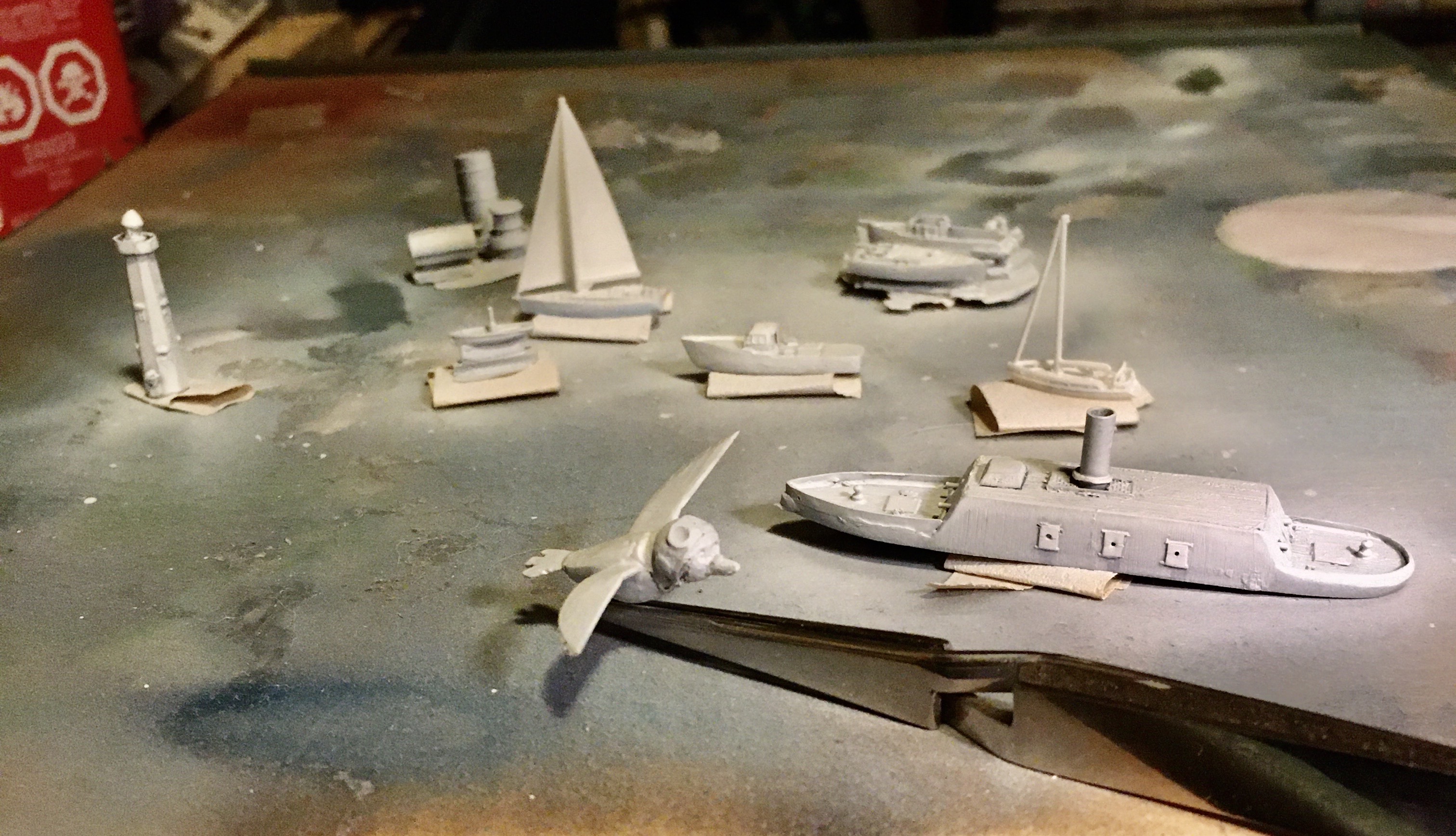

I tried out my Stynylrez white primer tonight. It sprays pretty well. I had some help from other modelers I respect.

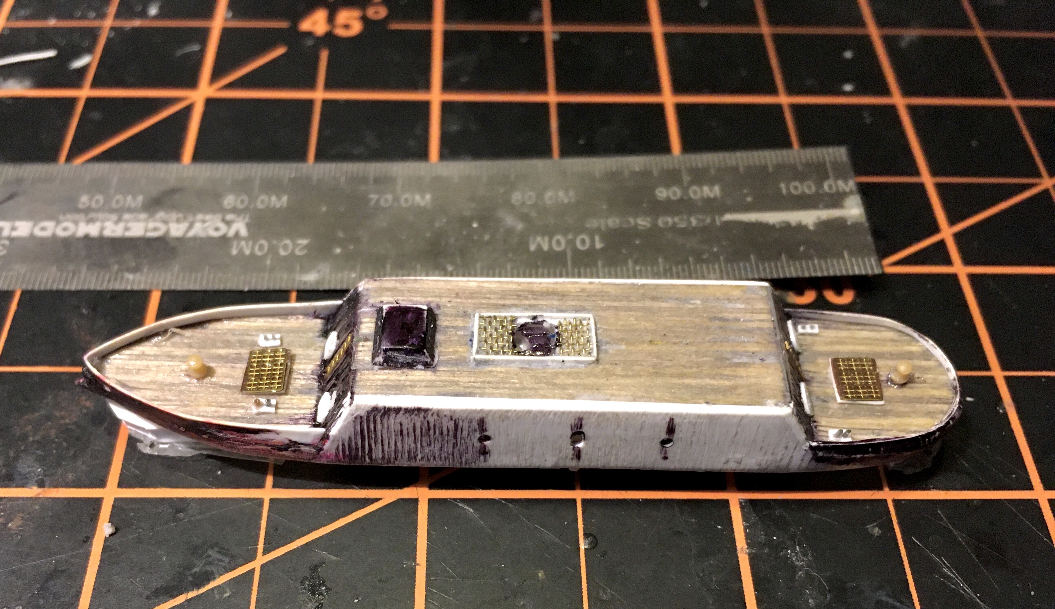

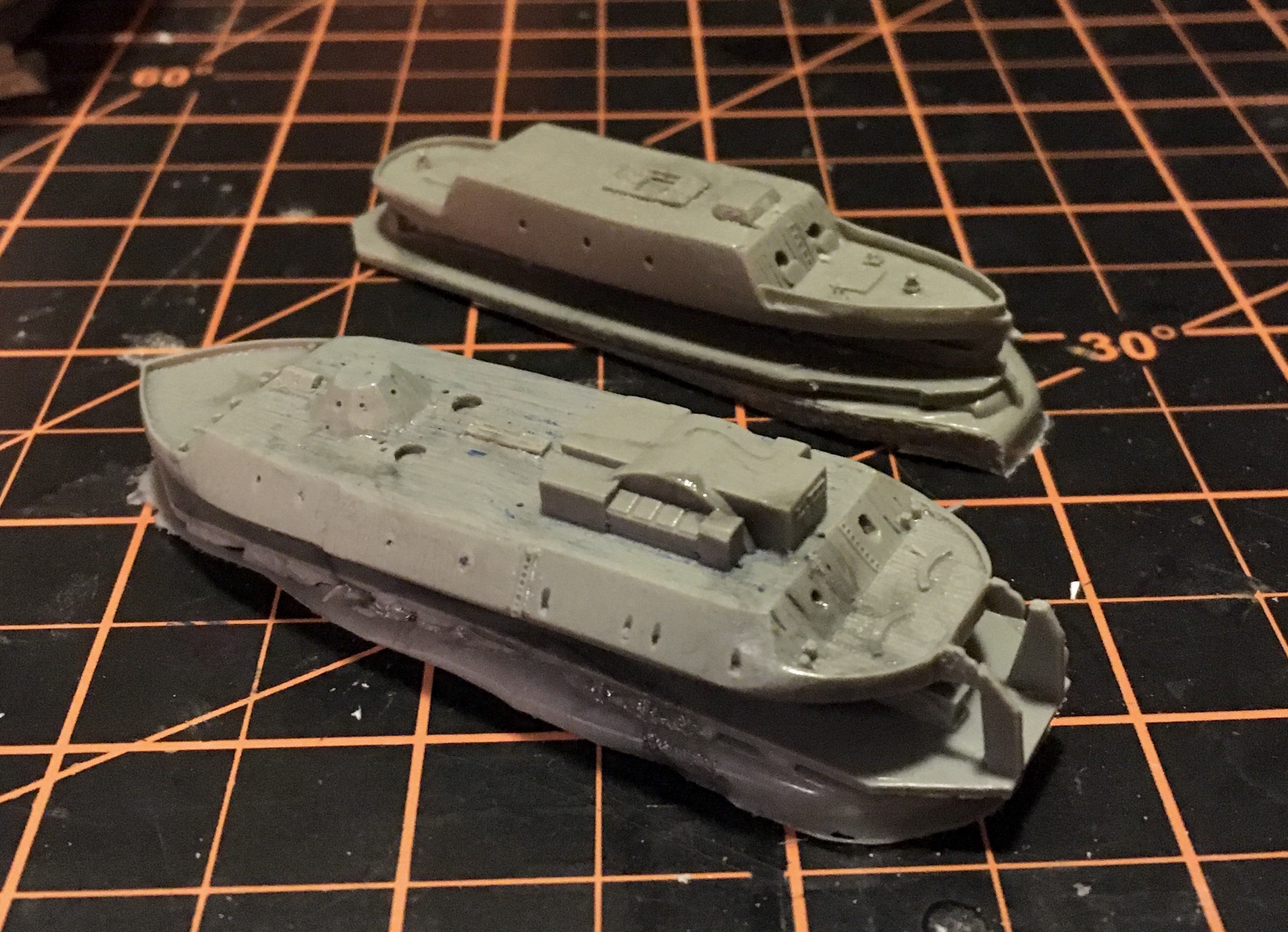

CSS Arkansas will be getting a 2.0 mold upgrade. I was really thrilled with how the fine laser-etched hatch grating detail looked. It is so fine it doesn't survive primer. See here the PEE gratings in place on the box-art version for the set. There a couple of other minor flaws to address as well. Anything worth doing is worth doing well (twice). Don't you agree?

CSS Arkansas 2.0 master. The PEE hatch gratings should stand out better when molded/cast. A couple of other small glitches got improved as well.
