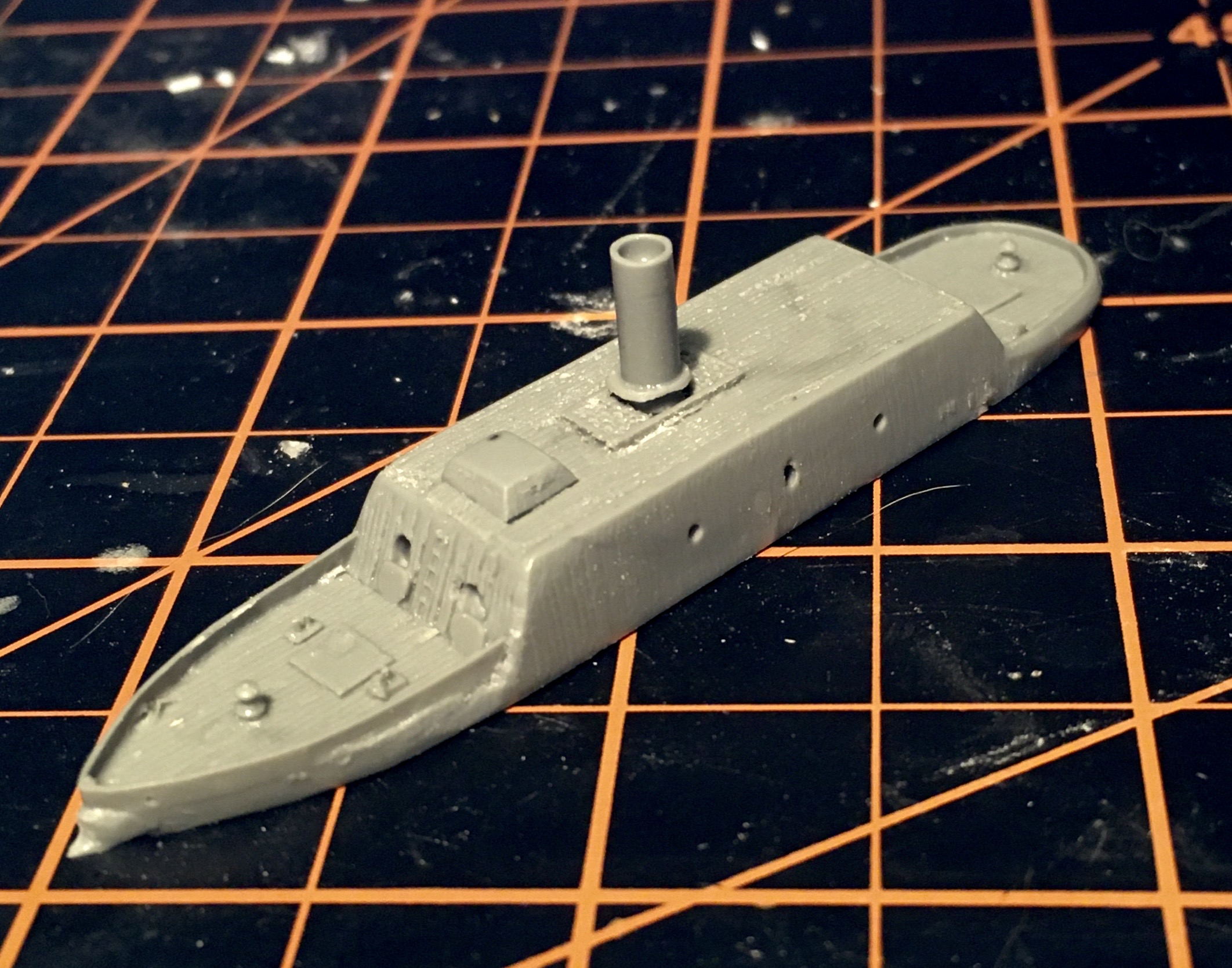

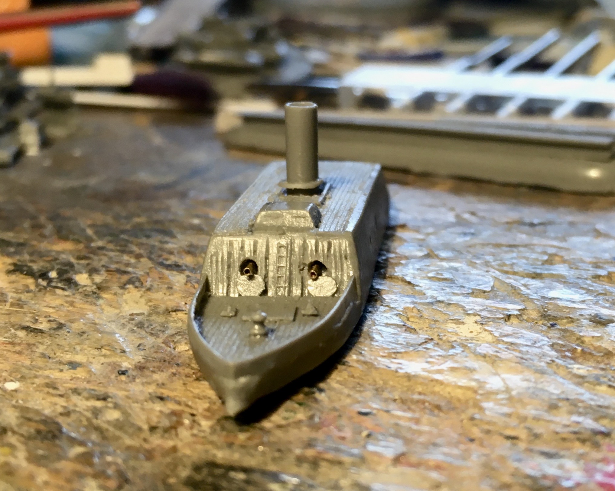

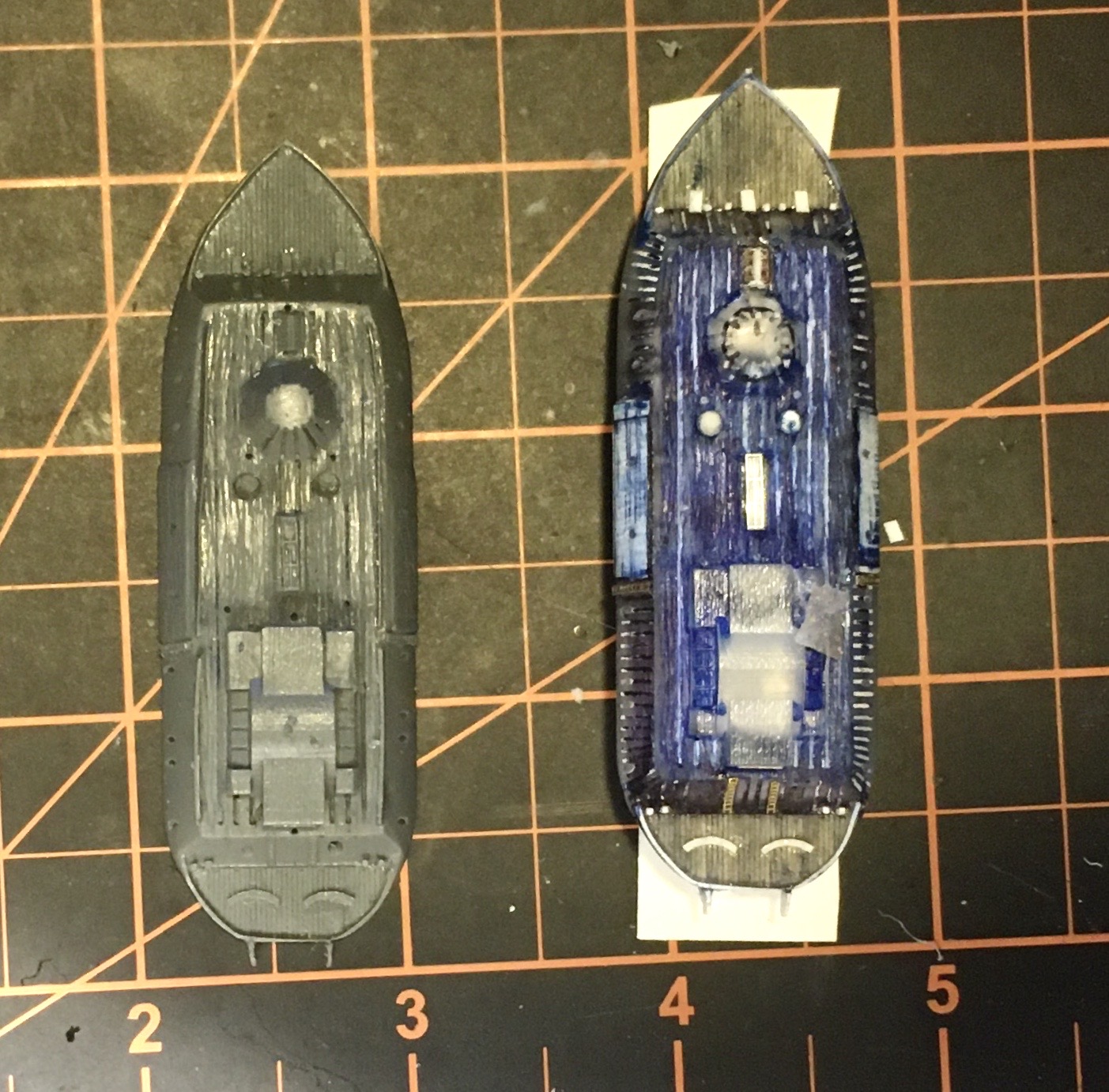

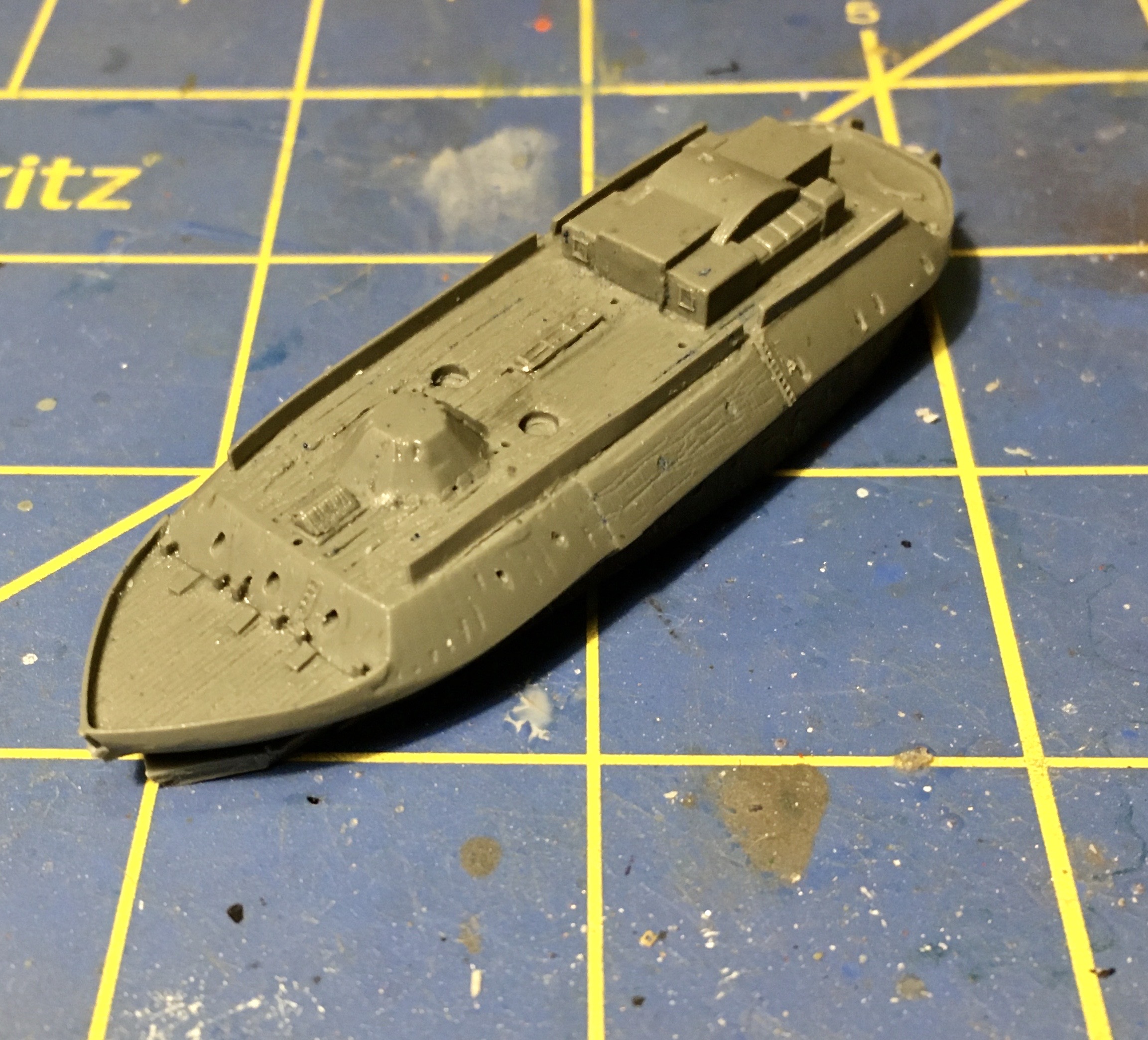

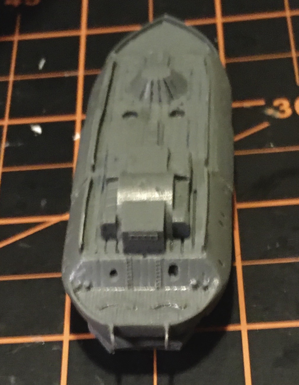

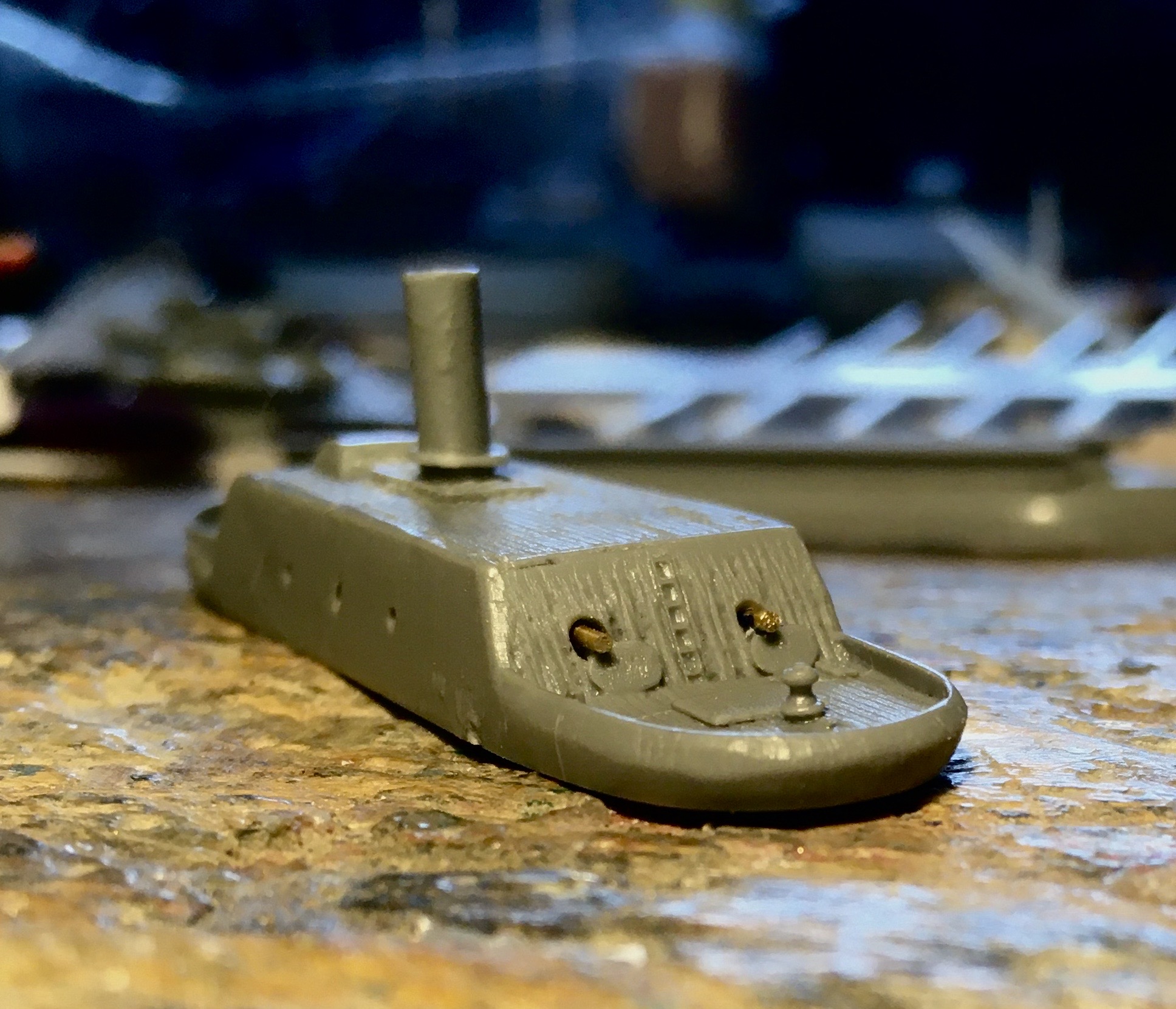

The first USS Carondelet casting revealed several flaws in the master I just cannot leave alone. (Big Surprise #2!)
First, the gaps and lack of view ports in the armored bridge. Seam? Yes. Trough? NO!
The main deck had several gaps I missed, look at the stern between the paddle wheel house and the after casemate face.
Those solid rail-lookin' thangs on the casemate roof were structures filled with rock to provide cover for Union crewmen from Confederate sharp-shooters. The originals are too thin and too tall. I know USS Cairo (pronounced Kay-ro) had them late in the war. No evidence supports USS Carondelet having them at the time of the 1862 Yazoo River battle with CSS Arkansas. They're GONE!! I didn't like the way they looked anyhow.
The midships casemate belt armor had several horizontal scratches that needed corrected and the midships cannon ports were too high.
The forward deck blast plates were way too thick. .010 styrene and p/e metal are almost the same thickness, so I used with the styrene.
The starboard side forward corner of the paddle wheel house got sanded off while repairing a C/A Glue mishap. Th That got squared away right riki-tik!

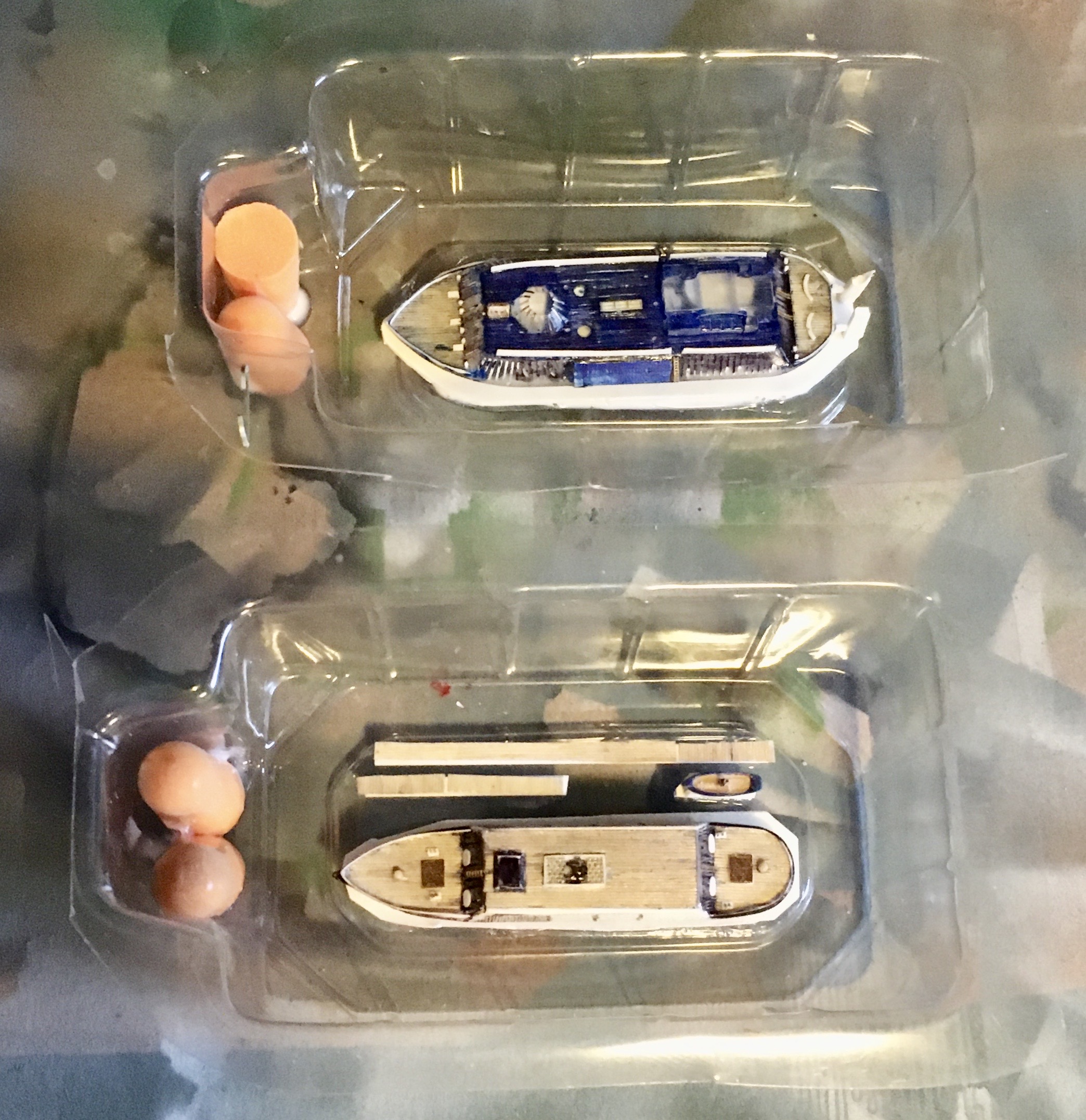

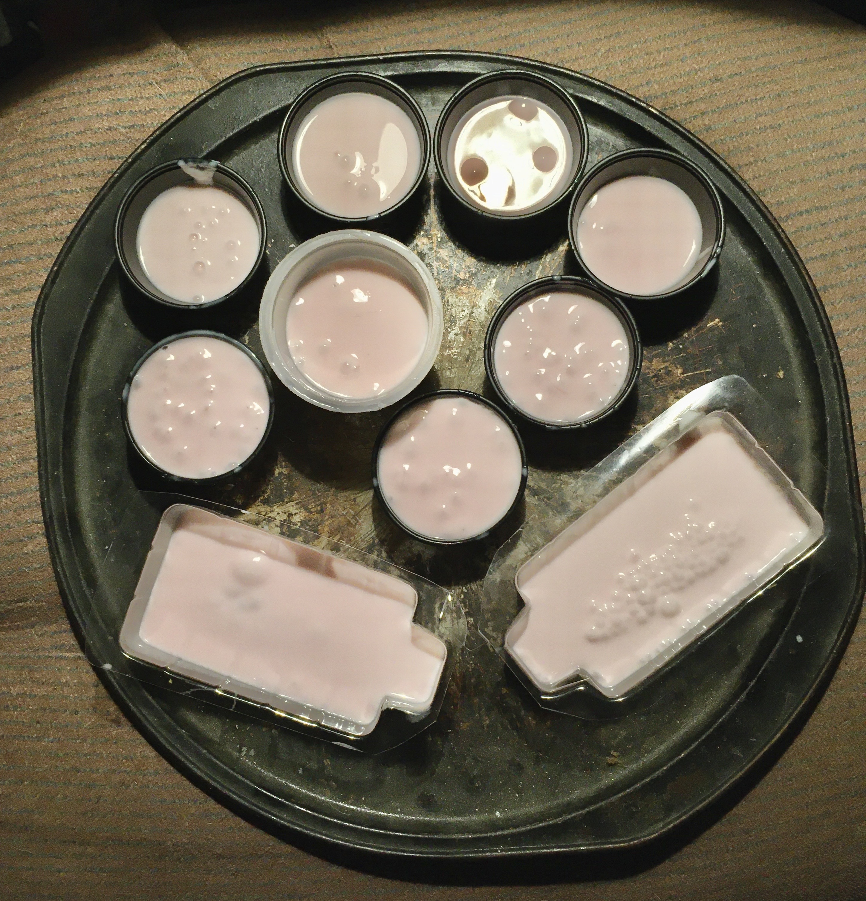

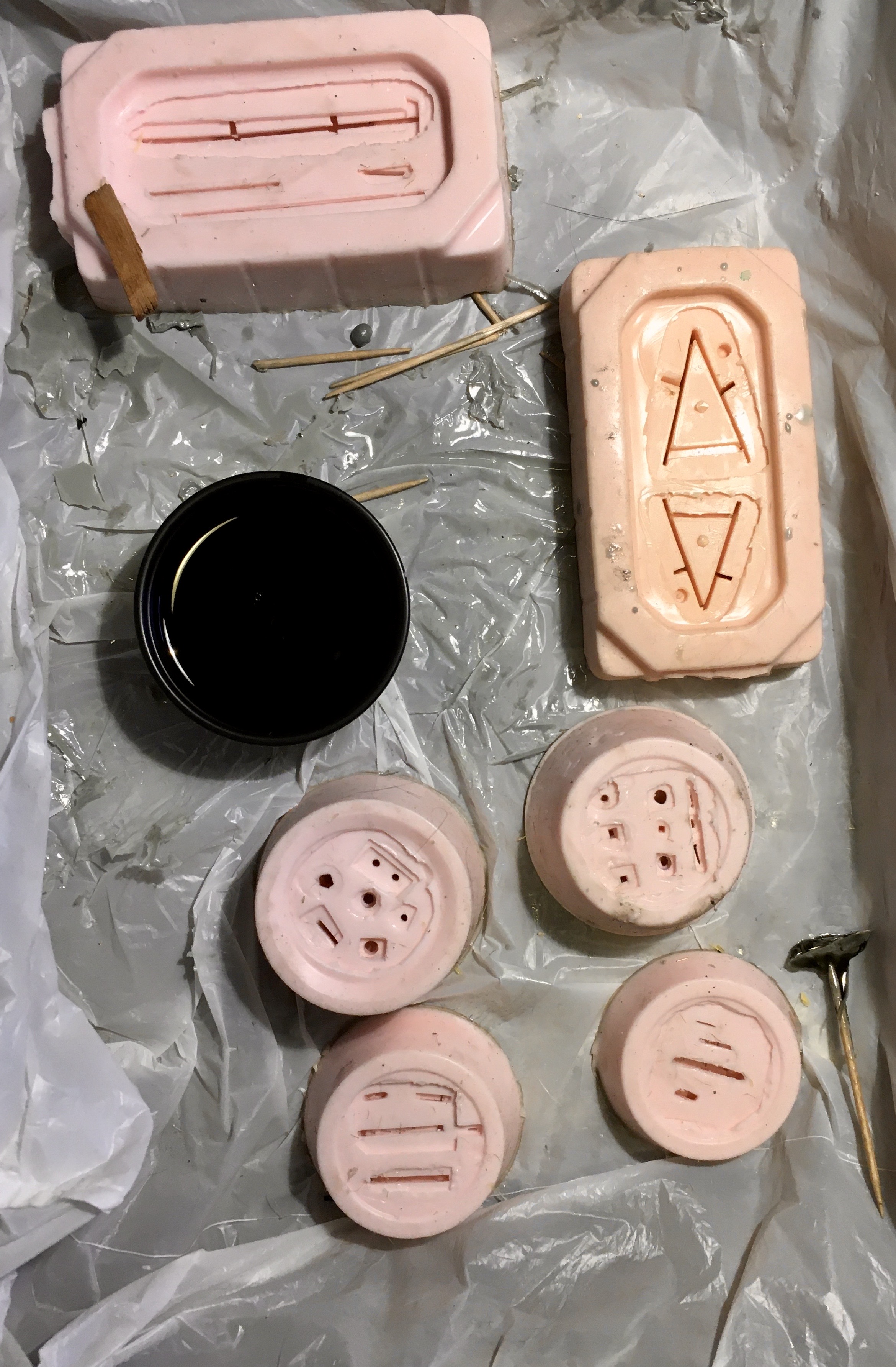

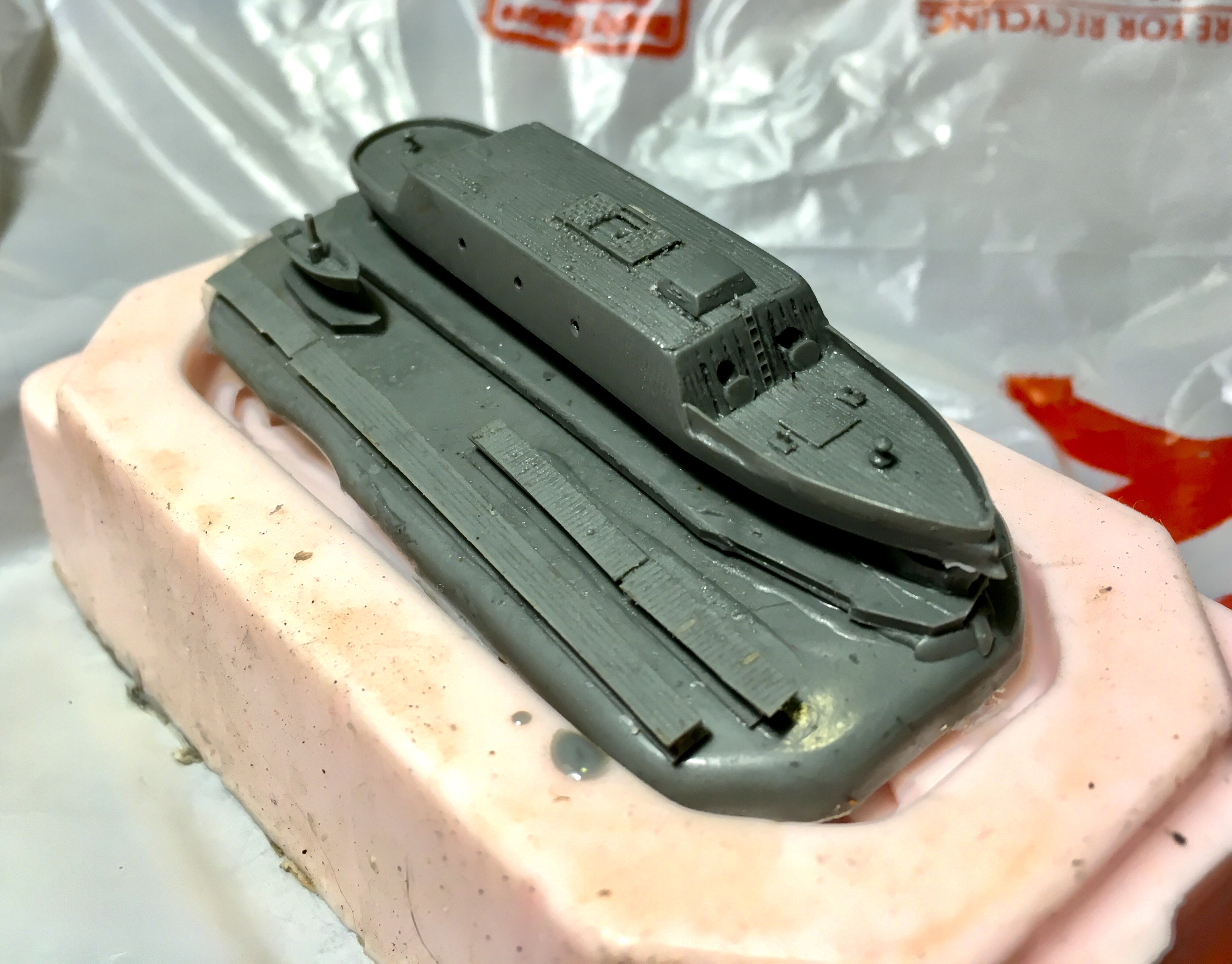

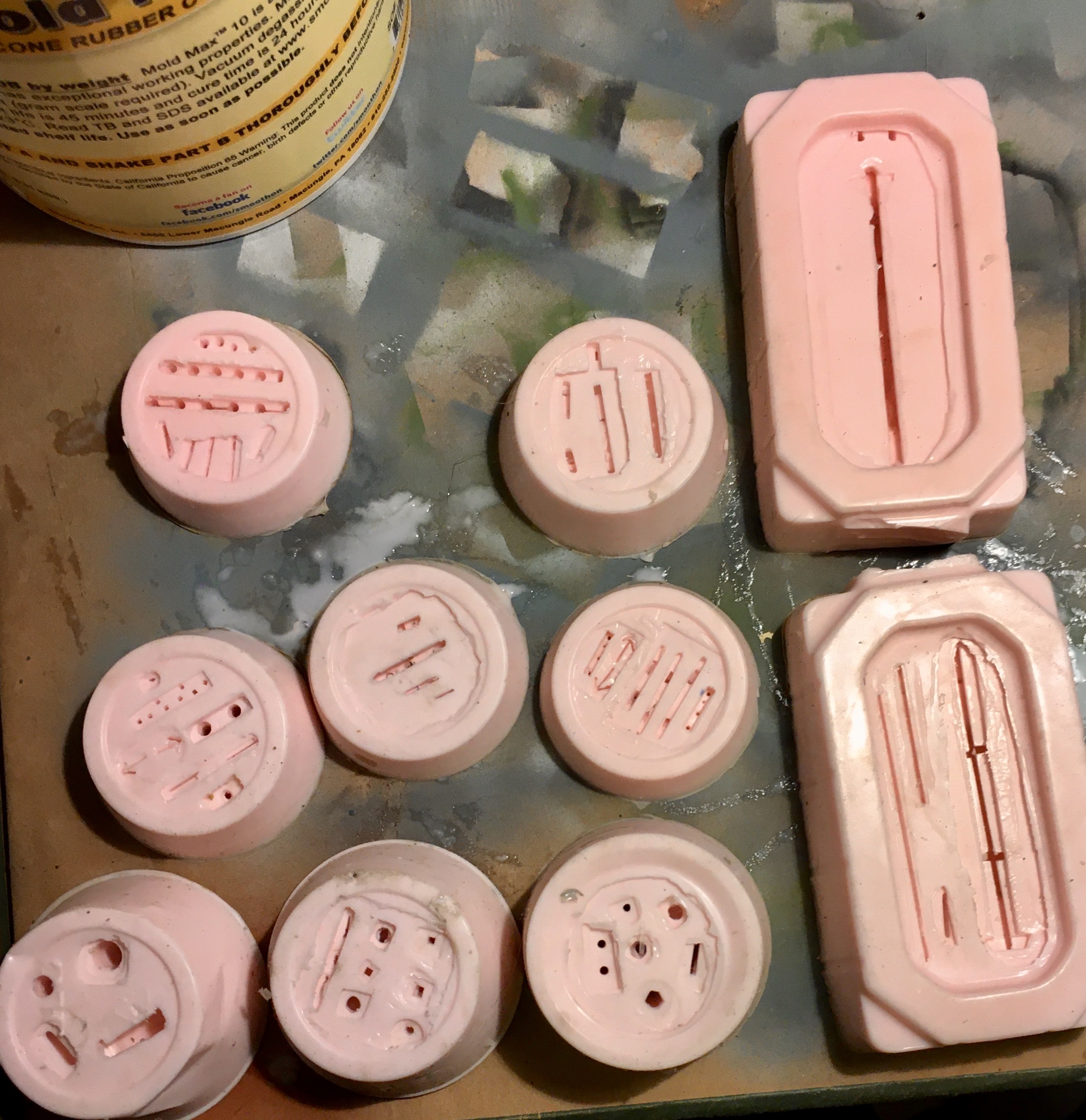

To help the model mold more readily. I raised Her another 1/4 inch from the mold base. This should allow the Moldmax 10 RTV to pour in and air to escape easily during molding.
Molding and casting, not so unlike life, is a learning process. The USS Cairo (?) mold will be used as a teaching tool.
