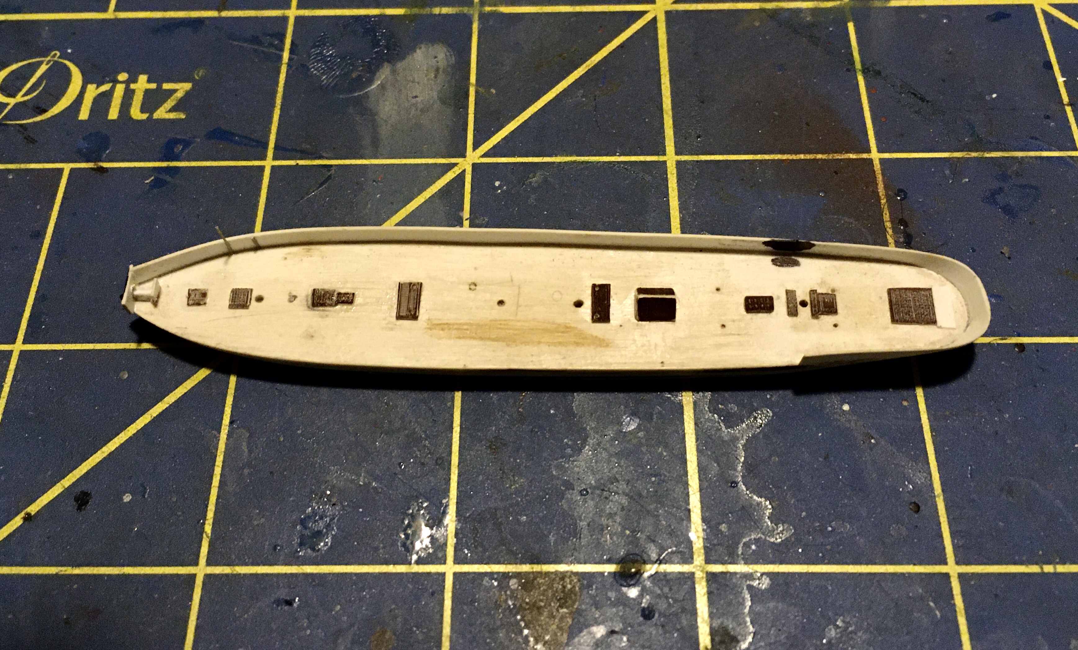

CSS Alabama with all Her laser-etched details in place. Her bridge will be a separate part with ladders going up each side of the main deck to it. Once the glue cures out, I'll re-texture the faux deck planking near the skylights and hatches and scribe around them for relief. Gun ports will be detailed inside and out of the main deck rail. Once I attach the portside main deck rail, I can start on Alabama's forecastle details. I cain't decide whether the base of the smokestack will be part of the main deck or stack. :hmm:

I was up late again. My Sweetheart slumbering blissfully, I forged ahead (just a little bit) on the interior rail details for CSS Alabama's gun ports. A little scribing around the raised laser etched details so the mold will show a little relief, black permanent marker to make sure the subtle deck planking detail will be suitably subtle in this dinky scale. Bits of plastic to block out the main deck gun ports. Jus' a lil' bit! I await the arrival of a generic wood deck sheet for use on CSS Arkansas and USS Carondelet's horizontal surfaces. Perhaps CSS Florida too.

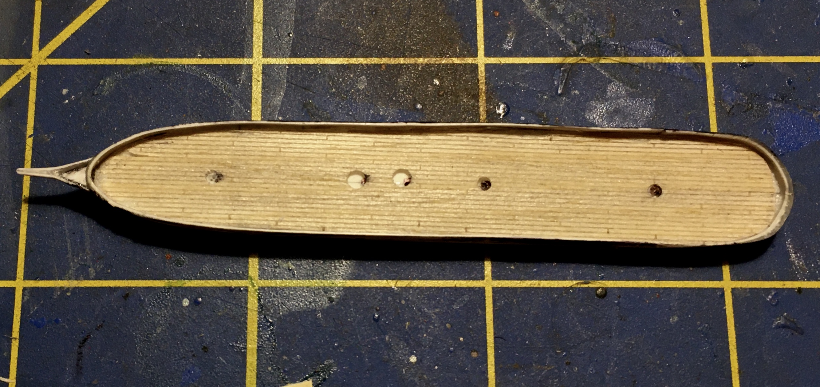

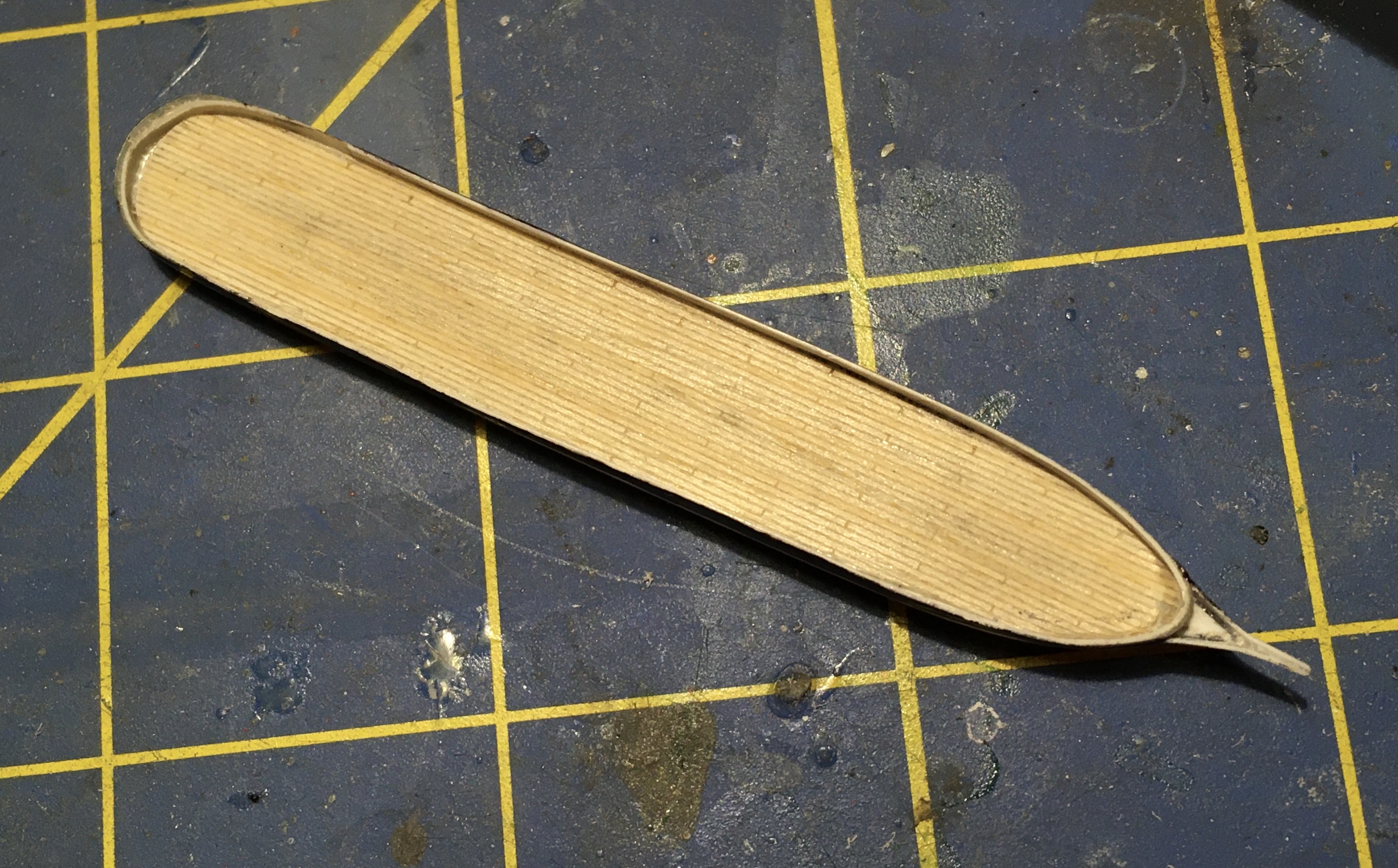

First attempt at fitting the adhesive backed scale wood decking to CSS Florida. I won't peel the backing and install it until after I get the hull details sorted out. What if a guy added the deck hatches, gratings, skylights and smoke stack bases to the decking first? :hmm: An interesting side note, the decking is translucent enough to see my reference marks for Florida's twin raked smokestacks and Her masts.
This first attempt has gone so well so far. I took a break to have Friday Happy hour with my Sweetie.
Thanks for looking in!
Thanks Guys! I REALLY want to stick the wood deck to CSS Florida! I isn't time yet. There are lots of details to add. Not any easy task given the dearth of reference material on John Newland Maffitt's most famous
command. I used my Waldron punch set to make the holes for masts & stacks.
Thanks Men! The centerline changed a teeny bit as the hull & main deck were shaped. Using .010 strip on the railings was just a bit flimsy, but closer to scale thickness for CSS Florida. I'll pick out the gun ports in a way similar to Alabama. Both Confederate vessels were built in the same British ship yard.
She will mount 8 guns. 2 pivot guns on the centerline and 3 24 pounder cannon on each side. 9" Dahlgren guns will stand in for Florida's Blakely 7-inch pivot rifles in this scale. The 1/700 3D printed cannon look similar.
