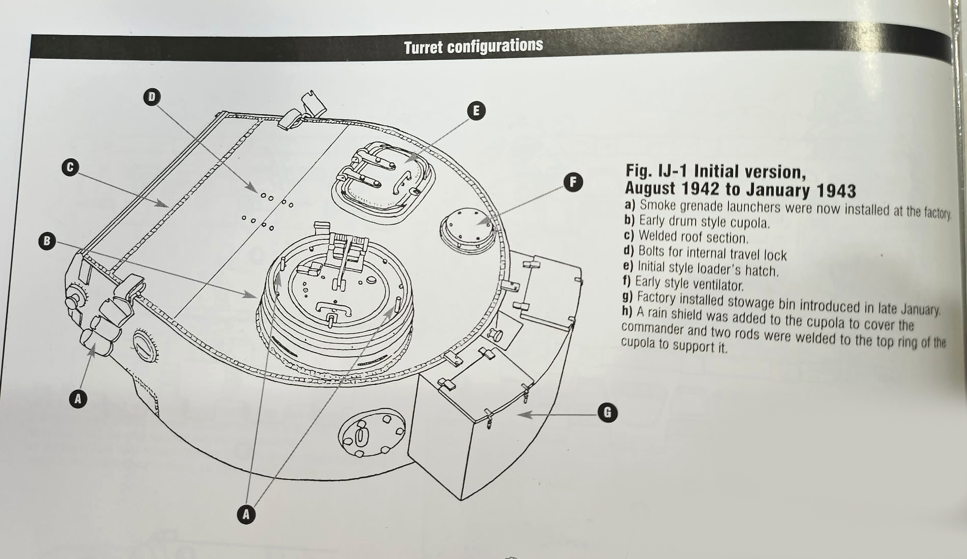

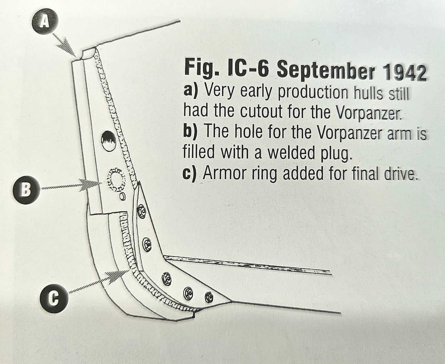

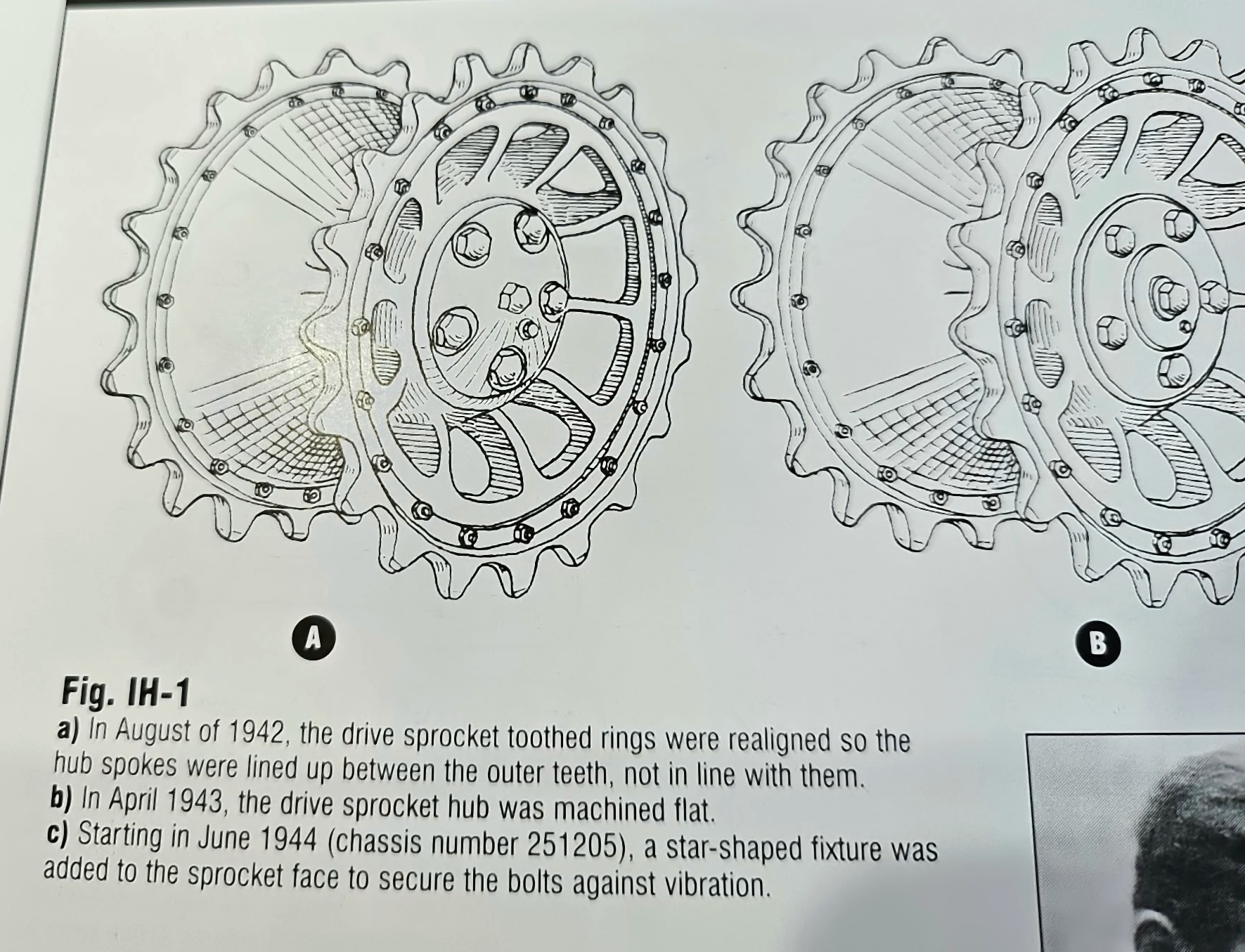

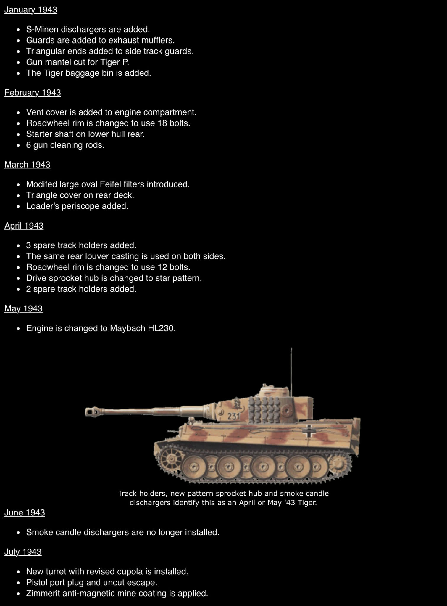

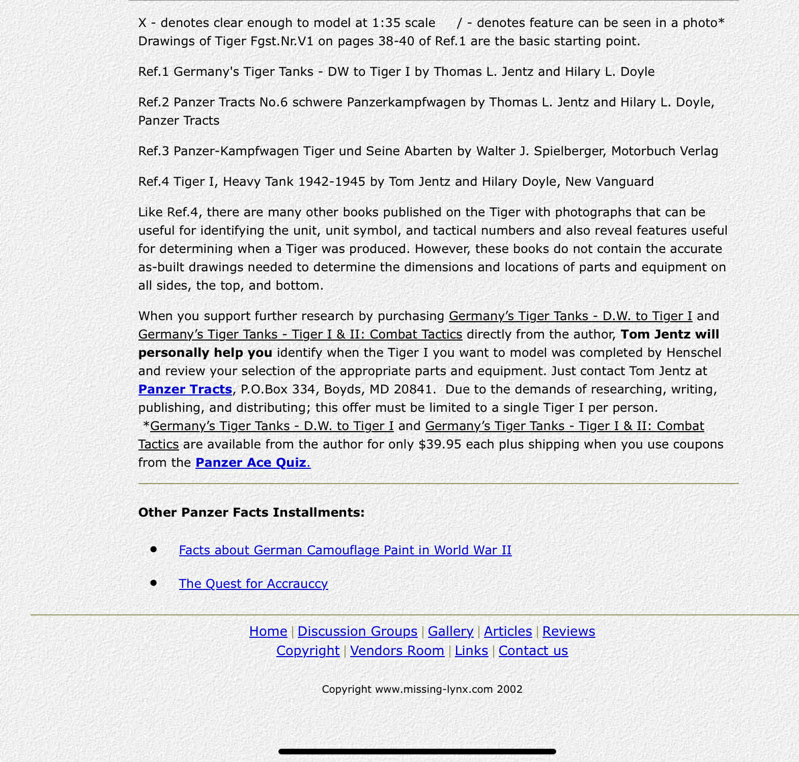

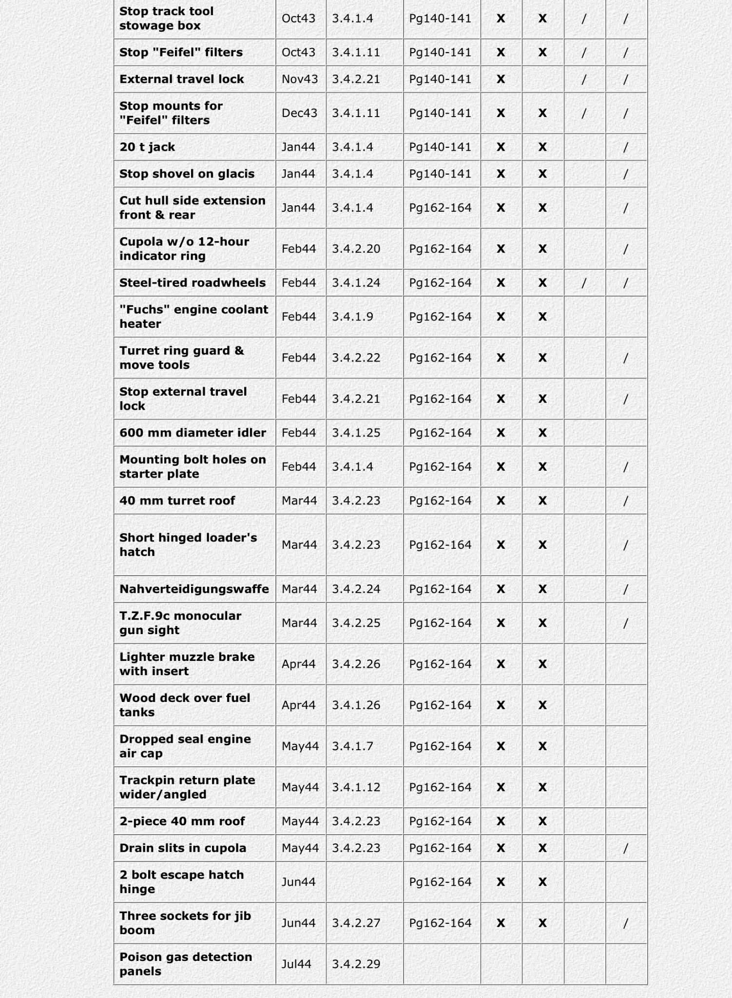

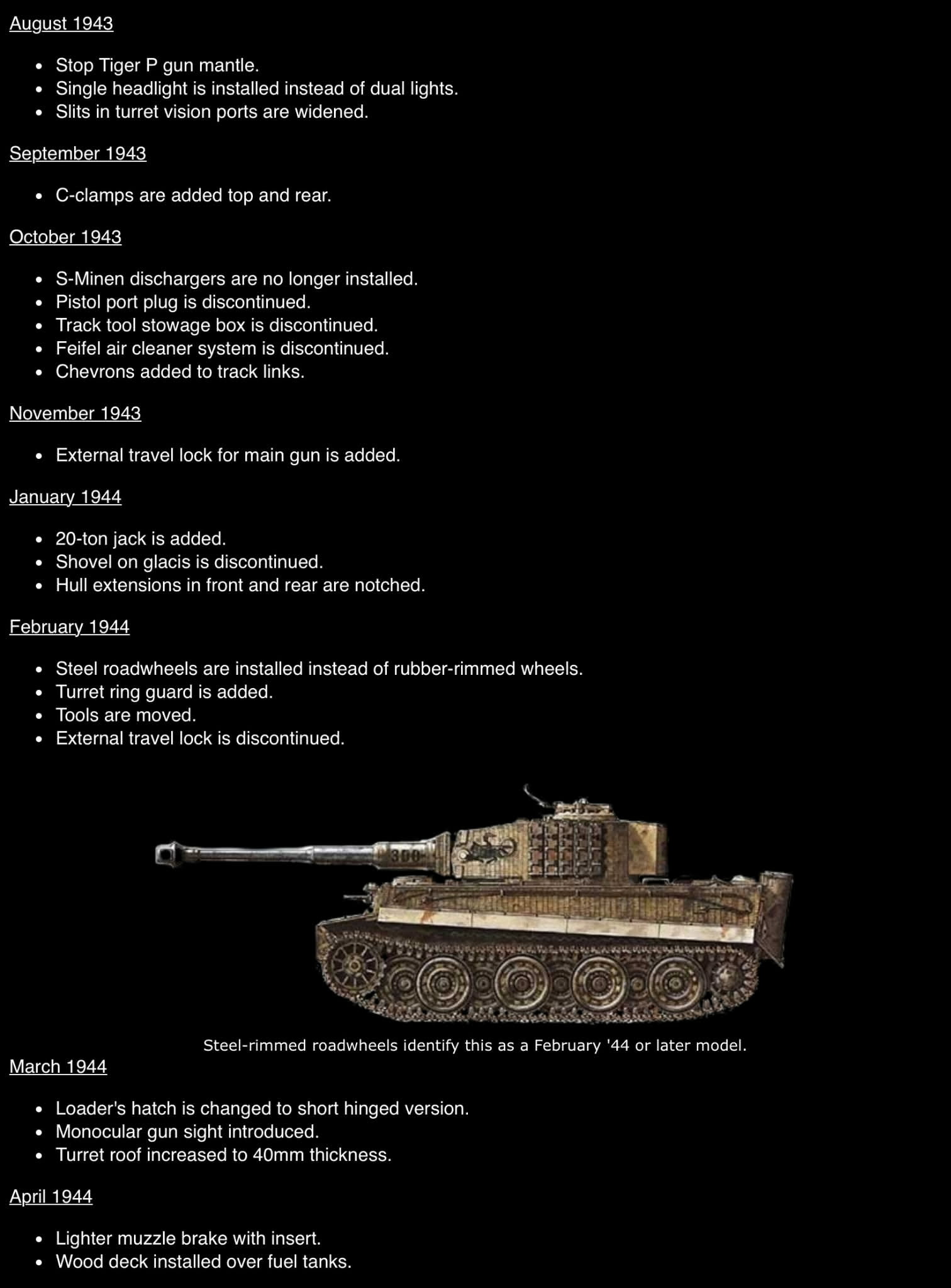

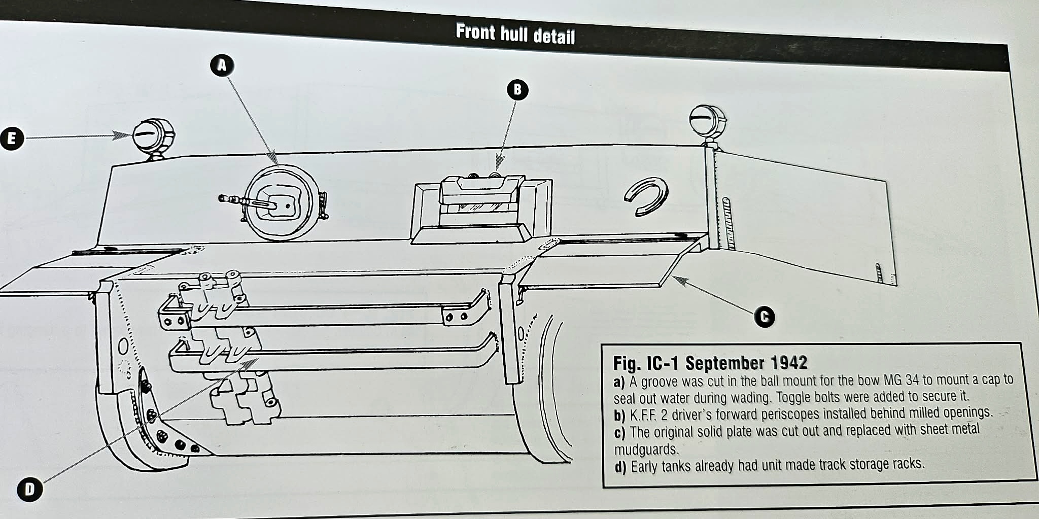

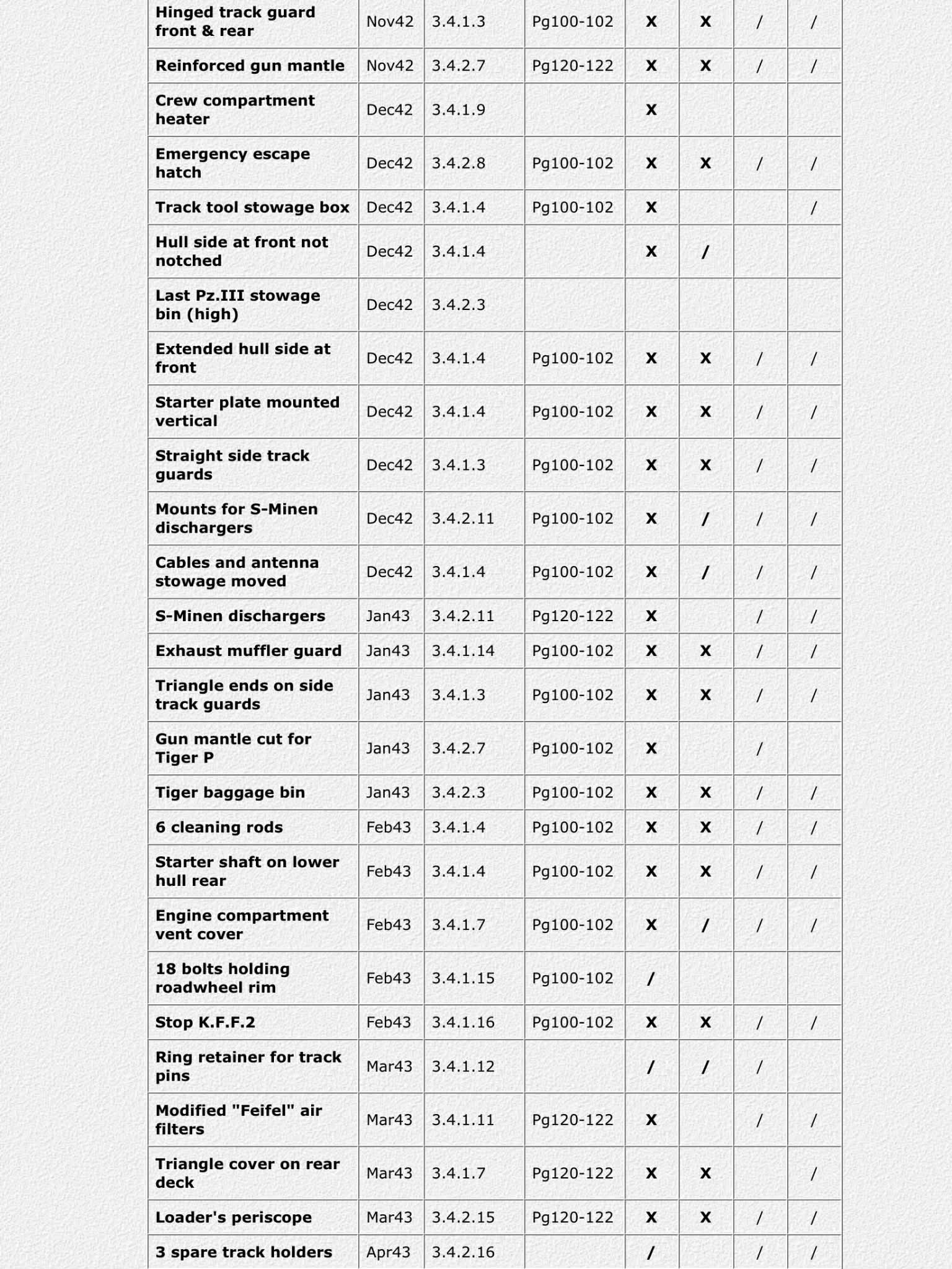

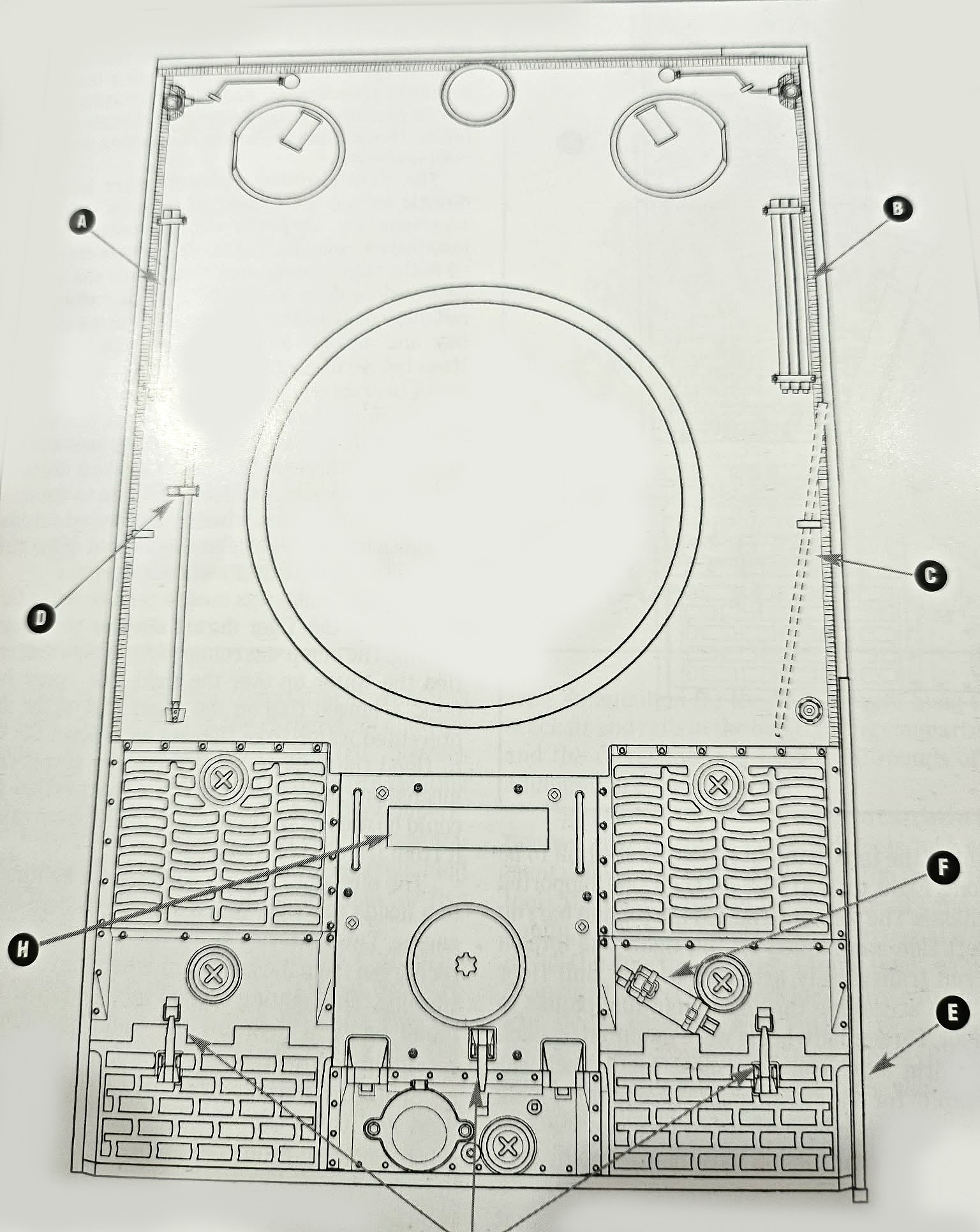

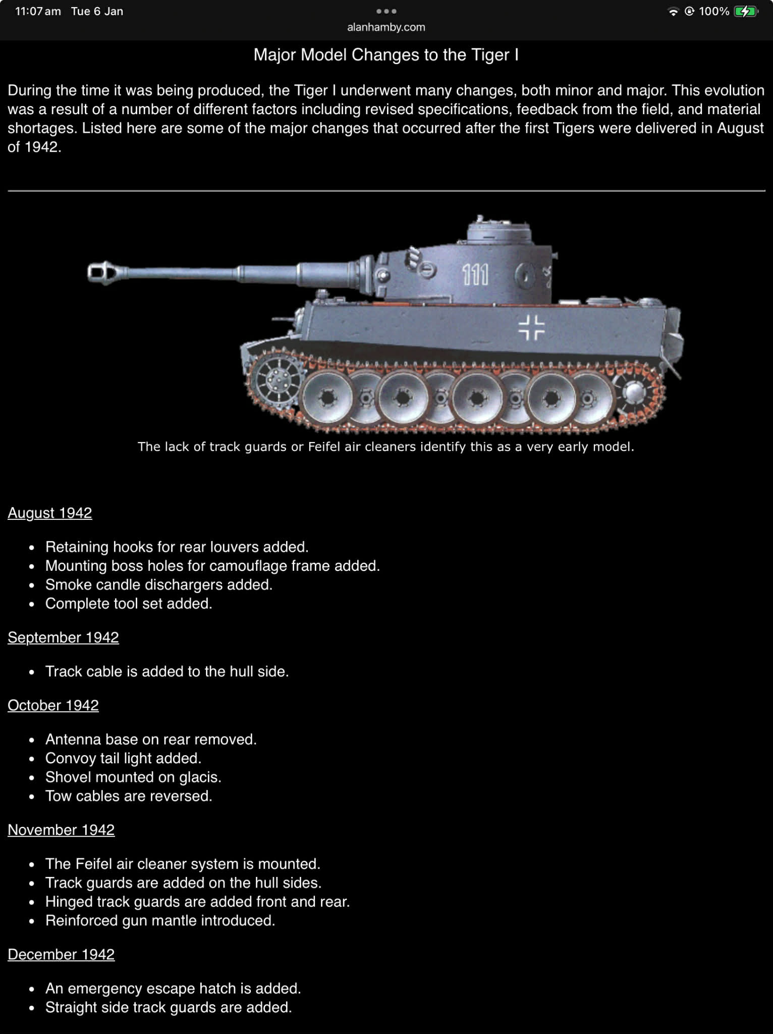

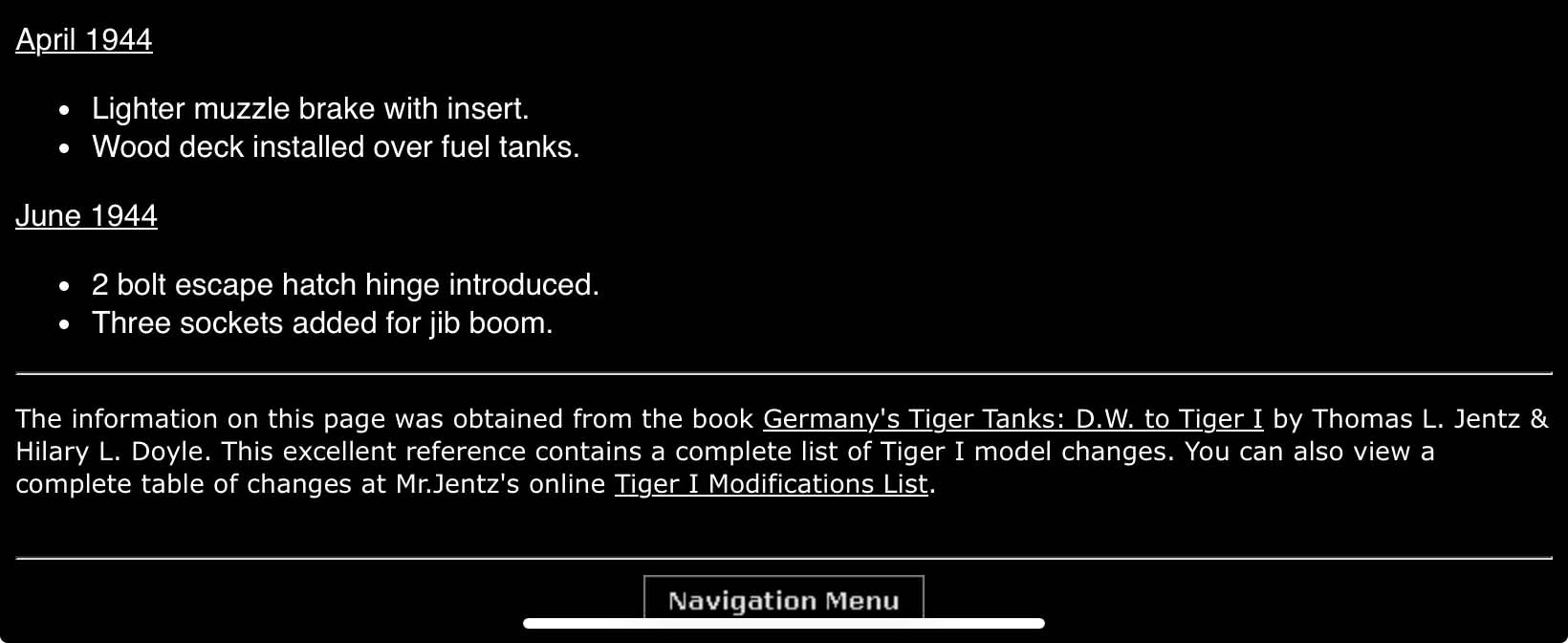

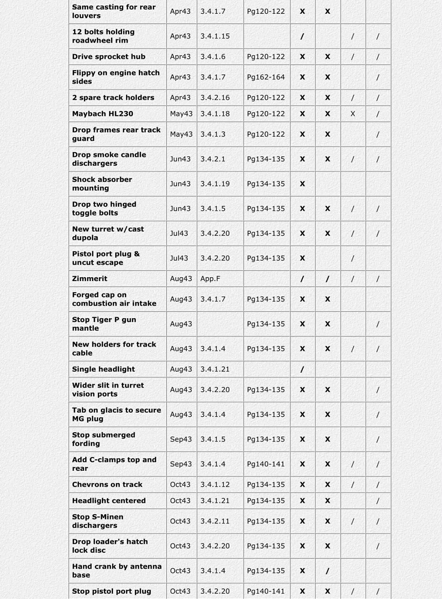

Hi Tim, John is correct that this will be a lot of work, however this is most of the info needed if you wish to go down the Tiger 'rabbit hole'.
0b982e17-8463-48ef-a7b5-f426550f5c7b.jpg495694ad-6572-419a-85a6-6bba401863e3.jpg49c9483d-6f3c-4e18-897f-cb153034f568.jpg3c355f71-210b-4981-bf93-84d64418dbc3.jpgfebf8dd8-f03d-4bec-ba8b-9312aca48e73.jpg12e7c74c-4536-4a5a-aa0b-ebdbd21eb26a.jpgc6adad61-d29d-4882-bbe2-c64928bb0ef2.jpg97799abc-37b6-4e60-8ccb-b41fc12605a6.jpg

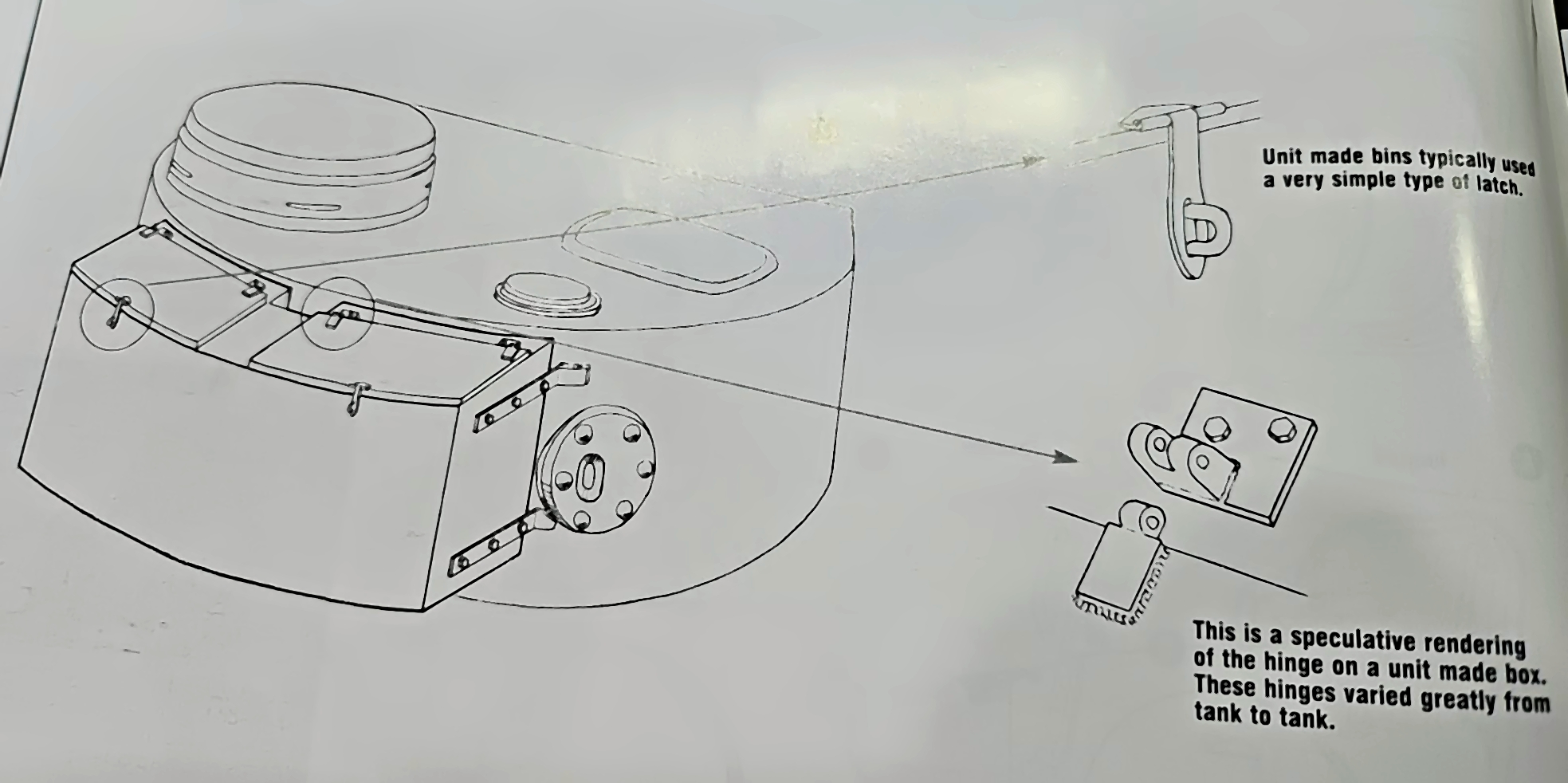

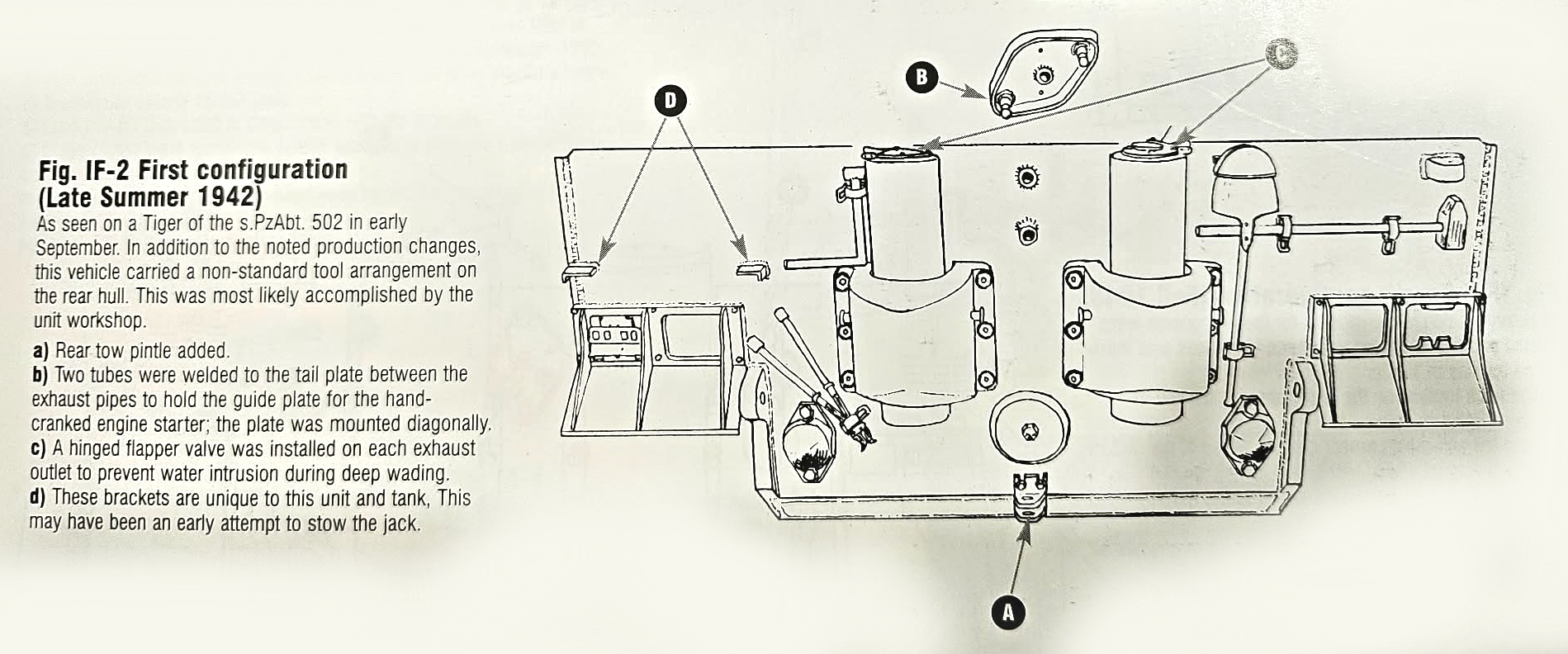

Early features
39fe797d-38c7-49f3-837b-ce209e51fca5.jpg6d49ad20-ae21-4d9f-bee6-99dc8a72fa2e.jpg4100ee90-e601-4126-93d2-d5746c36c0f2.jpg8846f94d-8c65-4dc0-89ae-3cbd1057d47e.jpgda858d3c-096b-4fb7-b0a2-4672268d8c2e.jpgfab34c4c-27a8-4059-8d36-a13bbda11c1d.jpg21f7e999-81f5-42a1-808a-02c33baaaa95.jpg2c40ca42-7db9-4b89-ae84-5d3d884aaad2.jpg092efaeb-92d7-4d9c-9c20-183babcb33f3.jpg
