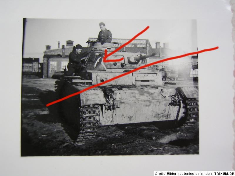

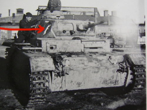

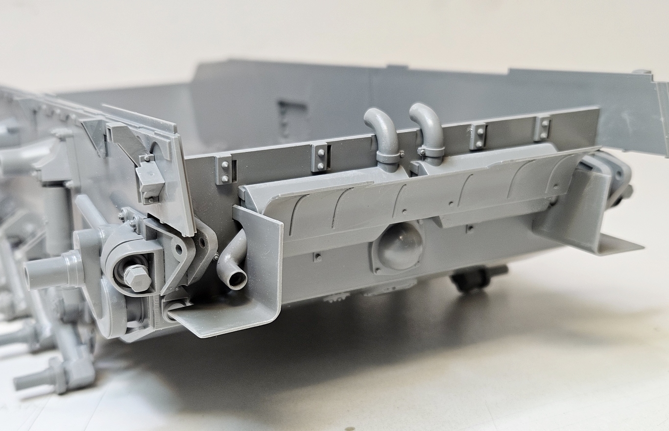

The kit has it close for this factory production. In any case, the 'ski jump' curve is missing (shown in the side view) which does seem to get bent down in many photos. A good reason to use the kit part as a pattern to rub lead foil over it and then replicate the thin sheet metal appearance and fragility.

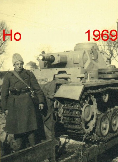

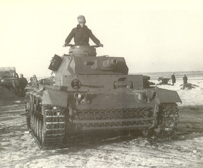

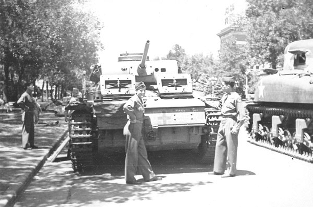

While I'm at it, since I mentioned factories, which mudguard support is in the kit? This determines the other fittings such as tool storage, et cetera.
Truncated rod and sheet metal support-
Stamped metal-

The kit supplied the round welded tube hanger.

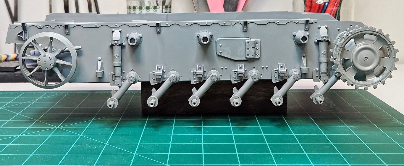

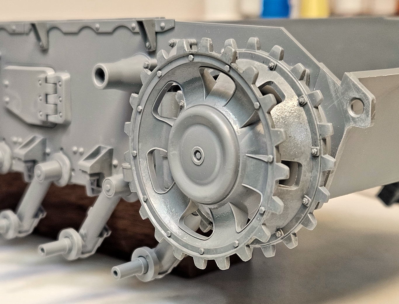

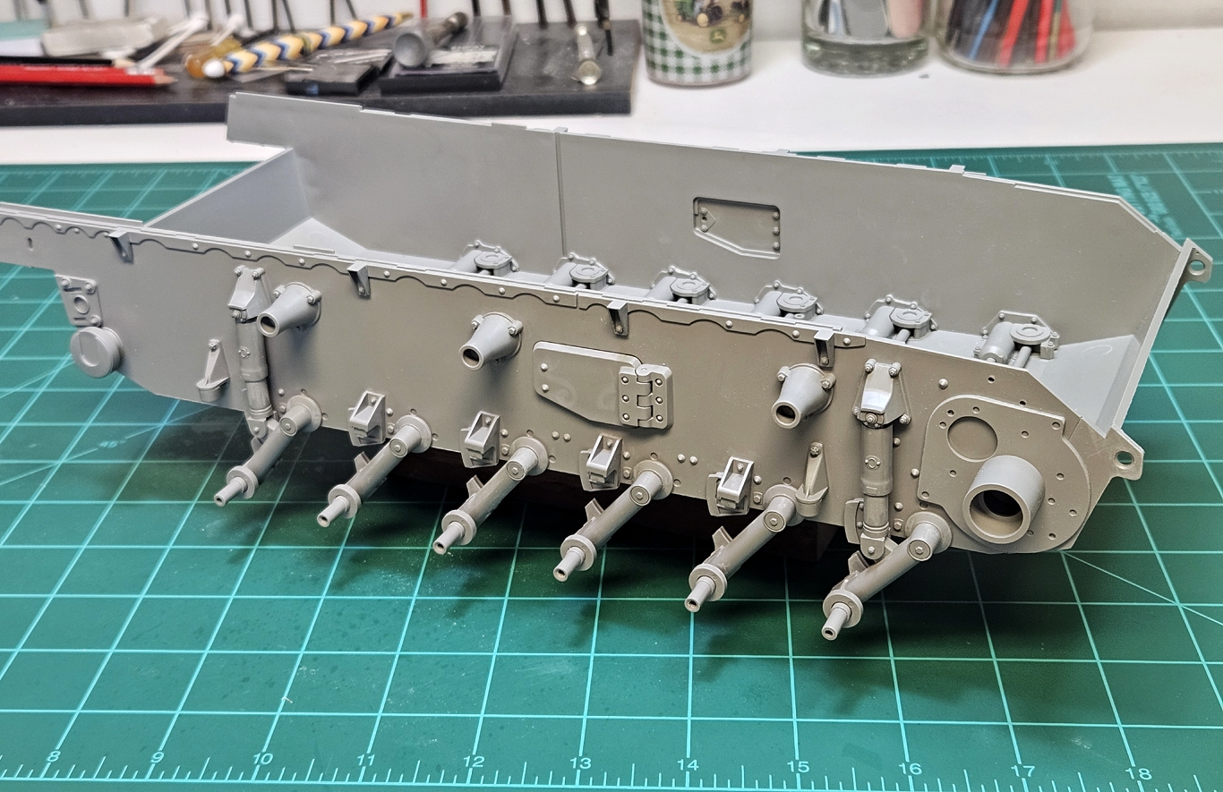

Bogged down with the road wheels. It's the first bit of trouble with the kit. The tires are molded separately and are designed to press fit onto the rims. Great for painting, however the fit is way to tight. You'd have to hammer them on. So I'm having to dremel the inside of the tires for a better fit. There's 24 of them...
Looks like I will have to fire up my lathe for those when I get there. Looking good Tim!
I thought about it myself. The rims have a slight taper so the tire only goes one way, but they'll only go about halfway. I used an aggressive sanding wheel in the flex shaft and carefully took enough material off just the inside/backside of the tires. It's still a pressure fit, but you don't have to use a hammer. Interesting with the great fit of everything else that these are so far off.
Looks good Tim, looks good. Nice that this is all the trouble you've run into.
So far anyway. I double checked to make sure I wasn't doing something wrong and the videos I've watched on this kit build doesn't mention this issue.
Yes the fit on my Pak 40 was overall good. There were a number of minor things where I needed to adjust parts to make them fit "better". Also this plastic is soft, so the WeldOn 3 I use can be quite aggressive if I overdo the application. One place where things were too tight were the pivots in the frame for the gun elevation. The pin and hole interference there were way too much so I had to adjust that a bit. I managed to get it where it was merely snug and you can move the gun up and down freely and it will stay put. The other part is the plastic barrel is so nice that there is literally no difference in any discernable manner between the aluminum barrel and plastic barrel except weight. The weight was enough of an issue to go with the plastic barrel. I then was able to drill out the ends so you would not see a plug in them.

Back to Panzer Tracts. @Tim A., check out the side view, front to the left, like a ski jump! Obviously, all sheet metal:
I was going to say that the photo of the restored heat shield was completely wrong.
  • A sheet metal deflector plate was added to the rear [over the exhaust mufflers] to redirect cooling air away from the ground and was introduced on the J version in 1942.
