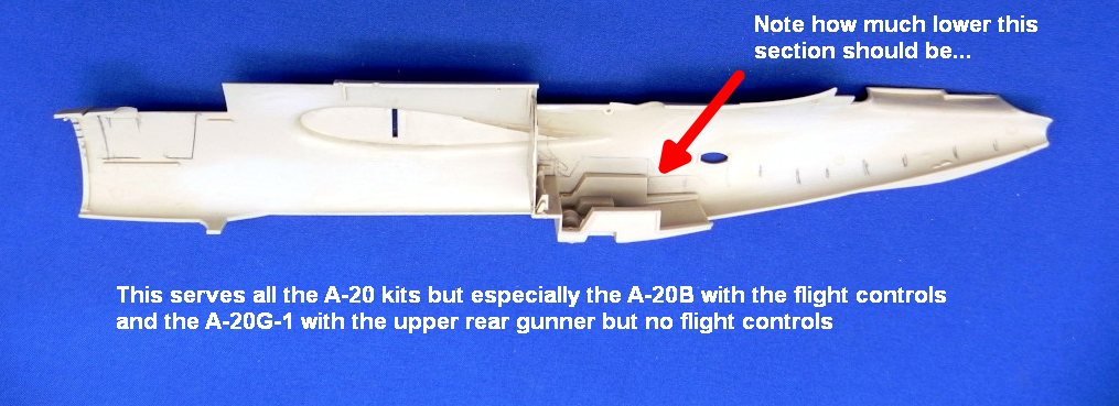

Wreaking Havoc 1: A-20B 41-3266(?) Outhouse Mouse with a Sharkmouth
This serves all the A-20 kits but especially the A-20B with the flight controls
and the A-20G-1 with the upper rear gunner but no flight controls:
