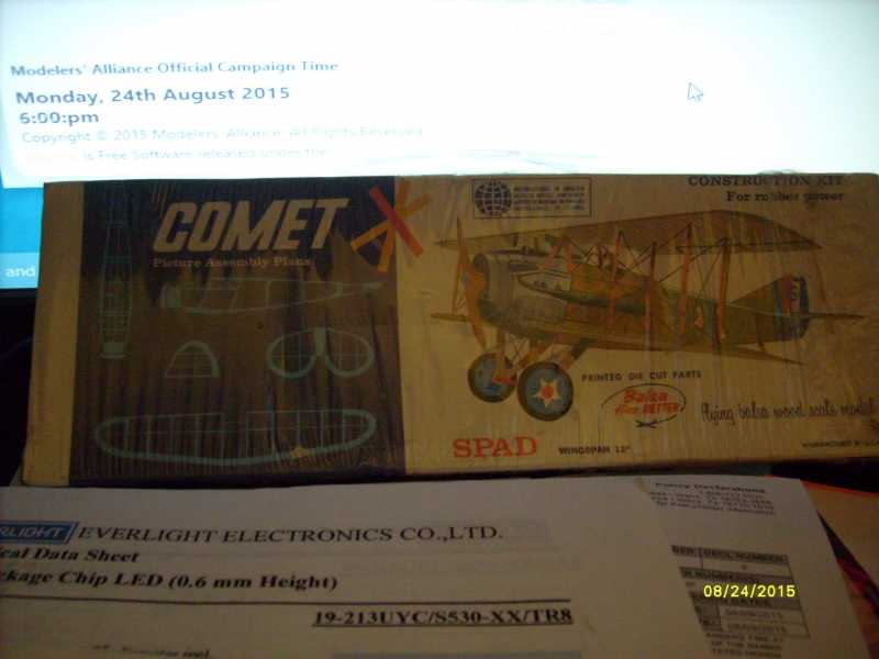

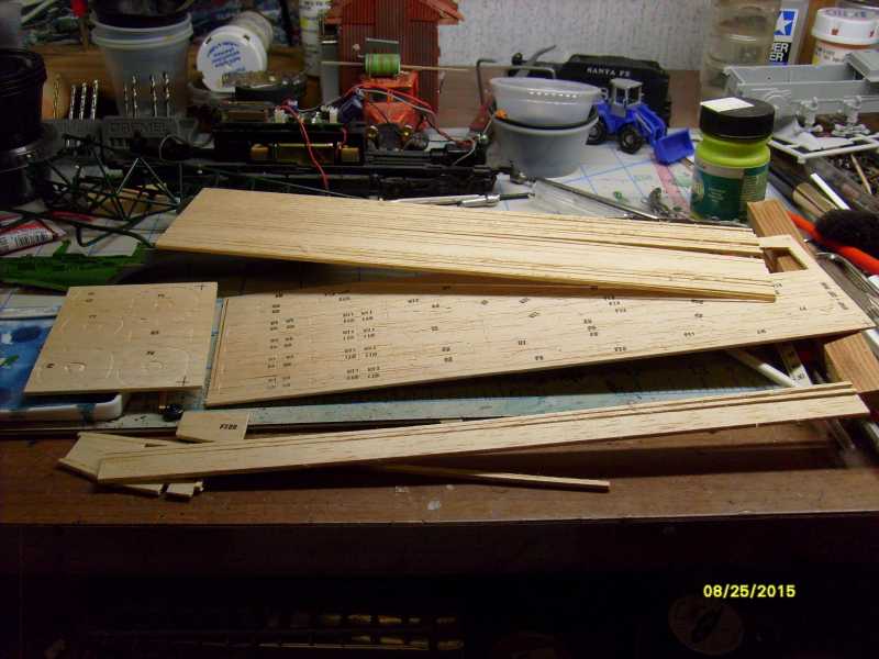

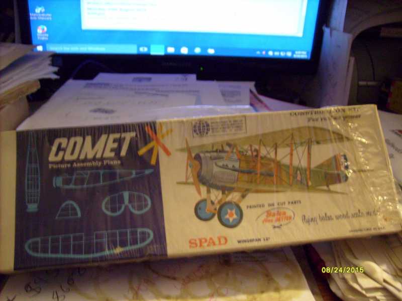

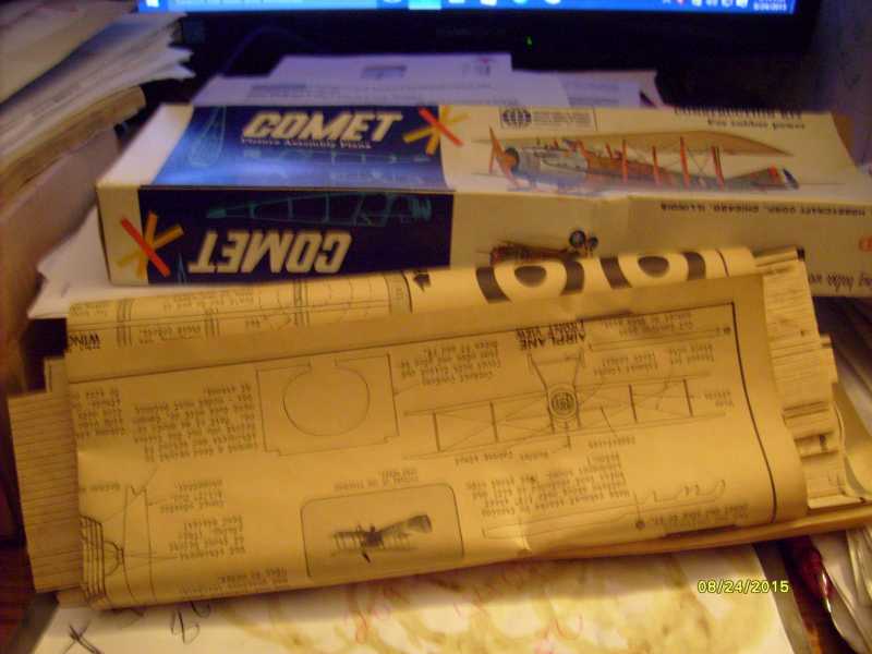

Oh yeah this is going to be interesting![]()
They're supposed to Fly ??? ... I was just gonna build the plane out of the wood ... Don't think I'll be using the rubber powered motor ... But since I have about 2 years yet ... I think that's enough time what with what's happening now in My life ... :snoopy![]()

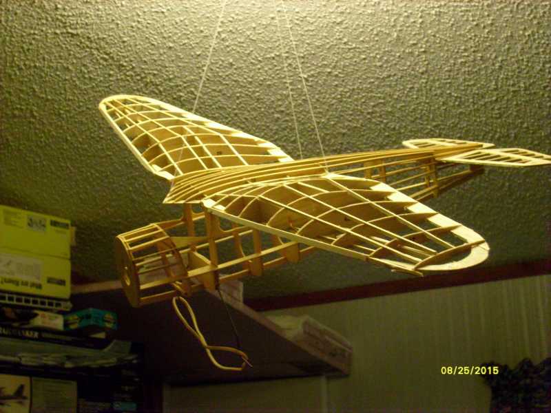

To make this Spad fly:
1/2" dihedral on each wing tip.
Build in 3/32 washout per wing tip.
Enlarge stabilizer to 25% of the wing area as seen from above.
Move rubber peg forward to twice the distance from the balance point as from the prop hook to the balance point
Increase the angle of incidence of the lower wing to 3/332"- keep the top wing at zero.
Any on these old kits can be made to fly if you follow the above basic rules. For low-wingers, 10 degrees of dihedral per foot per side, low wingers 5 degrees. Amount of rubber motor and length thereof is a whole 'nother story!
