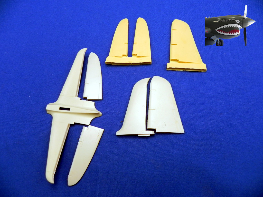

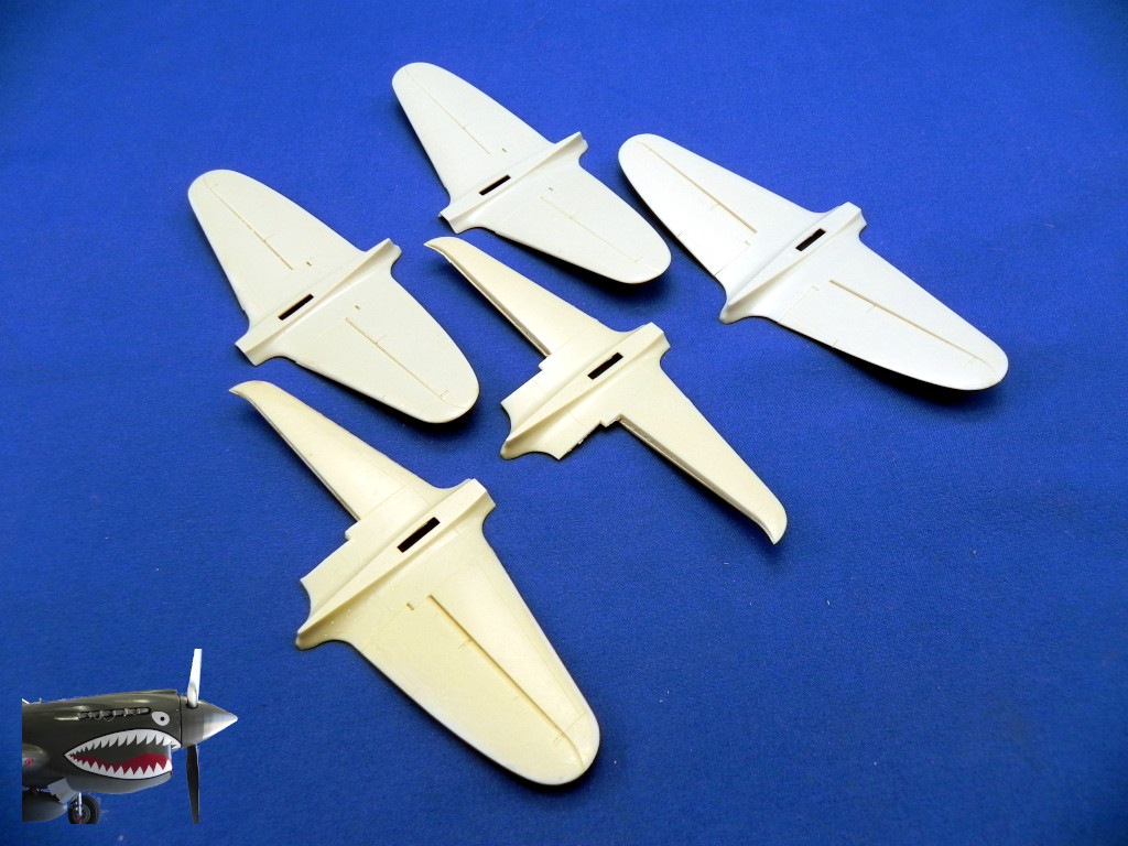

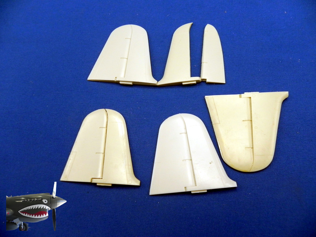

Not seen here but performed; several control surfaces were removed to be replaced by the KMC resin replacements.
The control surfaces for all five are being worked on since I have two sets of Kendall Model Company's (KMC's) replacements:

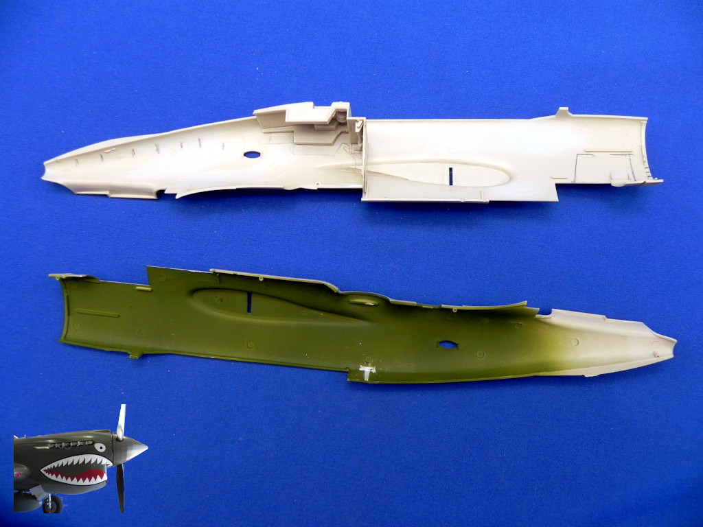

Working on getting some interior details corrected. Upper fuselage is from the A-20B after sanding the inside so pencil lines show while I sprayed the inside of the A-20H-5 for the same reason. Since it is less visible, I will use the kit interior parts (as show in the A-20B fuselage) in the turreted versions but this still means scratching three...

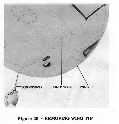

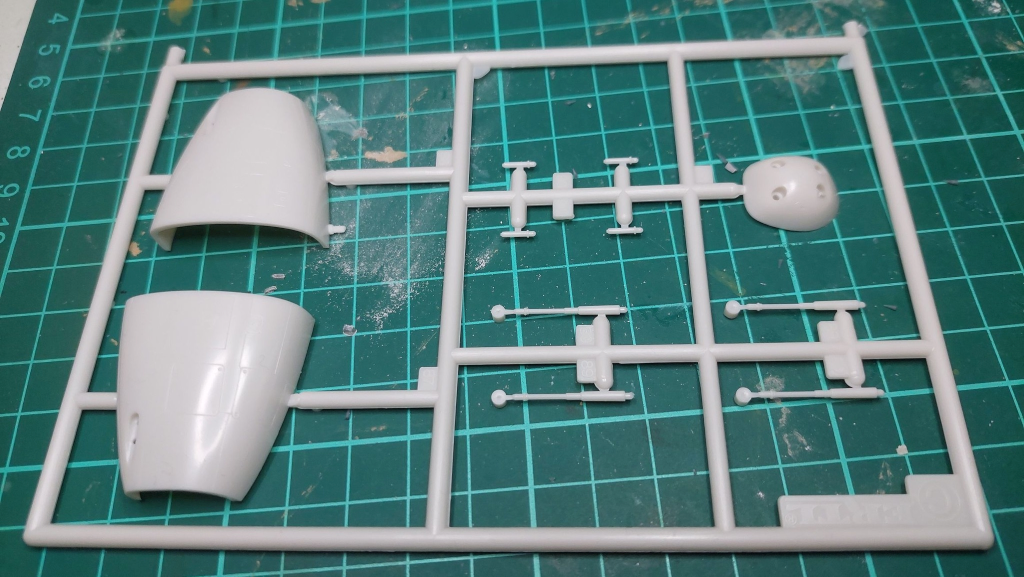

This is what the kit includes. It is the wingtip from the start of the A-20G-1-DO to about the A-20G-30-DO (I may correct this range later). Note that the teardrop shaped bulb is the navigation light while the bulb in the clear aft half of the wingtip is a formation light. It should not be green/red.
Compare that to the full clear wingtip incorporating both starting with the A-20G-30-DO (this one is serial 43-9716 from the 647th Bomb Squadron, 413th Bombardment Group, 9th AF, after a hard landing in England on the 28th of May,1944):

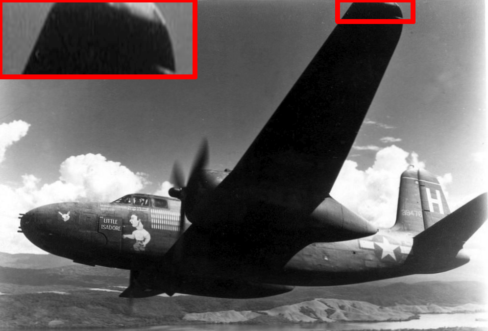

Many make the mistake of thinking that the wingtips are painted in a light color, such as white, instead of realizing that the complete wingtip is clear.
Since the A-20H-5 is comparable to the A-20G-45-DO, it is a change I need to make.

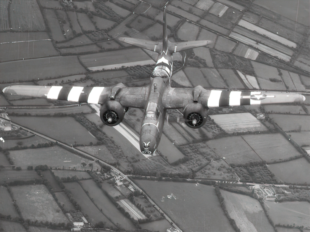

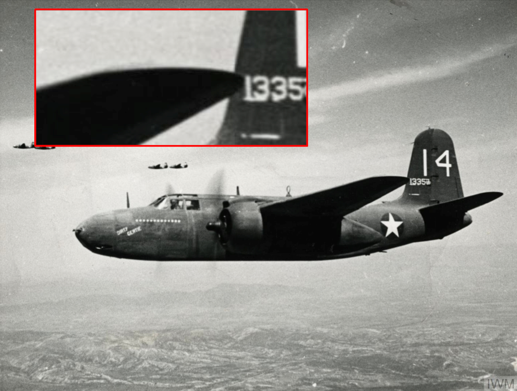

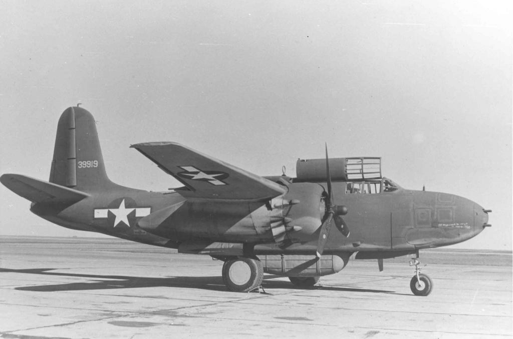

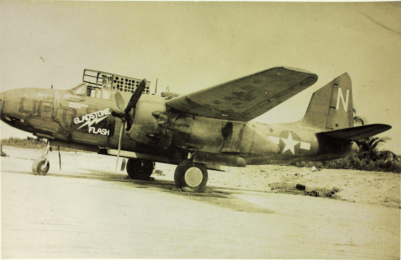

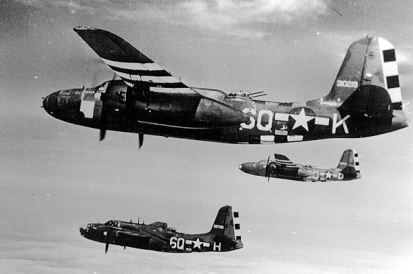

More examples of clear wingtips which many thought were white painted:
A--20G-40-DO 4321426 Gladstone Flash:
A-20G-45-DO 43-21938:
A-20G-30-DO 43-9476 of the 3rd BG, 89th BS, named Little Isadore:
A-20G-35-DO 43-10219:
A-20G-35-DO 43-9919:
That might be enough... But here is one more... A-20G-40-DO 43-21691:
OK so why clear?
AbsoFREAKINGlutely no clue!
What I do need to find out is WHEN Douglas (or perhaps it was Boeing) started added the formation lights in the clear rear half of the wingtip as the earliest models didn't had that either! Only navigation lights on the top and bottom of the wingtips. The A-20G-1-DO manual shows them but it may have started earlier.

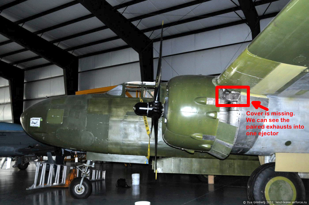

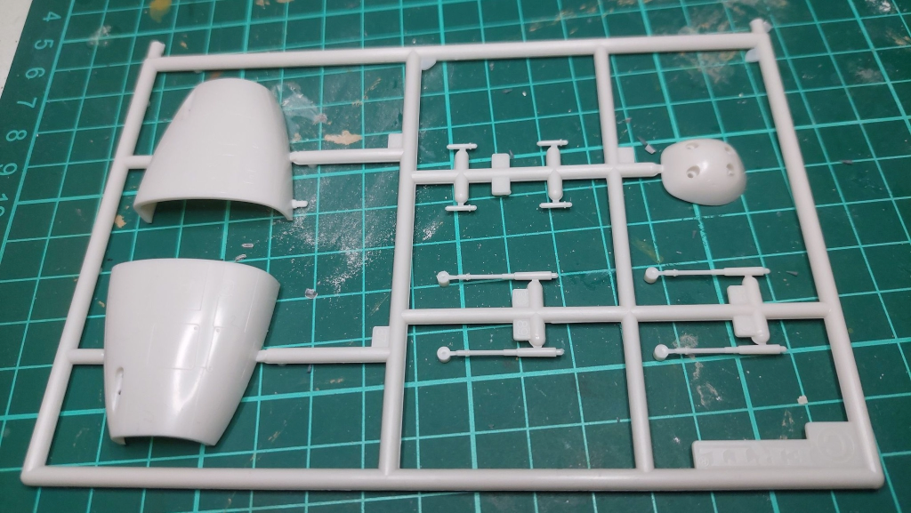

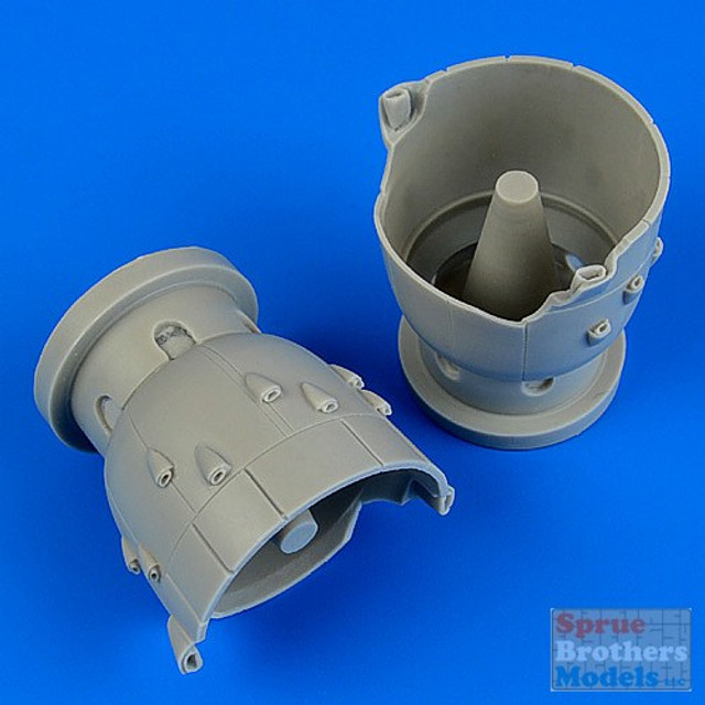

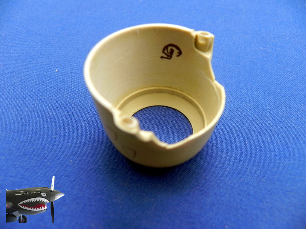

Colwings were worked on by deepening the paired exhaust ejectors and working on adding the individual exhaust pipes under each cover:
Yes, I can take the easy way out and simply buy the QuickBoost cowlings:
