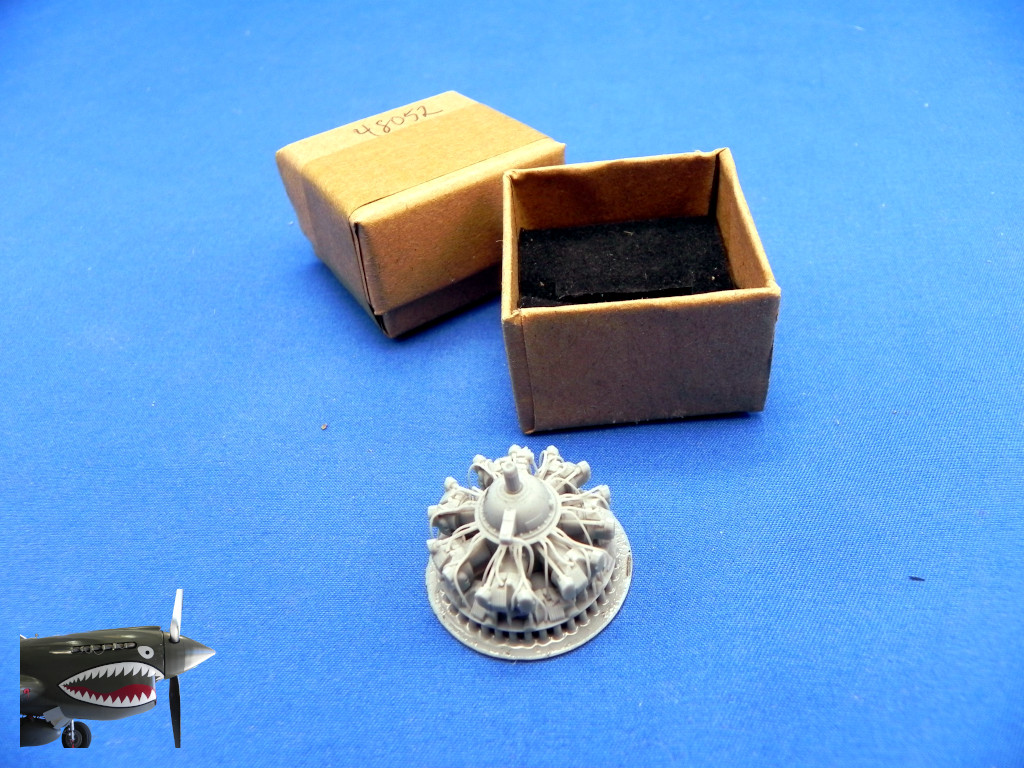

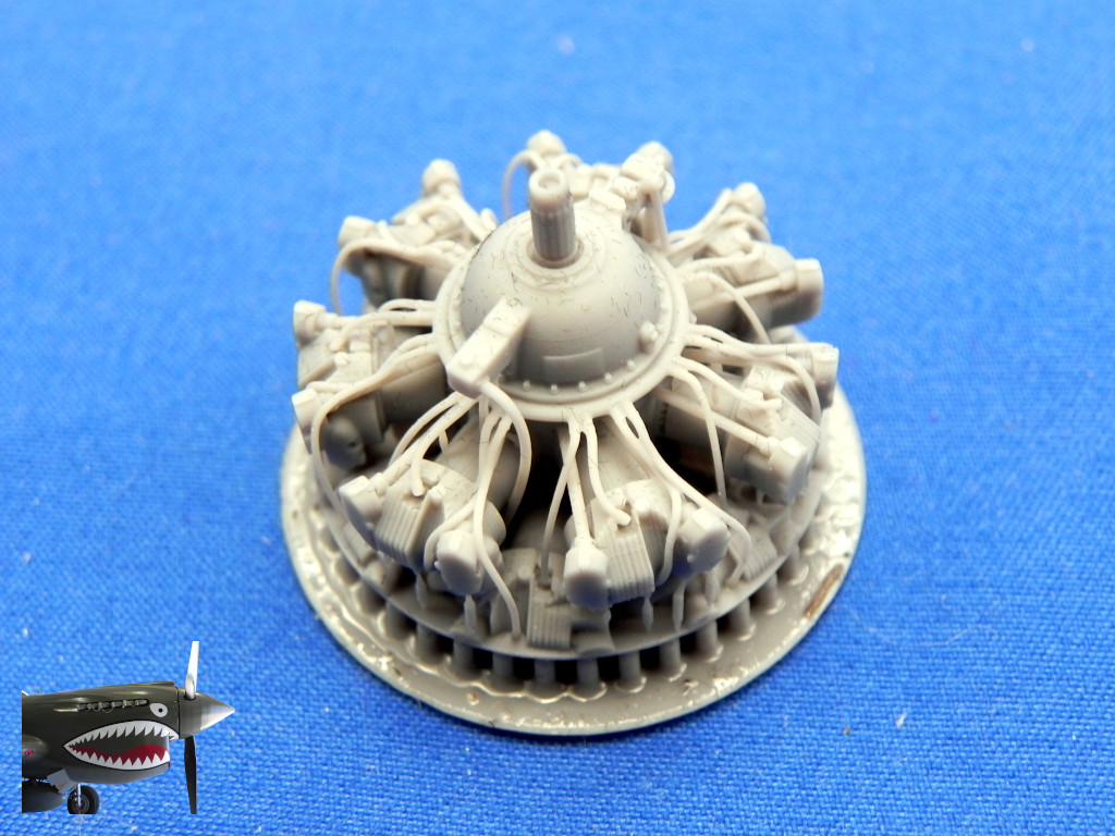

The R2D (Resin 2 Detail) upgraded engines are sublime...

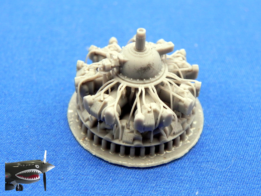

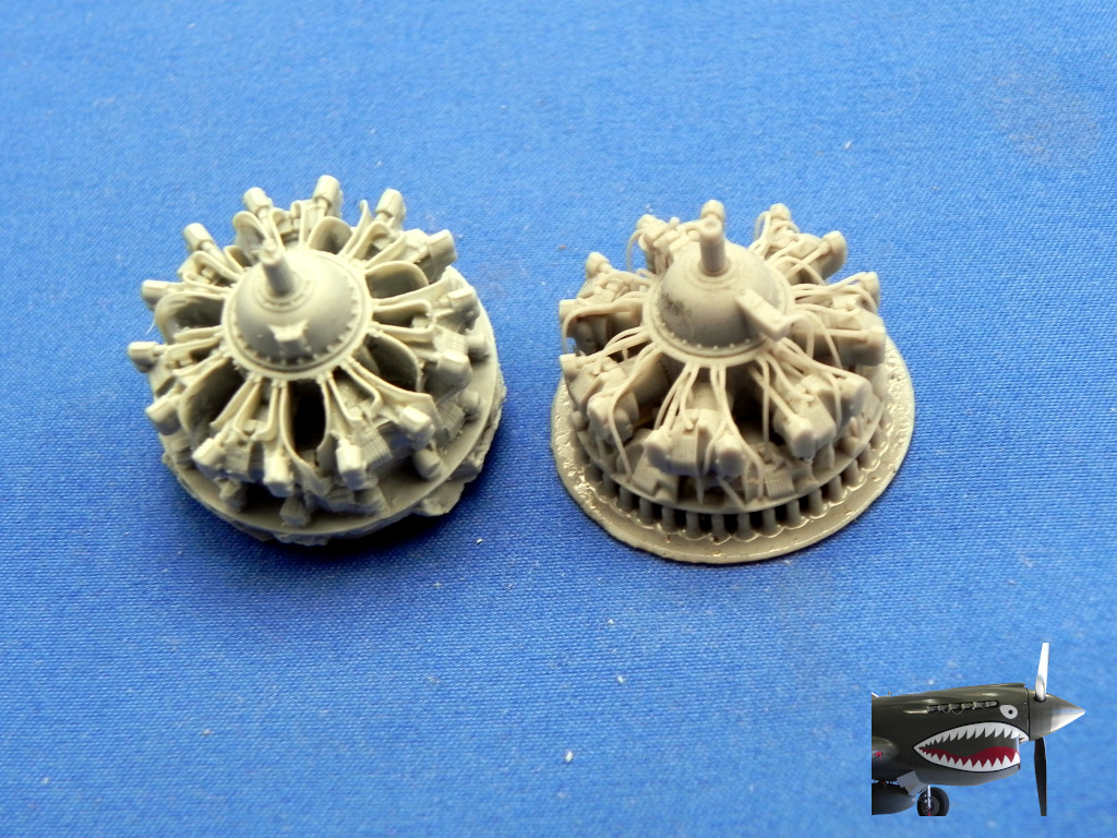

R2D R-2600 engines compared, old file on left, new on right:

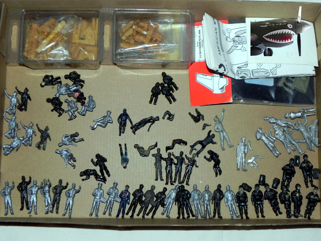

While looking for missing parts, came across a bag with all these figures. Brought back memories of how many kits I USED to finish!
13 years? Gee, I don't feel so bad.

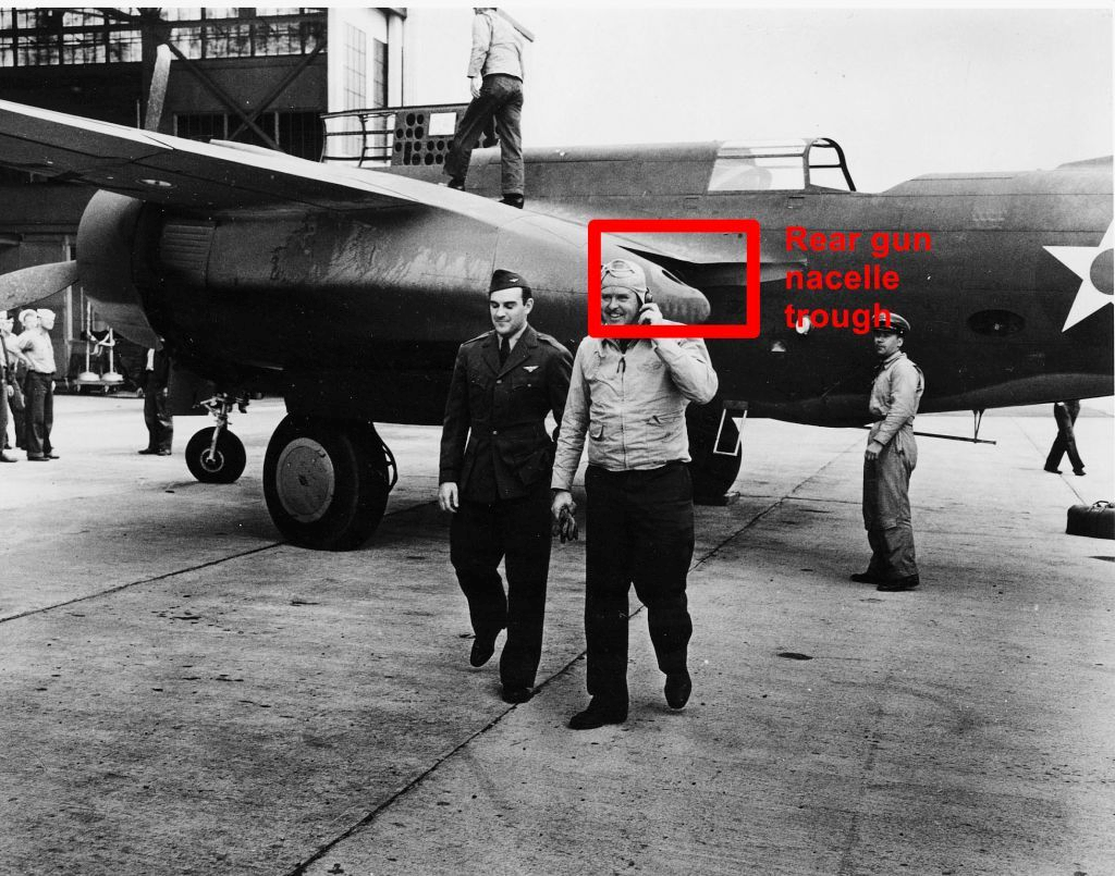

According to the book, the earliest A-20G-1-DO also had the rear firing nacelle guns:

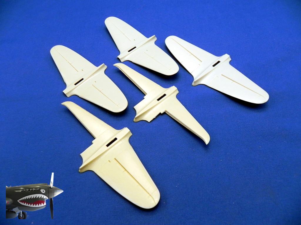

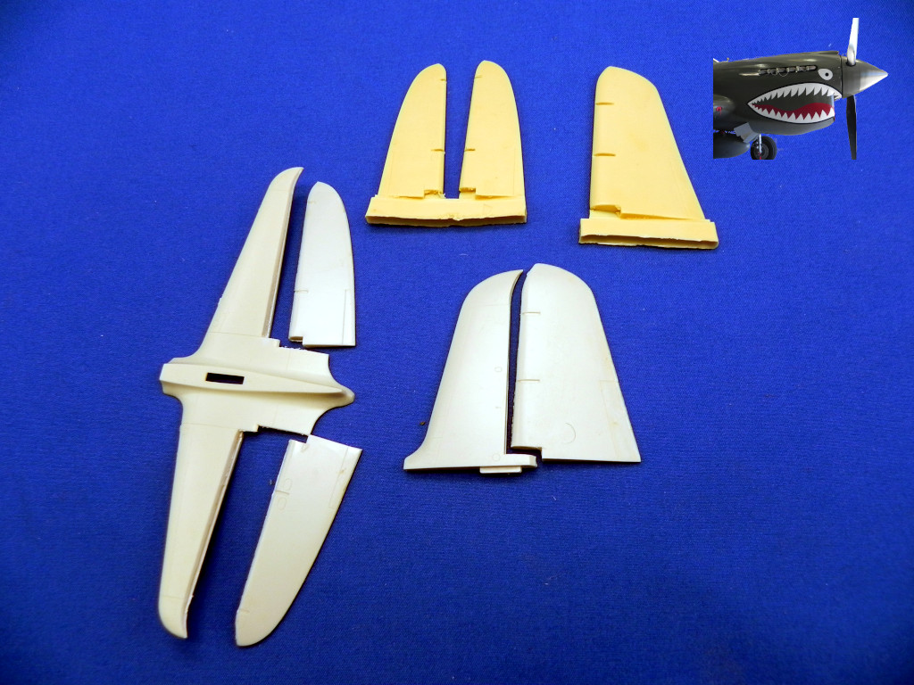

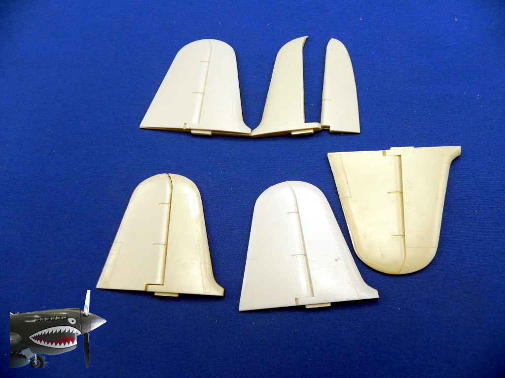

As I wrote, I am working on all five together. Here, the control surfaces are being worked on since I have two sets of Kendall Model Company's (KMC's) replacements:

That 3D engine looks pretty good, Saul. Ya know, you've got enough figures for a full maintenance squadron right there, wow.

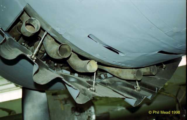

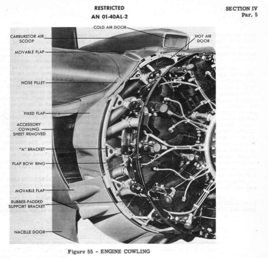

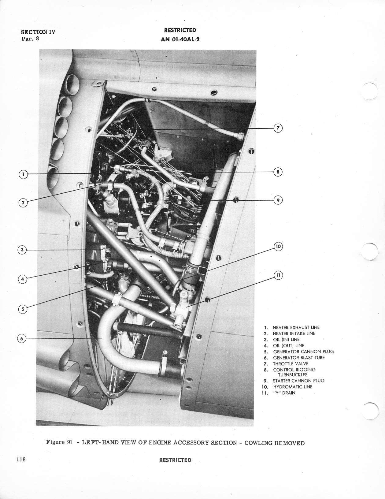

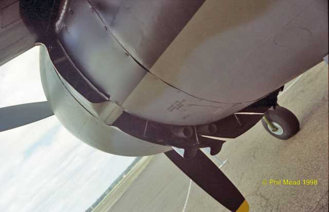

This post is repeated on the A-20G-1-DO thread. Photos to follow but some work was done on the engine cowlings for both the A-20B and A-20-G-1-DO as they are the same. This meant adding five (5) exhaust ejector pipes on the outer upper fixed flap (see A-20G-1-DO tech manual image below whose engine cowl cover would the be same), three (3) exhaust ejector pipes on the inner fixed flap, and six more underneath the tamp shaped movable flaps on the lower side:

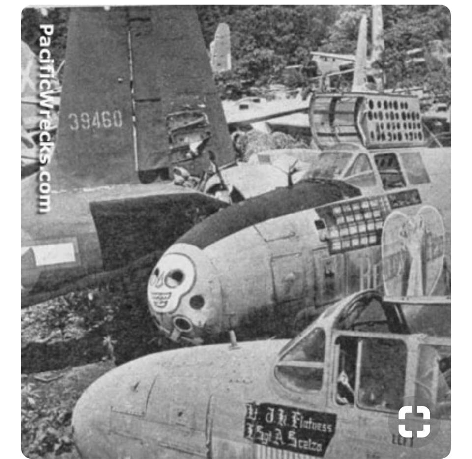

Some reference images since I plan to add rockets...
Note, this was not limited to the cannon armed A-20G-1-DO:
