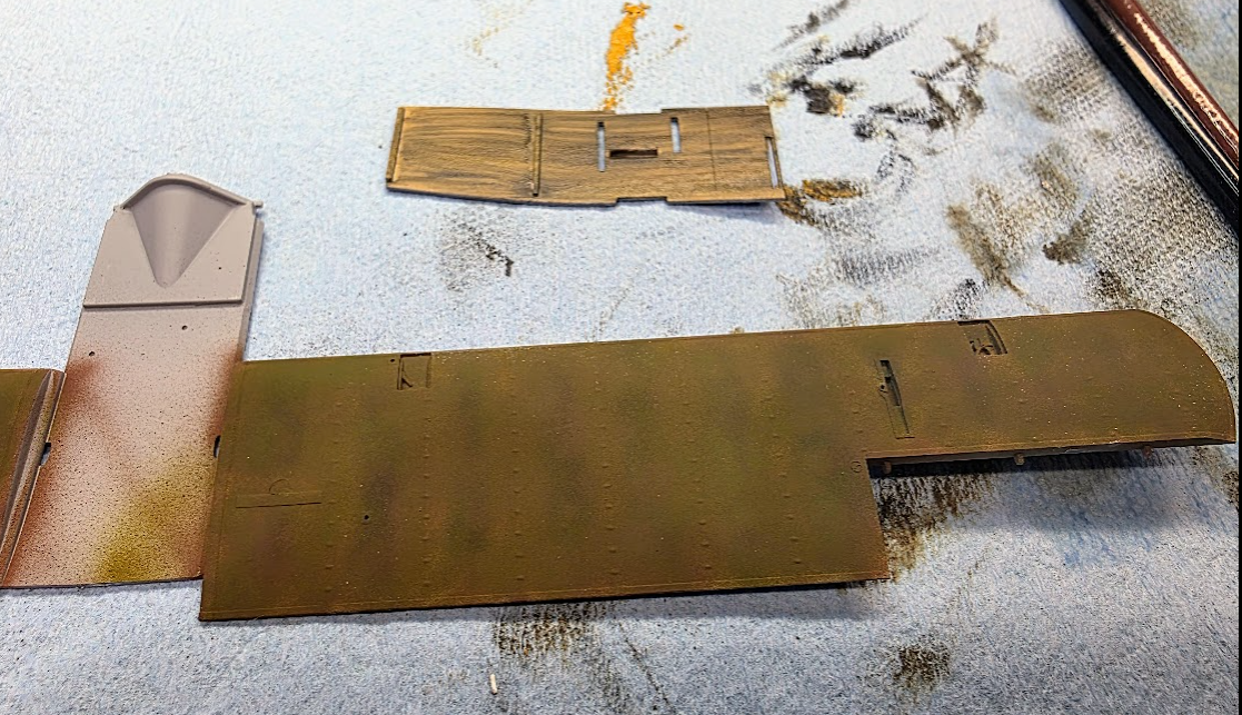

Here's some test shots of painting. Wood grain for the cockpit floor. I'm really not sure what it's supposed to be but I'm making it wood grain.
The wing section was primed, black base shading between the ribs, dazzled in some Nato Brown and a really thin Tamiya OD FX 62. I wonder what a gloss coat would do to the tones.
Looks great to me! Citadel sells some awesome washes that i add at the end I really like that help bring out the look...Nuln Oil is a favorite.

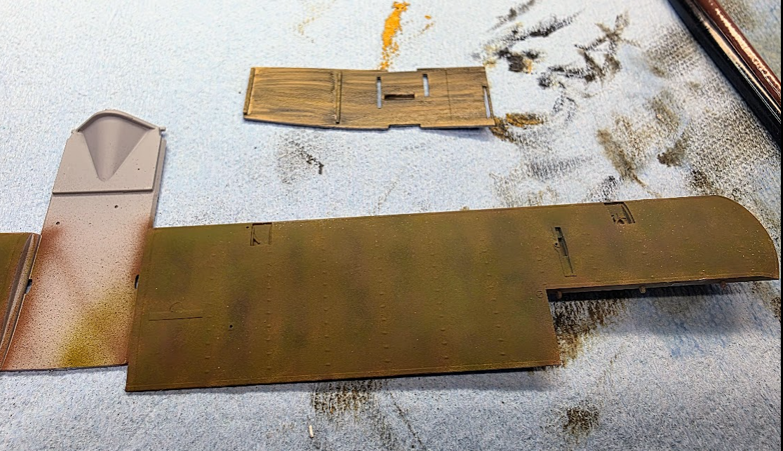

Darken them?........................

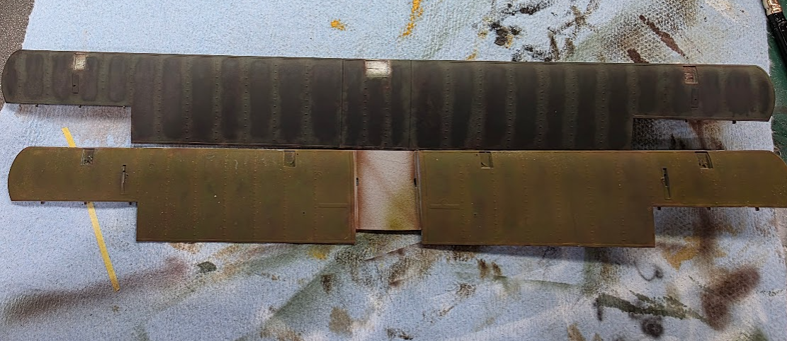

Still playing with colors.
This is the top wing with Nato Green over Nato Brown with some black and white preshading. White on the ribs and black in the center, not sure Iike that.
Bottom wing was what I did the other day.

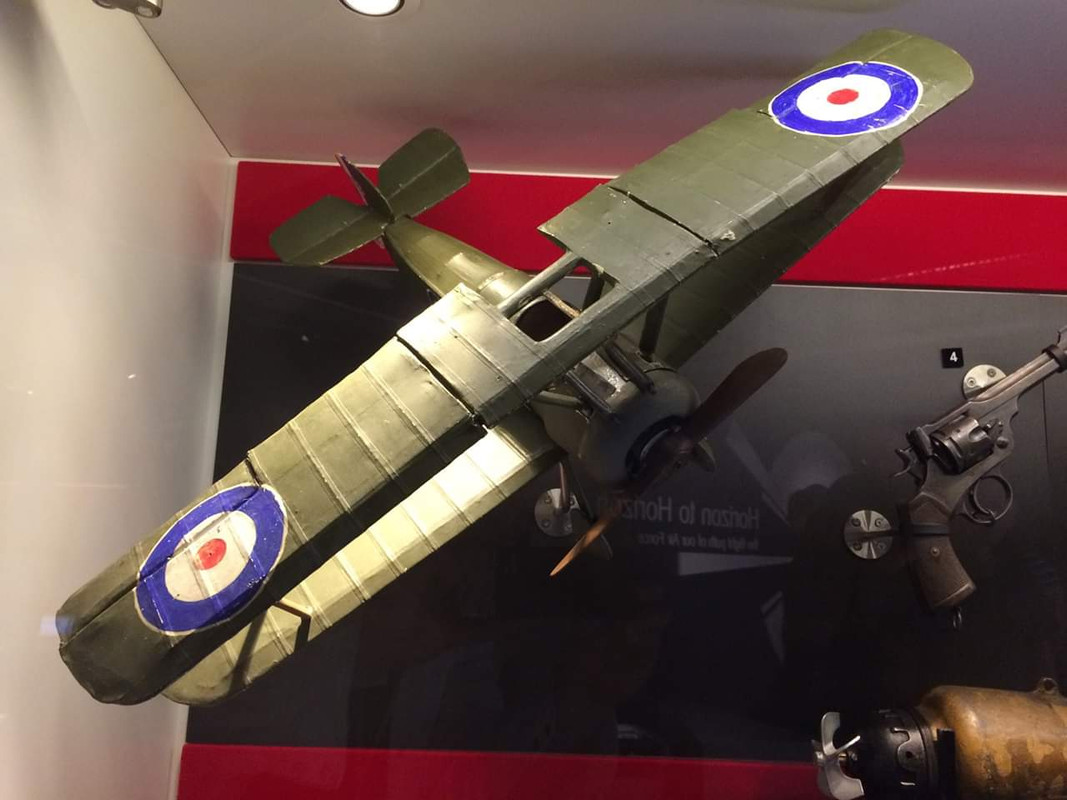

There's a website out there that has a post from a user who has a photo of a Camel that was build during WW1.
I'm shamelessly copying the photo here.
The assumption is this is the actual PC10 used on the real thing. Light is bad but it sure looks darker than my first attempt.
For your wood, when you get it the wood grain you like, spray on Tamiya clear yellow or clear yellow with a touch of clear orange to give you the varnished look. As for the PC 10, as far as I have found it starts out looking brownish and as it fades and ages looks more green. So pick the age of the aircraft.
