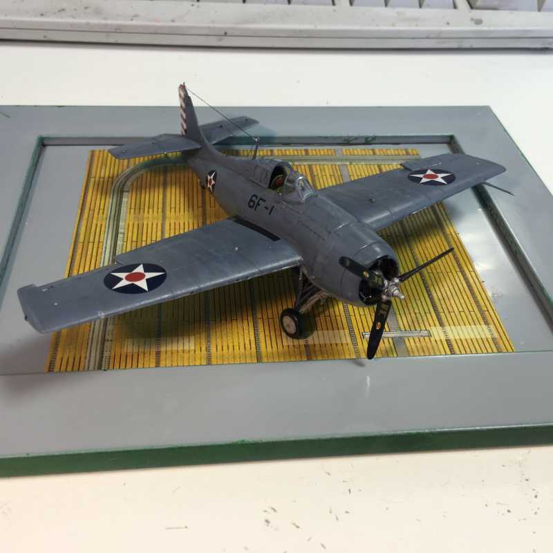

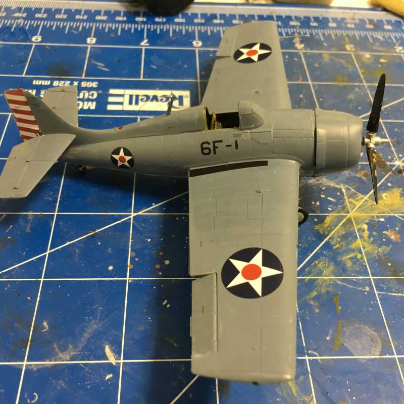

So dear friends I think that all the lessons received so far are paying of nicely. I am pleased with the model thus far, now she is all painted (brush-painted) and ready for the decals. See for yourselves:
I cannot thank you enough for all the help and wonderful tips. More to come, she should be ready this week if all goes well.

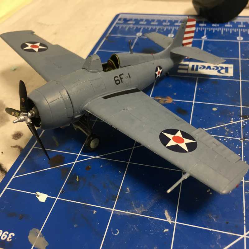

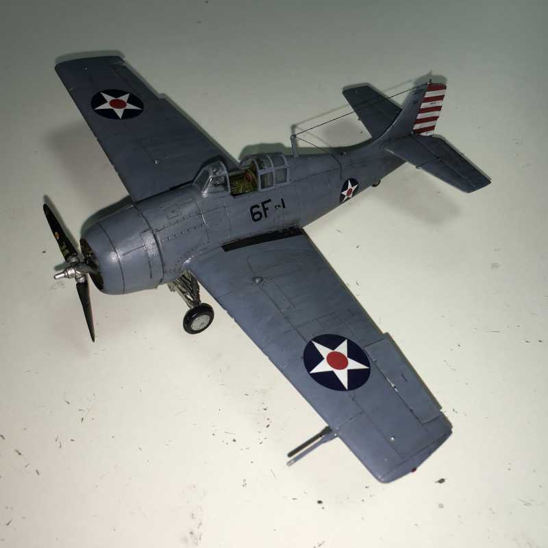

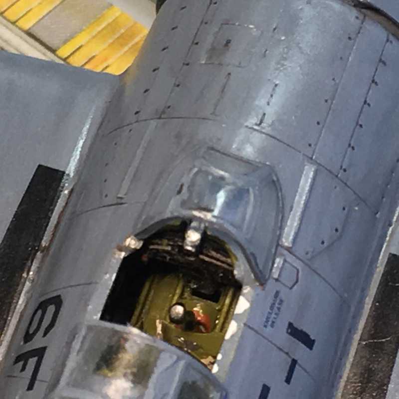

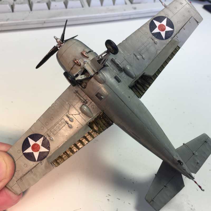

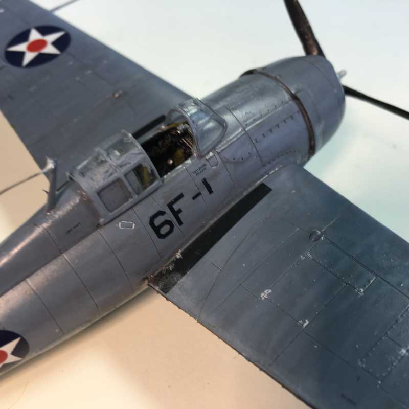

Well, I am ready. I think it is a big improvement. Not yet perfect, far from it, but I am getting there... :ro:
I am pleased with the results... See for yourselves.
Thanks for looking and for all the advice
Alex

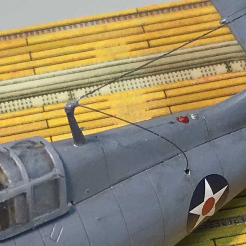

Very good Alex, nice finish. The canopy frames could use some work, if you take a tooth pick with some thinner on it you can work those lines back some and clean up the over runs.
Really nice finish (y)
Thanks Bob! That is a very good tip. Everytime I tried to clean that up (I don't know why the masking does not work in some areas..) I got the plastic all opaque - catastrophic!
I will try and see if it works. But, as I said, it is getting there I think!
Cheers
Alex
Cheers
Alex
Have you ever tried sealing the mask with clear coat? We use acrylic clear generally for that. Mask it, seal it then paint. if the mask fails only the clear will seep under the mask and make clean up much easier.
If the clear parts are going opaque then back off, probably using a solvent based that will attack the clear part.
No, I have never tried that Bob.
Clear acrylic... I must see if I have some (i remember once using an Italeri clear acrylic gloss, but it left a very thick layer on the model). Which one do you use?
See, it is really amazing how much you can learn here... Thanks again for the tip!
Alex
I'm not sure if you have it in Europe, maybe someone can help us out with that but here we use Future floor wax among other things. What I've liked to use lately is AlcladII Aqua Clear Gloss. Clear, like any gloss will be hard to get to lay down with a brush. Not sure how to help you with that.
Every build gets better and better Doc. (y) What are you using to mask the canopy? Tamiya tape or some other masking tape? A lot of bleed can be avoided by burnishing down all the edges with a toothpick or even finger nail. The gloss as a sealant is a good idea.
