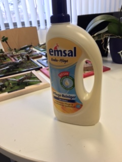

Thanks for the comments. I haven't found Johnson's clear, maybe it is just in the UK? Here in Germany I found this product :
It should work the same, I think, it contains Tenside which works as a fat remover and some wax-like product.

If that product has any kind of cleaner stuff in it I wouldn't use it. The "Future" Floor wax we talk about here in the States is basically an acrylic coating.
As an example some folks "dip" their canopies in it and carefully set them aside (covered against dust) to dry. Gives the clear canopy a real clear glossy smooth finish and tends to hide and cover up small scratches. I have been tempted to work over and coat my Toyota Corrolla headlight lenses with it as they have gotten a bit rough looking.

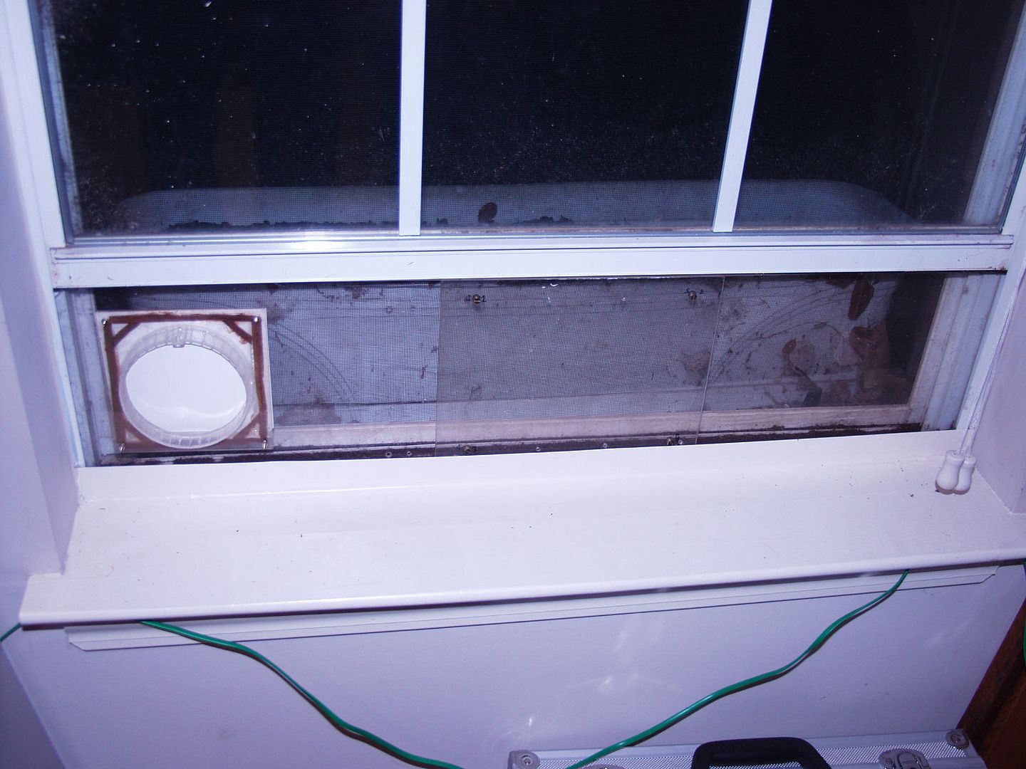

Hey Alex, the incubator is only part 1. Then you cut a hole in one end, add a fan and a shroud for pulling air out. Then it has an adapter to attach a dryer hose. The dryer hose goes to an insert you build to fit in a window.
Instant paint booth.
If the incubator was sealed it wouldn't work.

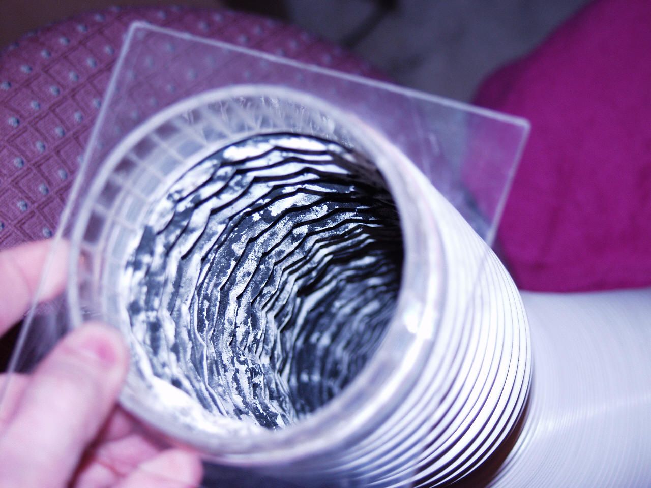

Here is what the old ducting looks like after a LOT of spraying. Have had this hose for years.

This is an OLD insert I used to use in my window. I have a newer one that is a small box that fits perfectly. Open the window a bit, insert box (that has weather strip) close window. It can be raining, snowing, cold or hot out and it makes no difference.

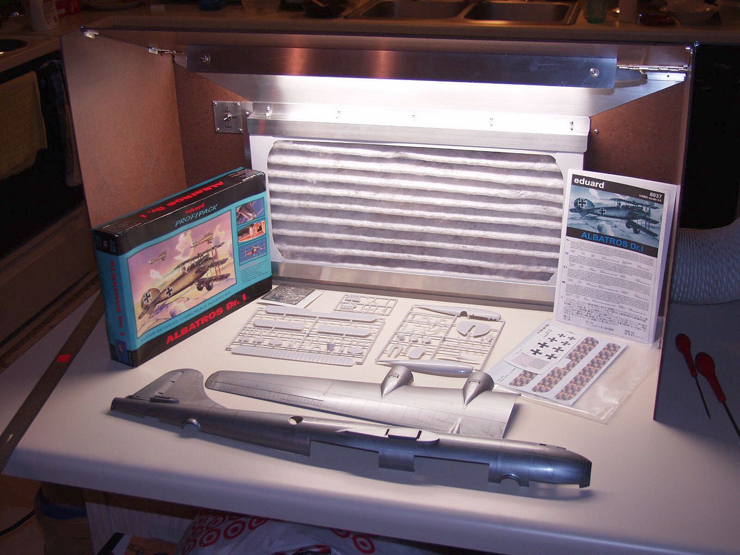

For grins here is the front side of mine. Yours needs to be a whole box.

If done right it should have some negative pressure. Always pulling air from the room. Something to think about?
I tend to think outside the box a lot. Mine is made out of masonite and clear acrylic sheet, with some aluminum extrusion from the hardware store here and there. I finally did away with the filter as it resisted air flow from the fans. What that means is that occasionally I have to wipe down the fan housings and blades. They get a coating of black powdery crud.
