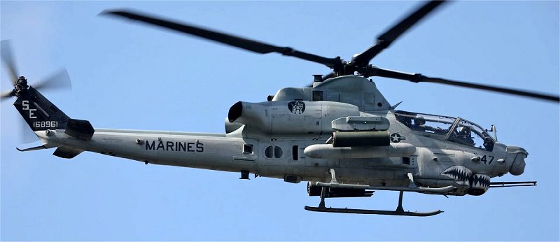

Here is the Real Deal...

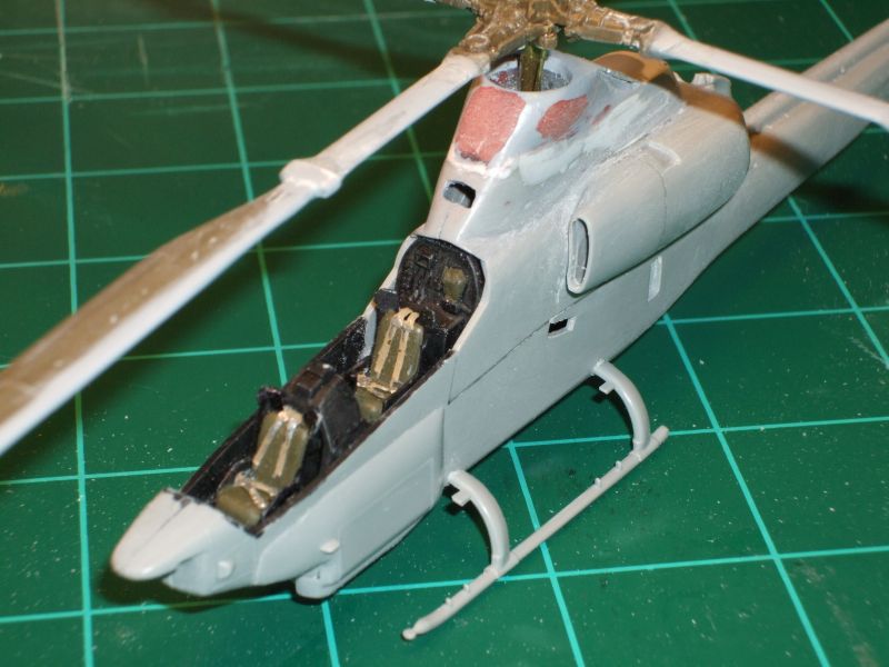

Here is my attempt at converting a 1/72 Whiskey into a Zulu.

@Frank; Your Weskey-2-Zulu looks great. I don't think my poor eye balls could take working in that scale.
Here is another Pic of 168961. A couple of things pop out that are interesting.
1-Seems to be assigned to a different "Flight" as the insignia on the engine is not the black cross.
2-The load out on this side of the aircraft is different with a fuel pod and a smaller rocket pod compared to the otherside which has the larger rocket pod and the hellfire rack. I know the kit comes with both the small and large rocket pods but I'm not sure about the fuel pod, have to see if I can find one, maybe off a AH-1W.

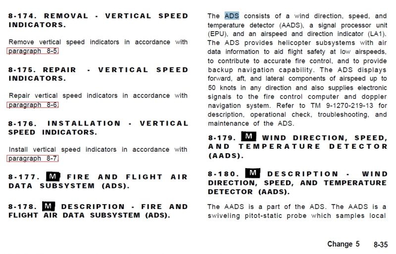

The "selfie stick" I'm talking about is in front of the gunners windshield. What would that be?
You think that's a fuel tank or one of those cargo pod things? I saw someone fly into Grand Forks in a T38, opened up a side panel on that tank and take out his A2 bag.
I also notice the US insignia not on the box art, is the insignia in the kit?
I hadn't noticed the missing US insignia on the box art, but it is included on the decal sheet.
As for the "selfie stick" I believe it's a Anemometer and/or Anemoscope. This device will measure air speed and since it swivels up and down I would bet that it also measures the pitch angle of the aircraft as related to the surface of the earth. I would think this same info will be use for calculating firing solutions. Now all this is just a guess as I'm not an excerpt by any means.

Pitot is the airspeed, this would be the AoA, Angle of Attack. I'd be interested to learn why it's installed like that, maybe it's a need to know thing though.

The item is an ADS. Excerpt from the manual describing its functions:
Most helos also have a separate pitot tube.
