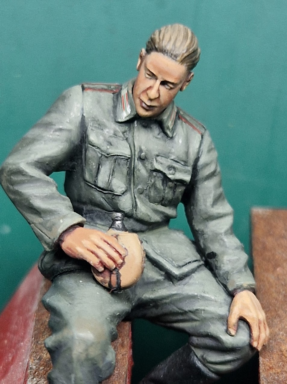

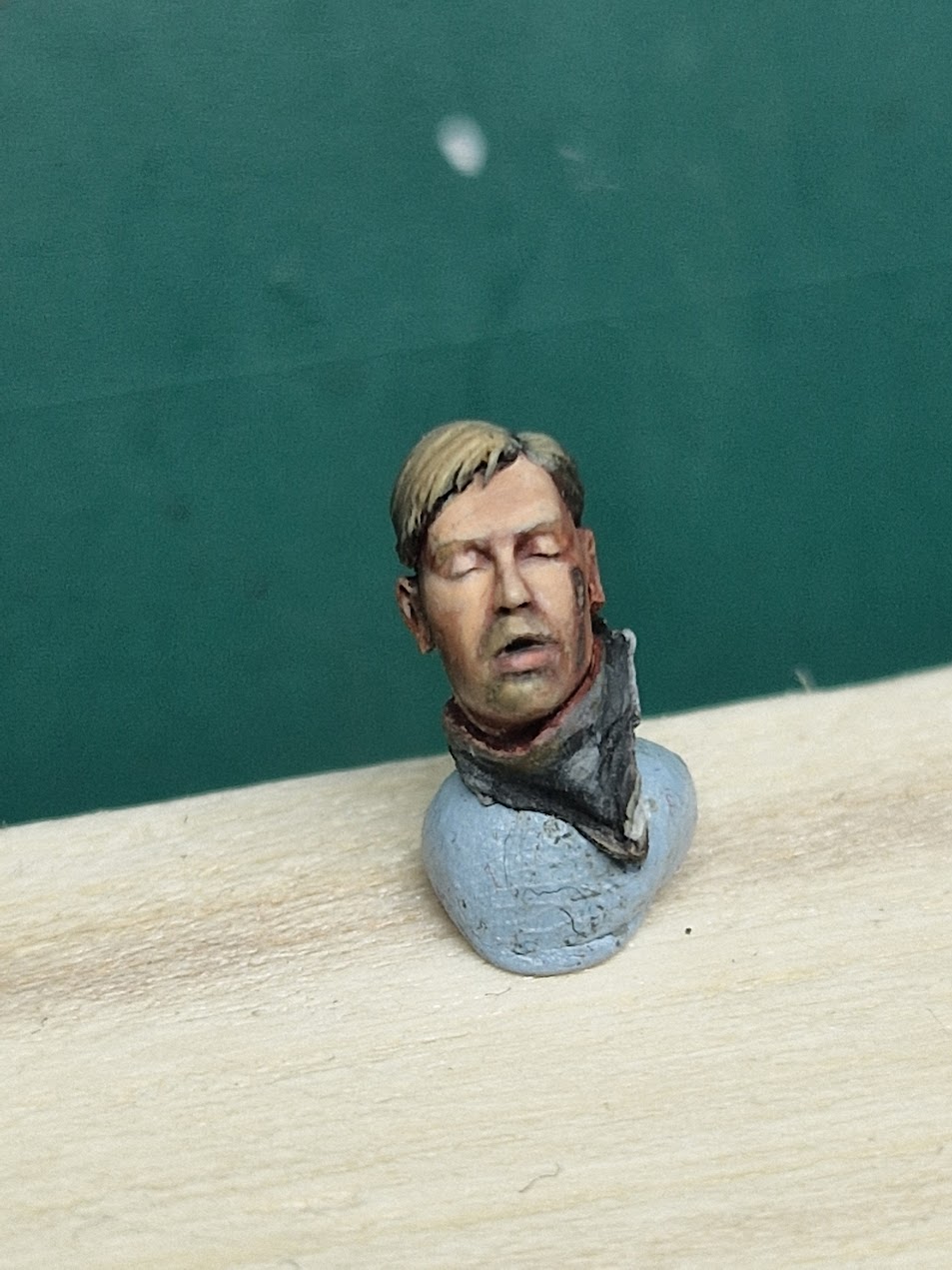

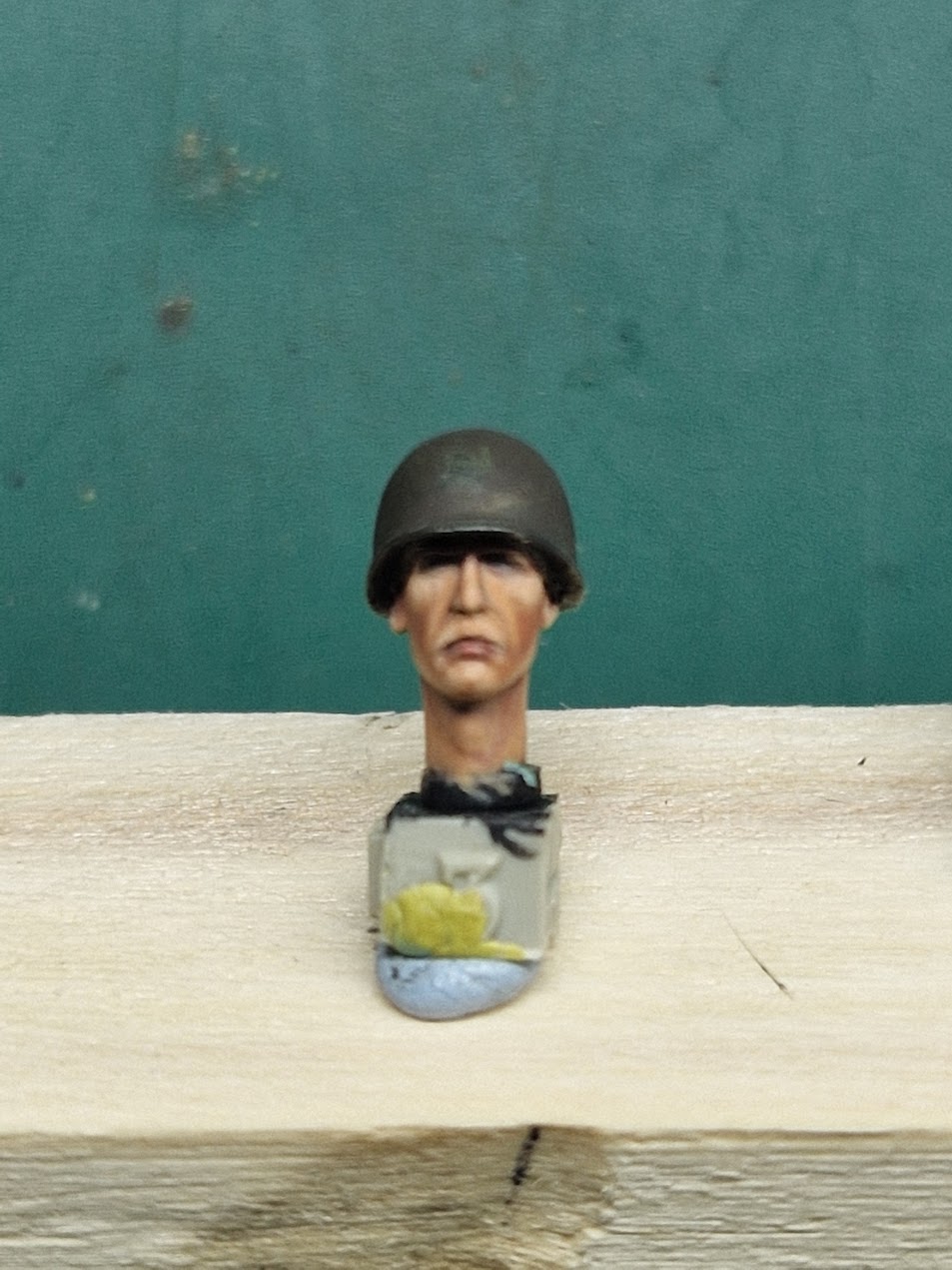

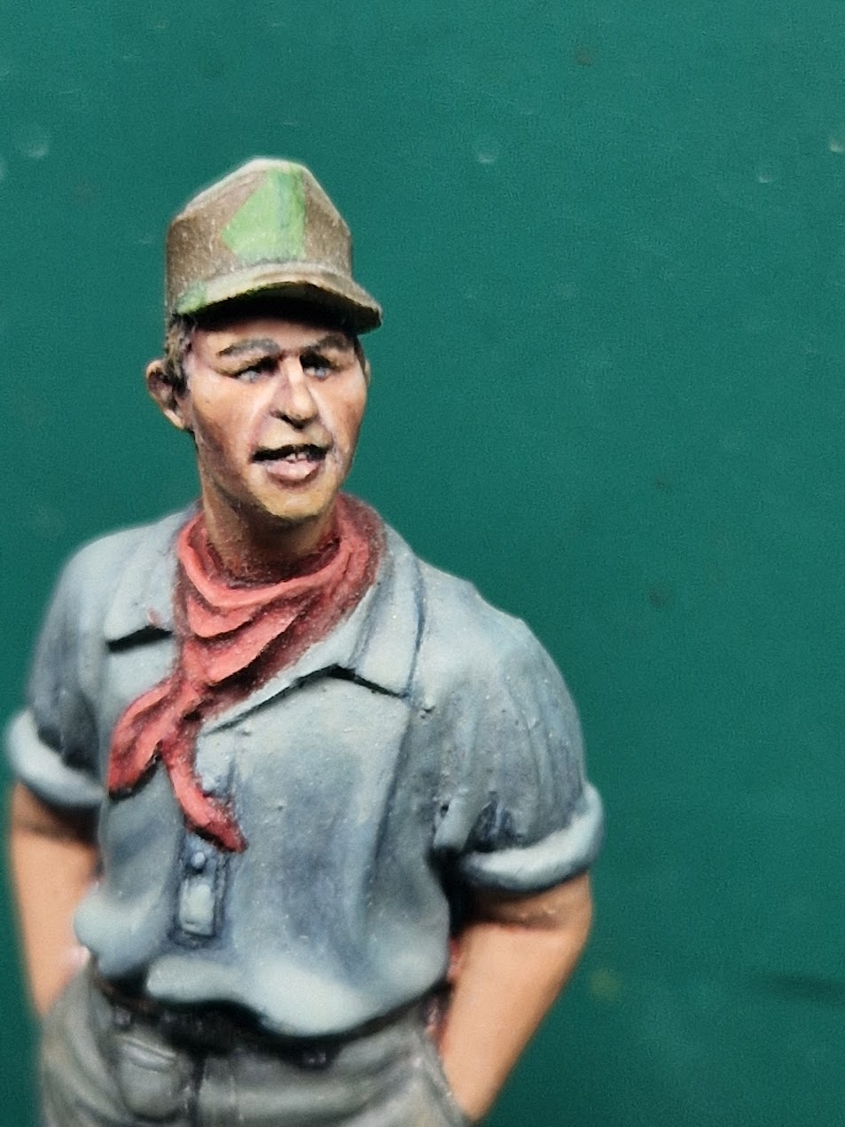

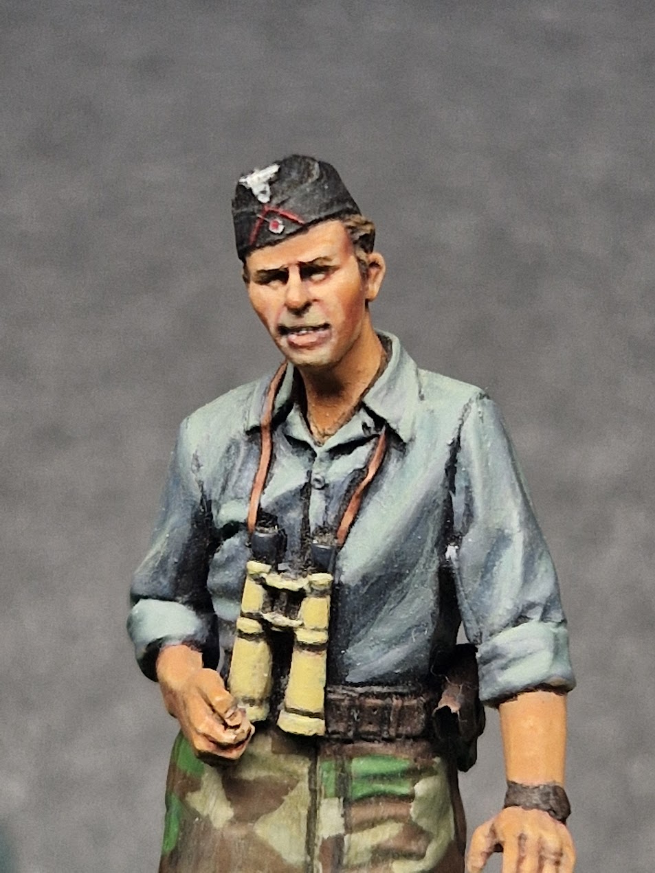

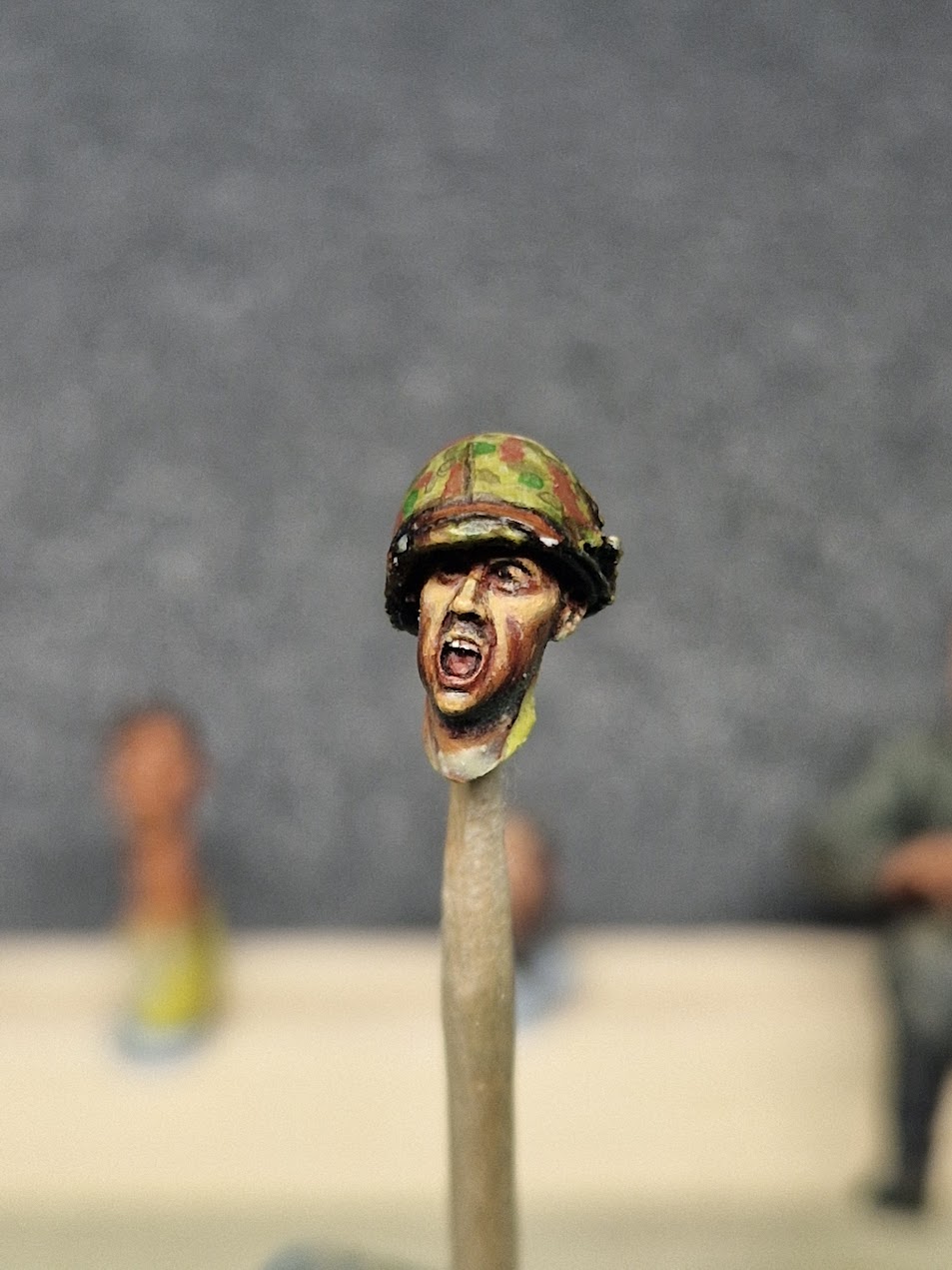

heres a taster of faces that ive done in the past purely for reference

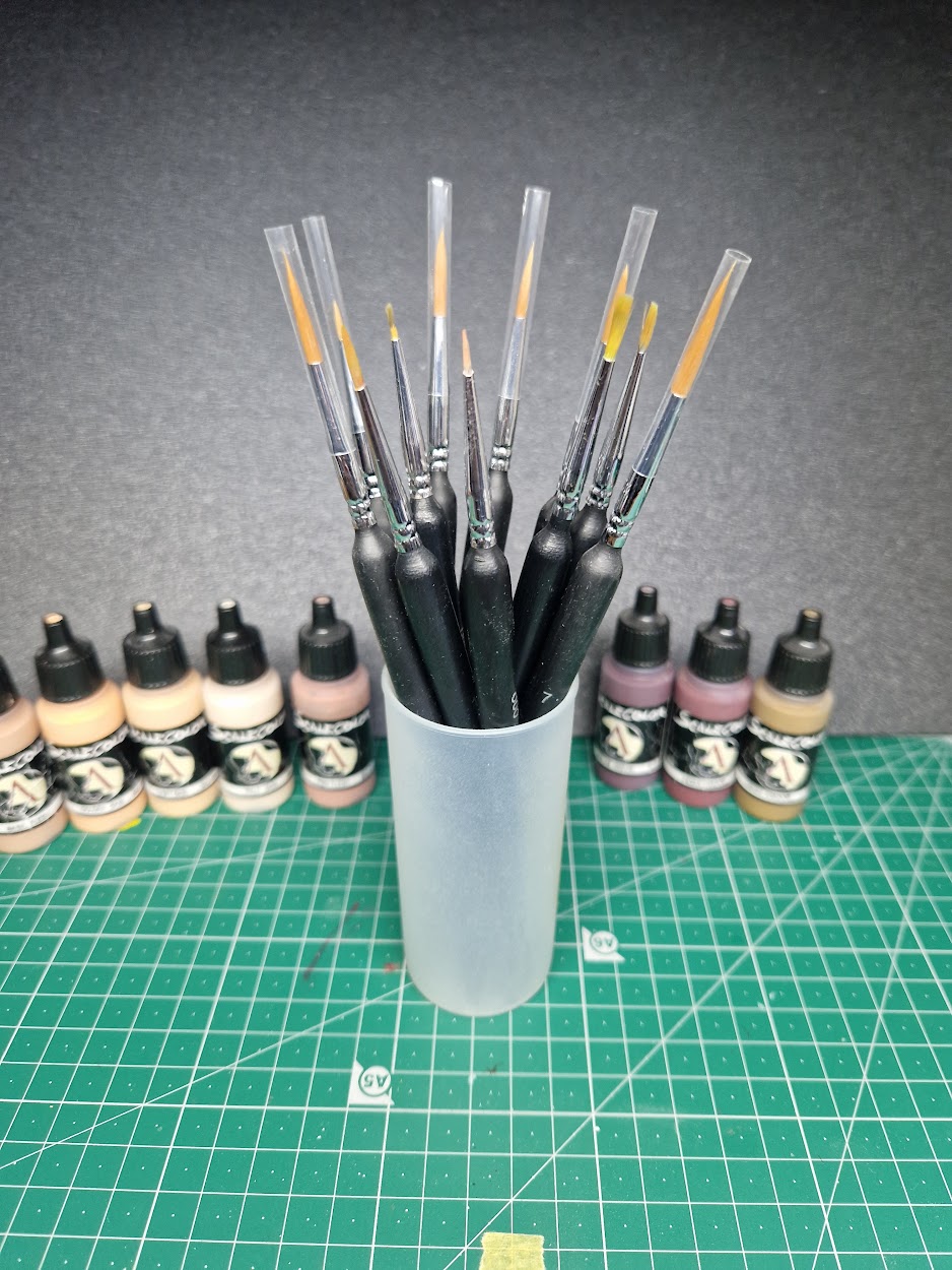

what I reccomend again at this early stage is to buy a set of dedicated flesh tones and a set of brushes
The brushes do not have to be a set of WN series 7 which will set you back an arm and a leg
the picture below is a set of "rounds" bought from Temu which ive foud are really good and as they are cheap if you ruin some then go back and buy another set.
also in the photo is a set of flesh tones from Scale 75 which I will be using for this tutorial but you can get my favorite which is the Vallejo set and also higher end sets like the ones below.

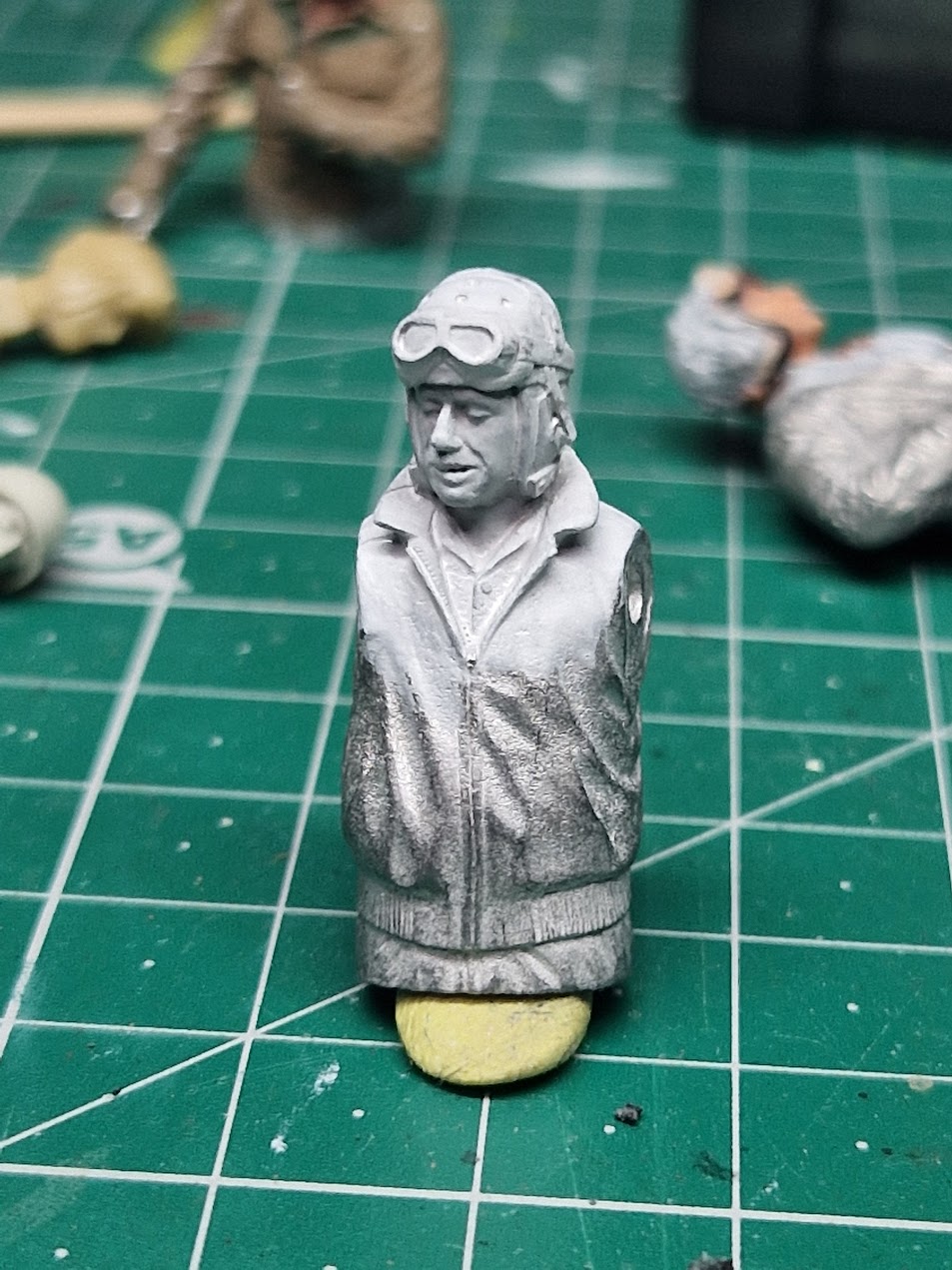

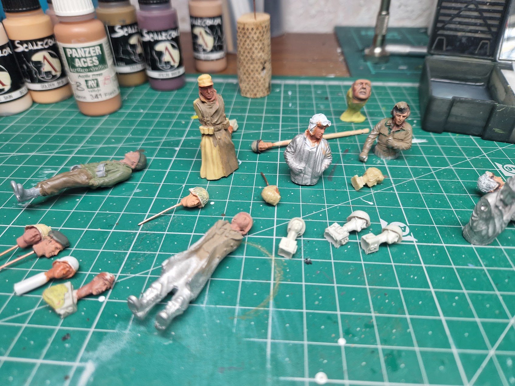

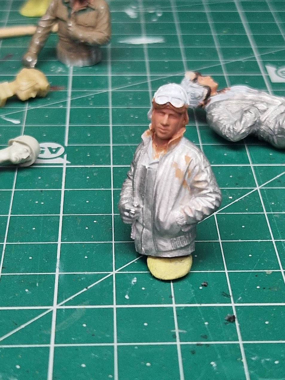

So as you can see i have a stash of heads in varying orders of paint progress but we will start with the Verlinden US tankers as they are bigger than the Hornet heads
as theres are very old heads they are cast in metal rather then the newer resin heads so its time to prime.
Prime suspect !
I use vallejo acrylic primers for my models because you can thin them and thats what we want for the faces ! Please note I am not a fan of this new fad of priming black then highlighting with white !!!
Why well firstly your adding layers that you dont need,
Secondly if you paint yellow then you have a base colour of white to bring the yellow out so why black to base a fleshtone?
So as you can see an thinned grey was applied to the first tanker and in the last photo a dark fleshtone mix was added to a different figure

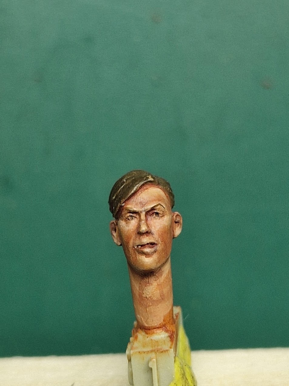

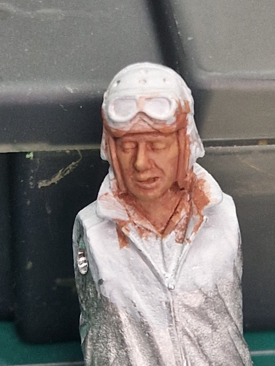

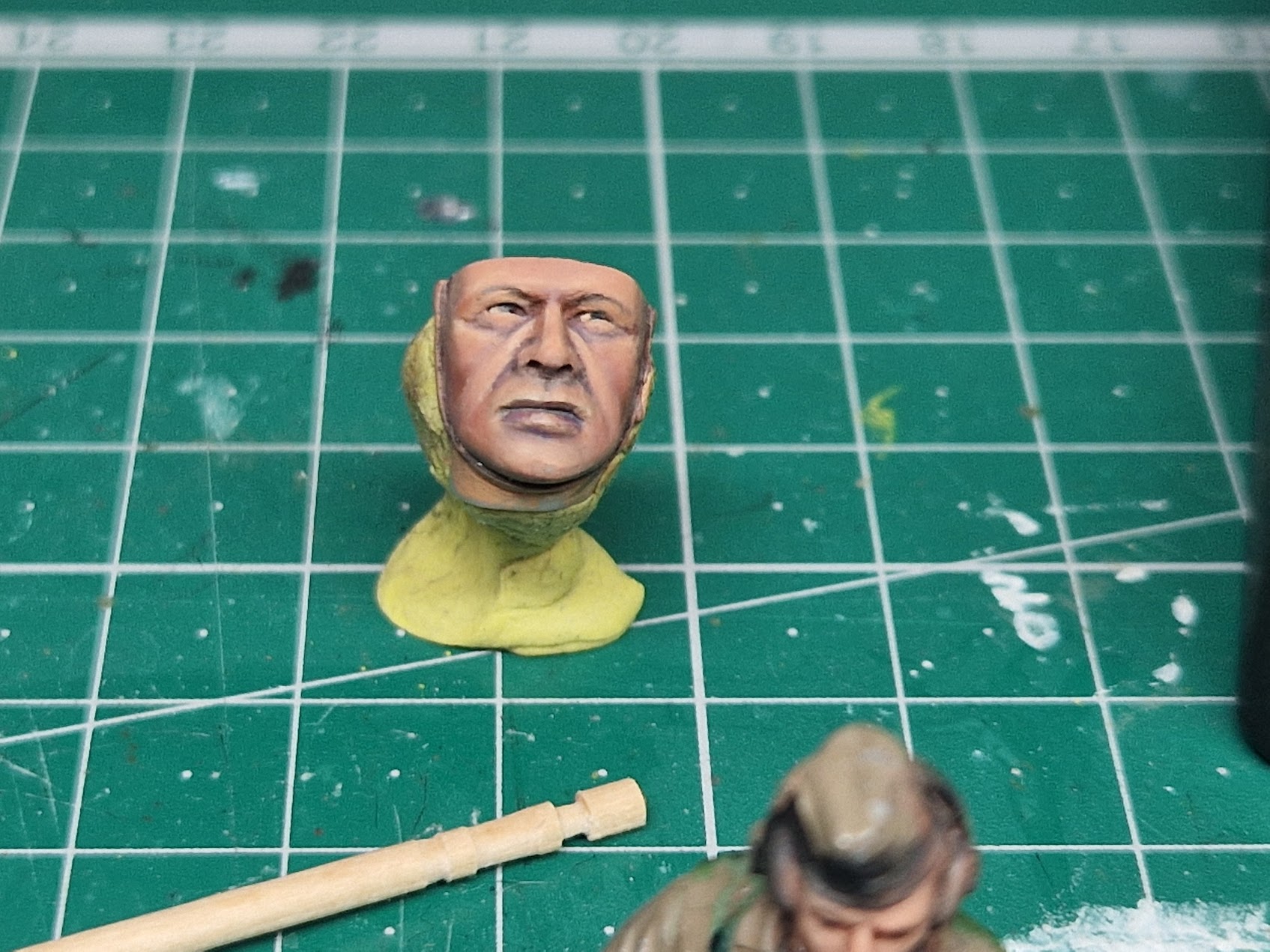

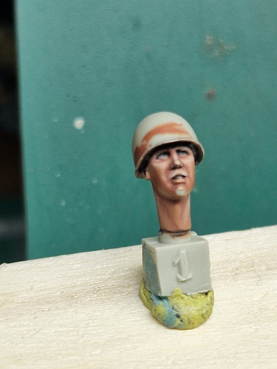

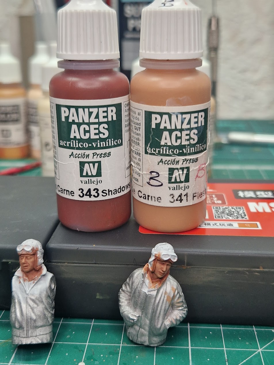

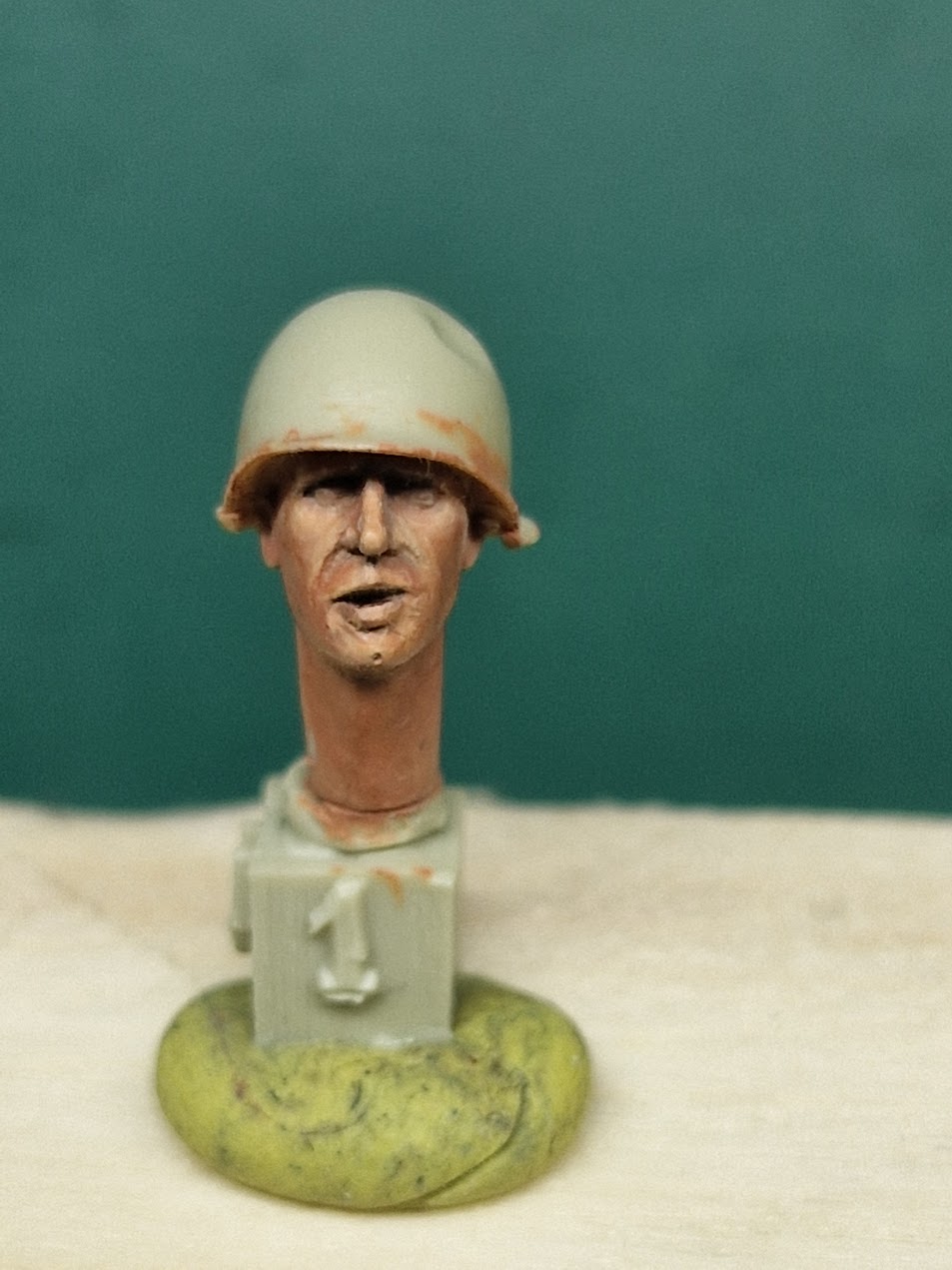

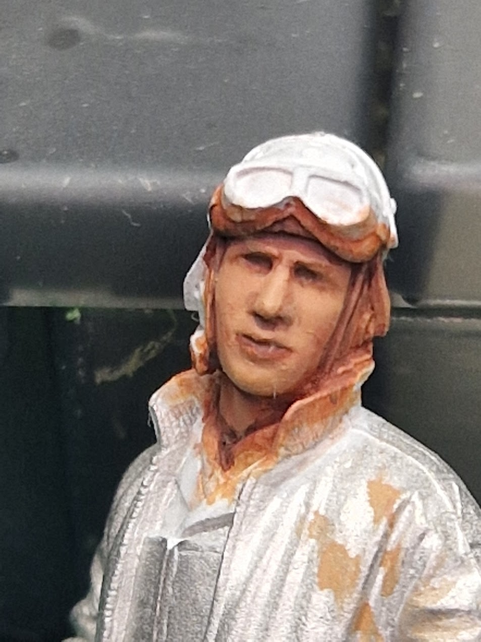

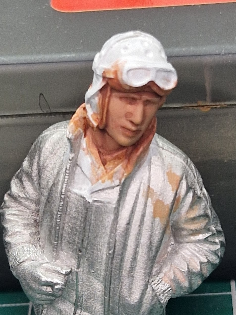

Pic 1 : both figures have now got their base colour but ive had to change up on the paints due to clogging issues with the scale 75 so back to my go to`s vallejo paints
2 3 4 base colour but now with a very fine shadow wash only around the edges and recesses eyes, under nose, and under chin, creases etc
5 6 now applied a very thin black wash to define the edges shadows under the nose and eyes
7 aurther just so you can see a tad better on a larger face but principle is the same
as you can see the face is being defined with hardly any paint applied but you must use a very fine pointed brush and if you have them a pair of optivisors with a 10 lens helps ypou get right in there
