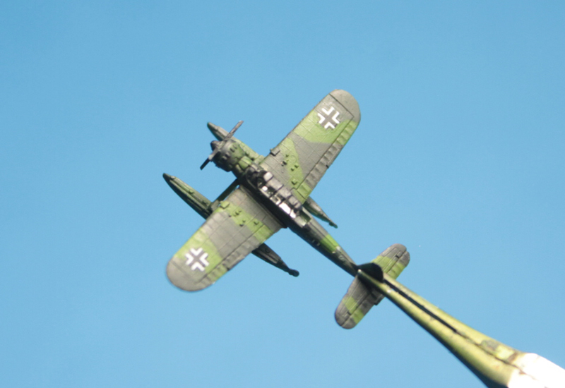

Here's a 1/700 Arado with no primer, the paint thinned as described and masked, so you can see it covers well and keeps detail intact.
