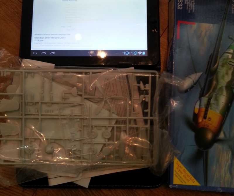

Aaaalrighty, then. Let's see how I do at this!
Here's where I start my 1:48 Revell Messerschmitt Bf 109 G-10 (no 04532).
Please be gentle- it's my first plastic kit in absolute ages. I plan to do it straight out of the box, although I may decide to use different decals.
I'll be brush-painting, and may have to adapt the odd colour as I go, as I don't have a local hobby-shop, so I'll be using what I have available in my collection. It may offend the purists, but it's intended to be more of a "getting back on the bicycle" build than anything really serious.
(y) Sounds like a great idea! It will give those rivet counters something to think about hahaha (good we don't have any here though :good: ).
I have a revell 109 to but in 1/32 but i will keep an eye on this one for sure :)
:popcorn
//Mats
They are here Mats, they are just lurking, waiting for the perfect time to strike...
Good start Olaf :popcorn
Excellent, Olaf, good to see you jumping-in... took me a couple of months before I got in to my first campaign here.
And yet another late 109.... Excellent !!
Ian
Since I am building one of these kits right now I will be watching this with interest.
I have built four of these kits before and the only thing to be wary of is the wing dihedral, as built out of the box these kits usually end up with the wings too flat looking, the good news is some sanding of the wing roots on the fuselage before the wing is attached will easily take care of the problem just dry fit often so you don't remove too much plastic.
Matrixone

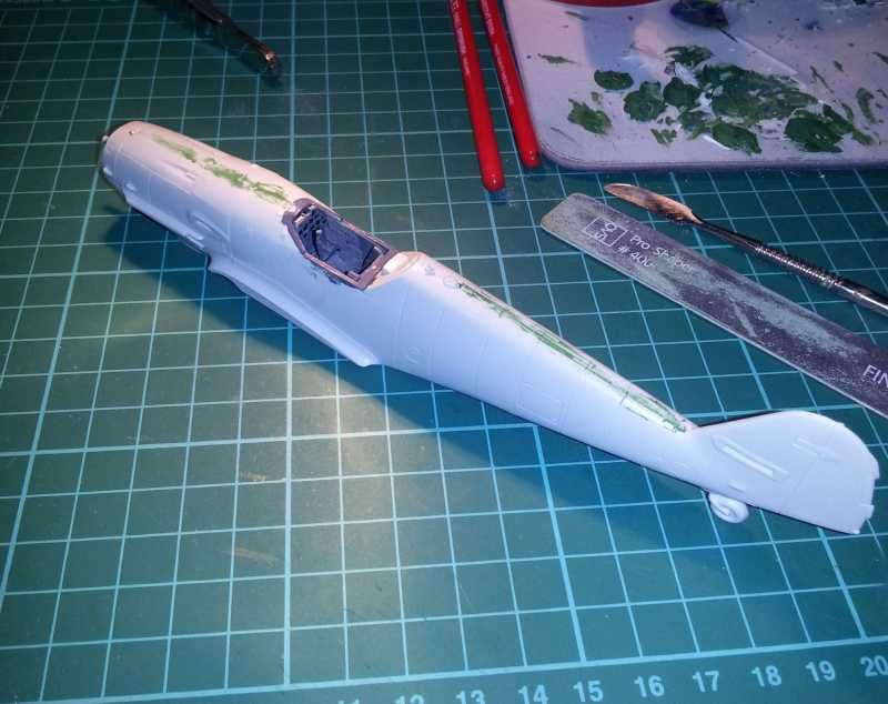

Well, baby steps...
I've just finished the cockpit tub, done a paint-job in dark grey (yeah, I know- not RLM-approved, but it'll do for my purpose for now), and picket out the instruments in black.
Assembled the two fuselage halves, and added filler along the seams.
Once the filler's dry, I'll sand the seam, and re-scribe any panel lines that are ruined.
(y)
Baby steps are also steps! :soldier
Looking good, the cockpit colour is a real problem to get right, i searched info for my Stuka and i gave up and did something that i thought looked good :geek
//Mats
Looking good there Mainly28s.
