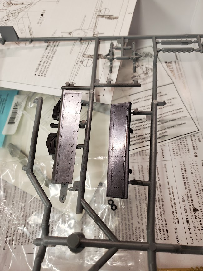

Well I had given up hope of finding the canopy rail and was looking for something else to work in. Did some repair jobs on broken bits that were damaged in the move. Contemplating on what to do next I pulled down the box for the SK 251 Flak halftrack thing. While doing inventory of the various parts and what showed up?
The boys thought I was having a heart attack but it was really a modelGasim!!

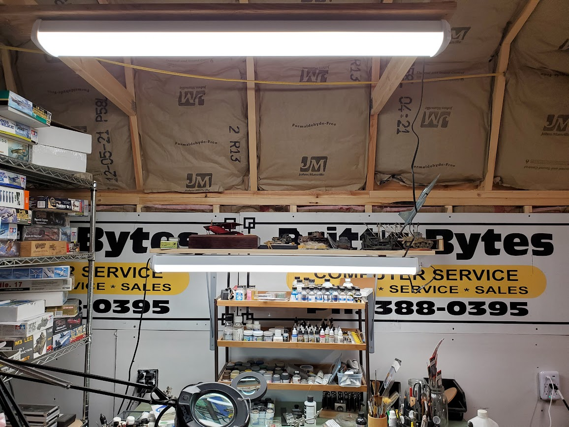

I got motivated and installed a 1x4 between the crossmembers and installed this other light I picked up at Costco a while back. I forgot how easy it is since it's ready to plug in. It can actually plug in tandem with the other light and pick up it's settings. Got my electrician coming tomorrow to install a switched box up there and I'll have all my lights switched then.
What a difference!

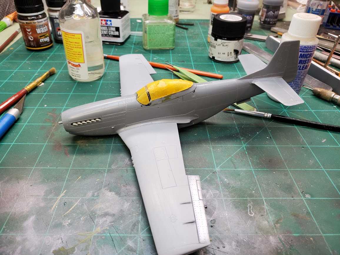

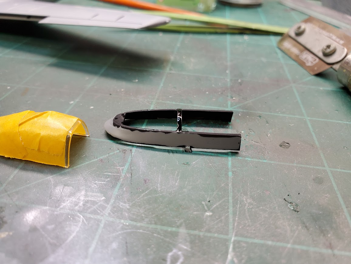

Since the juices are flowing I got the canopy installed.
Glued the rail on then used PVA for the clear part. Going to let that dry before trying to primer.
Progress Baby! :pilot

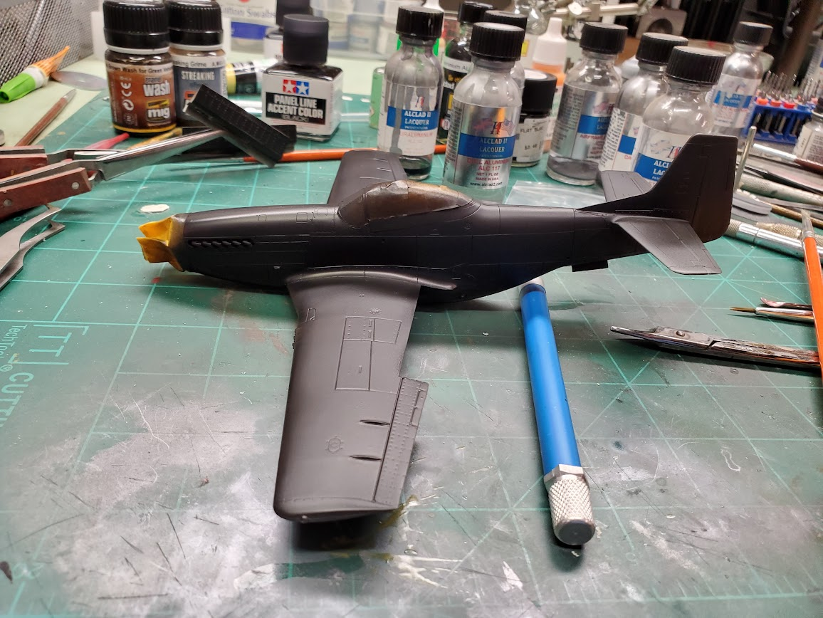

Thanks to Greg for getting the Alclad primer to me. As he suggested, needs a rub down as it's a wee bit gritty. Sanding from 6k to 12k smooths it out well.

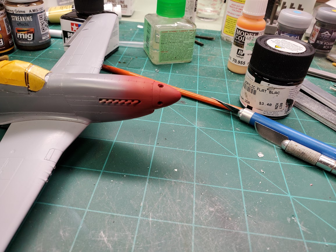

I'm still debating what colors to use here. The polishing pigment are intriguing to me but it sure doesn't photo well.

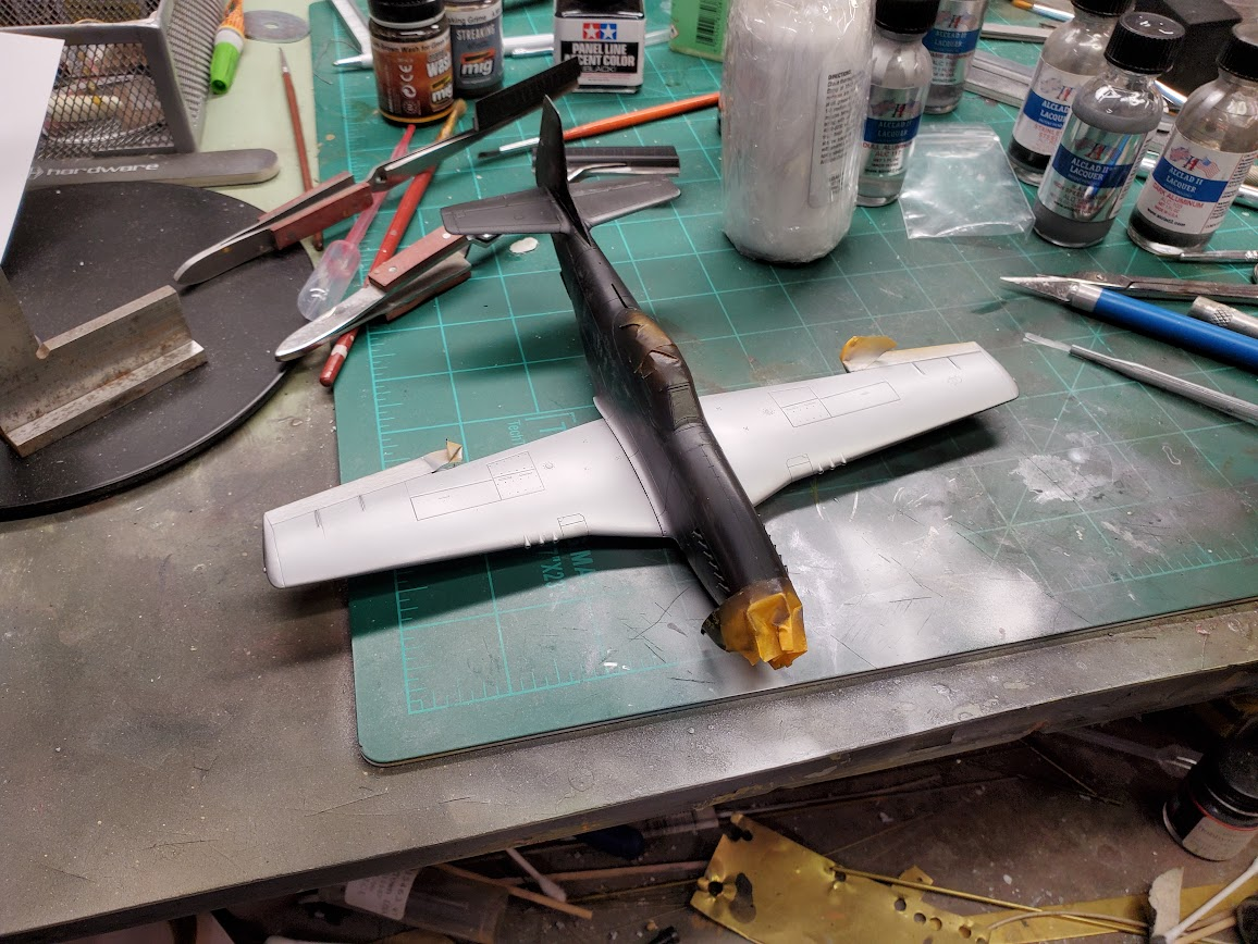

Flap on the left is unprimed, bare plastic. One on the right is primed and polished but from the photos, it looks like high polished black. What do yall think?
Oh I tested the peal test with masking tape, the polishing pigments really seem to standup to no lifting.
On my P-47, I used the Alclad gloss black. It is such that it will bond to plastic just like a primer. After spraying it on I used Mr. Retarder with a light mist/ not quite wet coat of the retarder that leveled the gloss out so it was like black glass.
After using the chrome and then some of the other lighter aluminum colors to give some weathering to the metal I actually applied Tamiya decals directly on the metalizer using Solvaset. Had no problems with the small ones at all. The larger ones had some issues, but that was more with the Tamiya decals than with the paint.
