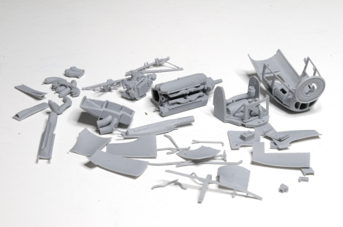

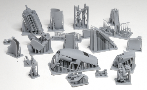

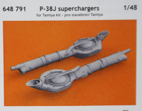

Off we go then.....i decided to start with the engine because there is a lot of cutting to do to the basic kit and i dont want to do that till i know i have succeeded with the Eduard stuff....just hedging my bets :)
It took 2 hours just to separate the parts from their print frames :)
This is just 2 parts..the problem with this is ,unlike the Aires stuff with separate block, cylinders and rocker boxes etc this one piece system makes painting more tricky.​

You are feckin insane, old man. All that small fiddly stuff. I can't wait until this goes together.
Paddy should have been a watchmaker. Get out your 5X watchmaker's loupe, binocular microscope, and the high magnification optivisor. :bigrin:
looking forward to seeing what you do with this Paddy.

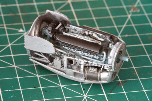

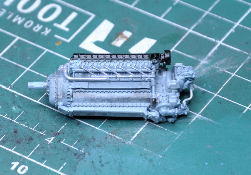

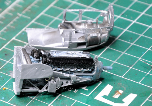

The engine has progressed to near done. I'm quite impressed with the 3D print but dont know if in this case i prefer it to the old resin casting method. This engine is not an easy build and its pushed me to my limits. The resin cast engines involve a lot more parts, these 3d prints can get more detail in a single part as you dont have to consider how to get it out of the mould. My issue really is in this scale ( the whole assembly is about 1" long and 35 parts) the location points are near invisible and the instructions are next to useless for accurate positioning. Get something wrong and it throws the rest of the build out
Still waiting for its exhaust to turbo piping

Adapting these parts into any kit is not for the faint of heart, if you can't make it fit no one will.
VERY NICE Paddy! I agree with you on the amount of detail that is there and how difficult it must be to get it together and correct. Eduard has really upped their game in recent years. The only problem I ever see with these tiny builds (not yours) is the paint. The smaller the build the more precise, thin, and smooth the paint needs to be. That really becomes a matter of super skill to do and get right. You have become quite good at this!
I know where you are coming from Paul, its one of the reasons i was so pleased to find MRP paints because their pigment is really fine.
Once you start taking macro pictures a world of disasters opens up :) especially with paint, of course the reality is no one sees a 1inch long engine suddenly 4-5 inches long as in the photos in real life but it is a great way to see where you made a mash up of something ?

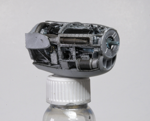

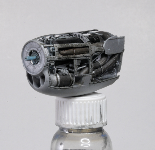

Here it is with the exhaust manifold fitted
