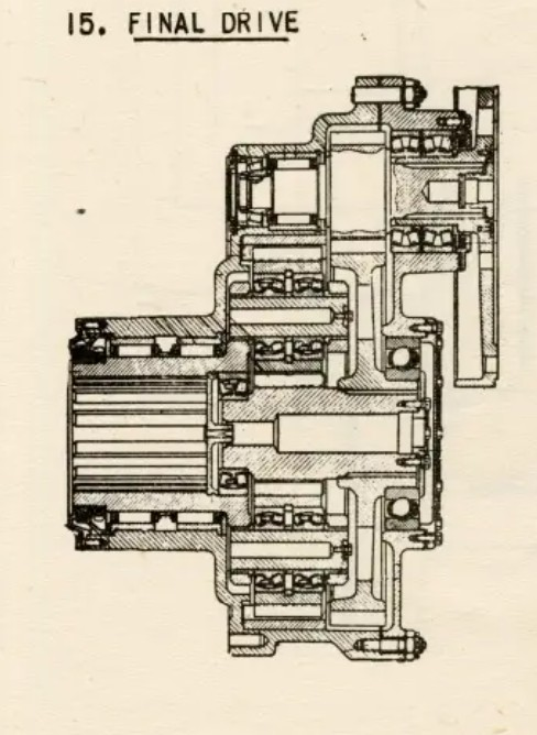

These pictures are from the Preliminary Report No. 10 - Russian KV-1 -
Military College of Science STT Chobham Lane Chertsey February 1944
Love the Ron Popeil reference! I do have that report too but remember a disconnect in translations.

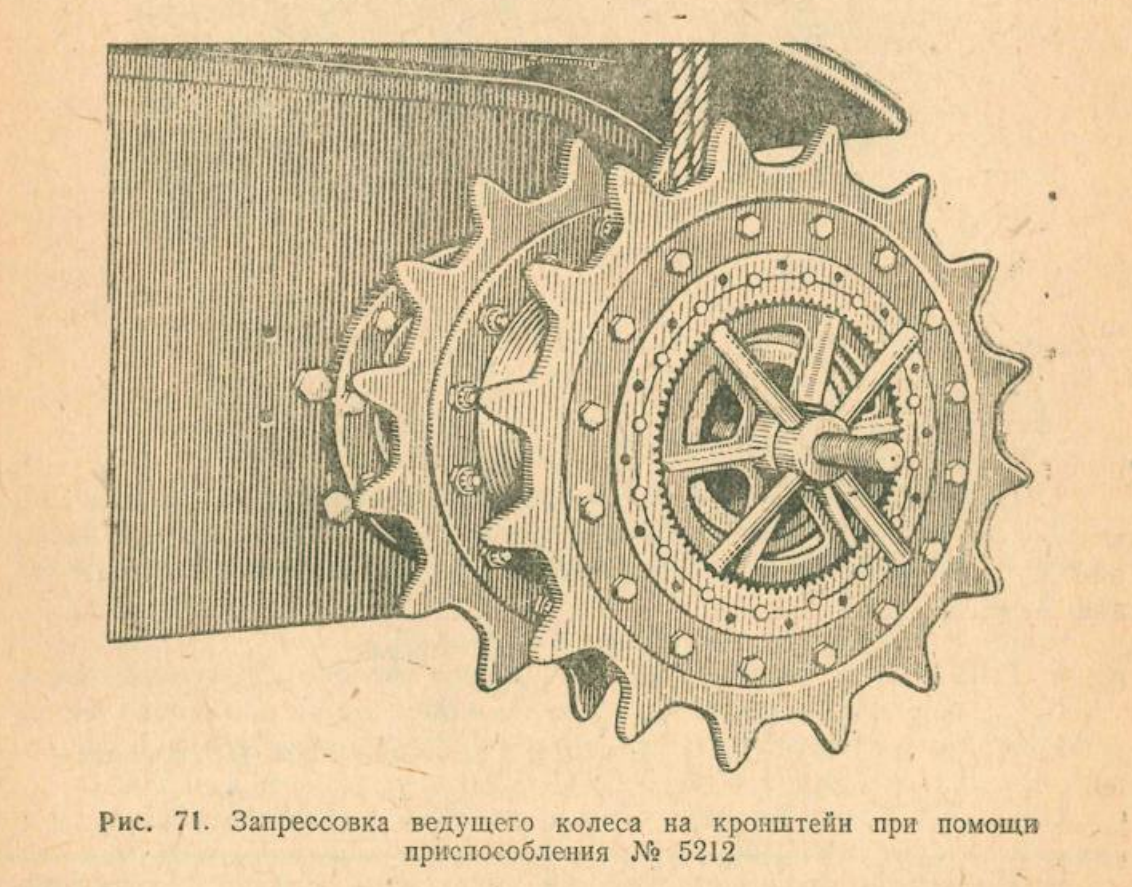

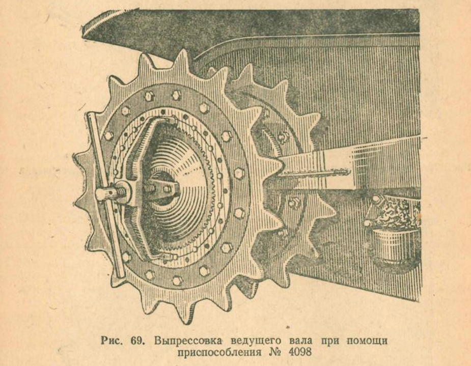

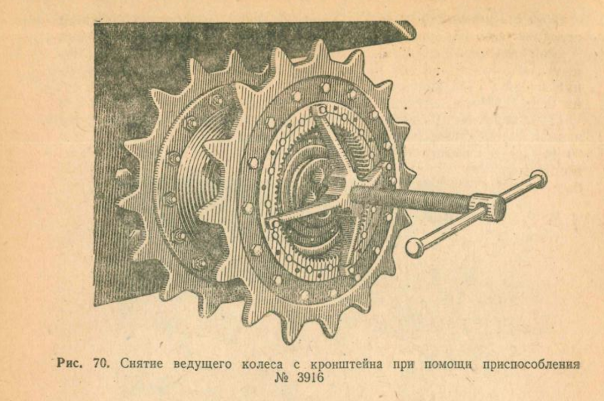

OK, the repair manual for the KV has these illustrations...
Caption to figure 69 is "Pressing out of the drive shaft using device No. 4098" so perhaps I am thinking drive shaft and the British report calls it an axle? For some reason it didn't click with me! DOH!
Caption to figure 70 is "Removal of the driving wheel from the bracket with the help of device № 3916"
Caption to figure 71 is "Pressing the drive wheel onto the bracket using tool No. 5212."

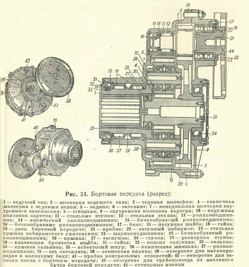

The russians didn't use the word axle (ось) preferring to use shaft.
Caption to Fig. 31. Final drive (section):
1 - drive shaft; 2 - drive shaft pinion; 3 - driven pinion; 4 - sun gear with driven shaft; 5 - carrier; 6 - satellite; 7 - fixed internal gear; 8 - stud; 9 - inner half of the housing; 10 - outer half of the housing; 11 - steel bushings; 12 - steel bushing; 13 - roller bearing; 14 - tapered roller bearing; 15 - barrel roller bearing; 16 - barrel roller bearings; 17 - bolt; 18 - brass washer; 19 - nut: 20 - final drive disk; 21 - plug; 22 - brass labyrinth; 23 - steel labyrinth seal cover; 24 - ball bearing; 25 - Barrel-shaped roller bearing; 26 - cover; 27 - plug; 28 - bushing; 29 - spacer sleeve; 30 - floating bronze washer; 31 - nut; 32 - oil seal ring; 33 - oil seal; 34 - oil seal cover; 35 - asbestos cord; 36 Tapered stud; 37 - Roller bearing; 38 Satellite axle; 39 locking strip; 40 - hole for oil lines to oil tank; 41 - inspection hole plug; 42 - hole for filling oil into final drive; 43 - hole for pipeline from final drive oil tank; 44 - locking strips;

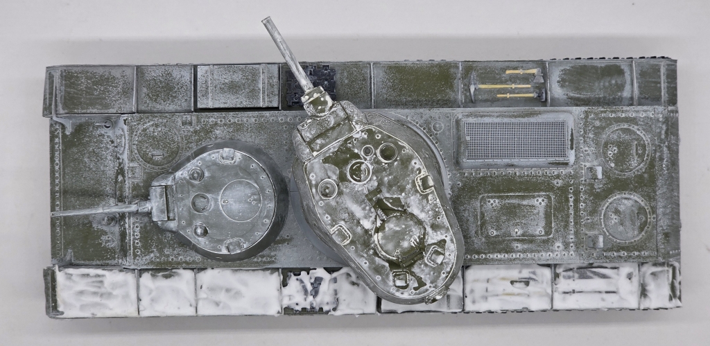

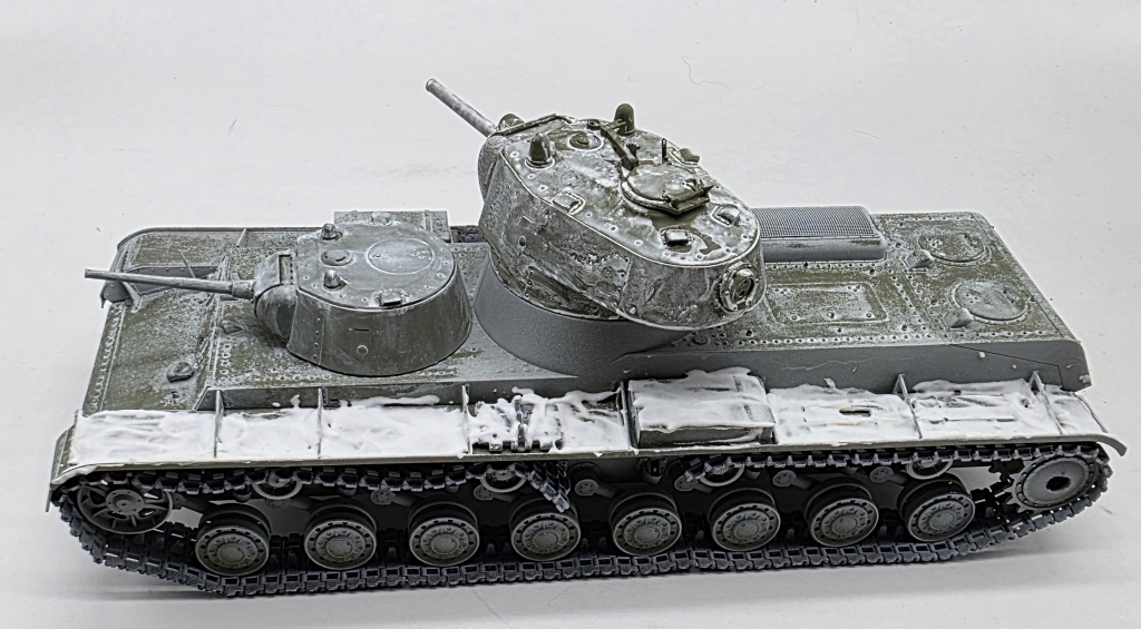

I guess it's just a general representation then because I've just got the kit stuff to work with and I'm just going with what I got.
I will neither confirm or deny my profession, avocation, or that we even talked about tanks in general, with that said, Mike, with all good meaning please look out your window and see how snow accumulates on objects.
Lol
It's just the start John...just playing around with the new product. Patience my friend as you preach to me ;) Trust me...after all the plowing I've been doing this break, I'm aware of snow coverage...

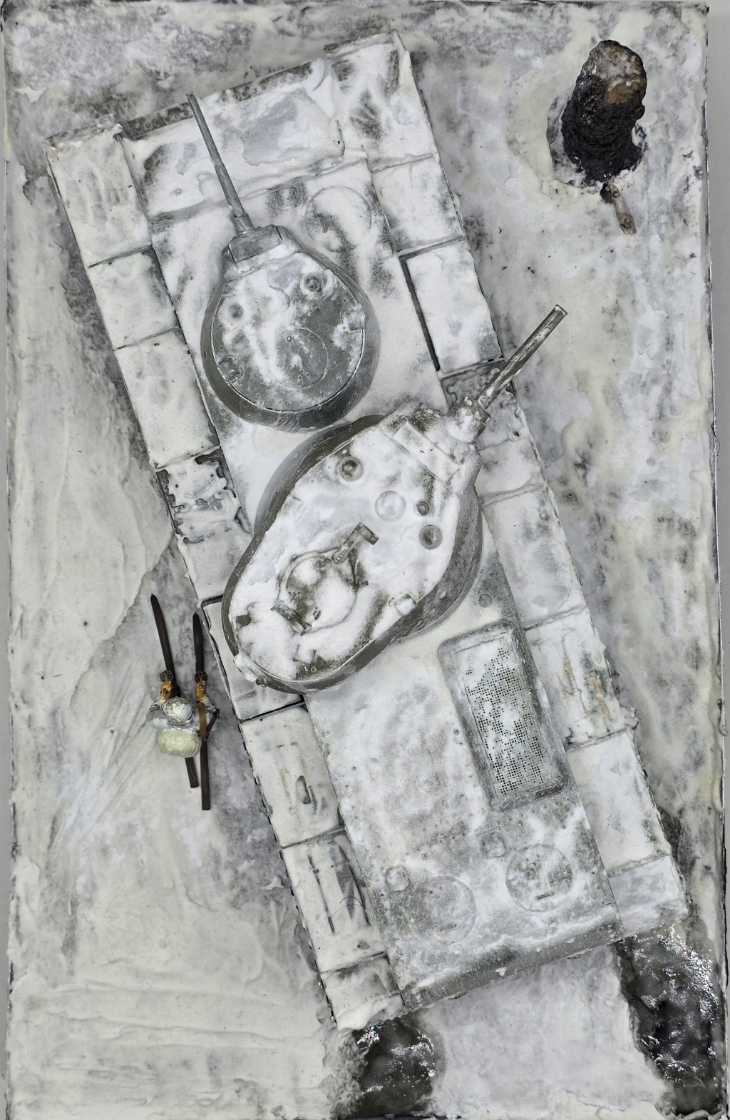

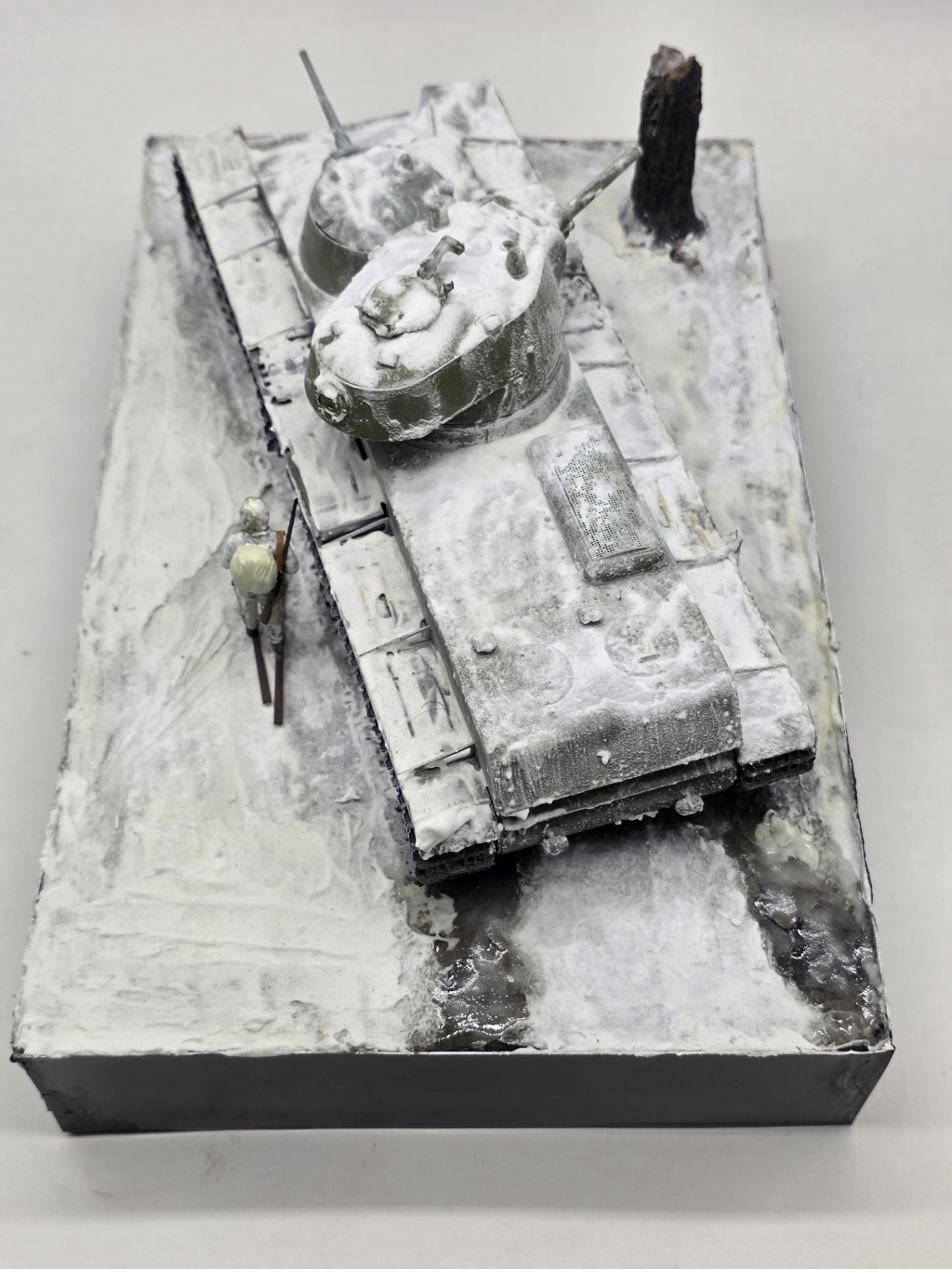

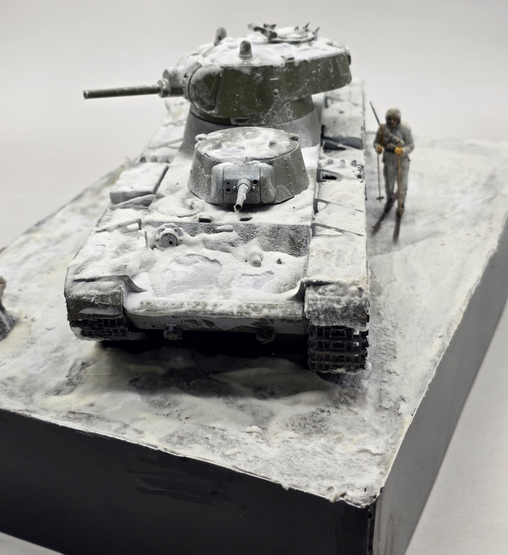

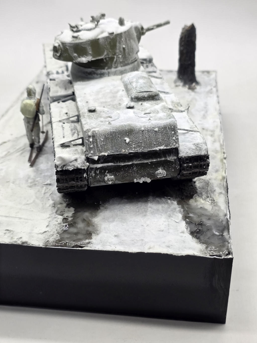

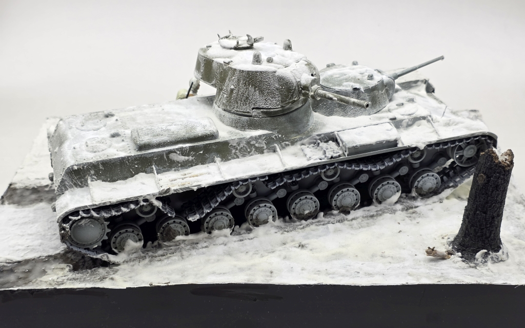

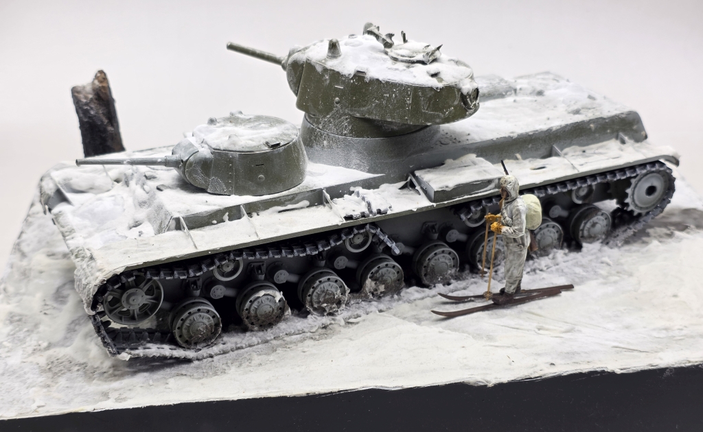

First-- a conclusion of sorts to the SMK build. I am not completely happy with the snowfall on the ground and need more work on it and the tank. I did like how the ice in the tracks came out-- just some UV resin with some AMMO Wet Snow mixed in...figure is a Finnish skier from ICM and the rabbit is from the Tamiya Livestock set.
I like it Mike, you're always your worse critic. You've been around ice and snow far more than I have but the only thing I would say is the tracks. The tank is knocked out, has it been there so long another snow fall has covered the tracks. Would it be ice sheet like you have or fresh snow covering tracks?
That's what I'm trying to figure out lol. It was left there for a while but I had no specific time frame in my head for how long it's been sitting there in the scene. Someone mentioned it looks windblown and that sure happens around here.
Well that certainly looks frozen.❄️
I agree with Bob, some fluffy snow and build -up on the side with the figure would add some variation.
