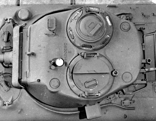

MISTAKE #1 - Do proper research! In my video, I mentioned that the tracks are not correct for a Pacific build, and that it was perfectly reasonable to have those 'other' type tracks on it. Turns out the same is with the Cupola!
Turns out, the instructions ONLY call for the earlier 'split' typ hatch, even though the kit includes the later cupola with vision blocks, even has nice separate blocks in clear, really nicer than the older Tamiya. But goofball me, I was blindly following the directions and as I had CA'd the cuploa in there, i had to Dremel it out.
MISTAKE #2 - I also managed to gouge the turret, so I installed the correct Cupola, added some gel-type CA, and did some sanding. I was not doing a good job paying attention., and the commanders hatch is oriented incorrectly - ARRGH!!!

Sorry I didn't see this earlier. The commander's cupola hatch does rotate but the cupola doesn't. As long as the periscope orientation matches photos, you are fine.

OK at last count i had seriously goofed this up. The kit comes with parts for the Cupola as Saul shows above, but it is not included in the instructions! the cupola in the instruction (and kit) is the lend-lease type that Russia received. these were a simple ring with a hatch that splits in the middle. here are both of the cupolas on the sprue:
I installed this and later did such a poor job removing it I decided it was best to simply order a second kit, and as you can see, it arrived!
