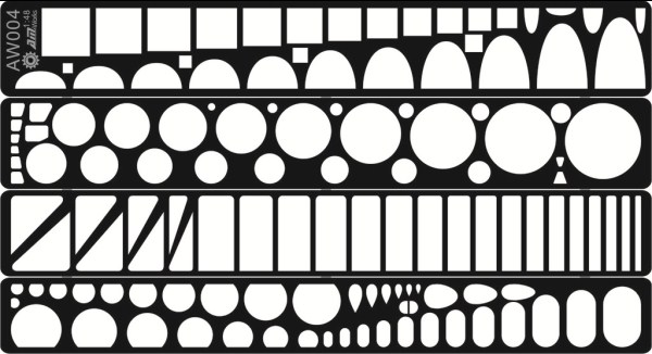

However what I was wondering is not what tools you use to scribe lines but how you make sure you scribe the lines where you want them without the scriber slipping. Do you use a template and if so what do you use for a template?
Thanks again and cheers from Peter
There are all kinds of different templates available from different companies, both with generic shapes as well as template sets for specific vehicles.
This is a set from Alliance Model Works of just general shapes.
This is a set from TechStar that gives both curved templates but also has spacing for rivets.
And like Rich mentioned, you can make your own. Of the ones that Rich suggested, the only one I've used is Dymo Label Tape and it works great, but does take some care when laying it down but it can be made to conform to curved surfaces pretty nicely.
