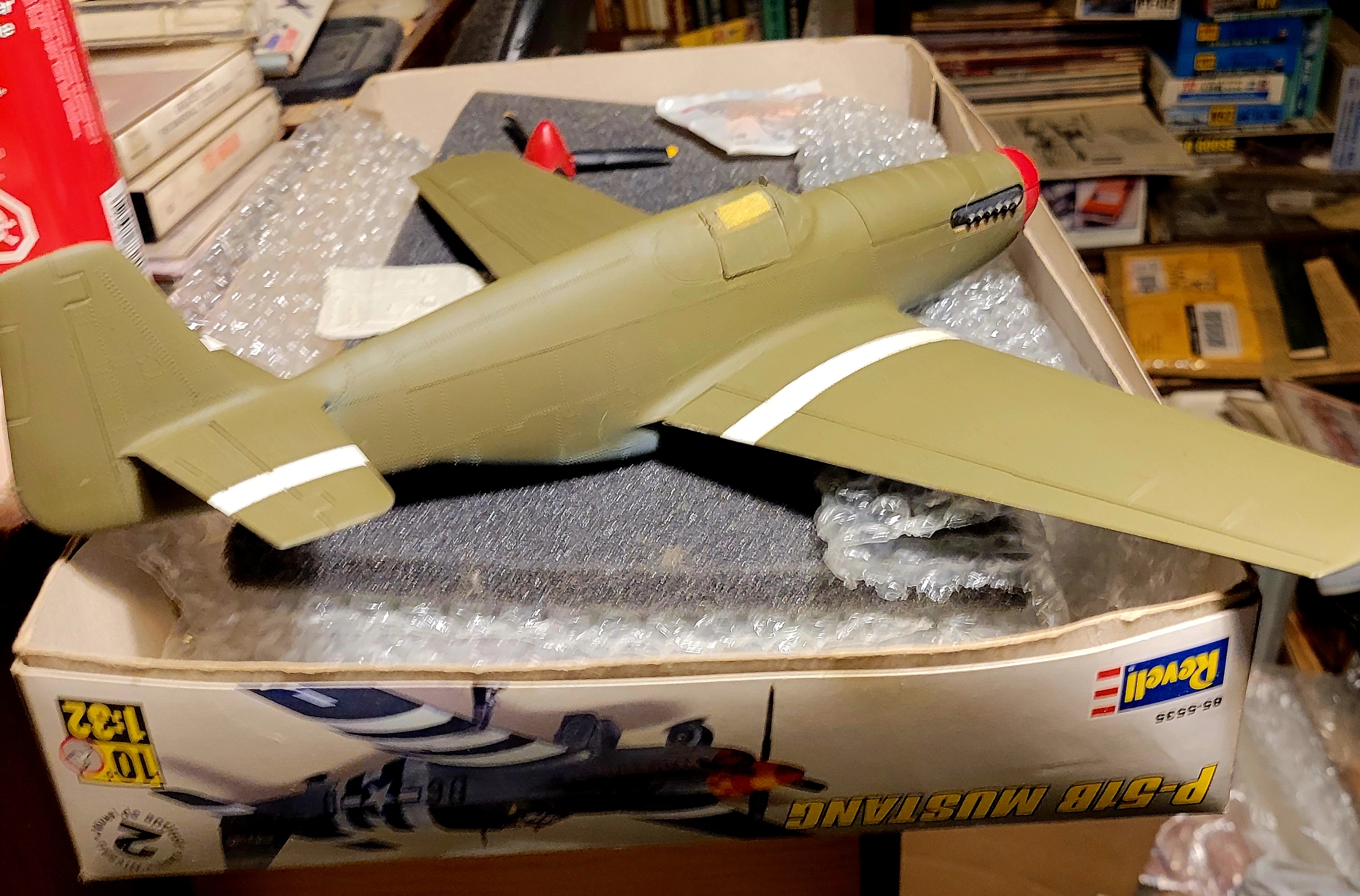

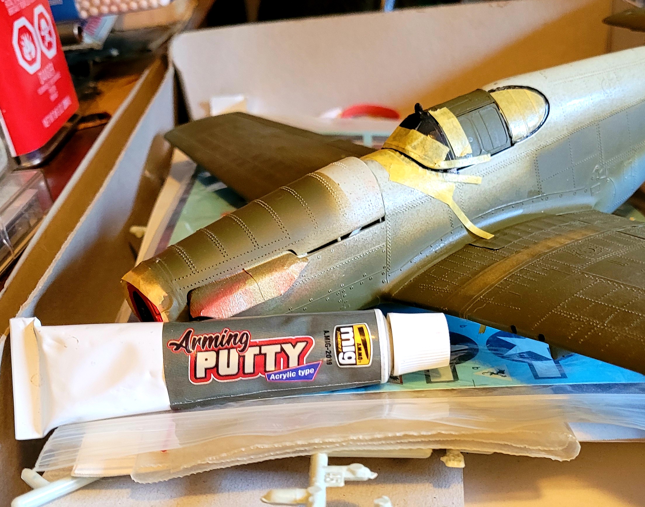

Now, about the model. The hold up was the canopy. This classic Revell kit is notorious for the lousy fit of the 6-part canopy.
1. Kiss my wonderful Sweetie.
2. Turn on the good music.
3. Fix a drinkie.
4. Engage the Gears of Creativity.
5. Get off my ass and figure out the fiddley canopy!

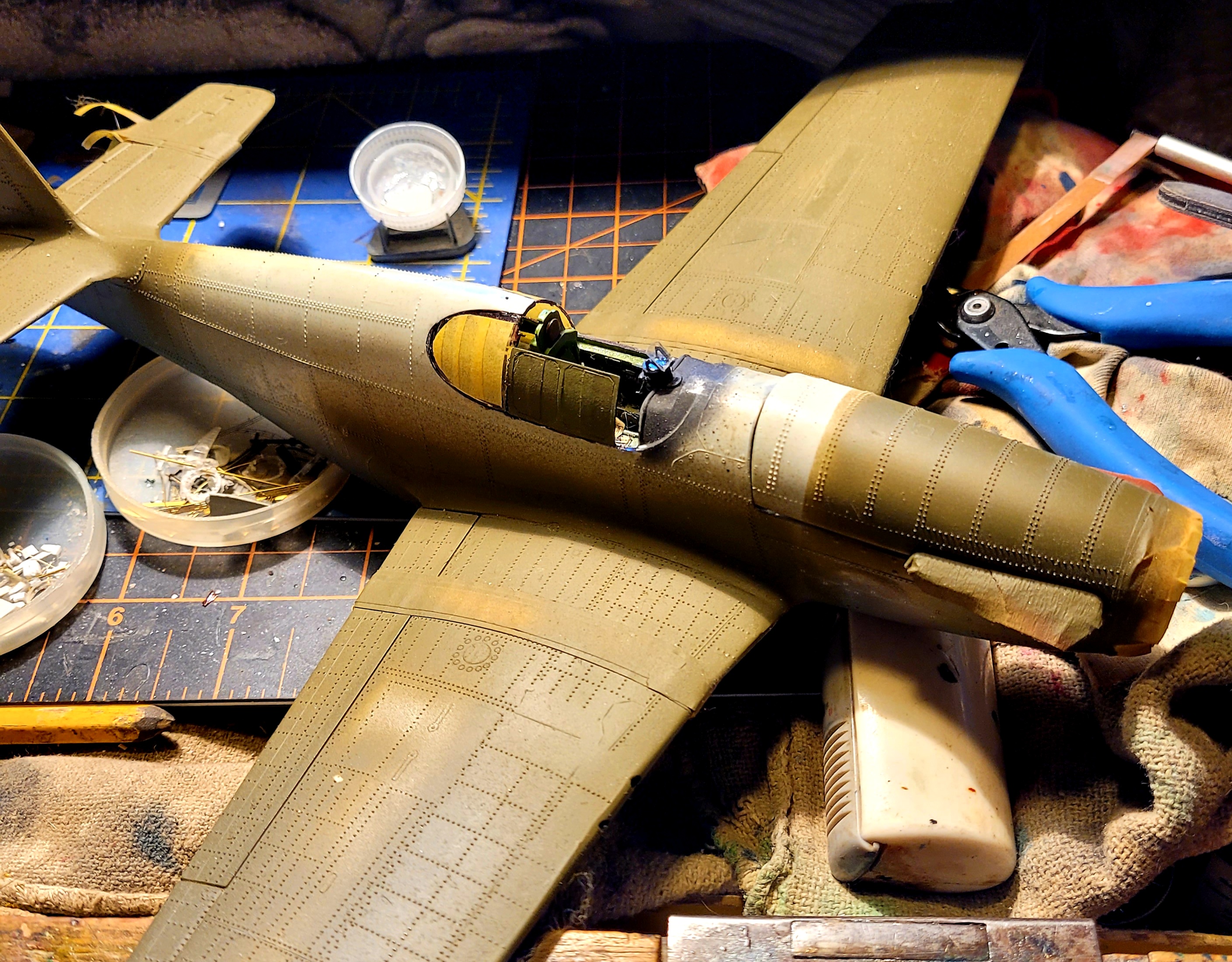

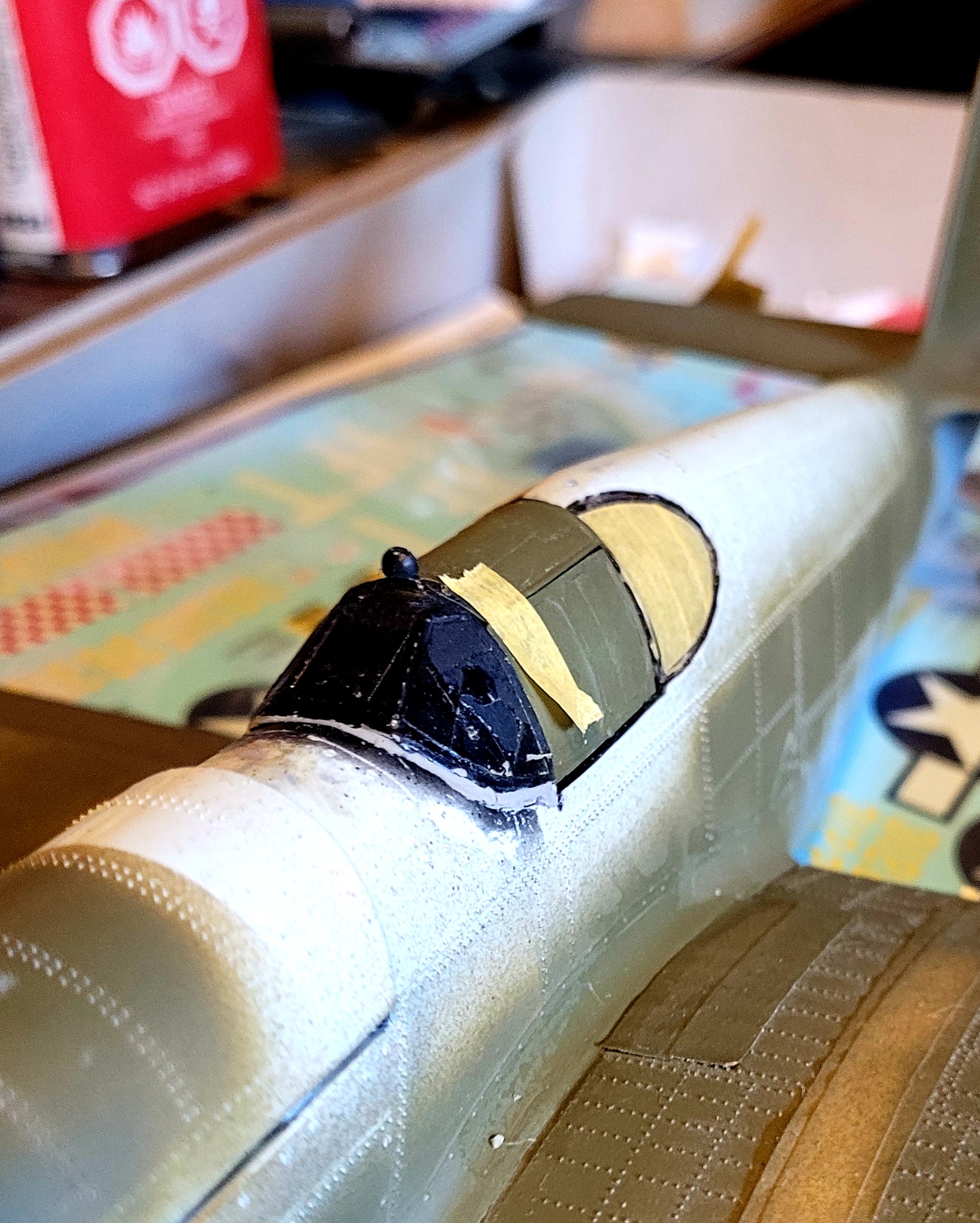

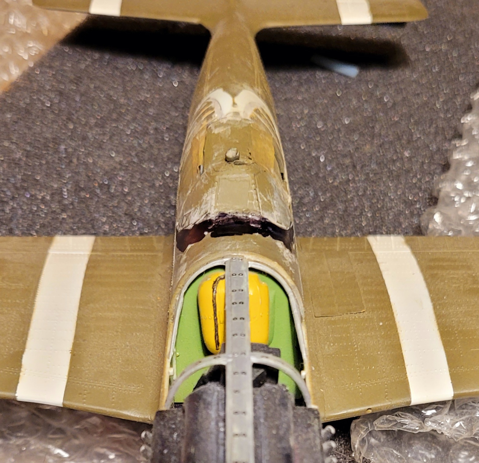

Here's what happened!

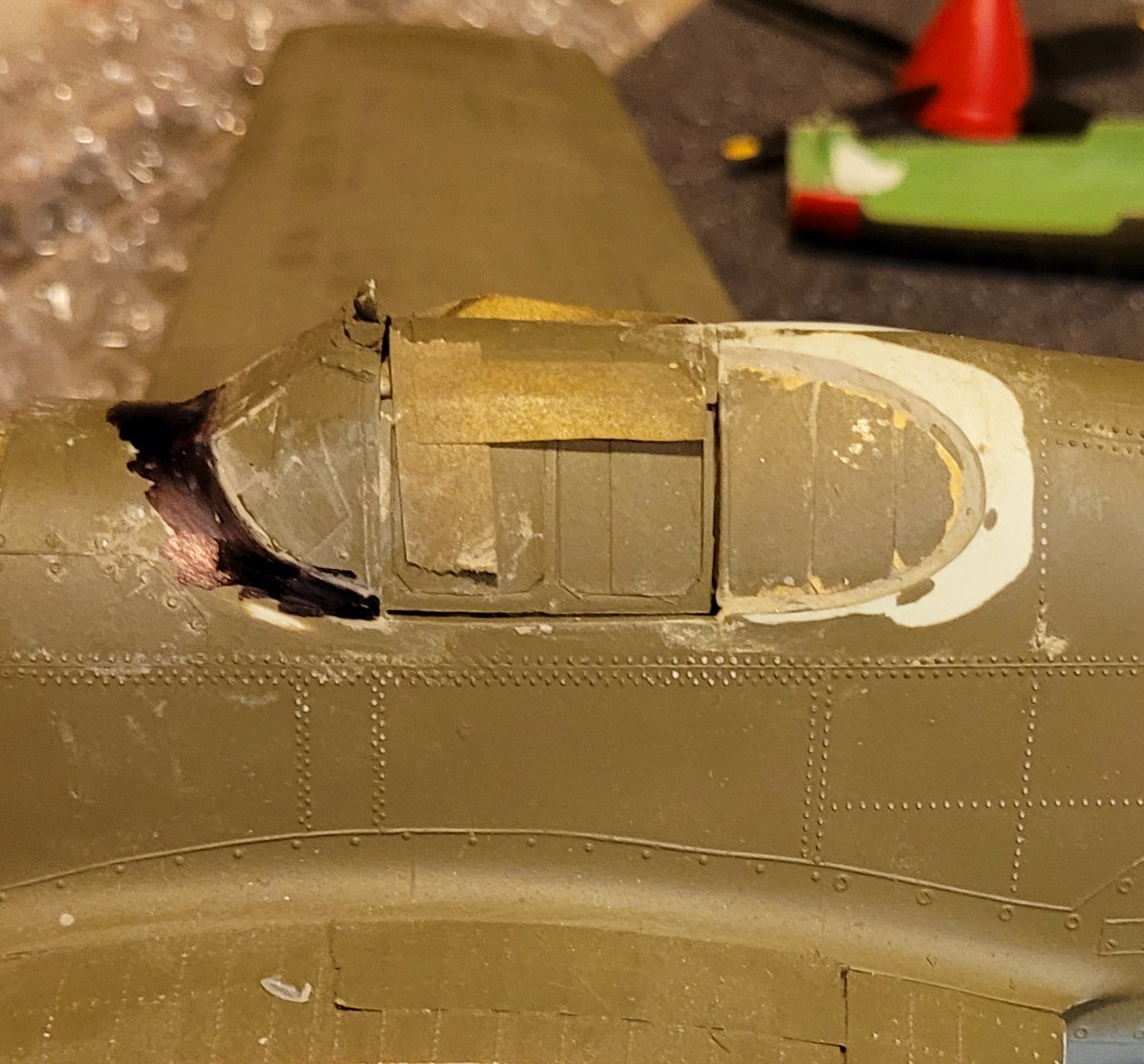

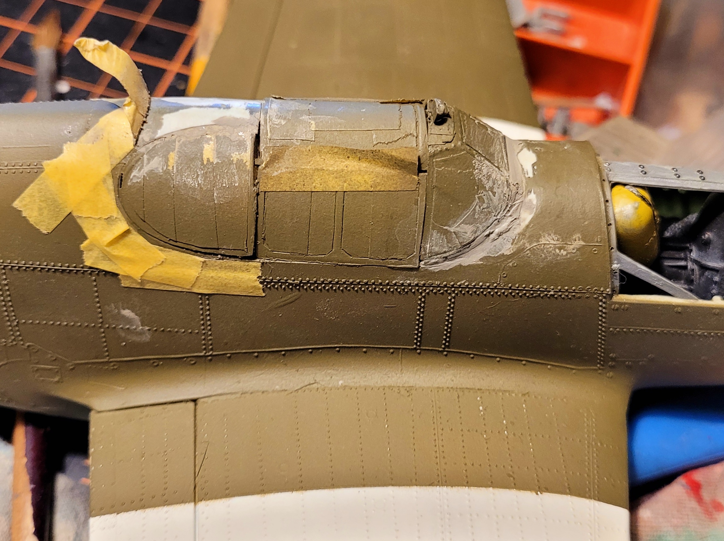

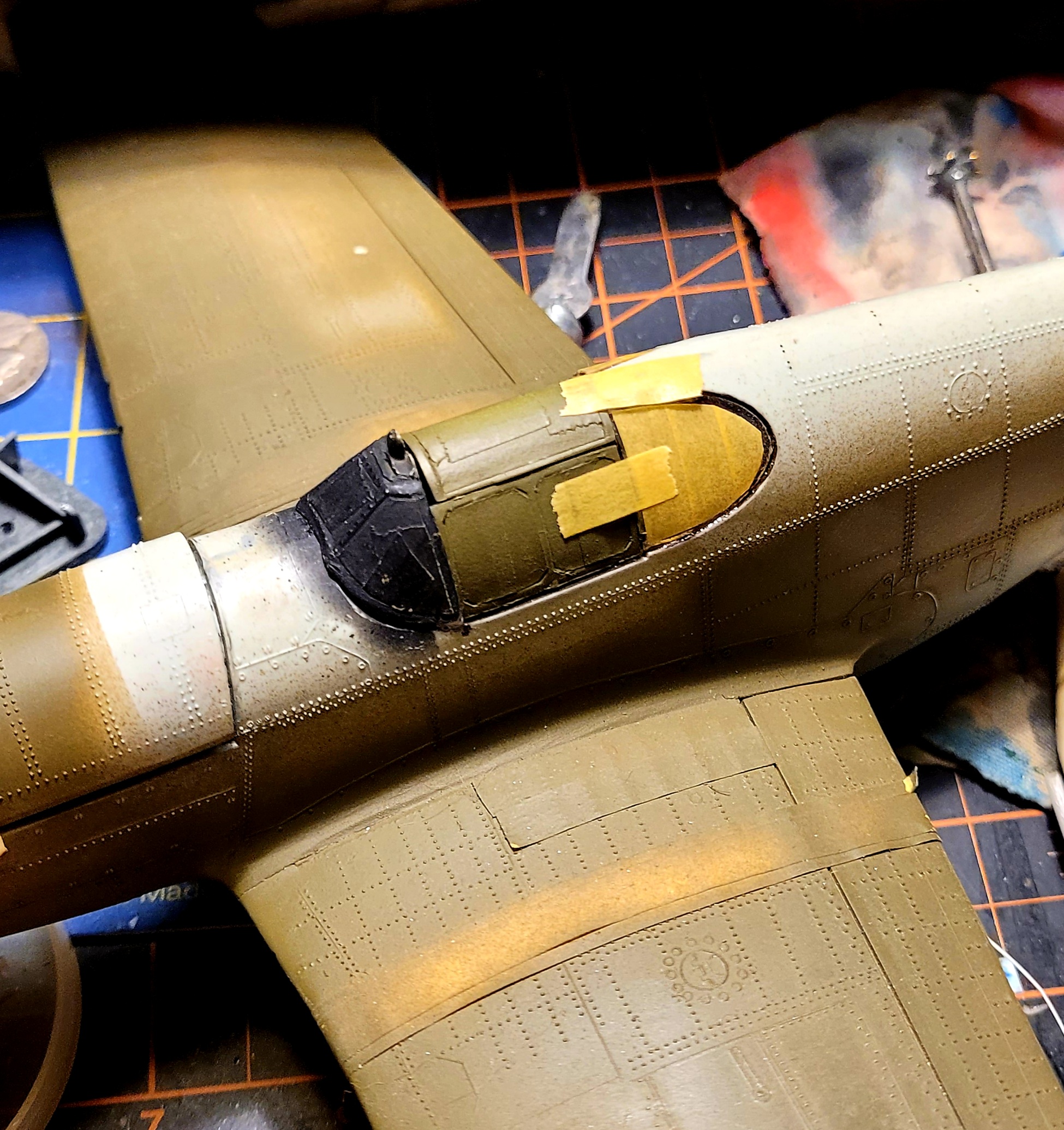

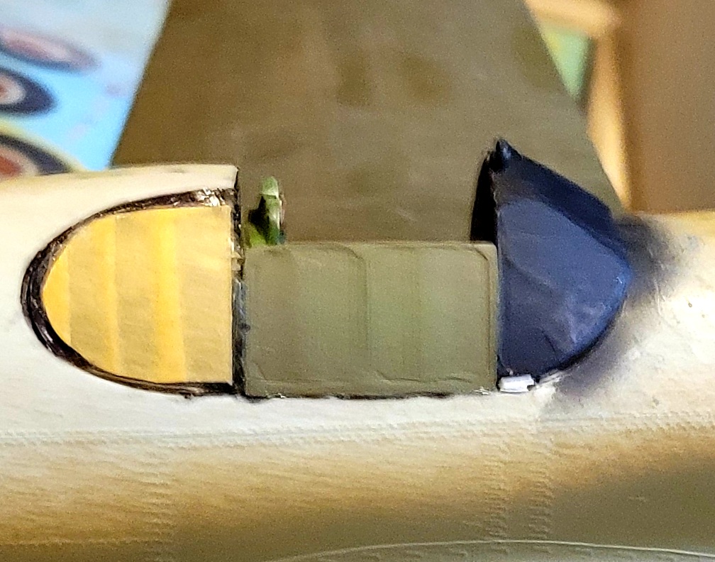

The starboard canopy winder is fixed. It doesn't hinge, so glue that part on.

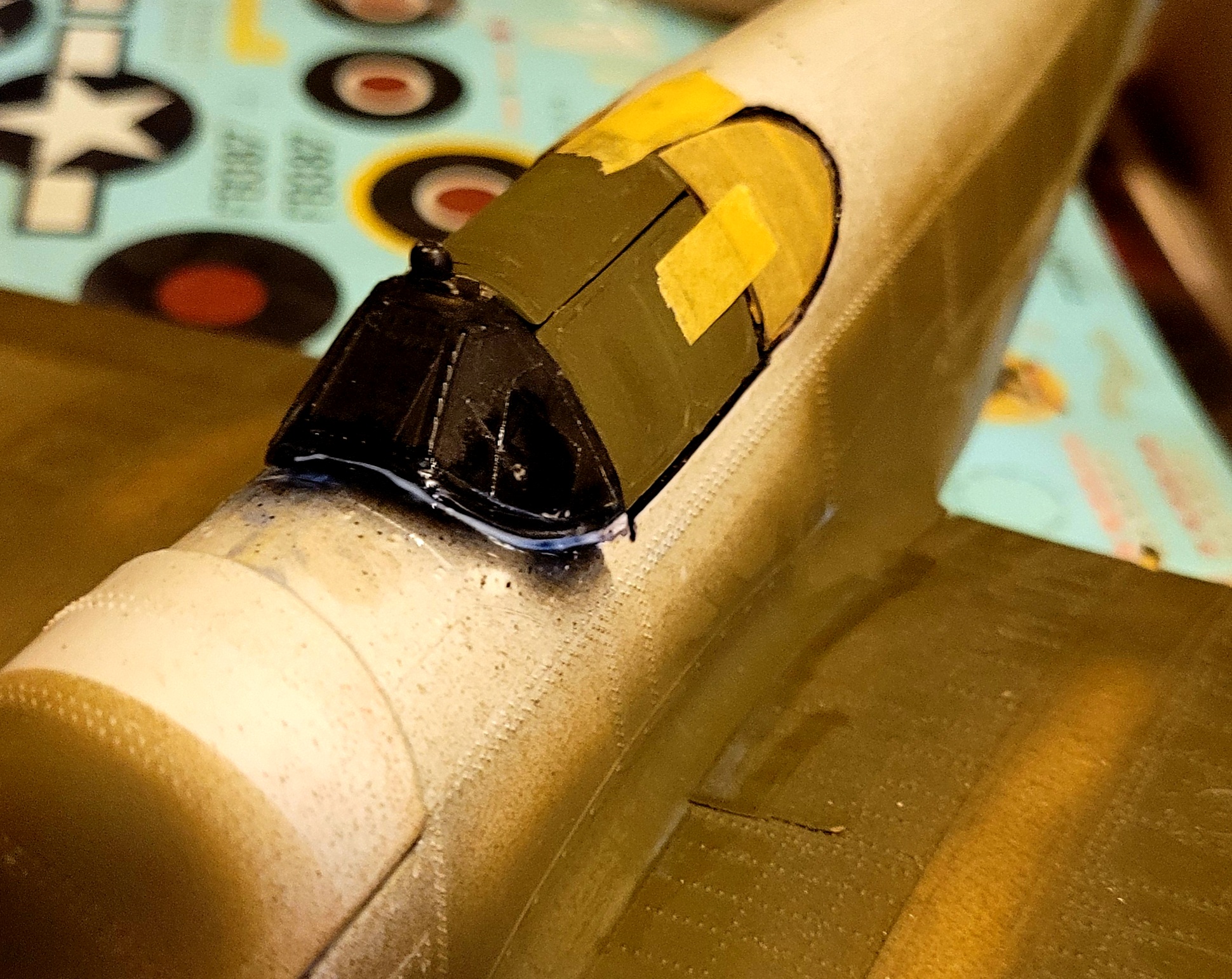

Test fit the windscreen to see how big the gap at the bottom corners are and add bits of plastic strip until it makes proper contact on BOTH sides of the cockpit. Trim/sand to fit!
Tamiya tape to hold the hinged panels in place for proper (?!?) alignment. Since these 2 panels will be displayed open, a perfect fit is NOT necessary.

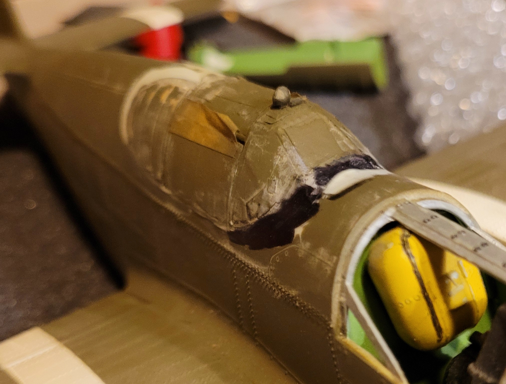

Kenny's Gator Glue and a damp cotton bud to smooth the acrylic glue into the huge gap after it set up a little bit.
Since we're trying new techniques today, I used MiG acrylic putty for the first time. Tape off the joint, smooth on the new putty, and go over it with a cotton bud dampened with Windex to remove any excess. Remove the tape and clean up the putty with another cotton bud and Windex. (TIP! A little MiG acrylic putty goes a LONG way! Thankfully clean-up is a breeze!)
MiG acrylic putty is easy to apply, tools very nicely and cleans up nicely. I wonder about how it will adhere. "You can't rush the chemicals!" I know. I left it alone to cure. I will probably spray a coat of Future over it just to be sure.

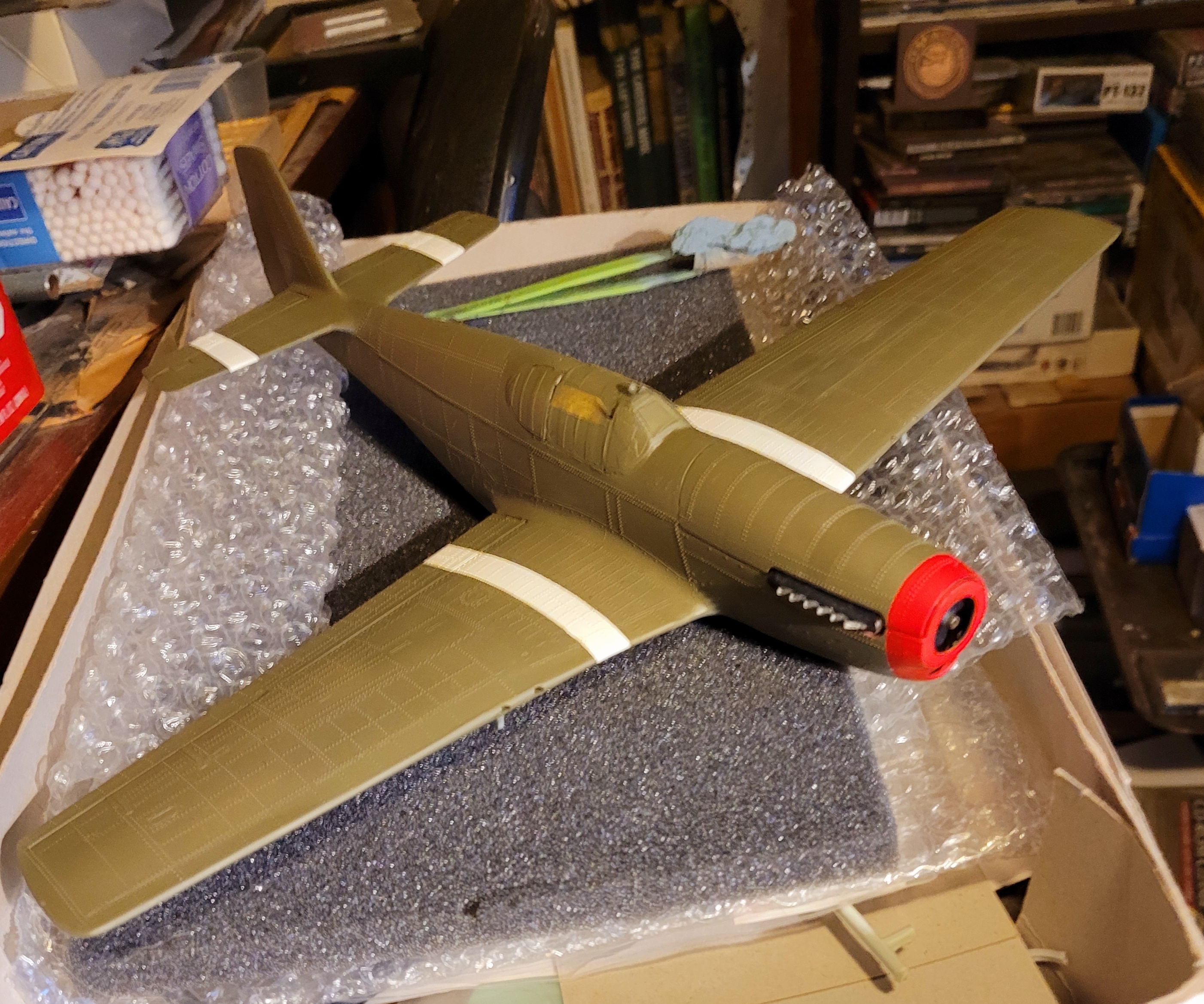

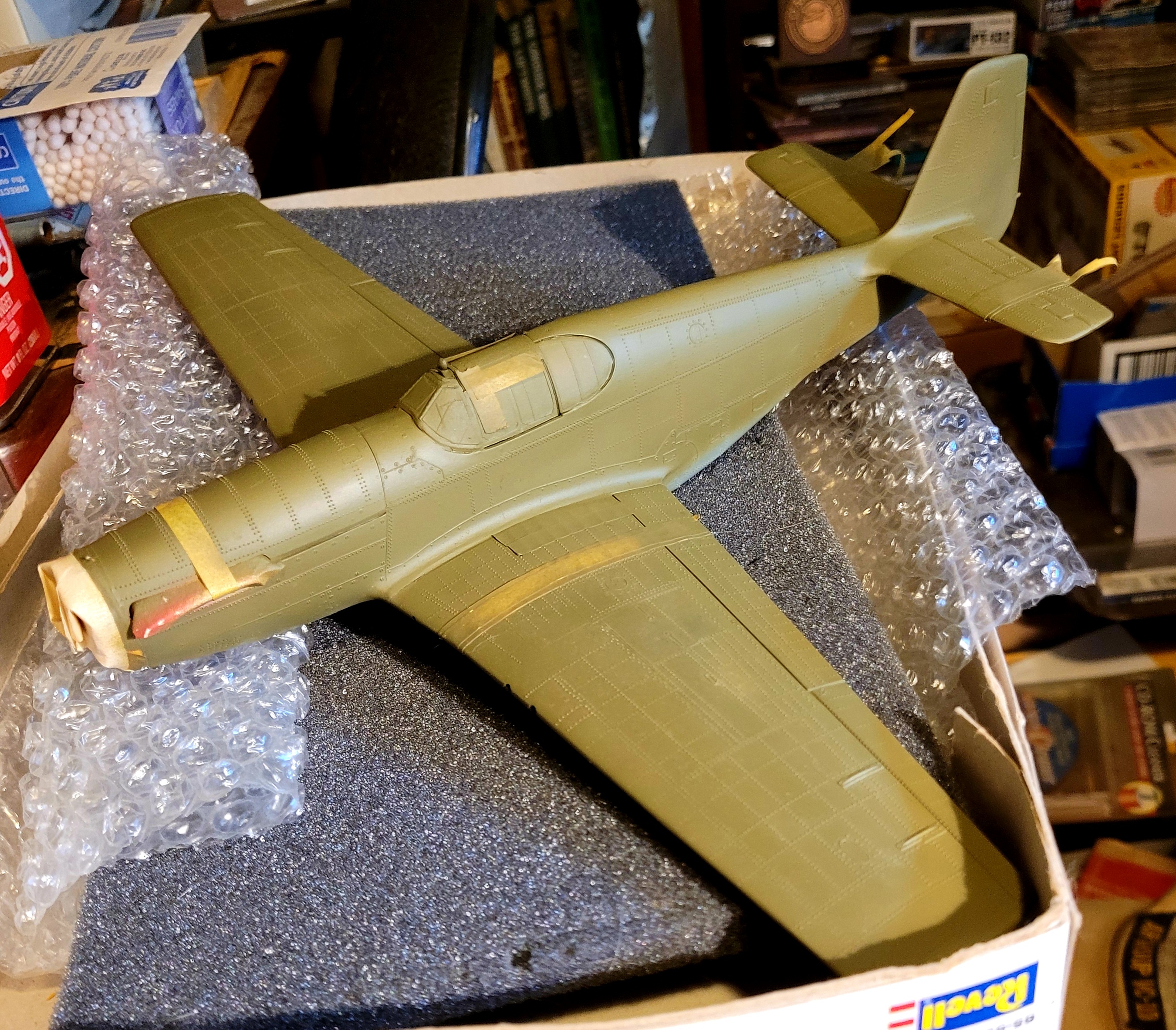

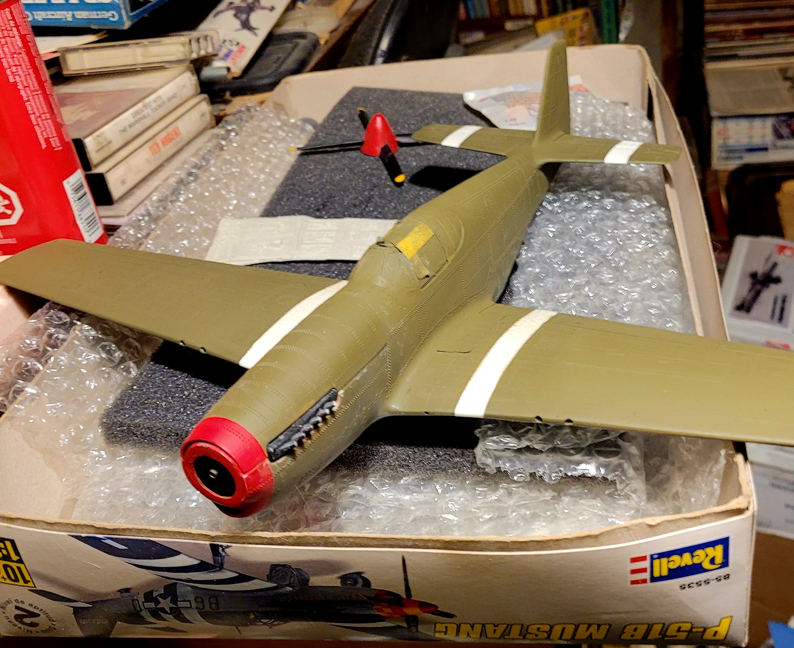

Now that the major model obstacle is overcome, I expect my Dad's Mustang to proceed at a more regular, glacial pace, just like all my other builds do. The subject is Don Gentile's 4th Fighter Group P-51B, named "Shangri La". Ironic, that.
