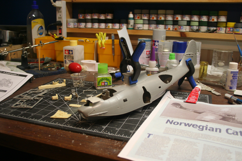

So, time is running out on this and I don't feel I'll be able to complete this build as I planned.
Would anyone care if I did an about face and build a different version with a similar kit?
was thinking a Golden Pelican from VP-44 and try to focus on the exterior.

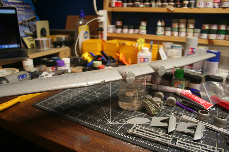

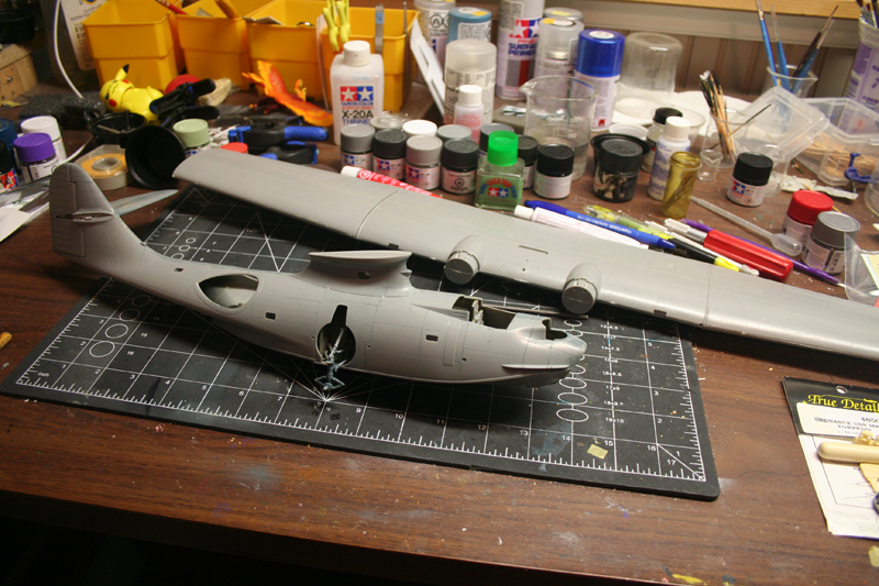

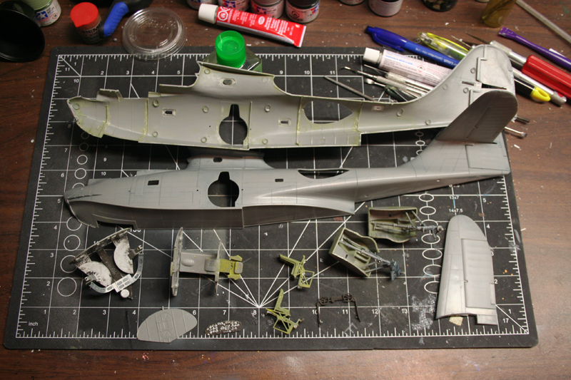

Someone was selling a PBY at my last club meeting. The hull and upper wing were assembled but it had a terrible paint job so I broke it down again and gave it an oven cleaner treatment.
This is after a few blasts of cleaner to remove the paint
and then I went at it with a shark knife and some brute force!

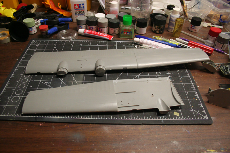

Could only get the 5 piece wing down to 2 parts without causing serious damage
But the fuselage and interior came apart pretty well!
Looking great to me so far. I don't mind at all. Bring it on.
At least you got something going for this. I didn't even get to start anything. I was so hoping to have that banner too. Oh well. Life goes on.

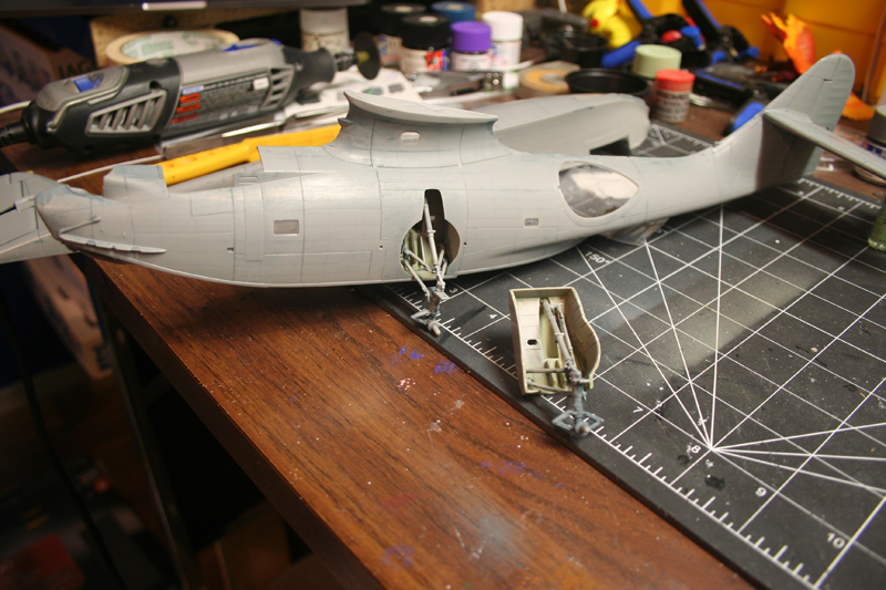

Got the main wing back together. Had to fix an alignment issue.

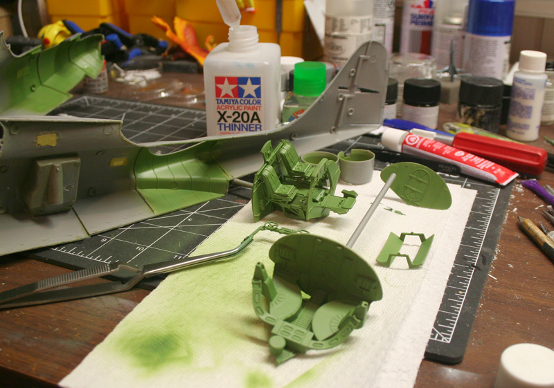

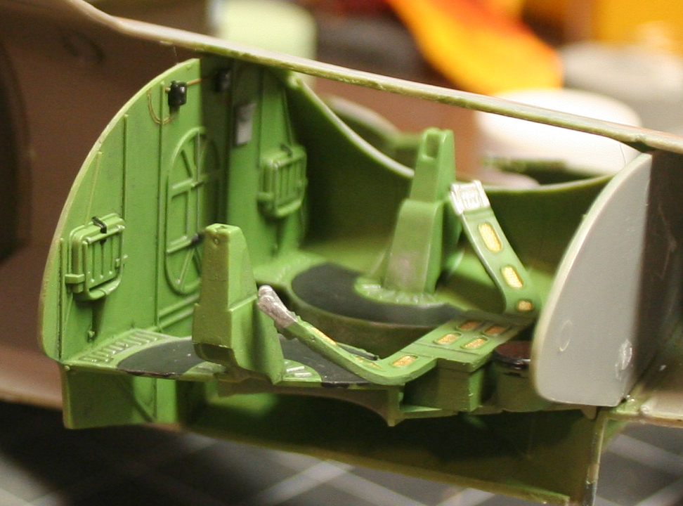

Most of the fuselage came apart fairly easy. Must have been the glue used by the previous owner.

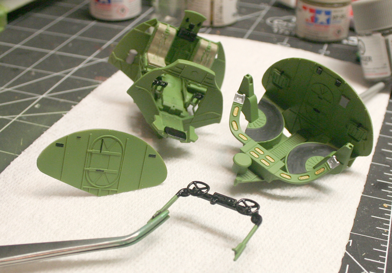

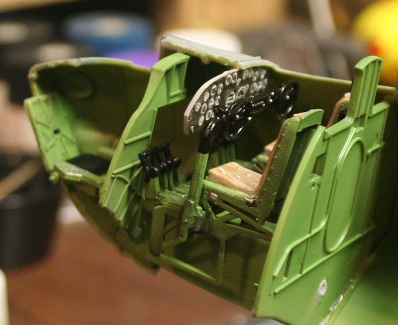

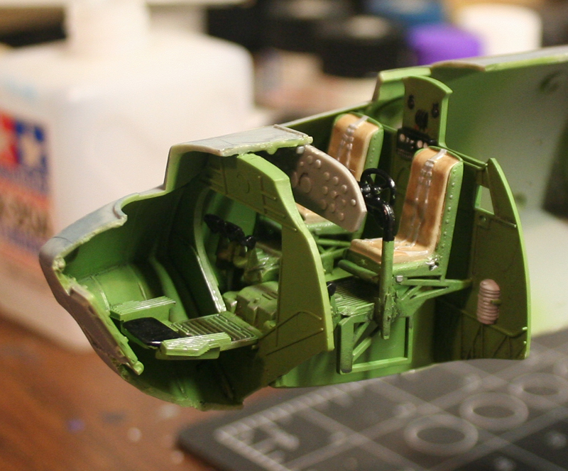

Repainted the interior a more suitable green
A few close ups.
