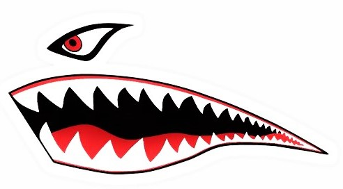

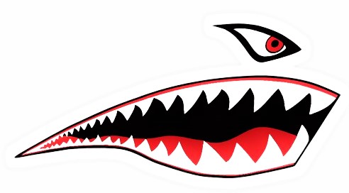

Copy the decal and make masks with the vinyl cutter you should have bought already, Paul. Or post a copy here and I'll do it for you. Maybe like this one. The curves around the front of the nose will be fun.
