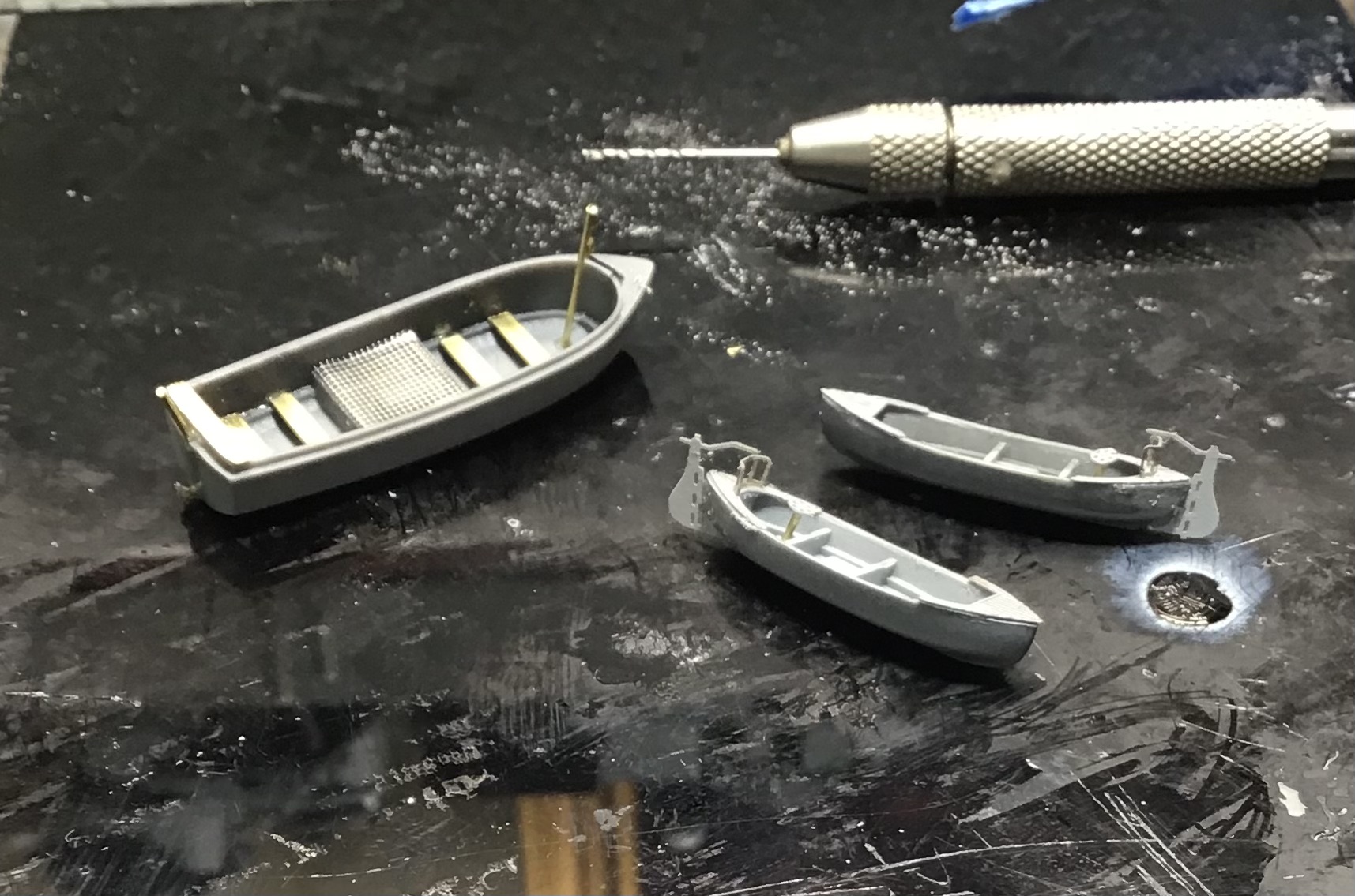

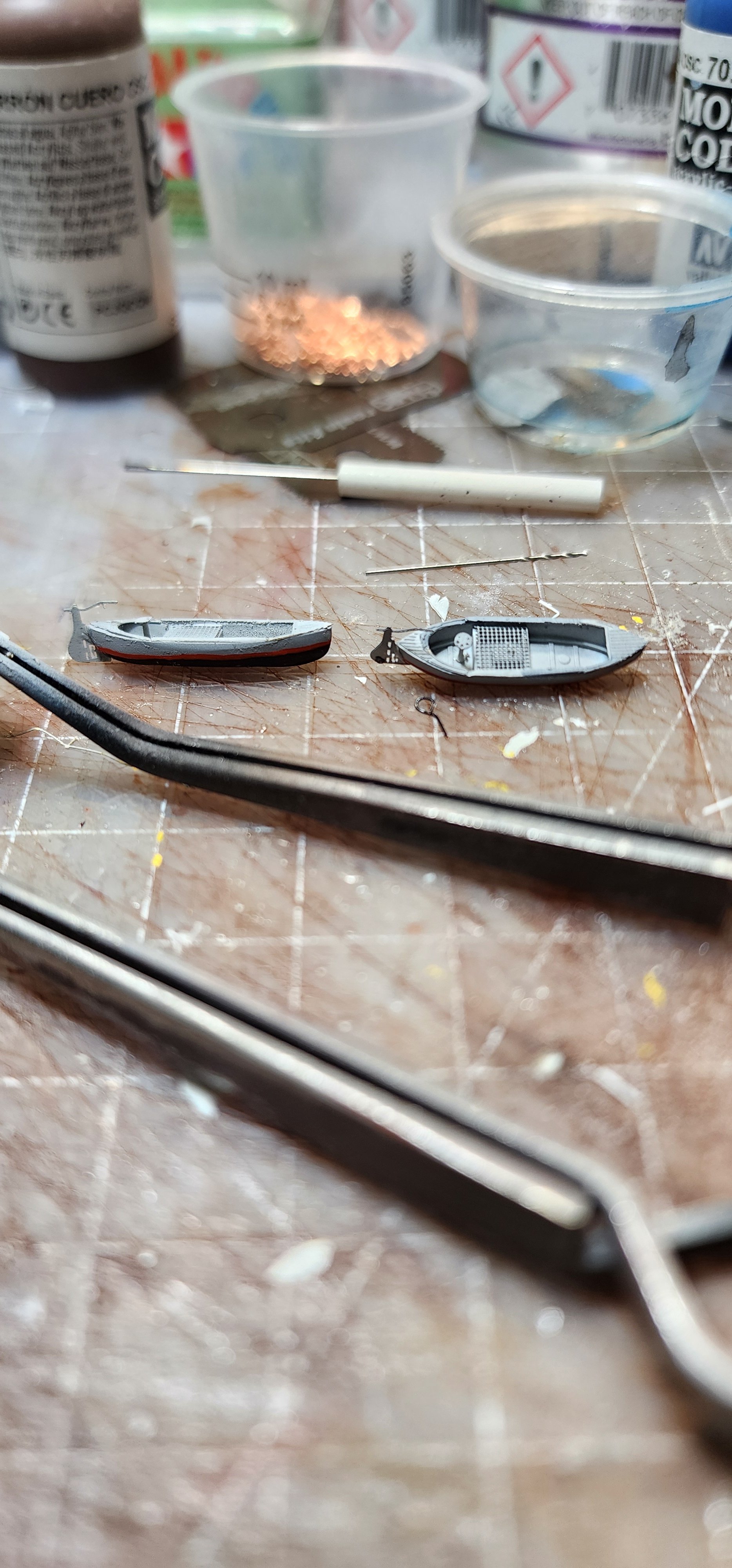

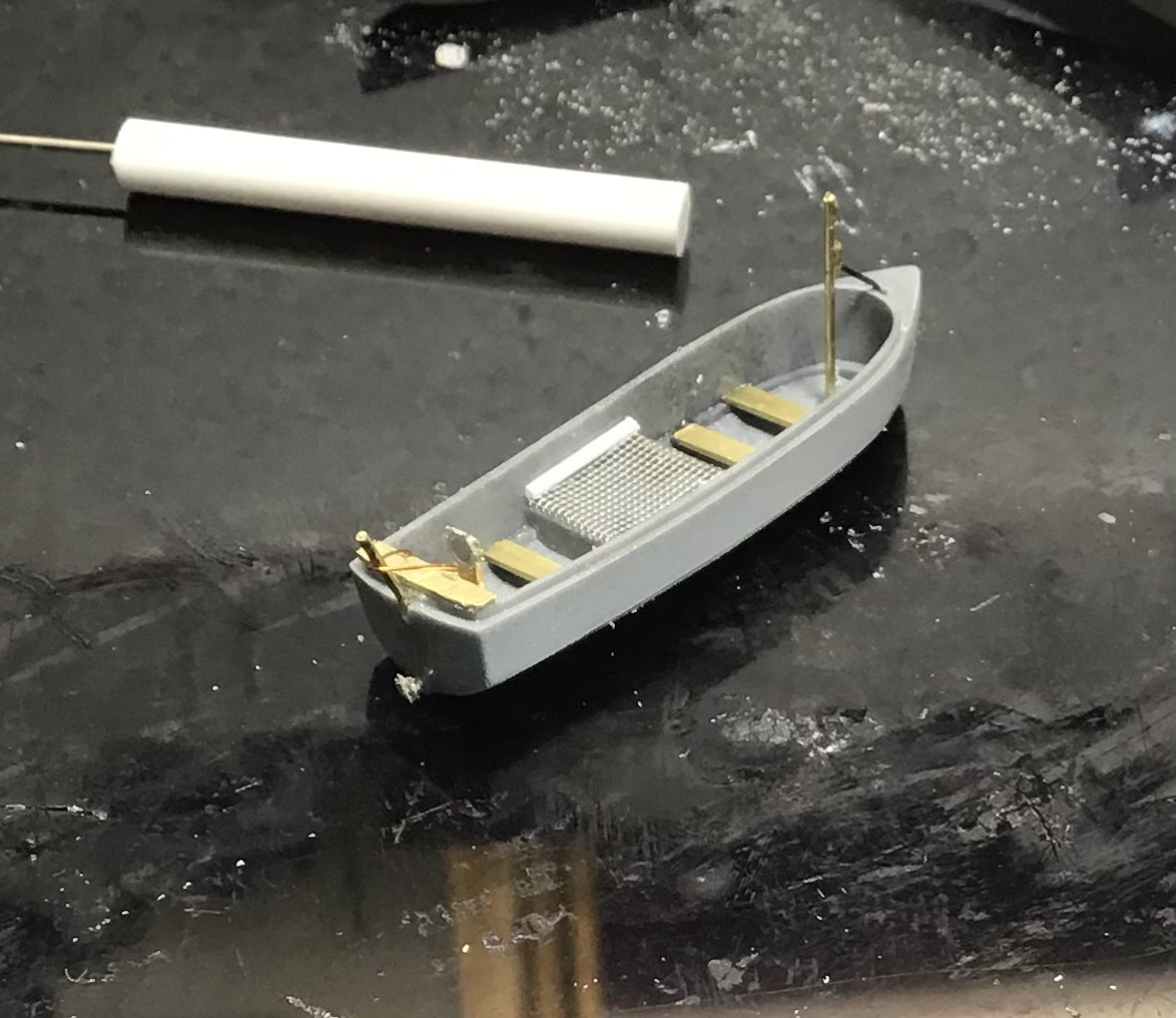

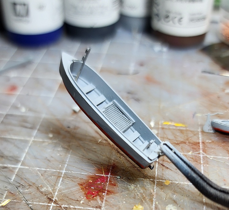

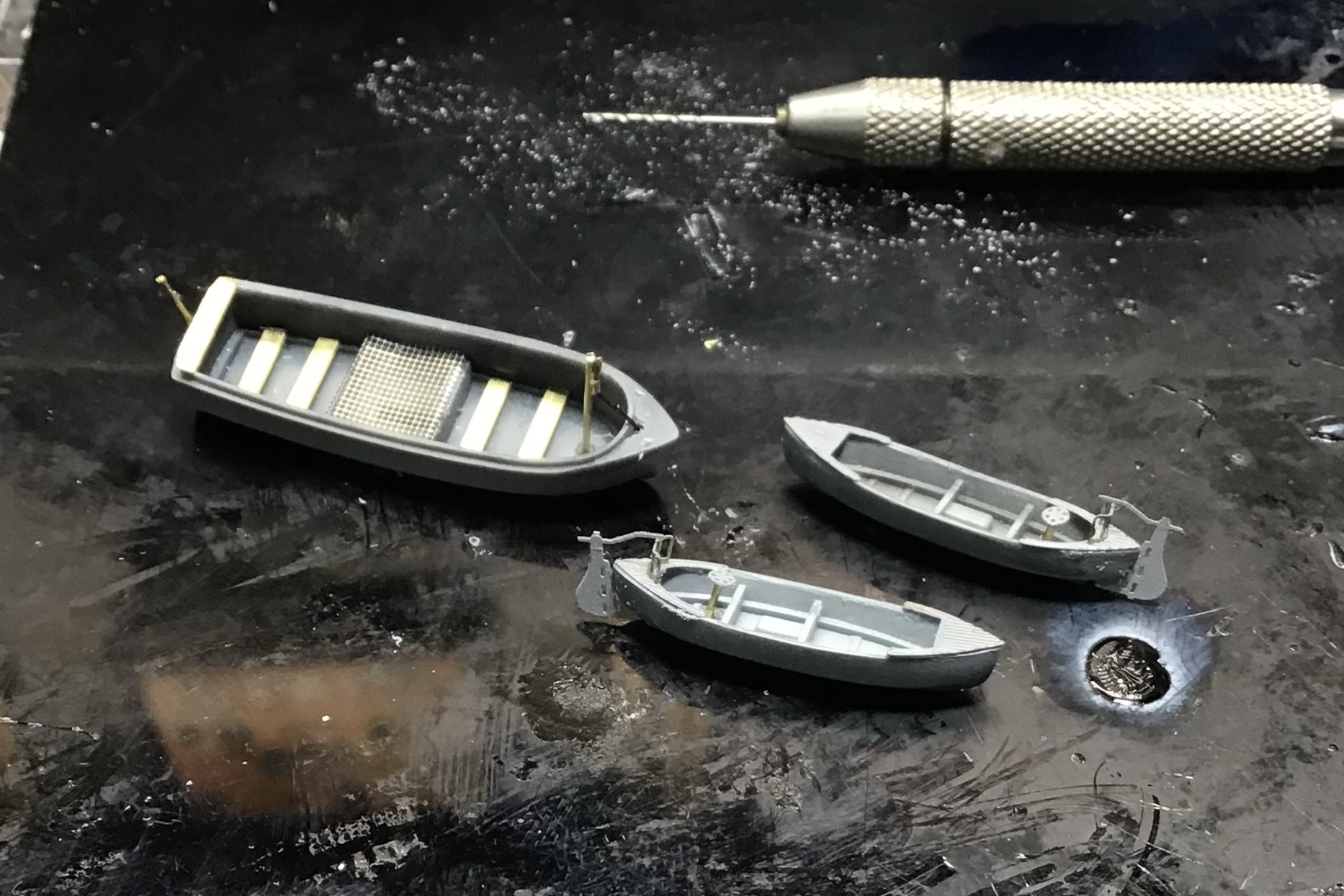

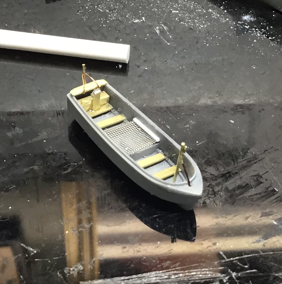

I tricked out a couple of little boats. Figuring out the wording to find a reference for the launch boat took some time! It kept wanting to show me Navy ships being launched! I made the parts for the launch boat from scratch and the cutters parts are AM PE. I made a teeny propeller and you can almost see it. That is a .5mm bit in the mini pin vise. I will probably put a small piece of square brass rod along the edge of the motor cover so it looks more flat.
Looking really nice Greg.
When it comes to CA, I usually run back over my CA’d parts with some debonder on a micro-brush to clean up any excess glue that isn’t bonding the parts together. This helps take away the pressure of trying not to get too much CA all over.
Maybe that will help?
It was the boats that bamfusaled my Graf Spee build years ago. Really nice touch Greg, would the last one have a wheel or tiller?
Thanks! The pictures show a wheel on a little pedestal thimg sort of like I tried to make. The little boats have a tiller.

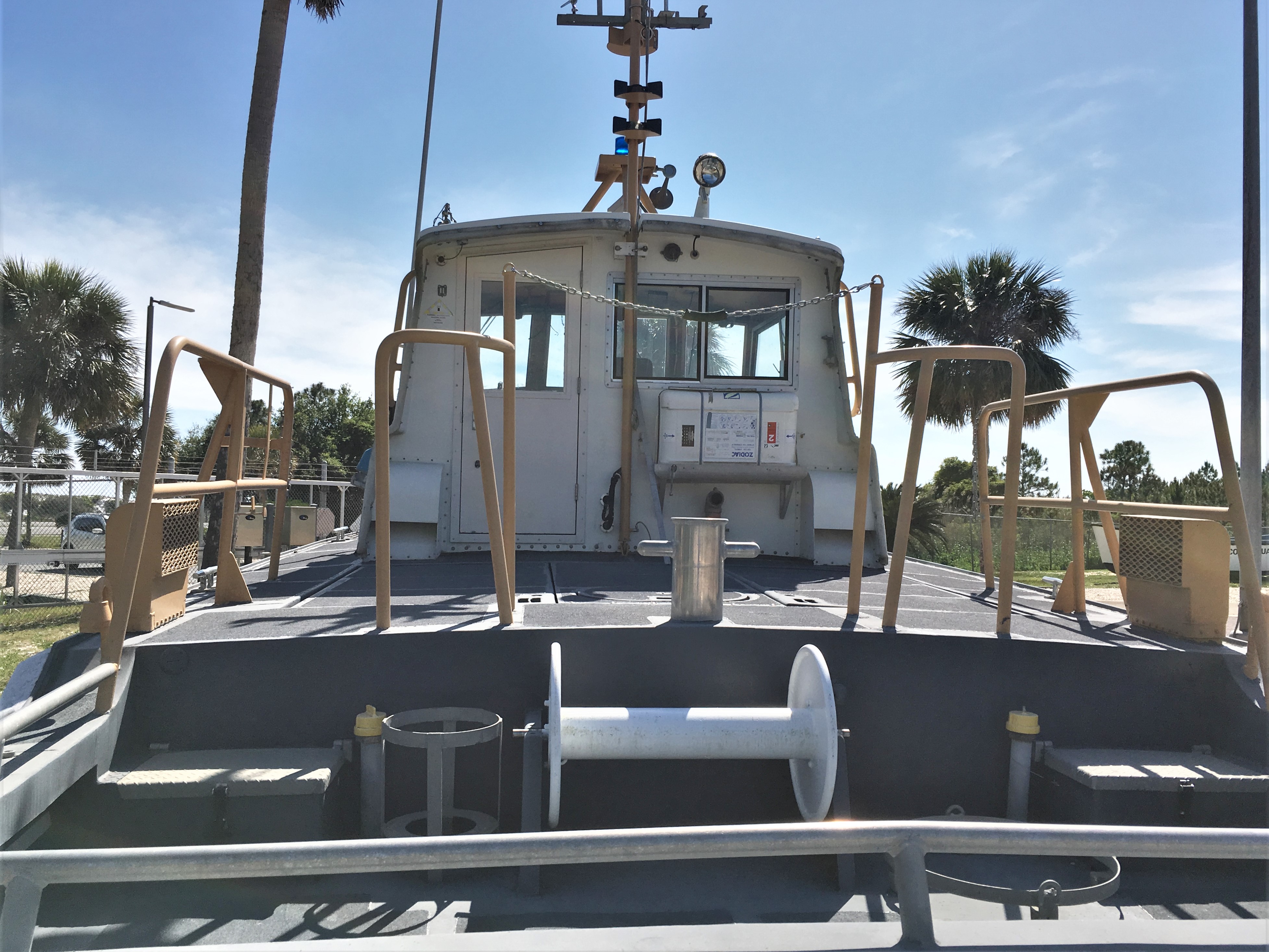

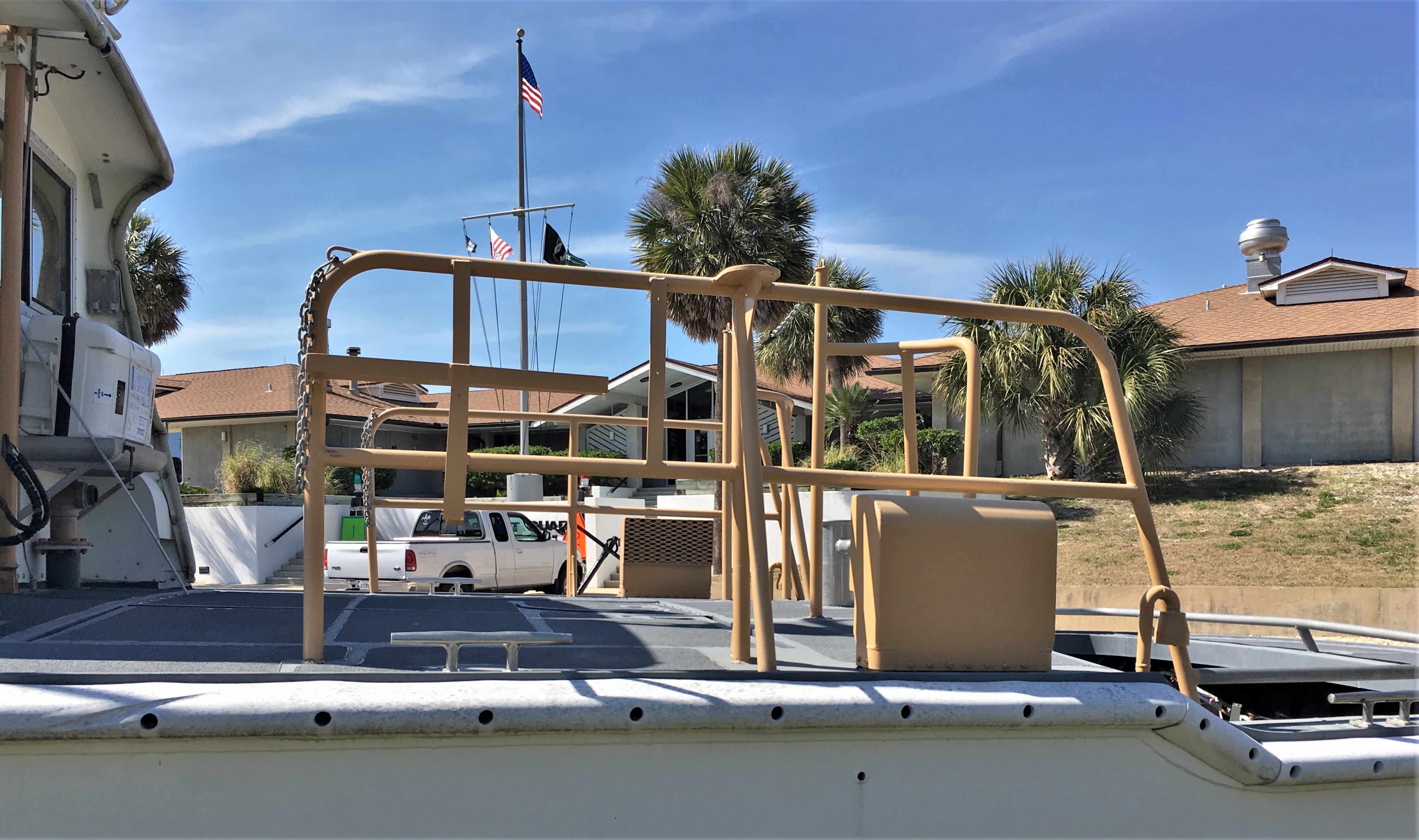

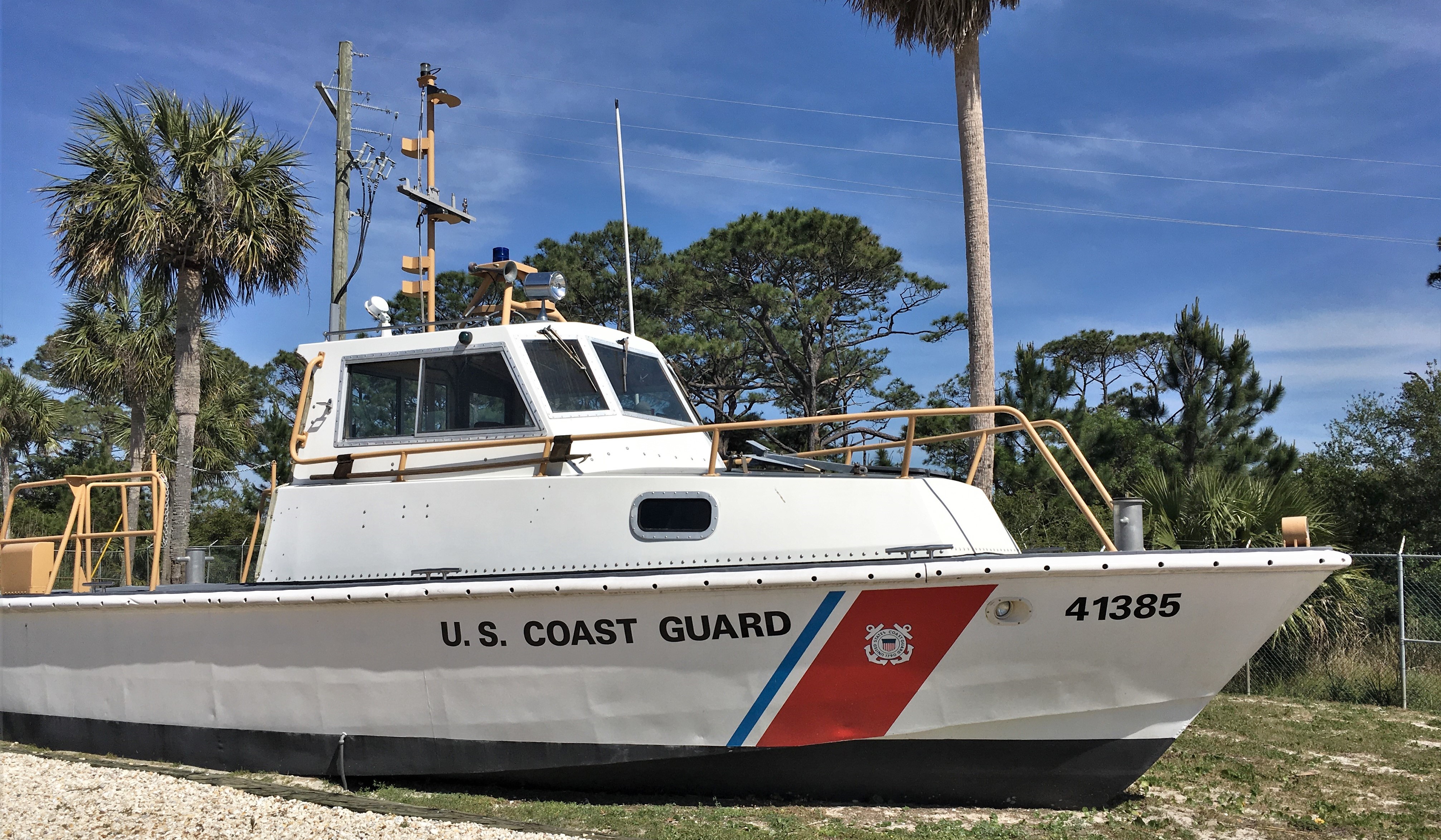

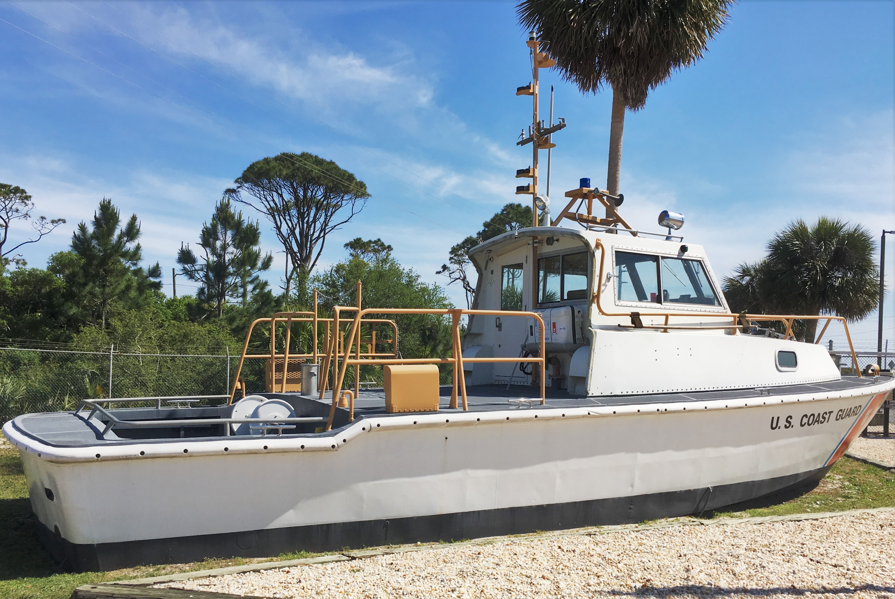

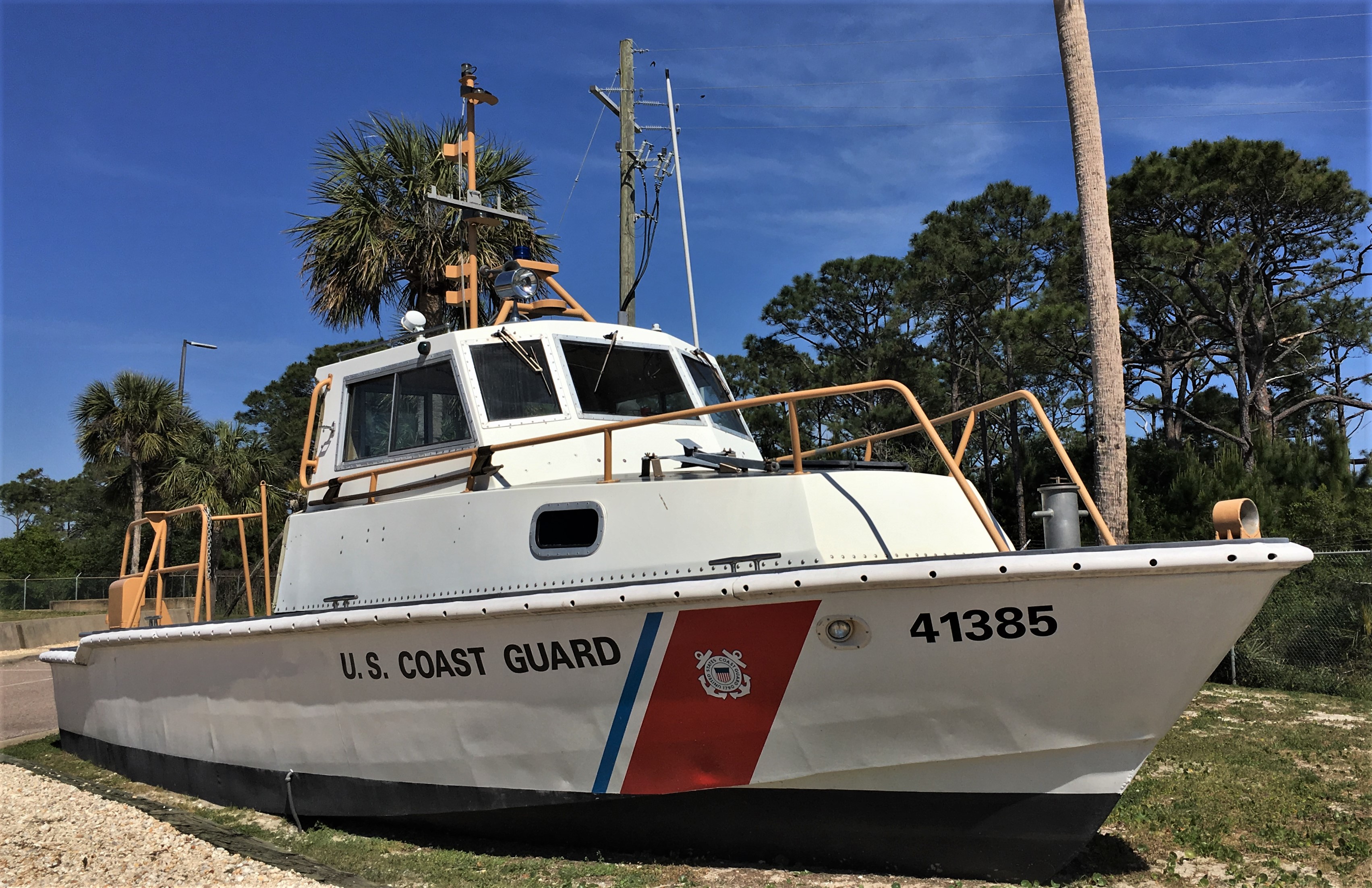

On a similar subject, @Rhino , what is this called so I can find reference photos?

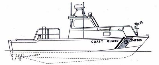

That is my early Cummins-powered 1/350 USCG 41-foot utility boat. I sent it for you to have fun with.
Reference pictures. :hmm:

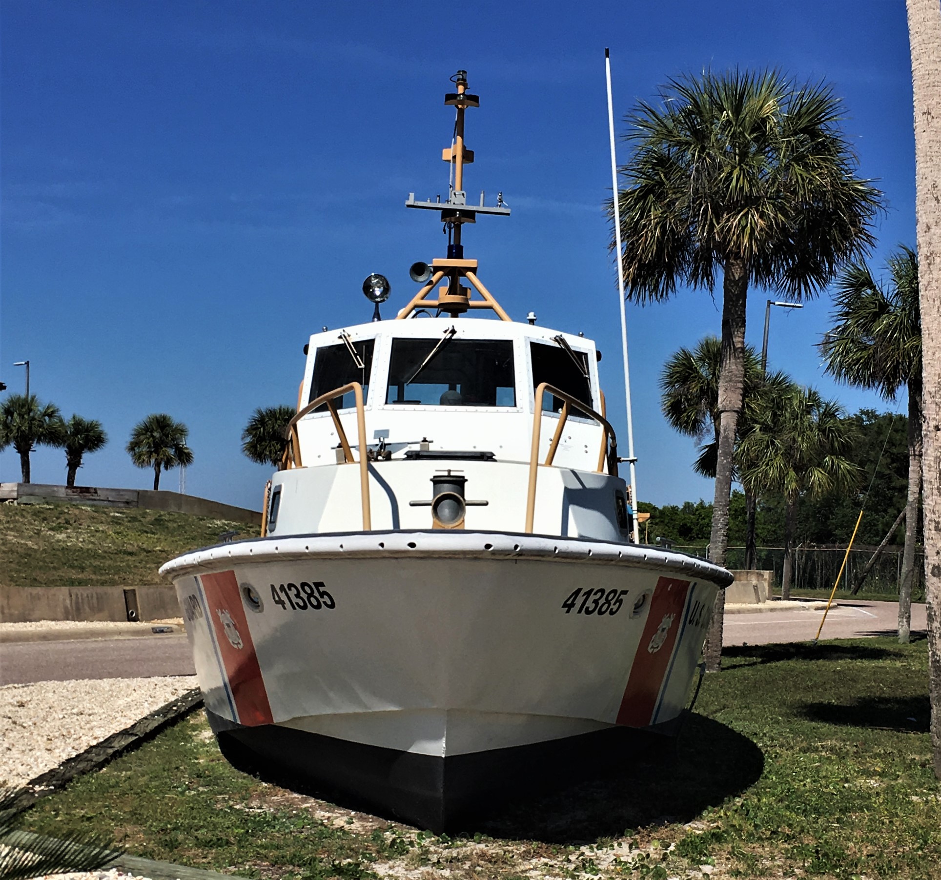

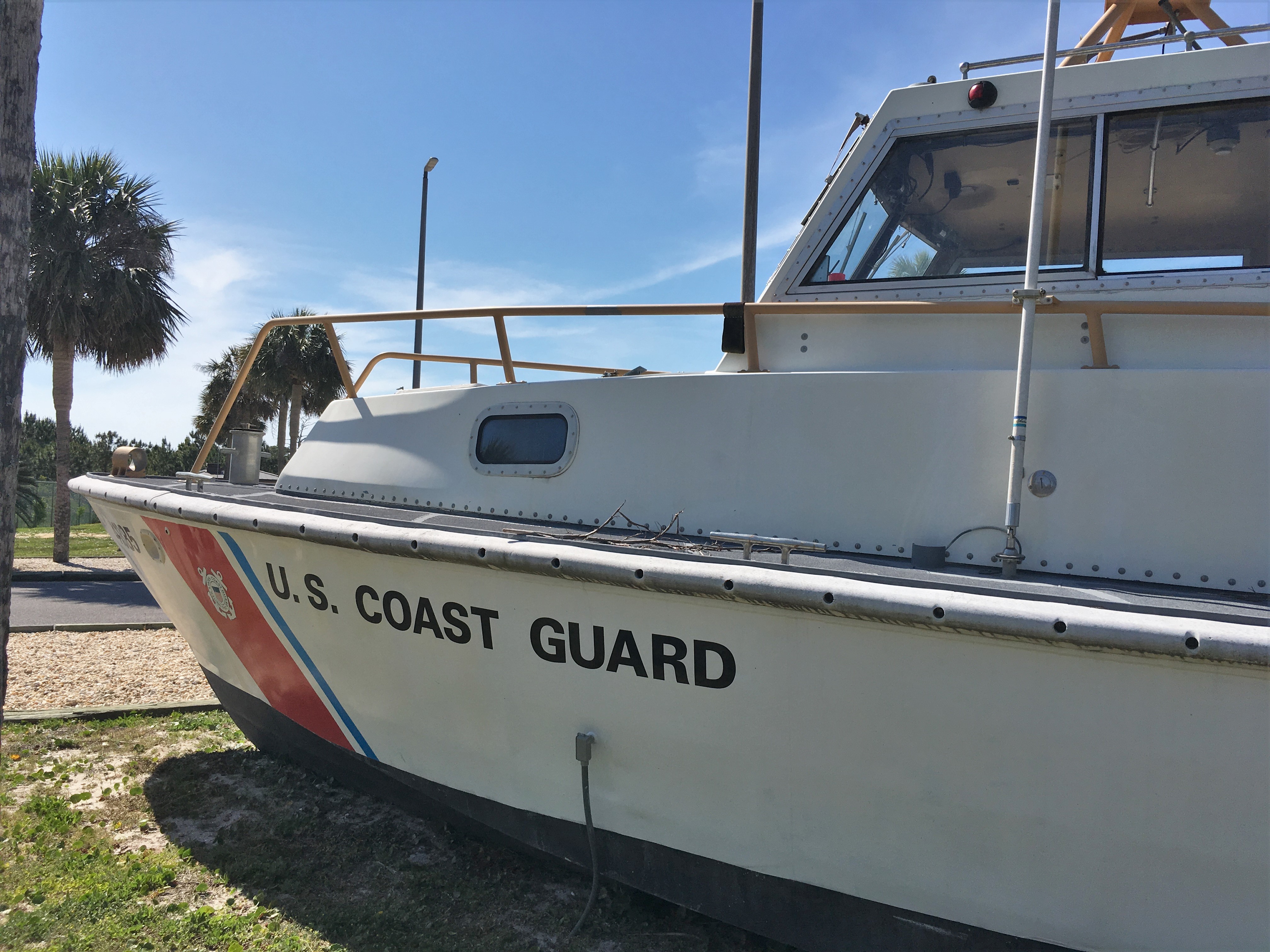

3680698.jpgIMG_1338.JPGIMG_1339.JPGIMG_1340.JPGIMG_1341.JPGIMG_1342.JPGIMG_1343.JPGIMG_1344.JPG
This late Caterpillar-powered 41 UTB is the gate guardian at USCG Station Destin Island, Florida.

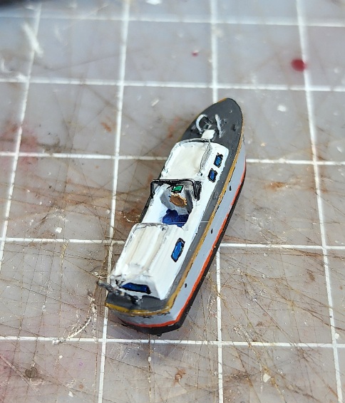

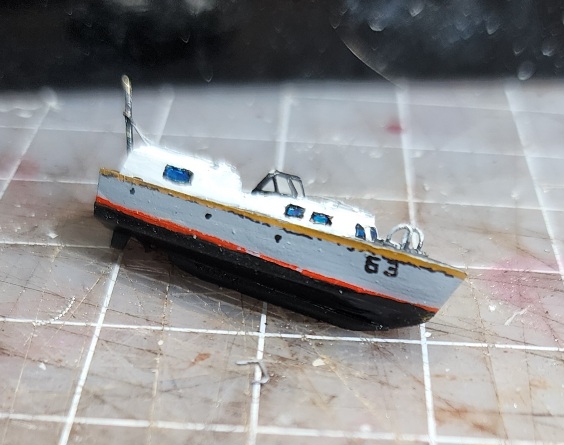

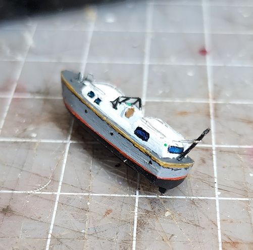

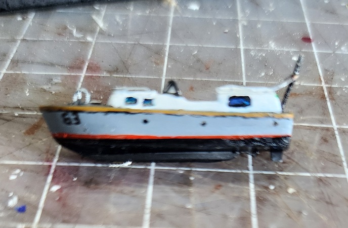

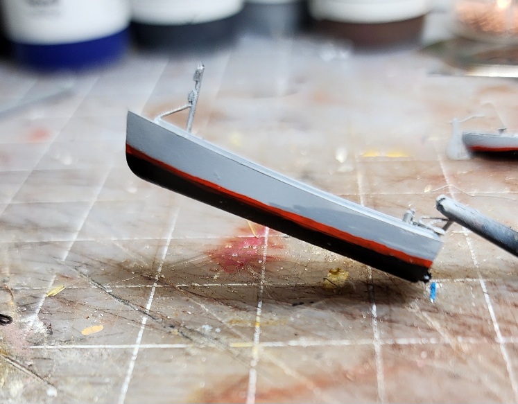

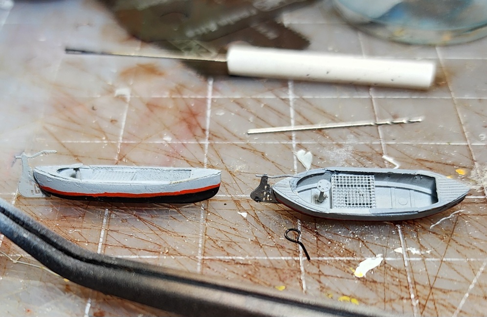

I have finished the little boats I think. I really like the 40' personnel boat.

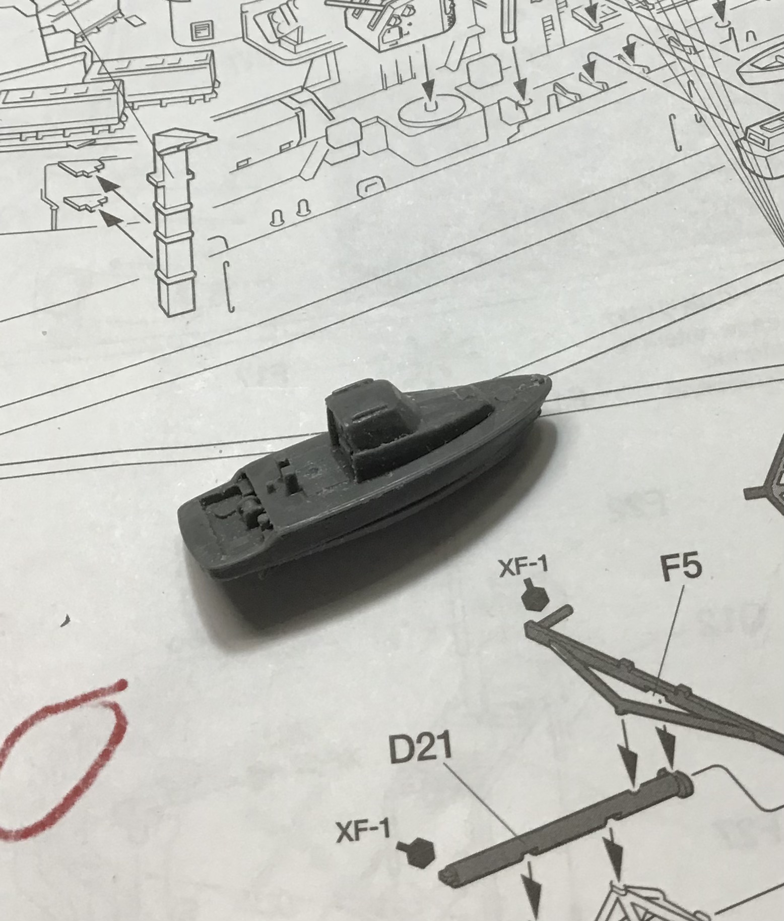

The utility boat turned out OK...
And the teeny whale boats are also OK. Not much you can do to make gray look good.

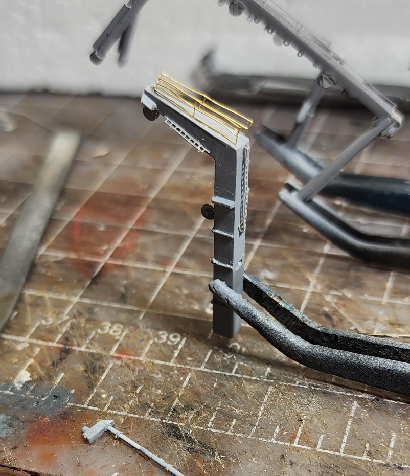

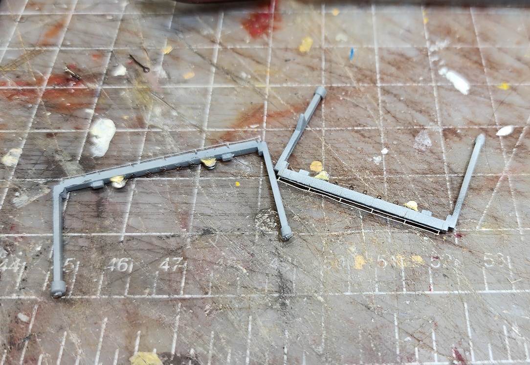

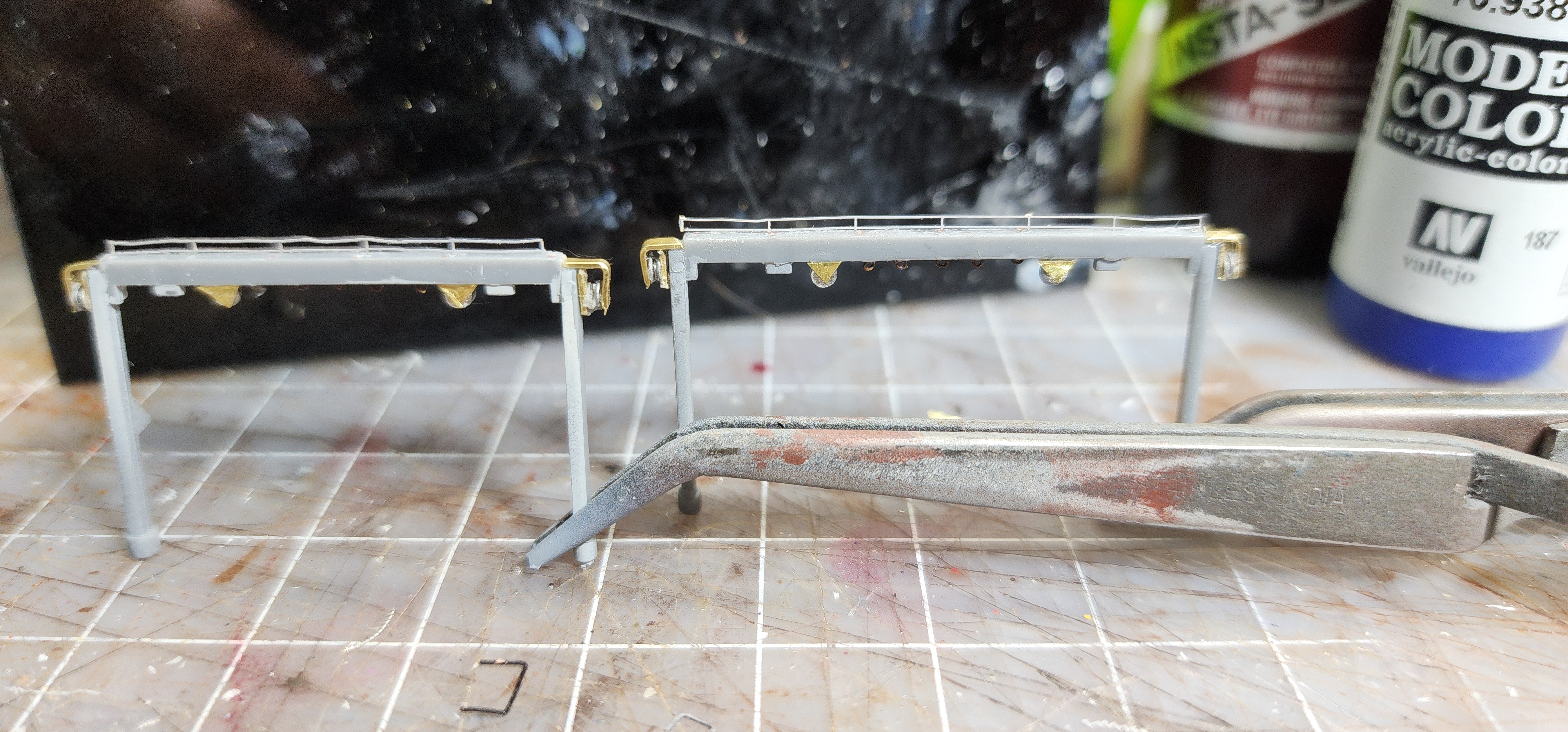

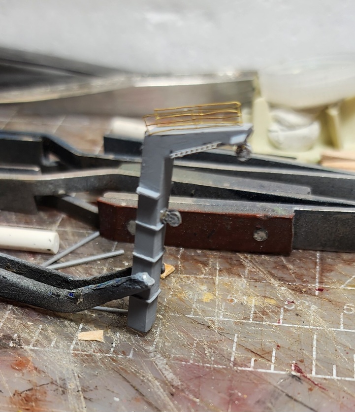

The davits are in progress. I may add hydraulic pistons at the sides if I find small enough parts. The "pulleys" are made from .01" metal sheet punched with Micro Mark's mini punch set. (Good investment if you don't have one in you tool box). The triangle pieces are from very thin brass shim and but out with scissors. The side pulley arms are made from .017 x .6" brass strip, bent with photoetch pliers.
