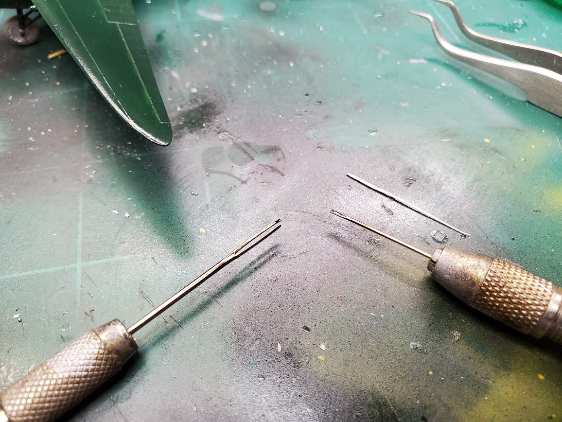

Did you cut the eye of the needle open? You want it to look like a mini 2 prong cocktail fork. Have two of them, one for CA, one for accelerator.. I tried using the needle and flow trick but can't make anything flow.
Well, no. I misread about that part. I cut the eye of the needle OFF so it would go into an eraser. I will try the open needle eye trick. It can't make the glue dry but will be easier to get it where I want it to go.Did you cut the eye of the needle open? You want it to look like a mini 2 prong cocktail fork. Have two of them, one for CA, one for accelerator.

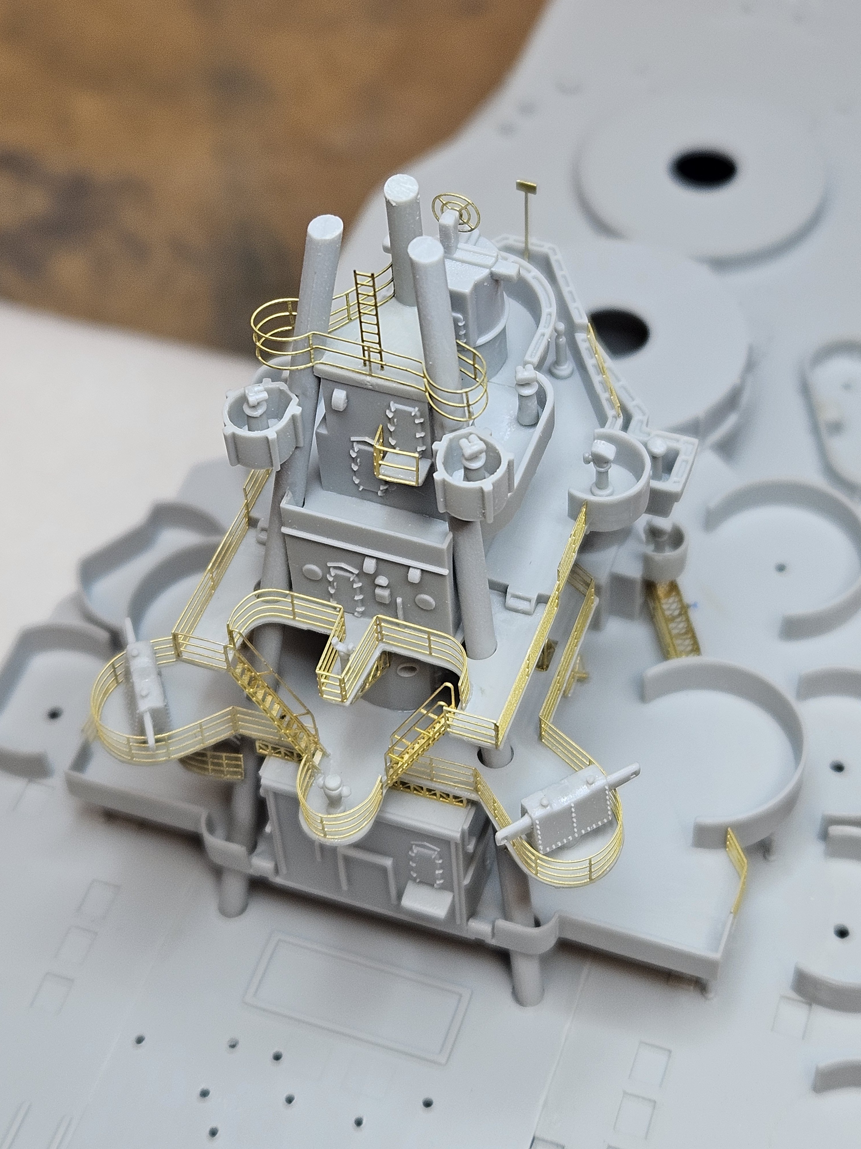

I don"t know. The sprayer doesn't work so I have been using a small paint brush or a small pin to put it where I want it. It is rarely soaked I think. Of course, you could be right, but I usually add the accelerant while holding the piece in place. Occassionally I put accelerant on one piece and glue on the other then join. It gives the same might work, might not result. I have tried many things. I know it is me not knowing what I am doing and pure operator error, I just can't seem to narrow down the error.It is common to use the straw end of the accelerant to put a drop or 2 on c/a glue on ship model railings. Almost nobody sprays it on rails/p/e.
I wonder if your c/a glue won't stick because it cures when it gets close to to the accelerant-soaked plastic?![]()

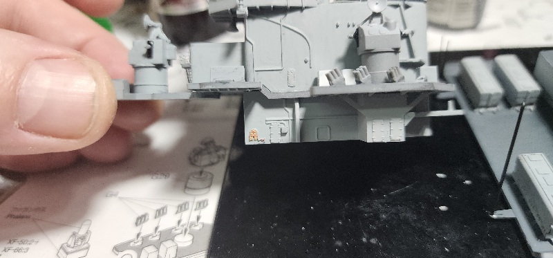

Ah, you notice the scorched coloring of the li'l one yea?Those should work really well! I use a cigarette lighter to clean my applicators. BEWARE! Cured C/A glue burns off with great enthusiasm!!

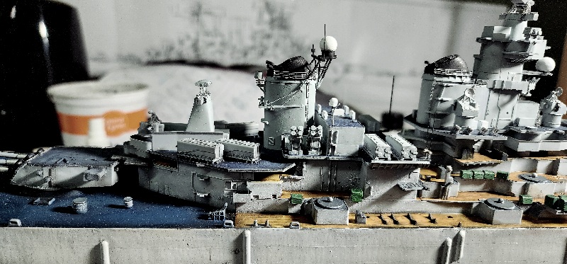

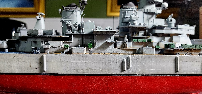

The subs mainly get the canning from the pressure gradients when submerging to varying depths, especially the WW2 stuff as the modern subs are way more rounded.Thing is it is very subtle. It is a lot of small shallow rectangles that can only really be seen when the light is right. The submarine photos he showed were the most pronounced, but it wouldn't surprise me if water pounding against the steel on the subs would cause the steel to divot inwards a bit more than other ships.
G and I discussed it said that very thing. I can add them at the end if necessary. I did find a striking set of four on eBay for $22 so if all else fails that is my fall back plan.Hold out till you get your new printer, you can always add the part once it's done.

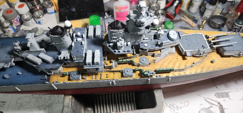

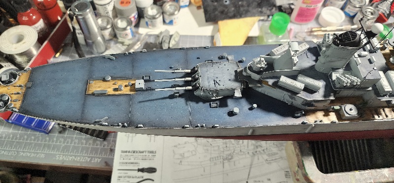

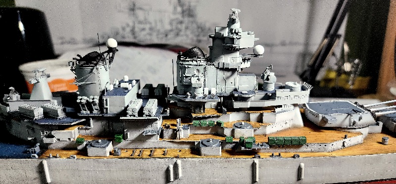

Washes/glazes look great.
