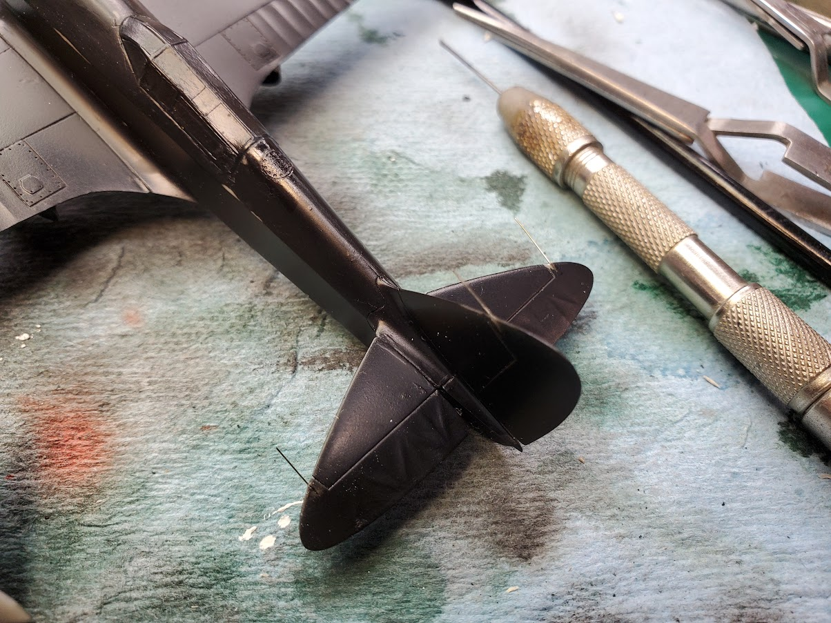

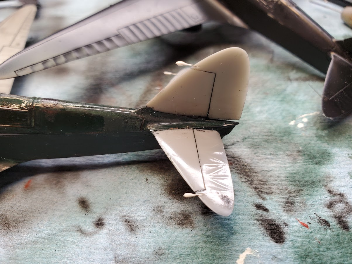

I'm not going to clog up things with more pictures. I had to strip the wings back to the wing roots, it was a good demark point, in sanding and cleaning up I had to strip some and that left steps in the layers that would be too pronounced once I got a finish on it.
The slot instead of a drilled hole is going to work. I just got to get the CA to bead up, need some accelerant. I thought Acetone worked as an accelerant but nope. Any other house hold items work? If not I'll hit the hobby lobby tomorrow.

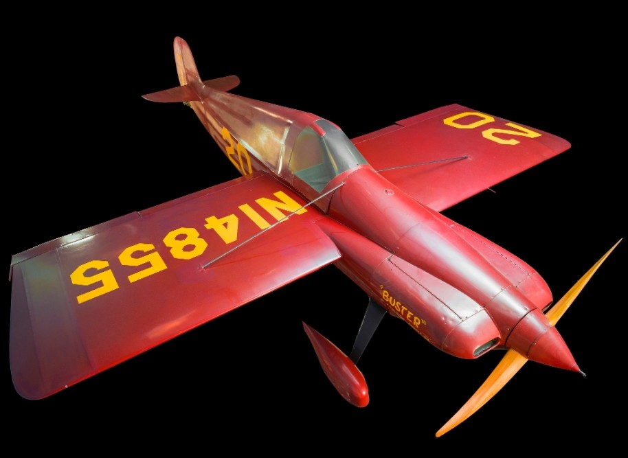

Totally unrelated to your builds, which look great Bob 👍 I have a friend who gave me several of his kits. One is a vintage RC 1/4 scale "Buster" midget racer. It raced from 1931 to 1954. The real one hangs at the the Smithsonian. I've been threatening to build it.

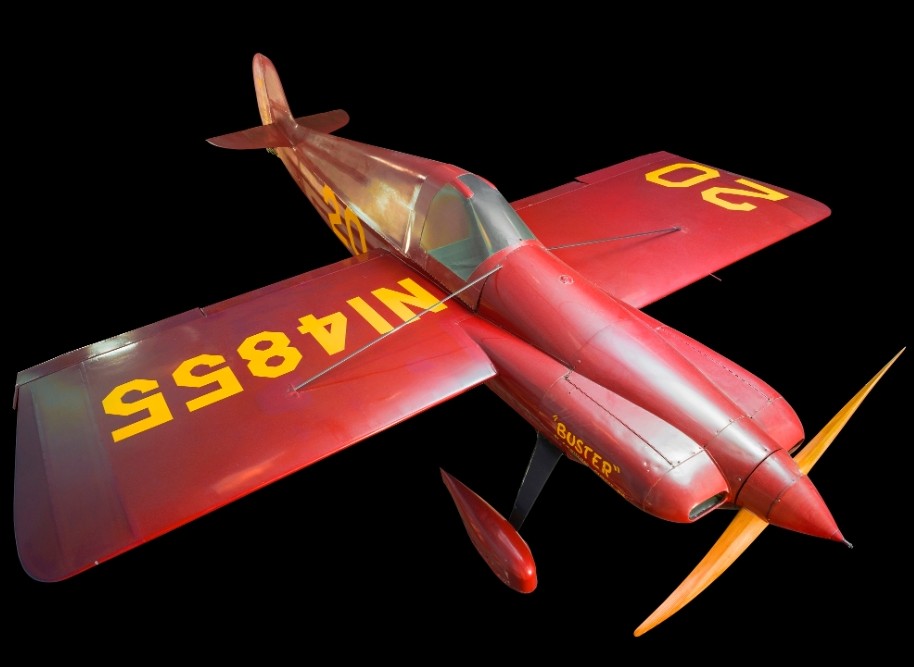

Totally unrelated to your builds, which look great Bob 👍 I have a friend who gave me several of his kits. One is a vintage RC 1/4 scale "Buster" midget racer. It raced from 1931 to 1954. The real one hangs at the the Smithsonian. I've been threatening to build it. View attachment 167901
I wonder if the Cassutt CJS has it's roots there. My Dad built one in our Garage and flew it off in 1971 as N2CP.

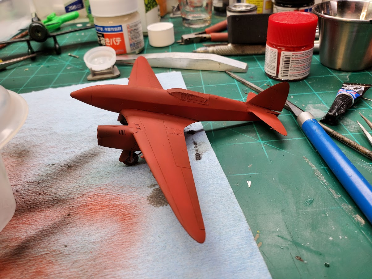

I've really been over thinking this. I tried to make the counter balances all sorts of ways. Finally hit me, just pin it and paint it with Mr Desolved Putty.
If it's over stated at the point in time I paint I'll just knock off the putty and paint it again.
Depending on the paint you are using, you can take some thinner and do a wet mist over the paint and it will smooth out the orange peel and other paint flaws, except for crud and dust.
I have done that with my Alclad gloss black by spraying it with a wet mist of Mr. Retarder. It has given me a glass smooth finish with almost no effort. I also did it with the Testors French Blue on the Bugatti racer last year and got the nice smooth gloss finish there as well.

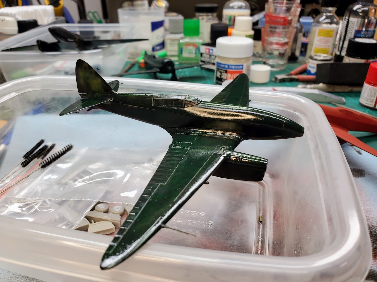

Back to coloring
And I broke out the Red.
Gloss coat will make it shiny, that's how I handled Black Magic last time. I'll have her painted tomorrow. Wanted to give the Humbrol BRG or Bentley Green time to cure
