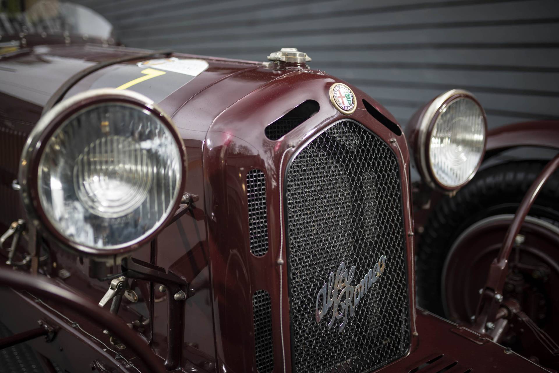

This is a full size Alfa 8C 1933 Its covered in square head bolts which are lock wired

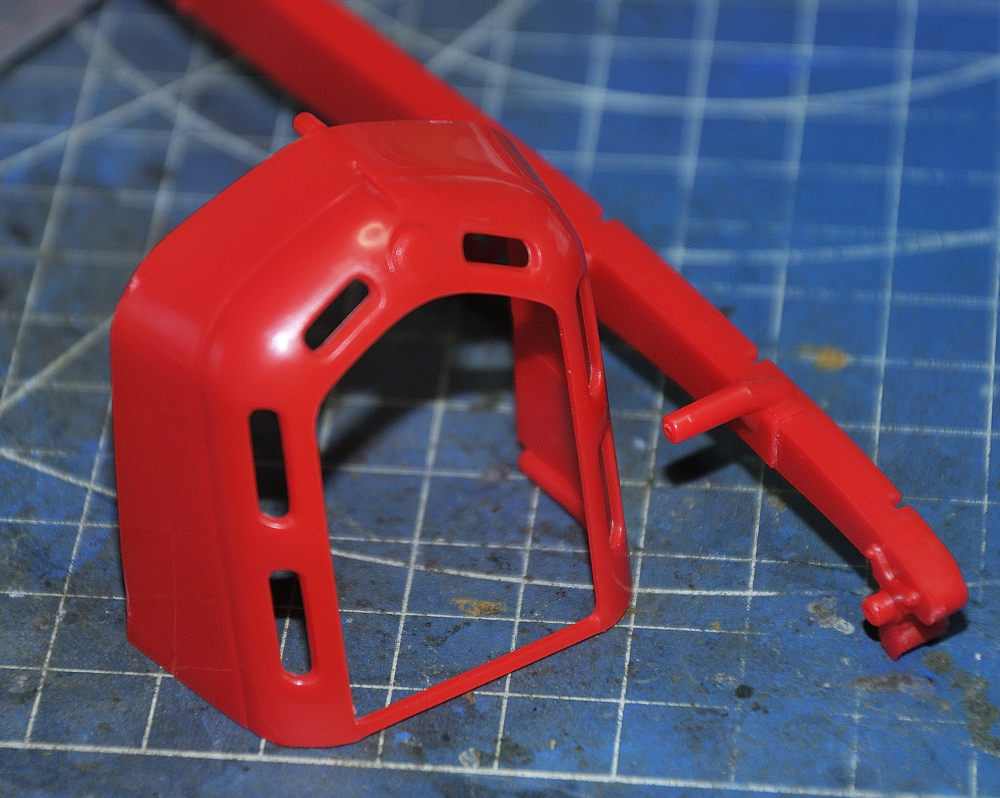

On a model at 1/12 these would be about 1mm across, i cant find anyone who does square bolts and i doubt i could drill a .3 mm hole through them if i could, the Kit ( Italeri) would need about 50 of these
You can see them better round the grill
On the kit they are not even marked
Anyone got and bright ideas ? Best i have come up with is a very small slotted round rivet with the wire laid through the slot this filling it and them painted ?

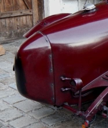

Over the back of the seat and rear fender here...
These are 14bs screws with some wire laid through the slots that i just rigged up, i wonder if i fill the slot with a little thick CA and thn paint them red ? TBH they are so small that without glasses i doubt you would see they are round and not square.

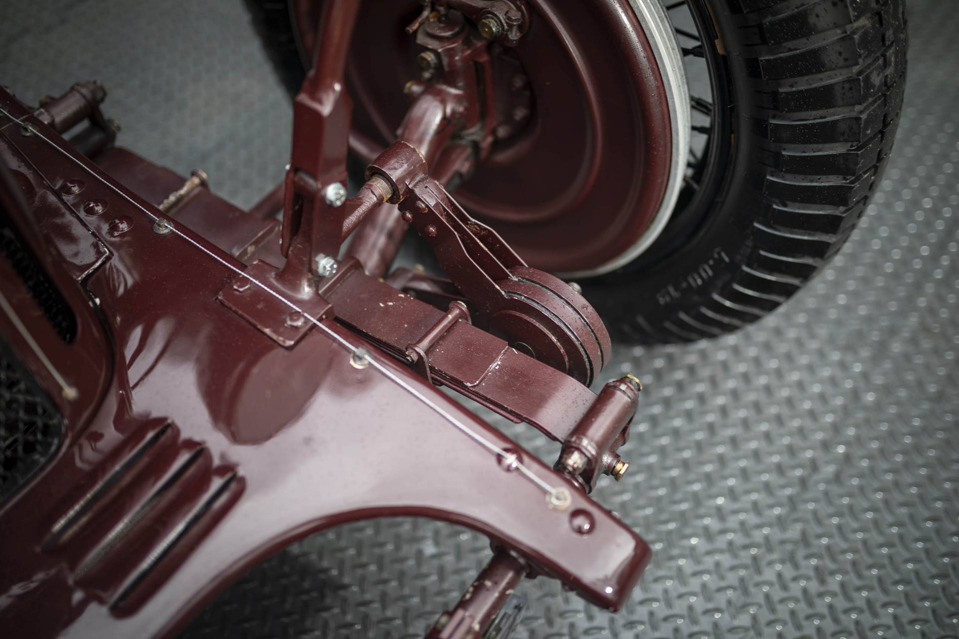

That's a weird way to safety bolts. If the wire breaks at any point it all comes undone.
It doesnt really make sense because if these are nuts and bolts you need to get to both to tighten, i also note that they are all flighted so they must have held both ends to get the holes to line up bolt to bolt for the wire to be straight ?#

I don't think they are bolts you tighten down, I think those are studs you attach the wire on and the wire holds down the body part that is attached. I think the bolts are just alignment points and the wire secures it.
I think you are spot on Bob, thats why they all line up, you cut the wire and remove the panel in seconds.:vgood:
