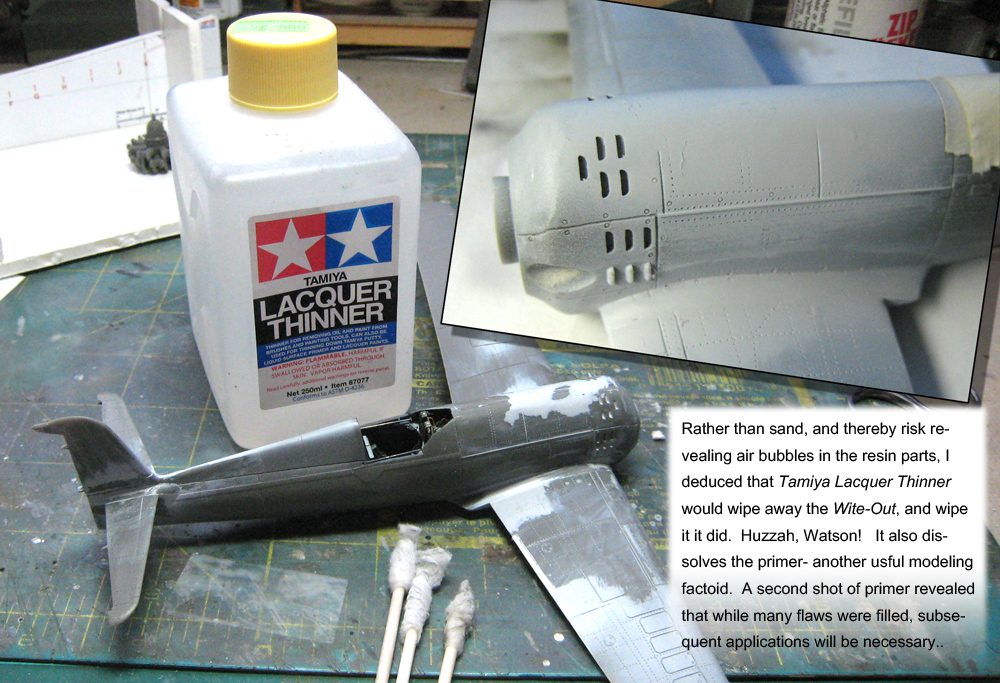

Interesting with the White Out. I'll store away that little tidbit. Funny, I wasn't sure they still even made White out anymore. Great job on fixing the short shot too! I like to see modelers that don't give up just because of something like that! Too many do!

Christian, take a look at that pic. I drilled three holes in each side, aimed horizontally. Then I slipped three brass rods in and, pressing the two halves of the fuselage together, superglued the crap out of 'em. Re-glued the seam, too. As soon as the glue was set I ground and sanded the protruding ends of the rods flush against the fuselage. Now all I have to do is rescribe and re=rivet, and hope the darn thing stays together!

I got the tip from some smart modeler, Bob- I just lucked into the whole lacquer--thinner thing. It does make for quick (and cheap) repairs.
